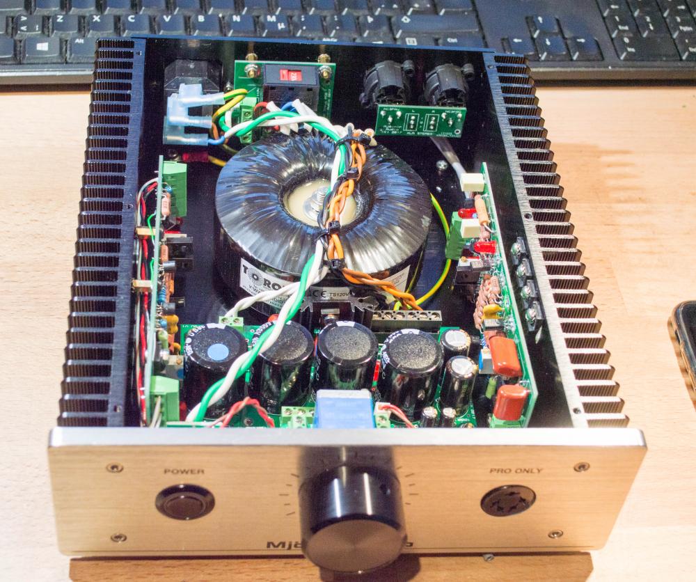

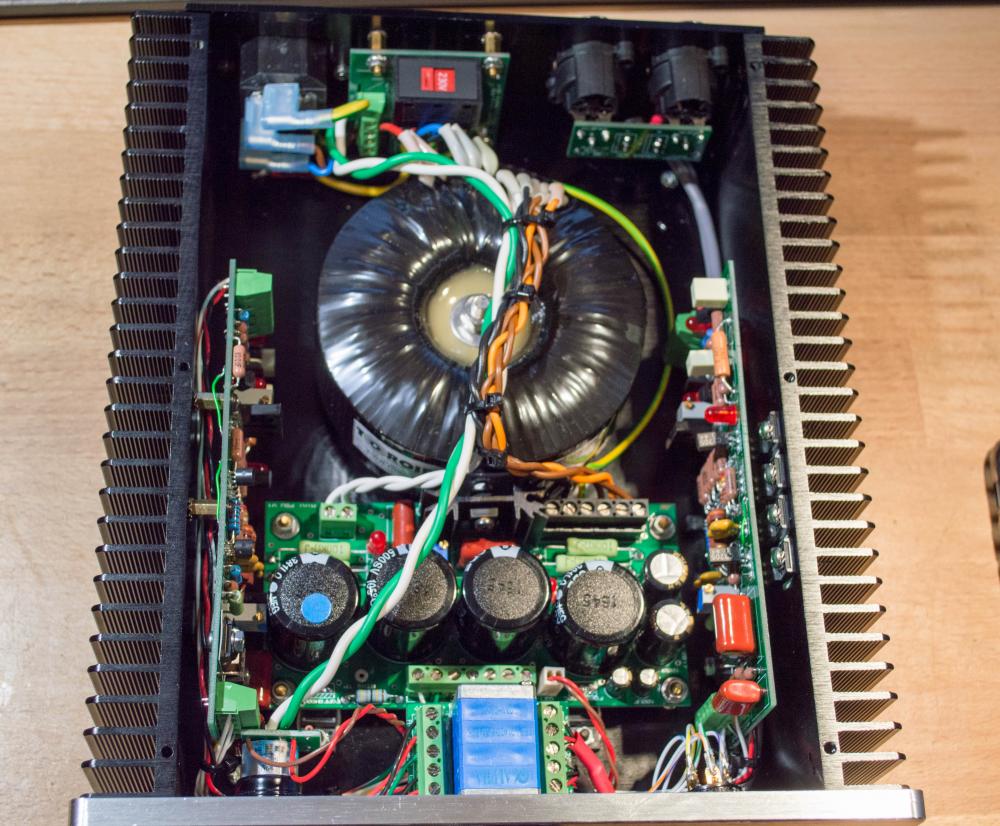

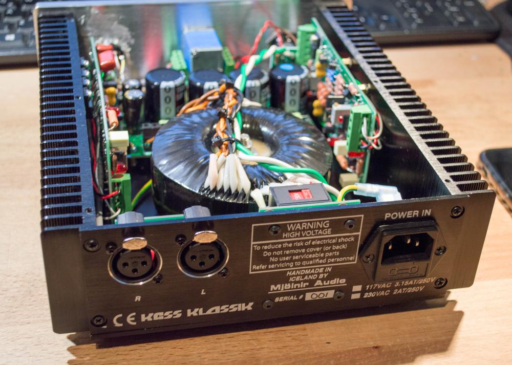

spritzer Posted November 18, 2017 Report Posted November 18, 2017 (edited) It's been a while since I built something just for me but here is something old...Ā Ā So long story short, I was sent some boxes by mistake and the seller said I could just keep them.Ā That also meant I had to find a project to put them.Ā They were tiny 70mm tall boxes with sinks on the sides so an idea was born.Ā It's been roughly 15 years since I built my first KGSS so why not make something to commemorate that..introducing the KGSS Klassik.Ā So this was a pretty difficult birth, cramming the PCB's down to this size while using the same parts I used back in the day...was a challenge to the say the least and well, there is no space in the fucking chassis.Ā So this is a bone stock KGSS like we did back in the day but with a few modern twists.Ā Ā Output resistors, 2SC4686A's instead of the C3675's but that's about it.Ā The PSU is the new SMD version of the old KGSS design.Ā As can be seen, this is a super tight fit and makes something like the KGSSHV mini seem spacious.Ā It does work wonderfully but I need to do something about the Stax socket.Ā So this one comes from the whole host of extension cables I've killed recently and often the threads on those sockets are just toast.Ā So here I glued it in place with some crazy resin glue but it didn't set properly.Ā Other than that, it is a cracking amp and not "that" much bigger than the SRM-252...Ā Ā Edited November 18, 2017 by spritzer 9 Quote
Rossliew Posted November 18, 2017 Report Posted November 18, 2017 Looking good there. You should instead name it the kgsshv-v and probably sell it for a whole lotta benjamins:p Quote

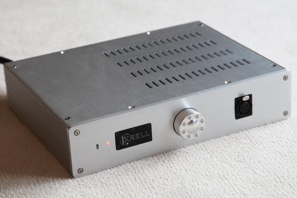

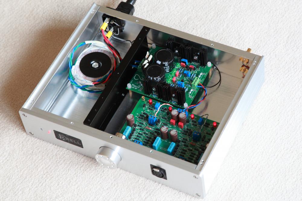

jose Posted November 19, 2017 Report Posted November 19, 2017 While I wait components for my Dynalo SS and my CFP I finished my F5ha: Ā Ā Ā 6 Quote
mwl168 Posted November 19, 2017 Report Posted November 19, 2017 Is this offered as a kit? The PCB looks to fit the chassis perfectly. Quote
jose Posted November 19, 2017 Report Posted November 19, 2017 No Kit is offered. A GB was made two or three years ago in DIYAudio and the PCB“s after many delays arrived earlier this year. PCB was designed to be used in this kind box. Quote
