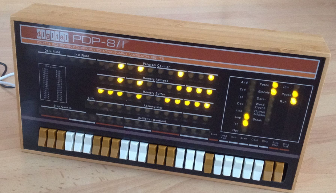

livewire Posted June 25, 2017 Report Posted June 25, 2017 (edited) Retro look blinkin lights! Ā Edited June 25, 2017 by livewire 6 Quote

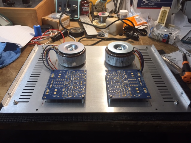

sbelyo Posted July 5, 2017 Report Posted July 5, 2017 Thanks... Ā Gonna populate the boards and mount the heatsink angle brackets this weekend. Ā I've got to get going on these projects. Ā They not gonna build themselves 4 Quote

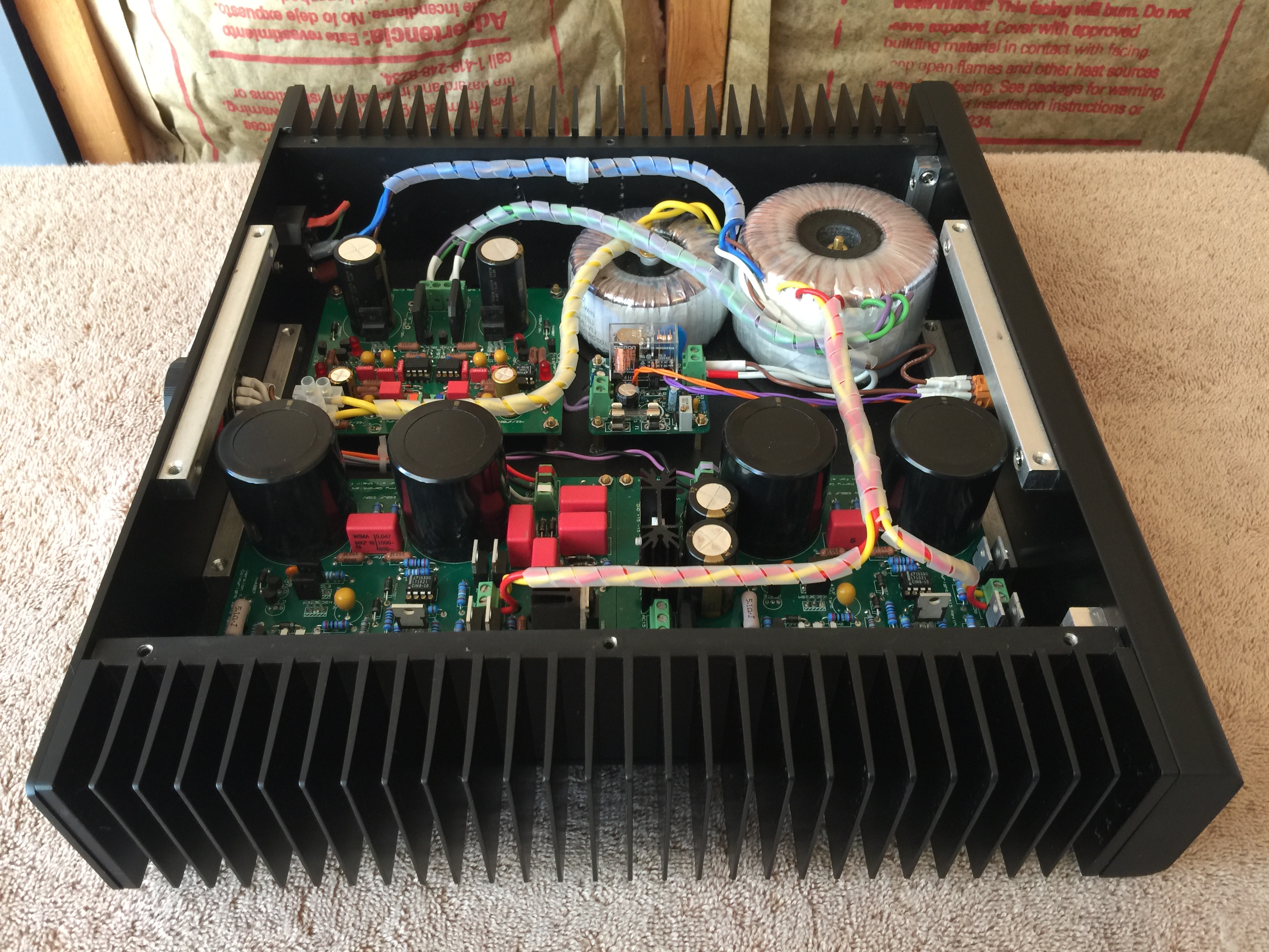

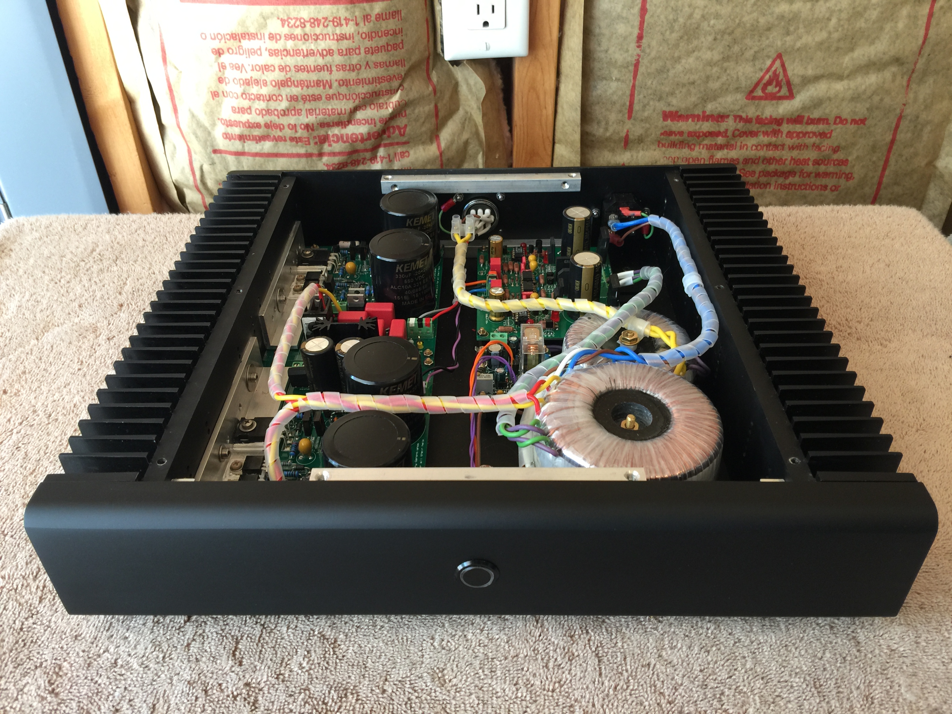

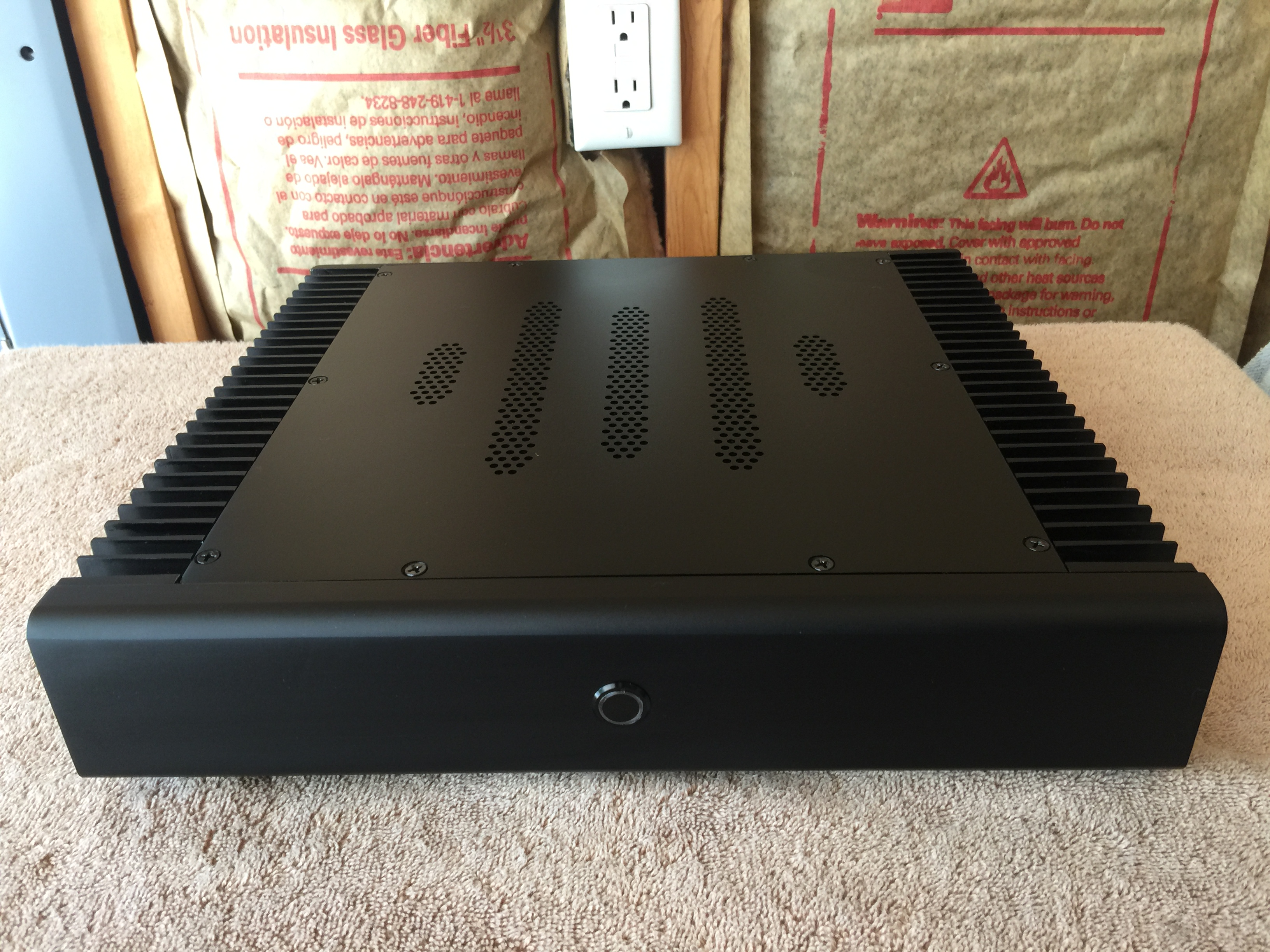

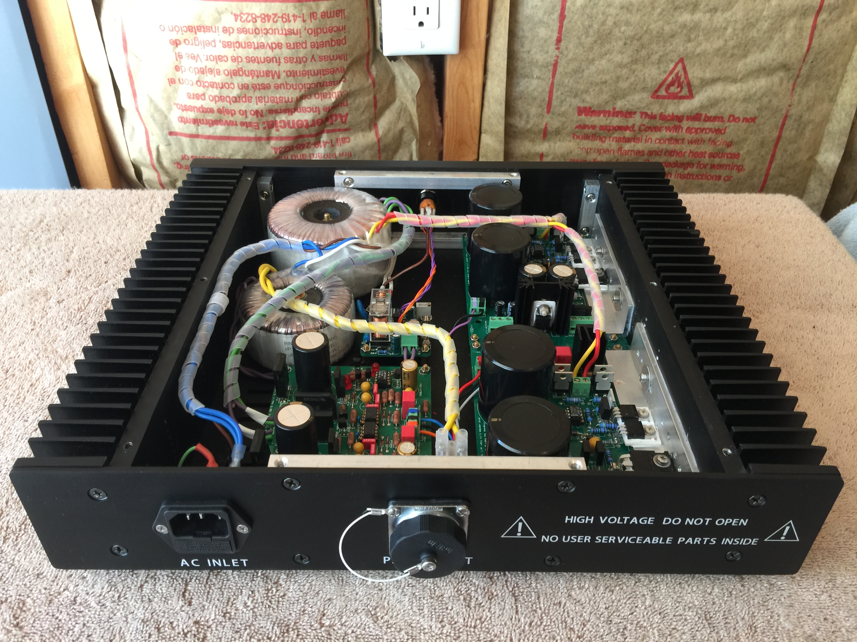

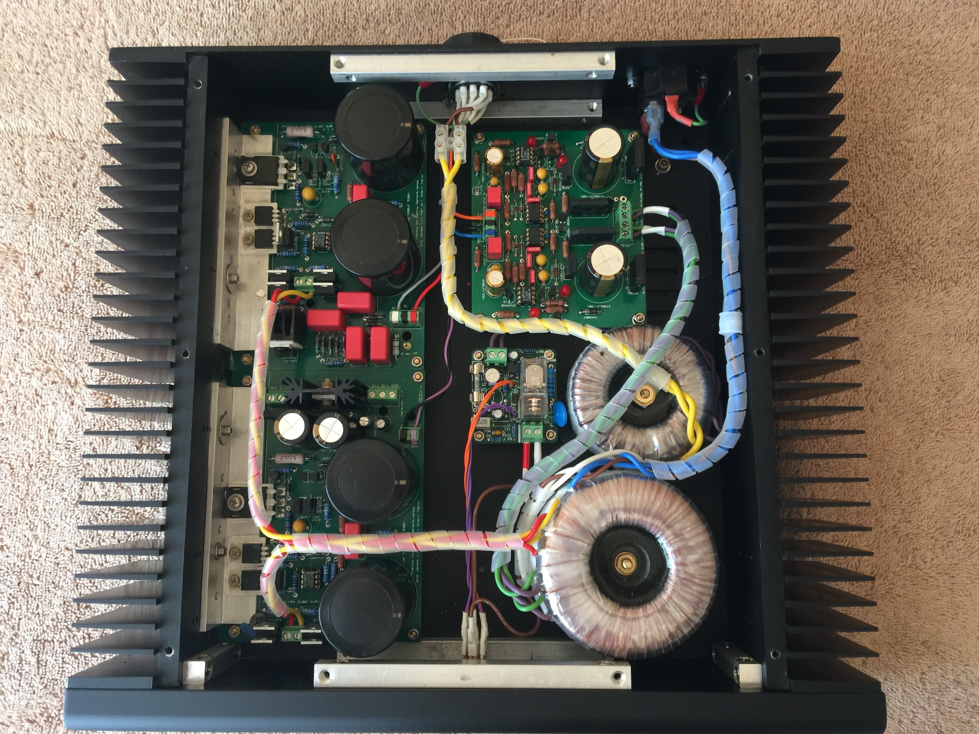

Laowei Posted July 8, 2017 Report Posted July 8, 2017 (edited) Finished up the separateĀ "Universal" PSĀ that will be used to power my GG. Maybe try it with a Carbon later.Ā Measurements:Ā GRHV+: 404.5VDC GRHV-: -406.4VDC GRLV+: 15.01VDC GRLV-: -15.00VDC Pro Bias: settles atĀ 580VDC Casework by Head-Case member joehpj AwaitingĀ select parts on a slow boat fromĀ China to finish up the GG.Ā Ā Ā Ā Edited July 8, 2017 by Laowei 11 Quote

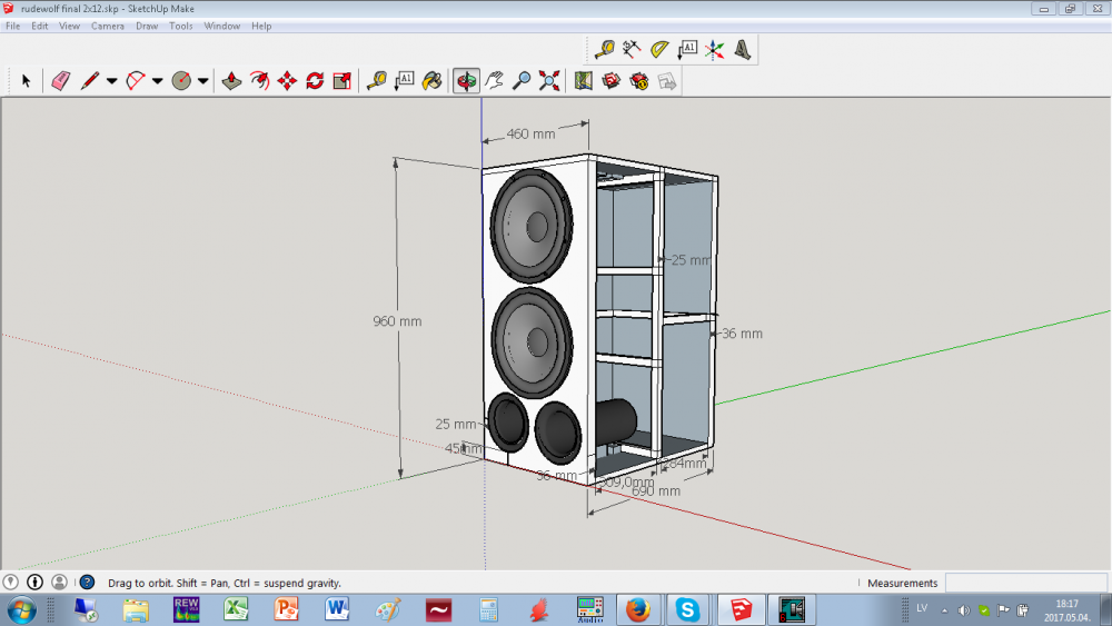

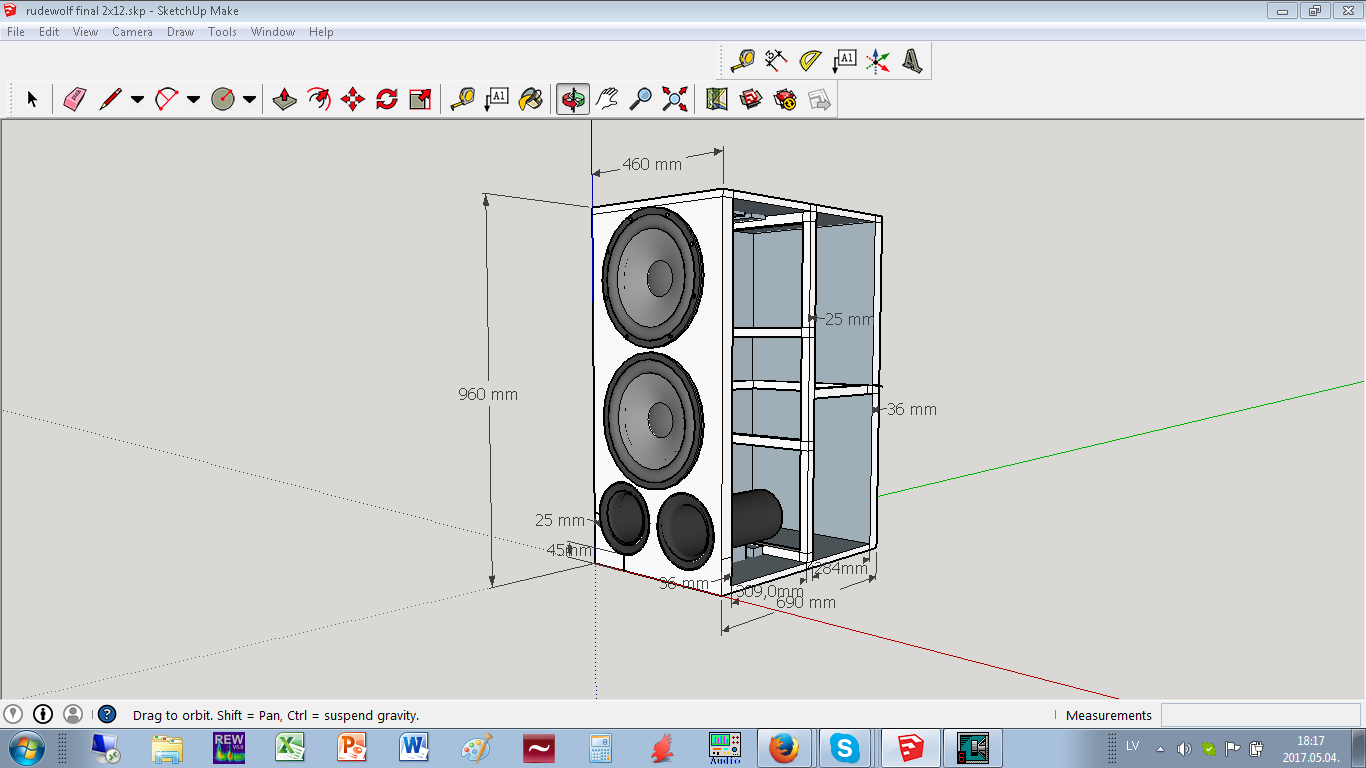

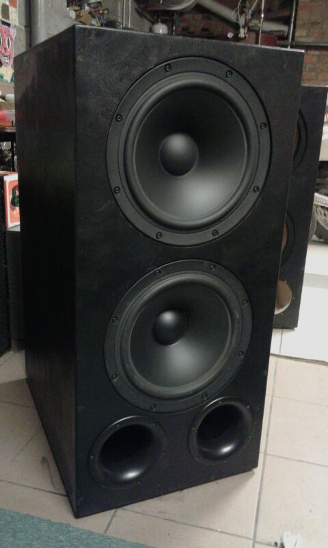

RudeWolf Posted July 12, 2017 Report Posted July 12, 2017 My new monitor stands. 114dB free field at 22Hz with only 500W. And there will obviously be two of them. 5 Quote
UFN Posted July 12, 2017 Report Posted July 12, 2017 Not bad. Which drivers are you using?Ā //UFN Quote
kevin gilmore Posted July 12, 2017 Report Posted July 12, 2017 12 inch and 10 inch drivers? similar to what Wilson does? Ā Quote
RudeWolf Posted July 12, 2017 Report Posted July 12, 2017 (edited) Four of these -Ā http://www.sbacoustics.com/index.php/products/subwoofers/12-sb34swnrx-s75-6/ I did plenty of research and my main goal was to find a light subwoofer driver which can do twenty. Initially I was looking at Dayton, but they're poorly represented in EU and they're anything but light. A high Mms/Bl factor was a must. Scanspeak had a 13" which was twice as expensive. Other than that I had to look for exotics like Audio-Technology and Accuton which are even more expensive but TS specs aren't any much better. SB Acoustics is actually a very decent manufacturer, but I'll mention that one of them came with a minor defect that's audible on higher excursion. Let's see how they'll handle it. Edited July 12, 2017 by RudeWolf Quote

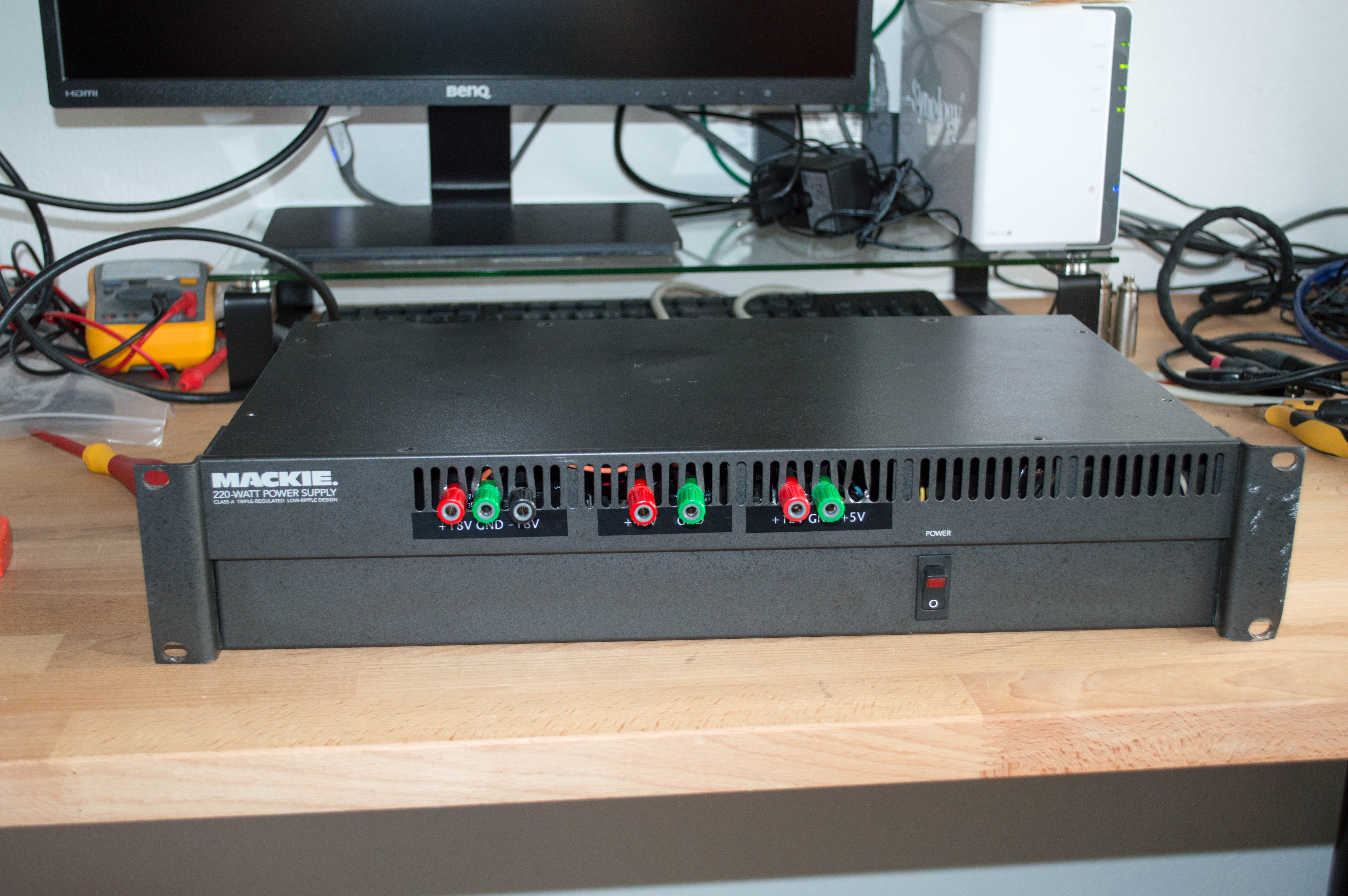

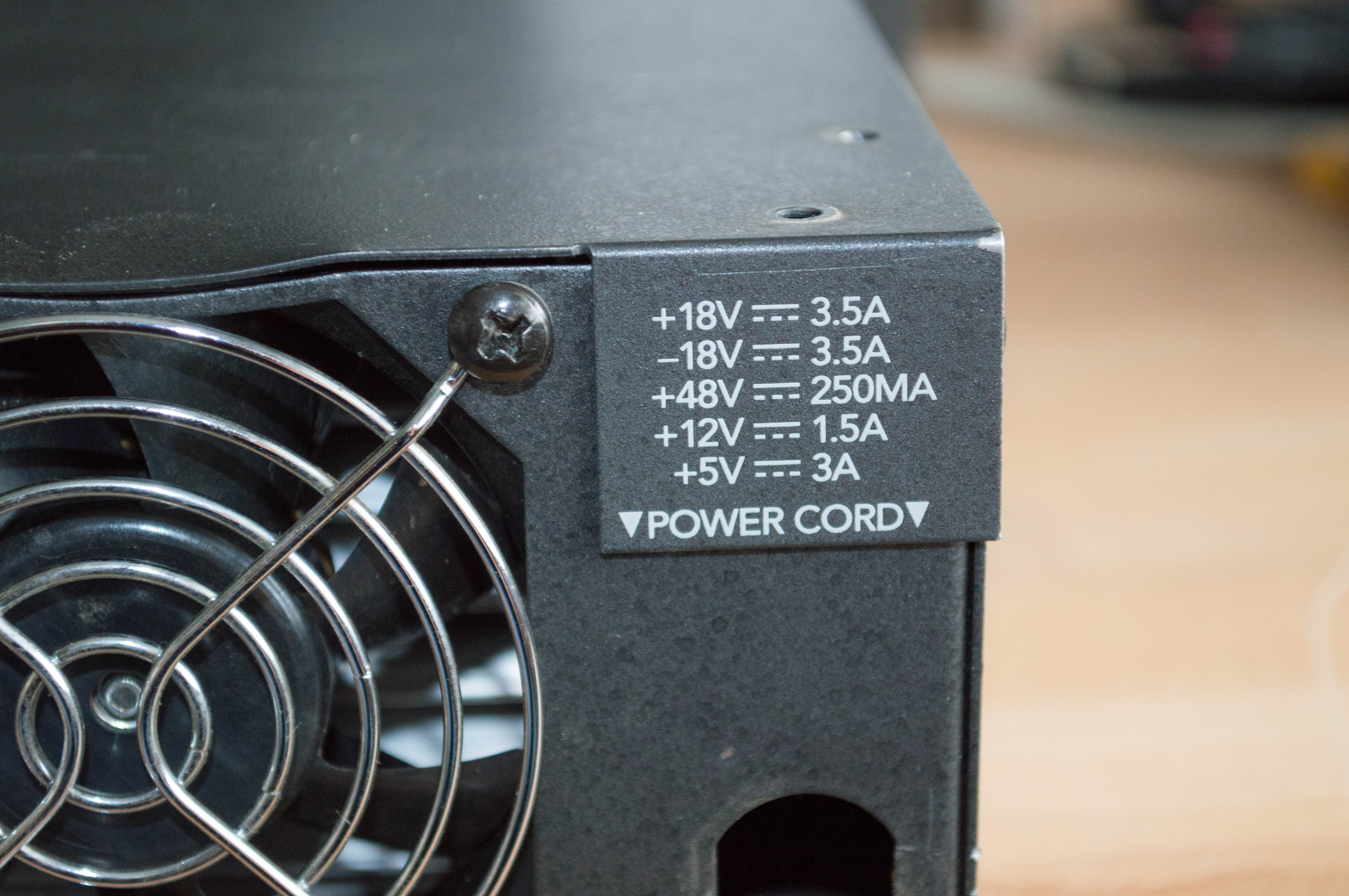

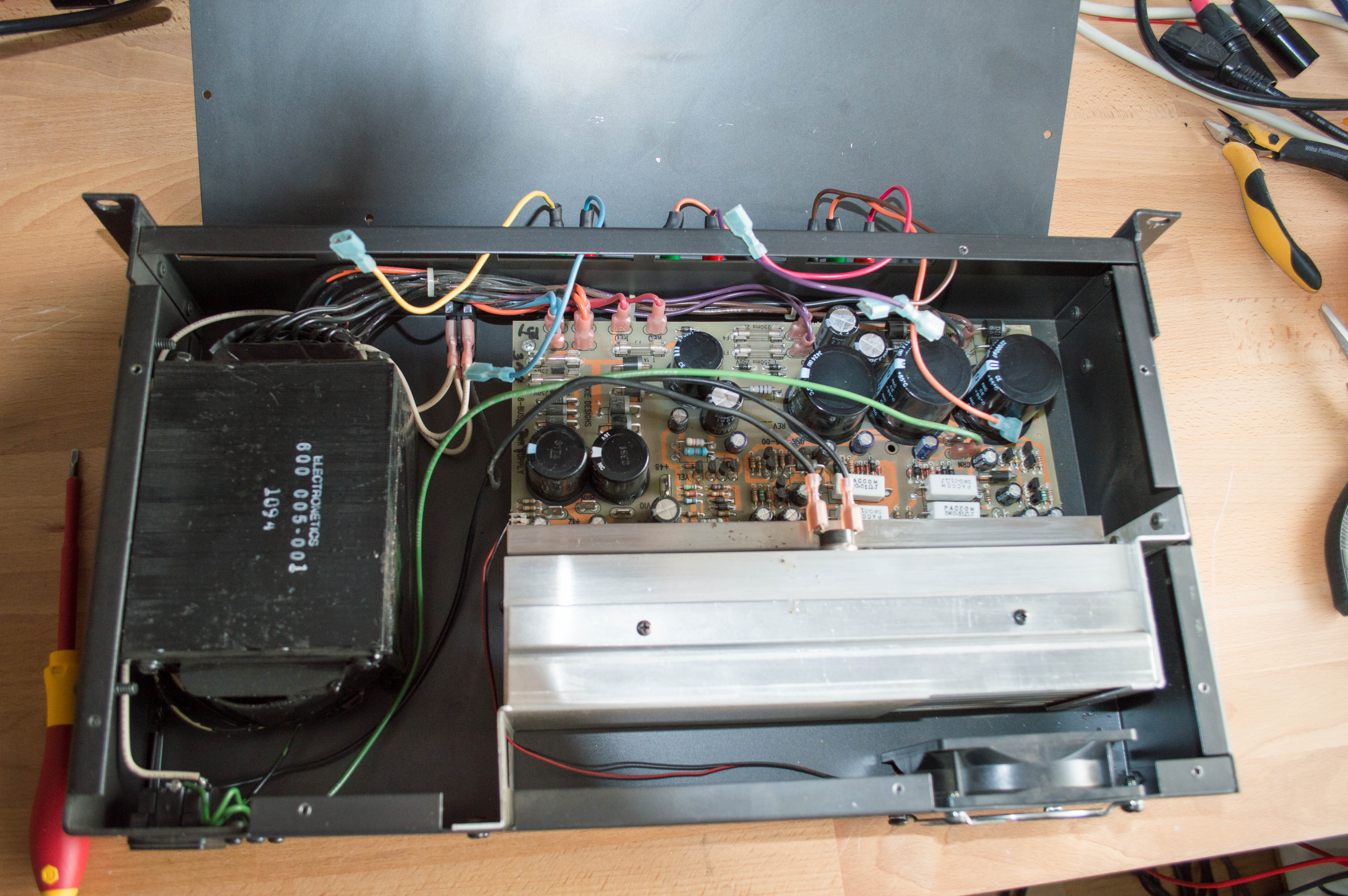

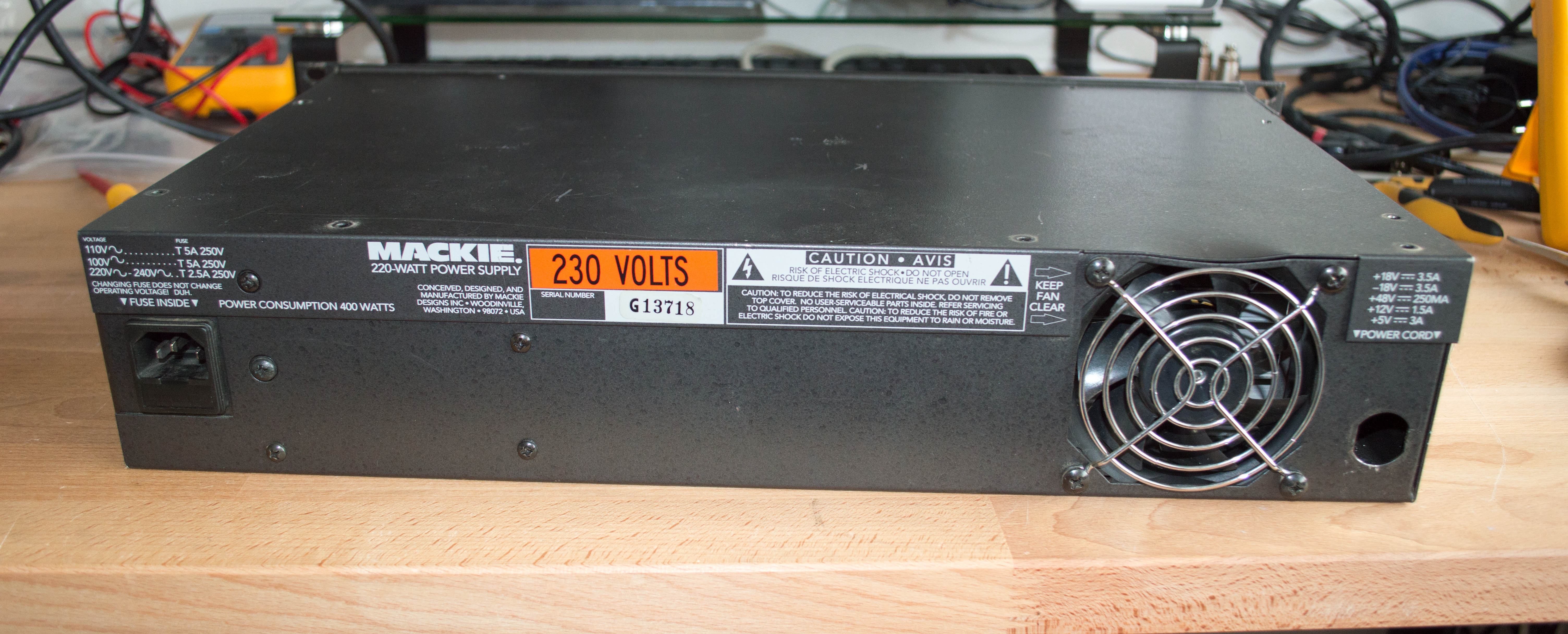

spritzer Posted August 9, 2017 Report Posted August 9, 2017 I went to the thrift store and there was nothing cool there until I saw this on a bottom shelf...Ā They were asking 20$ with stickers that they were unsure if it worked so perfect for me.Ā Ā This is a PSU for Mackie mixing desks with a super long umbilical cable which I have removed.Ā Heavy fucker too... at least 10kg.Ā Healthy output current so the idea came into my head to use it as a bench supply should it work.Ā After some cleaning it looked ok with no bad caps or any visible damage.Ā Just look at that monster of a transformer.Ā So I turned it on and well it worked so this was next: No current limiting here but hey, this one was cheap so who cares.Ā Also I can test large class A amps with this beast.Ā 11 Quote
