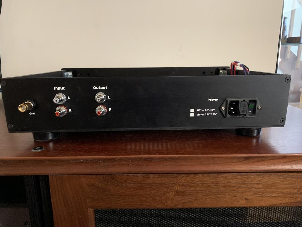

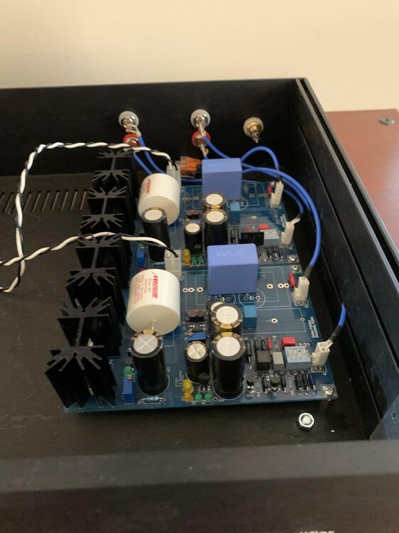

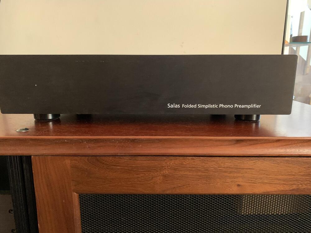

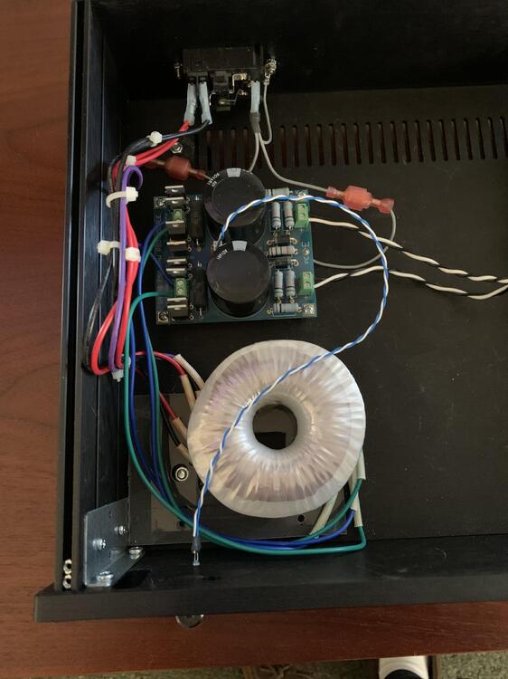

Pars Posted March 20, 2022 Report Posted March 20, 2022 Nearly finished casing my Salas phono stage. Need to mount the transformer and raw PSU. I may use a vandal switch on the front, but some type of momentary switch board or at a minimum, a voltage select board will be going in as well. Also need to shorten transformer leads, and clean up wiring. Runs dead quiet in my system; no noise evident when turned up all the way at tweeters or via headphones. I've got the Antek steel transformer cover and a set of Mundorf Supreme caps, though the kids all seem to be going for the Clarity Caps these days. It sounds good with the BC polyprop and MKP1837 I have in there now. This is setup for MM at 42dB gain. Loading switchable to several different values via dip switches. Set at ~34K right now for the Ortofon 2M Bronze I was using (a bright cartridge IMO). 8 Quote

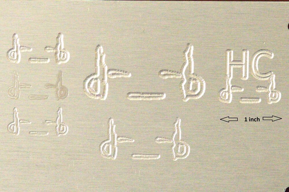

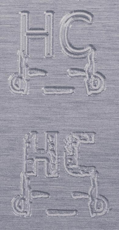

JoaMat Posted April 29, 2022 Report Posted April 29, 2022 Have made a few test inscriptions on aluminum with CNC machine.Ā Ā 7 Quote
JoaMat Posted April 30, 2022 Report Posted April 30, 2022 I somehow managed to copy H and C from HeadCase logo and mill it on the plate.Ā picture in B/W 8 Quote

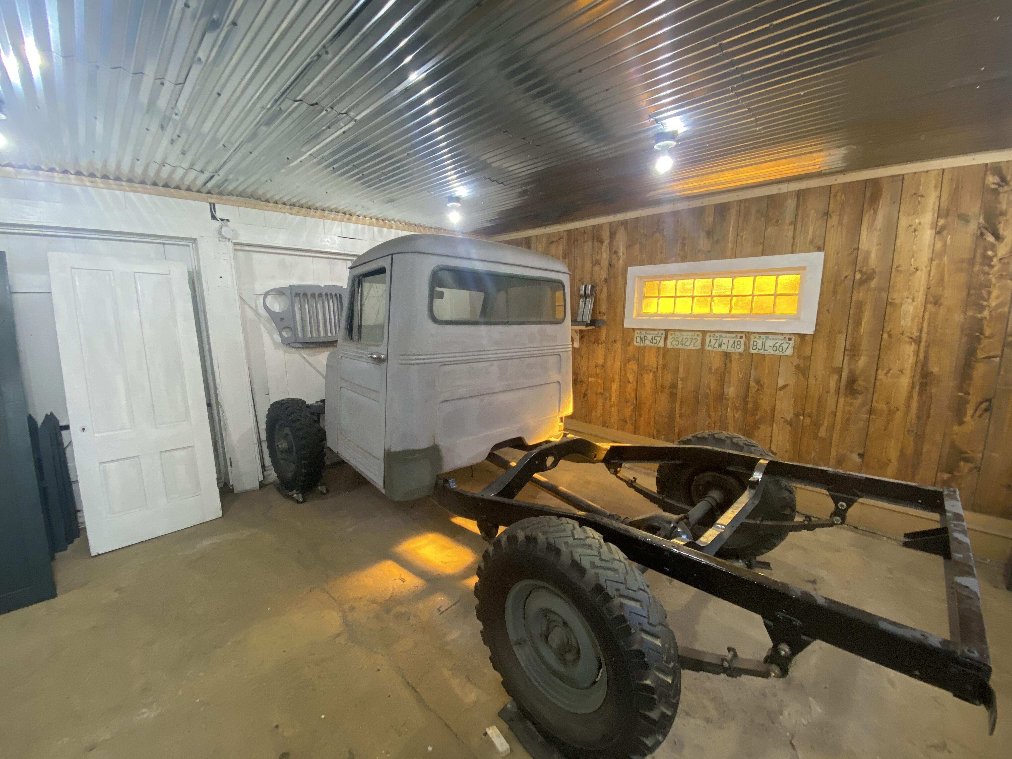

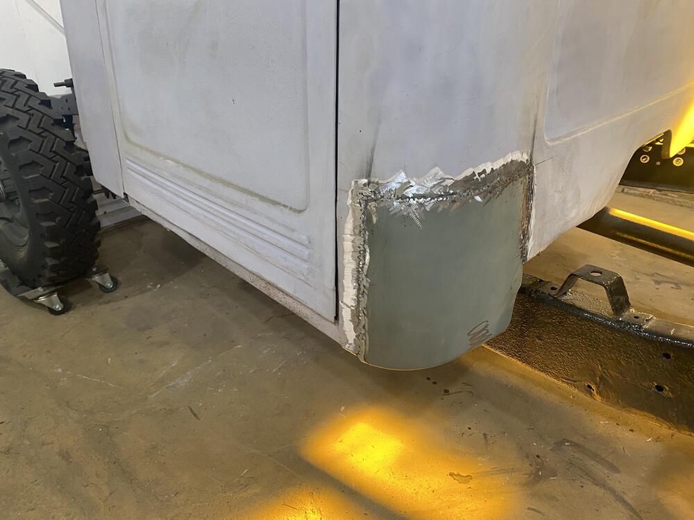

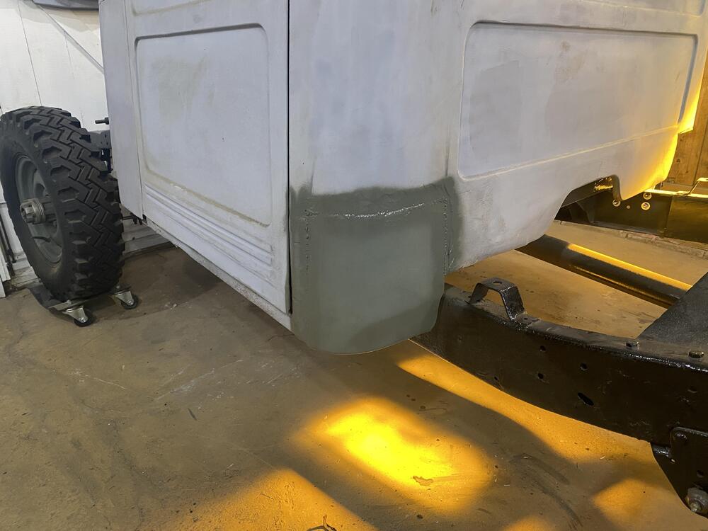

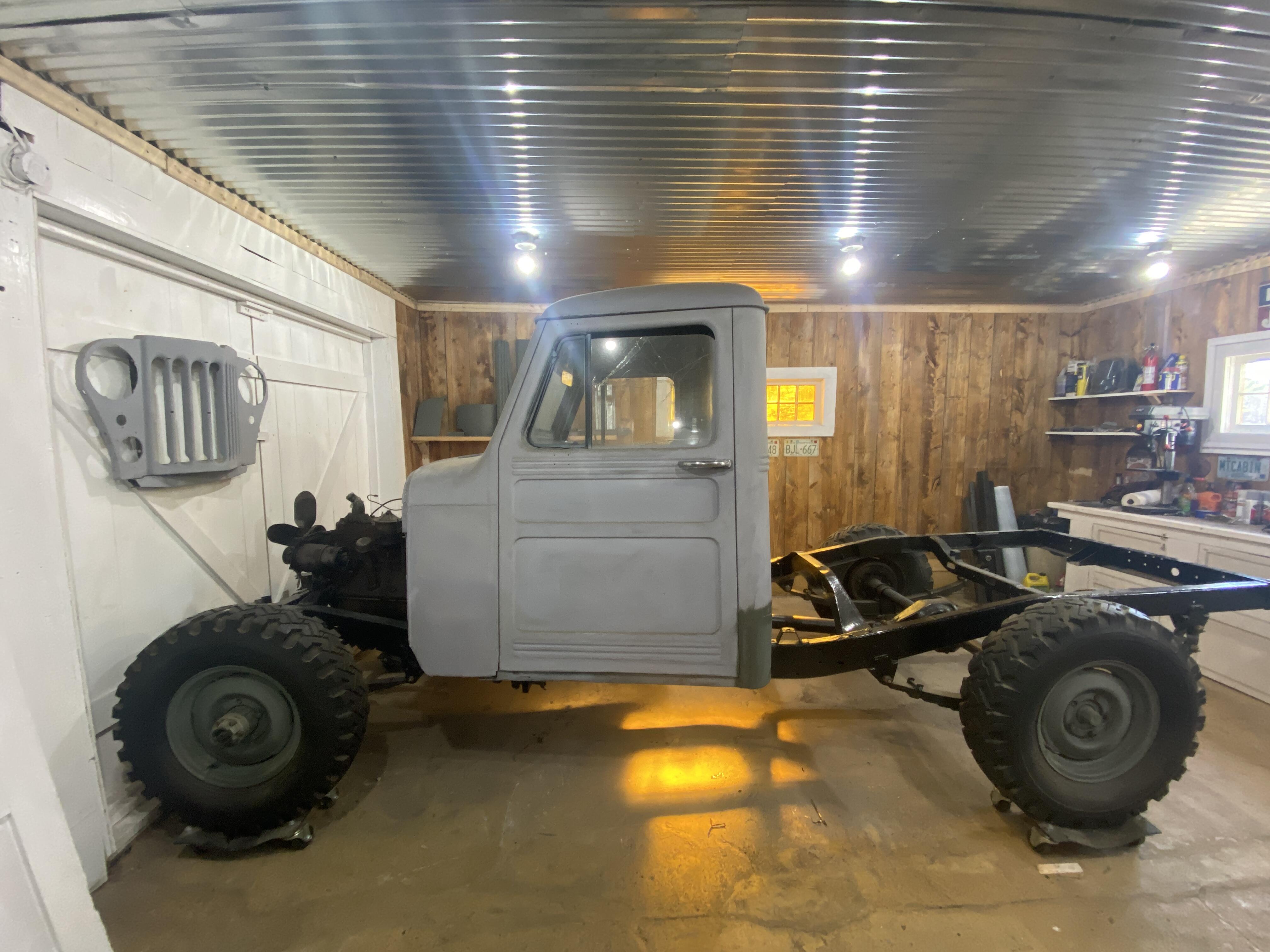

en480c4 Posted May 1, 2022 Report Posted May 1, 2022 Got one of the cab corner repair panels welded into my fatherās ā62 Willys project. As the saying goes, āa grinder and paint makes me the welder I aināt.ā Lower cowl panel in front of the door will be next, then the rocker, and finally lower door repairs. Then lather, rinse and repeat on the other side.Ā Ā Ā Ā Ā 12 Quote

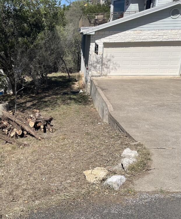

luvdunhill Posted May 9, 2022 Author Report Posted May 9, 2022 A box with some dirt in it Ā Pre box, pre dirt Ā 9 Quote

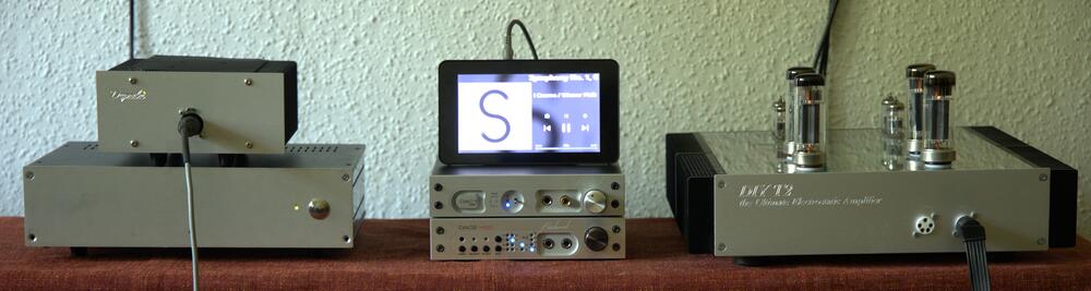

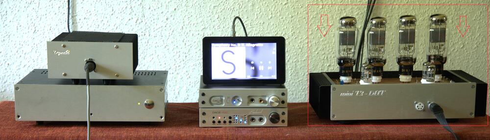

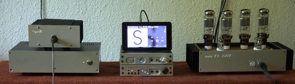

JoaMat Posted July 13, 2022 Report Posted July 13, 2022 Not built today, This combo works realy good but this combo is not good. Ā Where is the bad apple? 3 1 Quote
MLA Posted July 13, 2022 Report Posted July 13, 2022 Is DynaMat having an impedance fight with mini T2 DHT edition Ā ?Ā Quote
mikeymad Posted July 14, 2022 Report Posted July 14, 2022 The little orange light is on the Benchmark in the second one?Ā Ā Quote

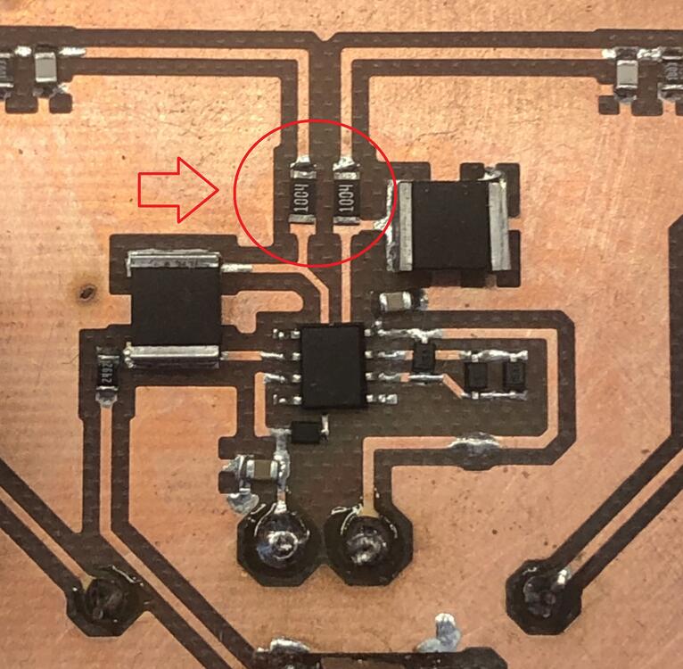

JoaMat Posted July 15, 2022 Report Posted July 15, 2022 Thanks for the suggestens. It turned out to be this⦠Two unsoldered pads inside amplifier to the right. The amplifier has been working all right for a couple of months, until now. Luckily, I noticed the two missing pads. No bad apple, just a poor soldering guy. 7 Quote
simmconn Posted July 15, 2022 Report Posted July 15, 2022 hmm, perhaps someone has the habit of populating all the parts first, and then finish up all the soldering joints. Easy to miss a thing or two when there is no AOI. After all itās only the servo⦠Quote

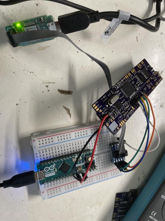

luvdunhill Posted October 21, 2022 Author Report Posted October 21, 2022 Anyone have a favorite jtag interface that can power the target and doesnāt have a complicated Vref requirement? I had to get creative to make this work .. Quote
