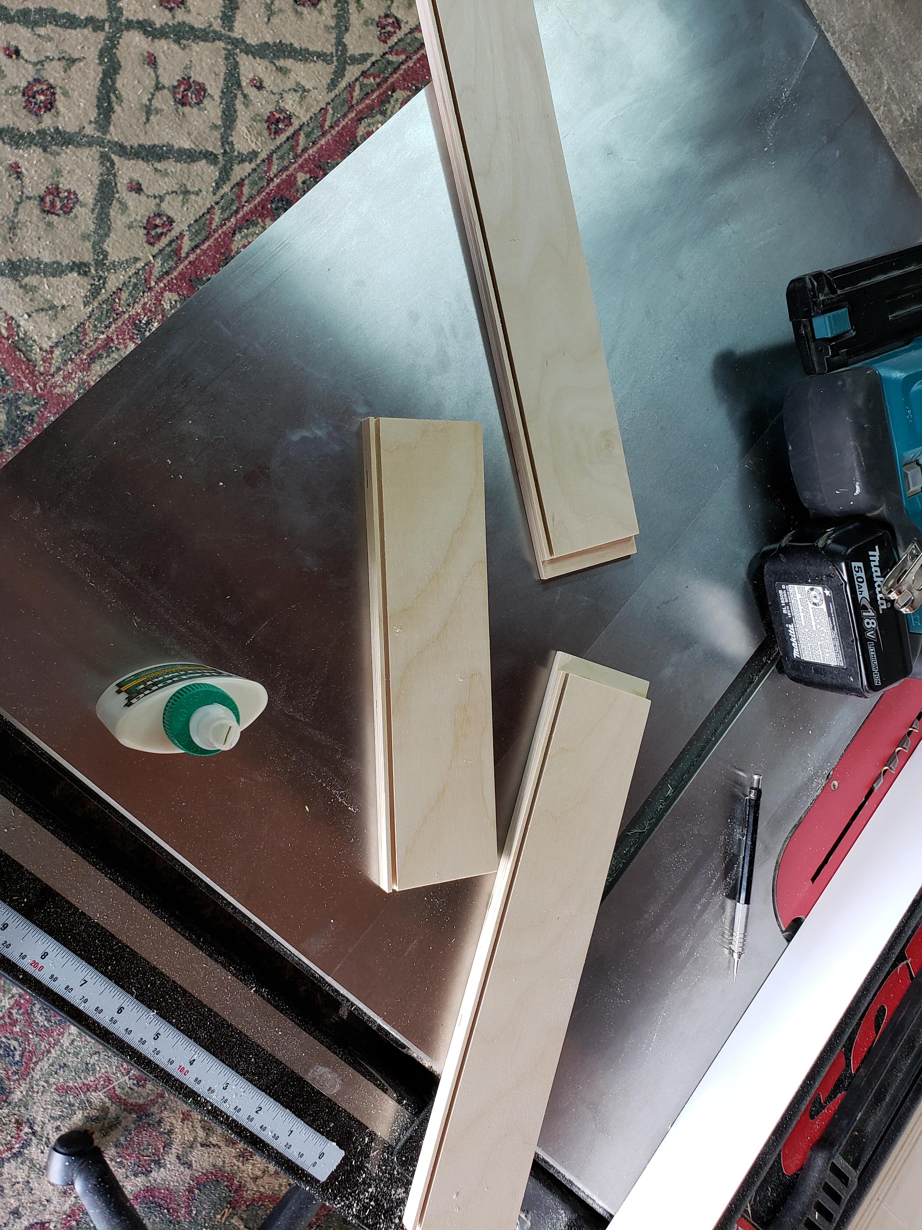

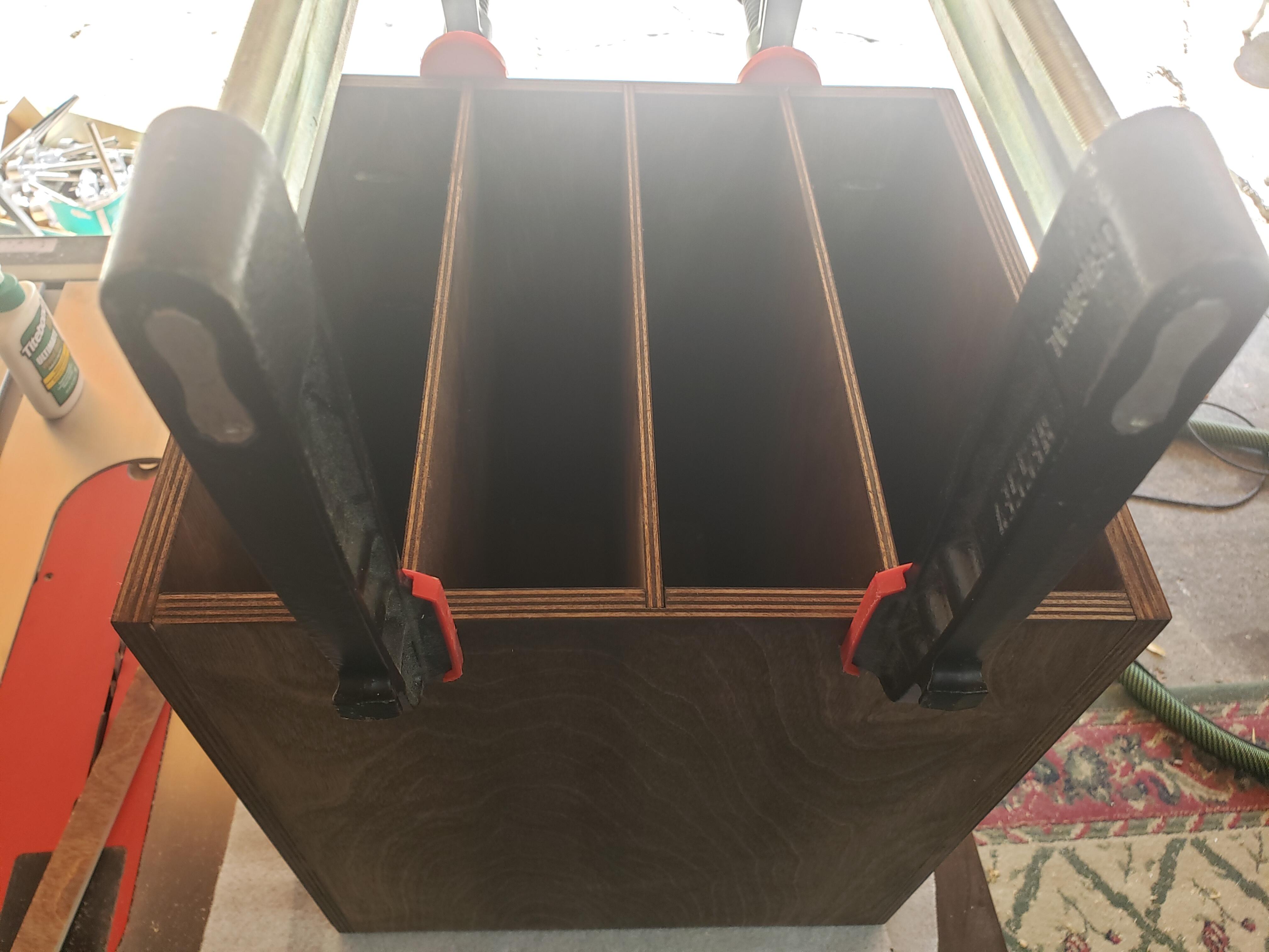

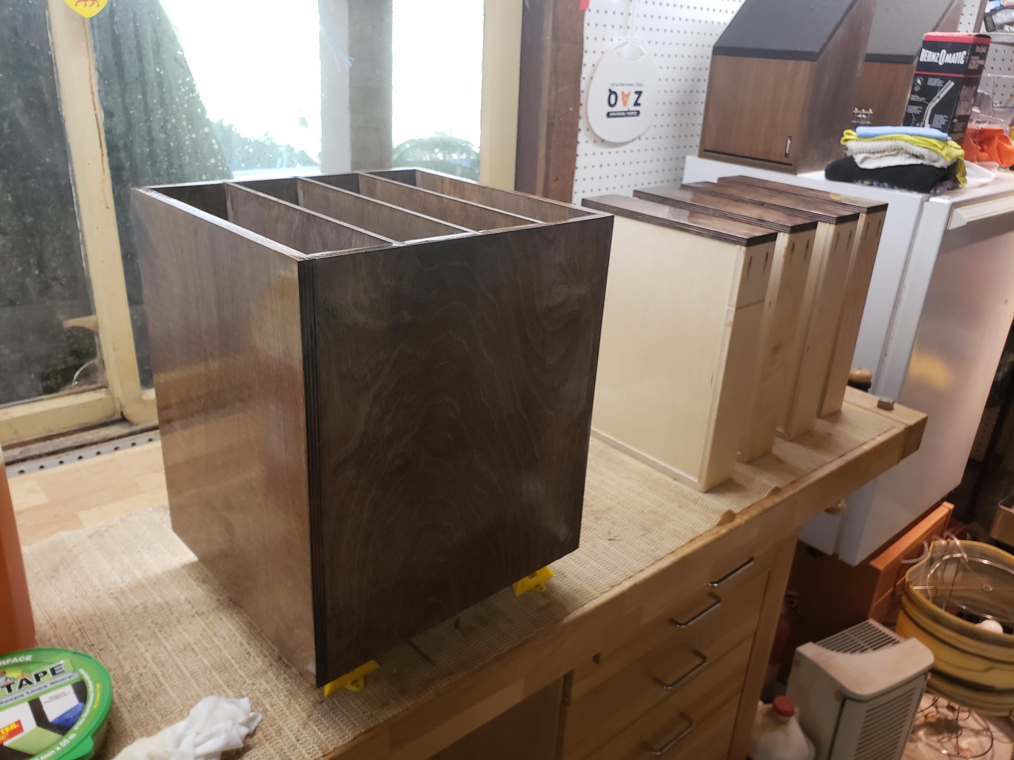

swt61 Posted July 17, 2021 Report Share Posted July 17, 2021 Got the drawer dividers cut, glued and clamped up. I cut the drawer material to height, but a tad bit long and wide. I want to wait until the box cures, then I can un-clamp and measure to fit nice and snug. I have some drawer glide tape coming. This will attach to the bottom of the drawer sides and allow the drawers to slide with minimal friction. The box is too small for mechanical drawer glides. 7 Quote Link to comment Share on other sites More sharing options...

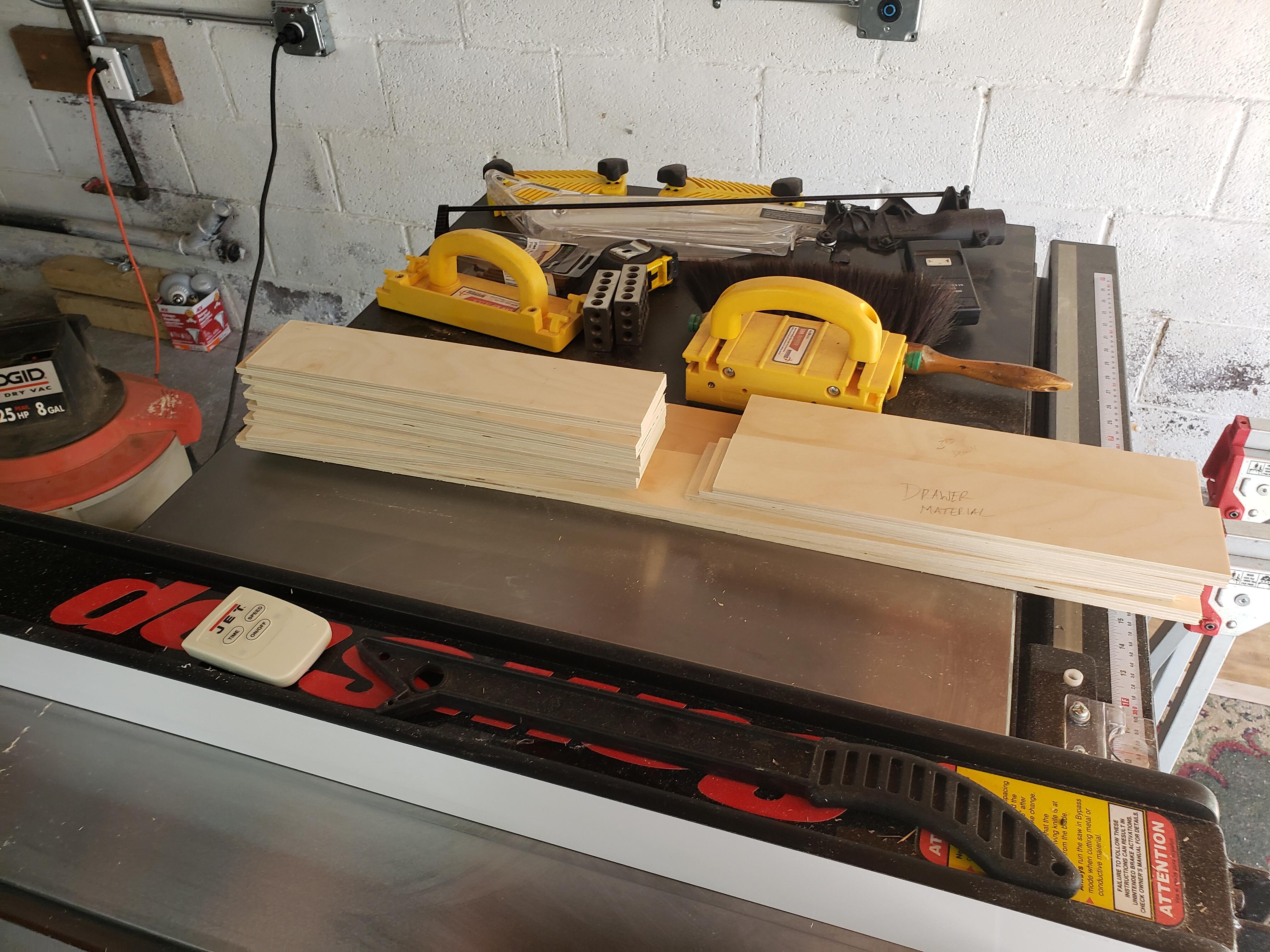

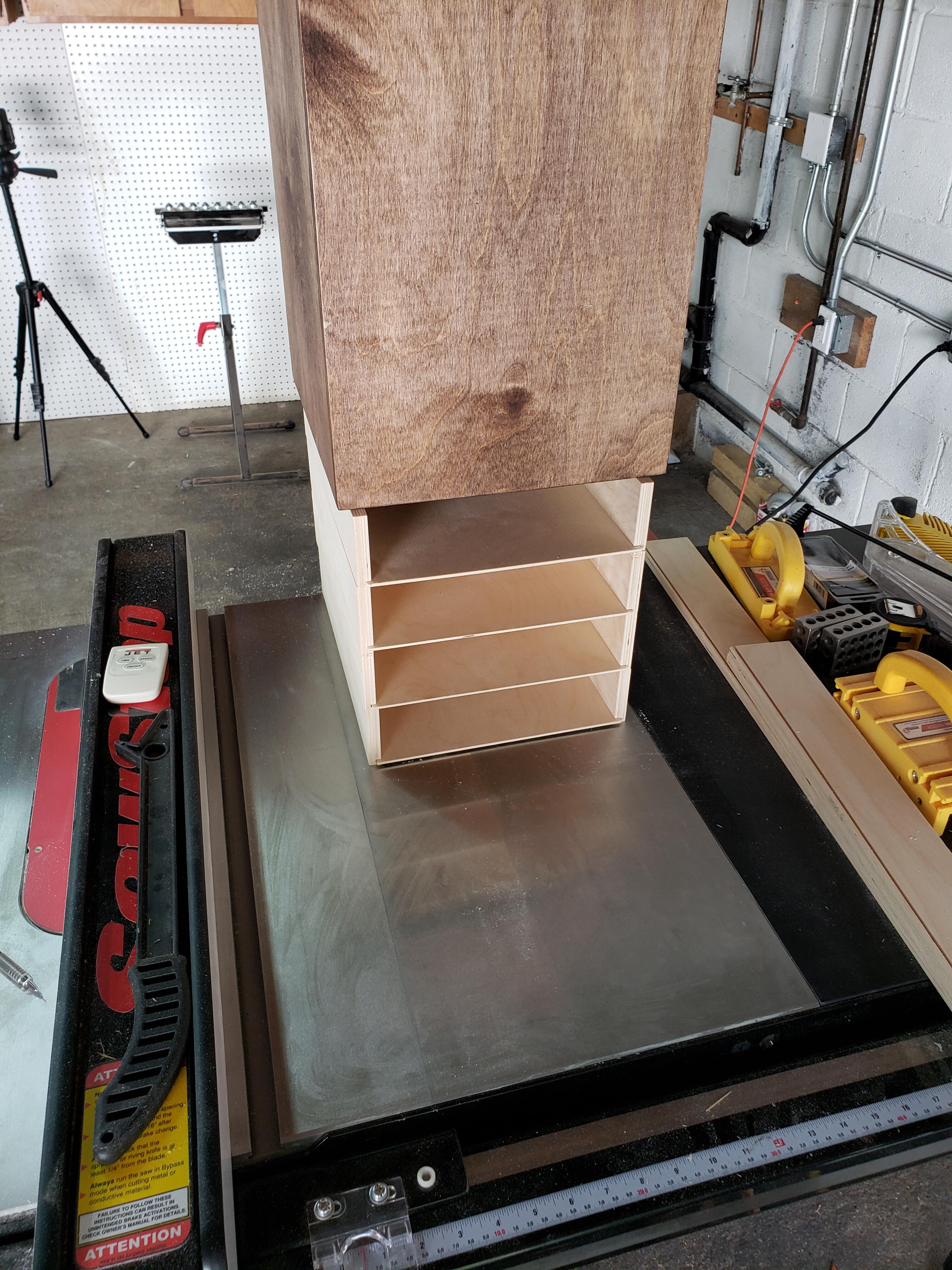

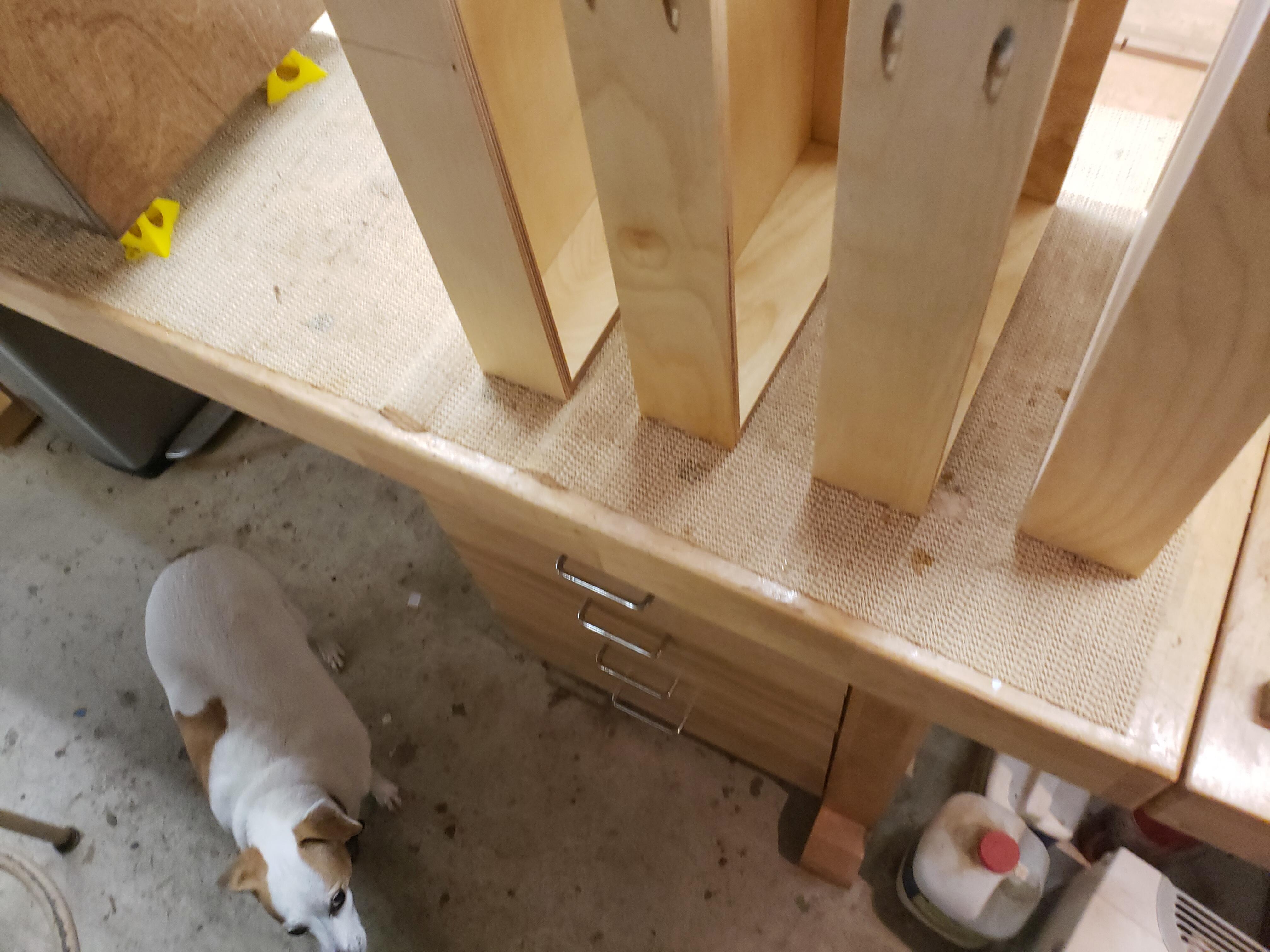

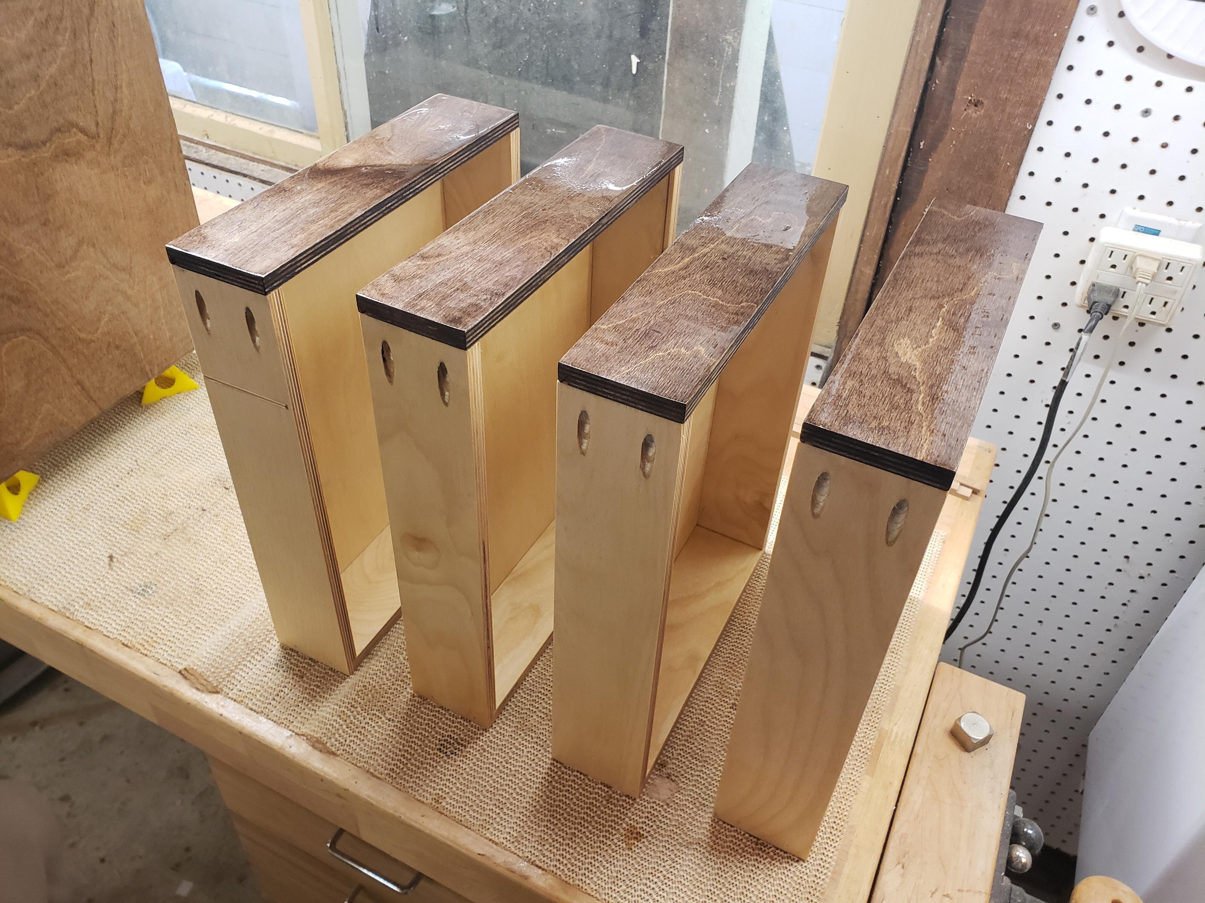

swt61 Posted July 17, 2021 Report Share Posted July 17, 2021 Three sides of all four drawers are cut, assembled and bottoms slid into place. The drawers will be left natural, with a clear lacquer finish. Except the drawer fronts, which will be stained to match the box. The box sits atop the drawers for weight, to ensure that they dry flat. Ā Tomorrow I'll cut the fronts to fit and stain them. Ā Not sure what finish I'm goingĀ to use on the box, but IĀ think it'll probably be boiled linseed oil, with a top coat of Tried-N-True. 9 Quote Link to comment Share on other sites More sharing options...

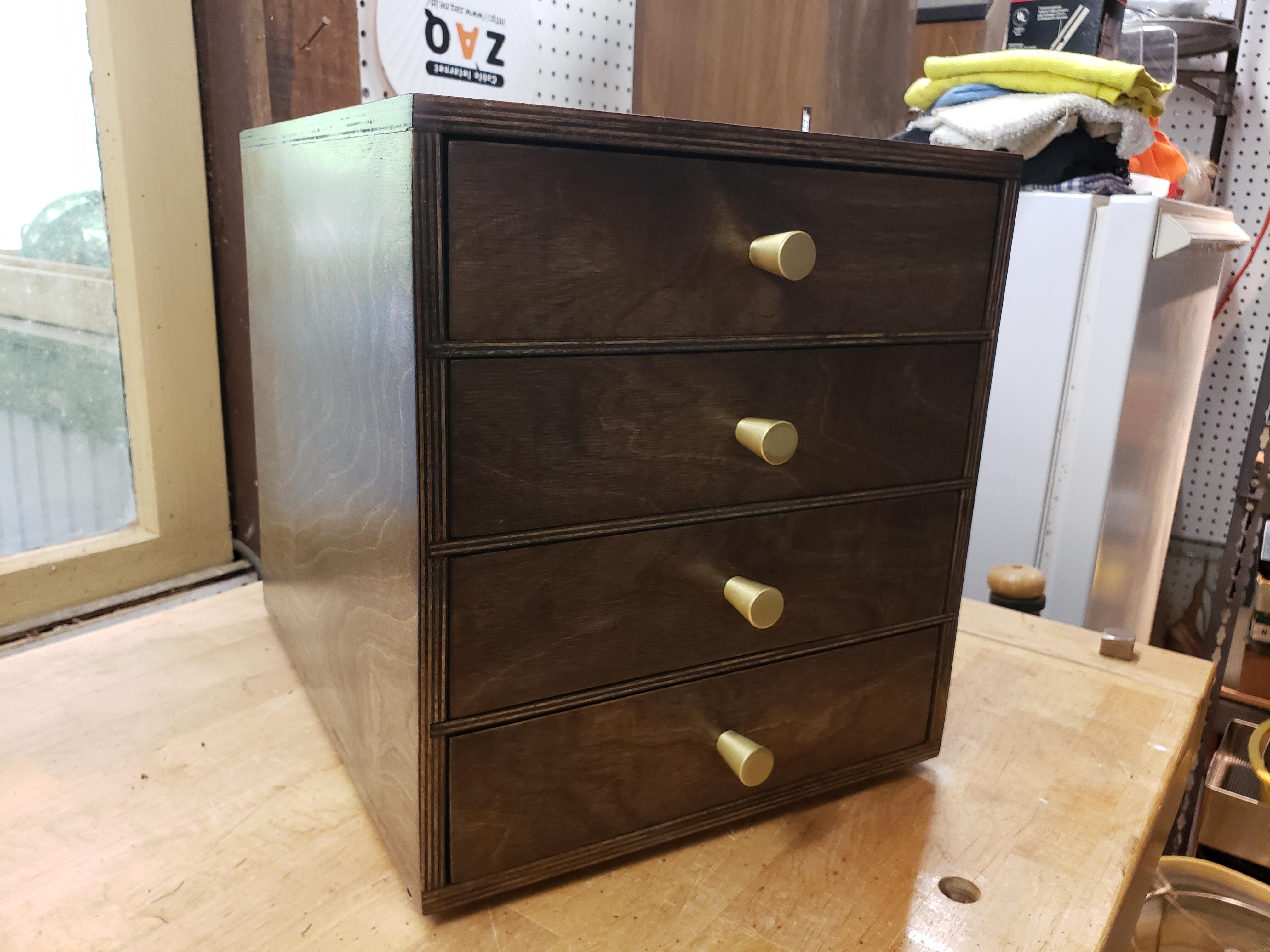

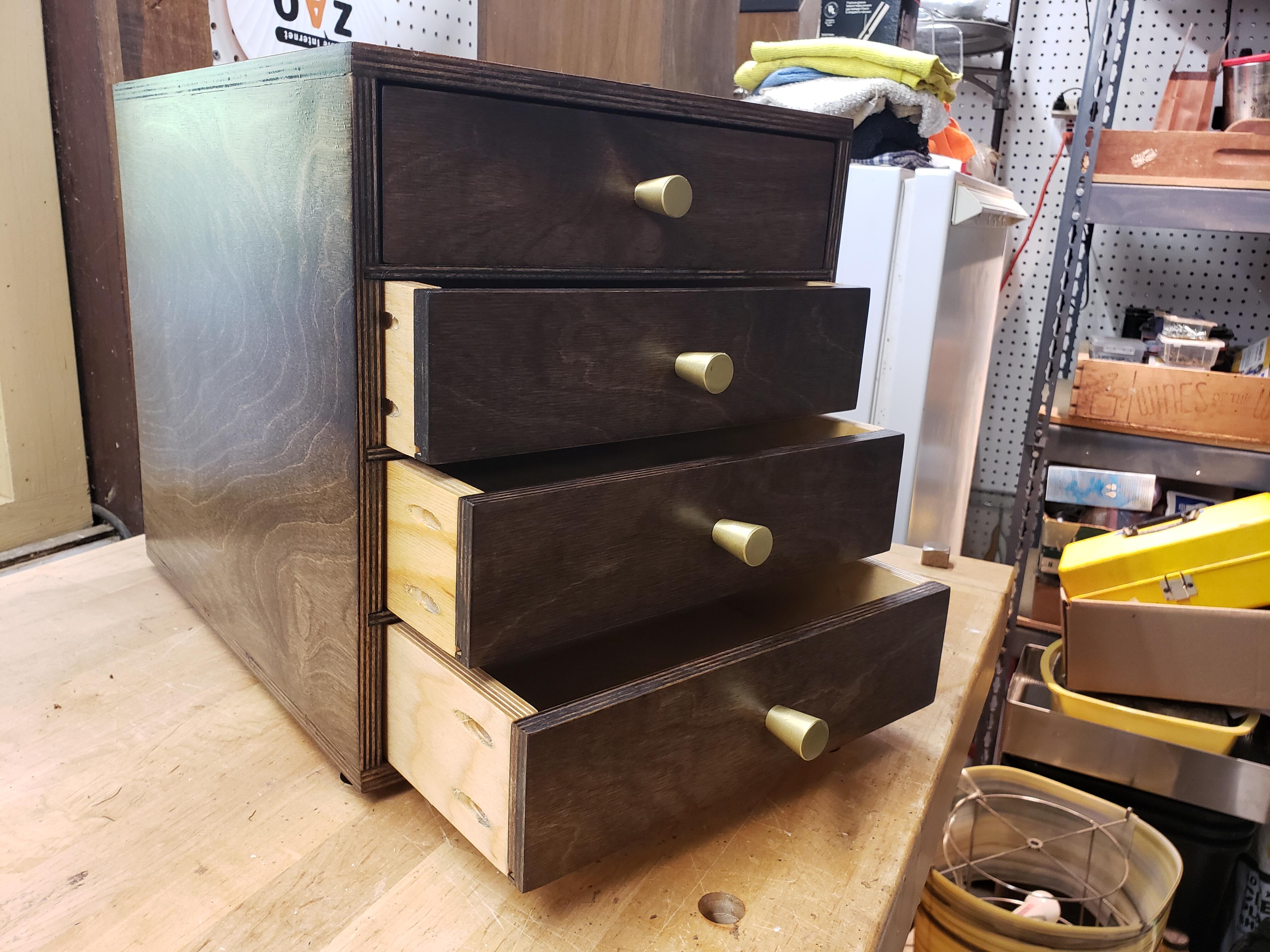

swt61 Posted July 20, 2021 Report Share Posted July 20, 2021 Construction complete on the incense box. First coat of boiled linseed oil applied. The shop assistant approves.Ā 9 Quote Link to comment Share on other sites More sharing options...

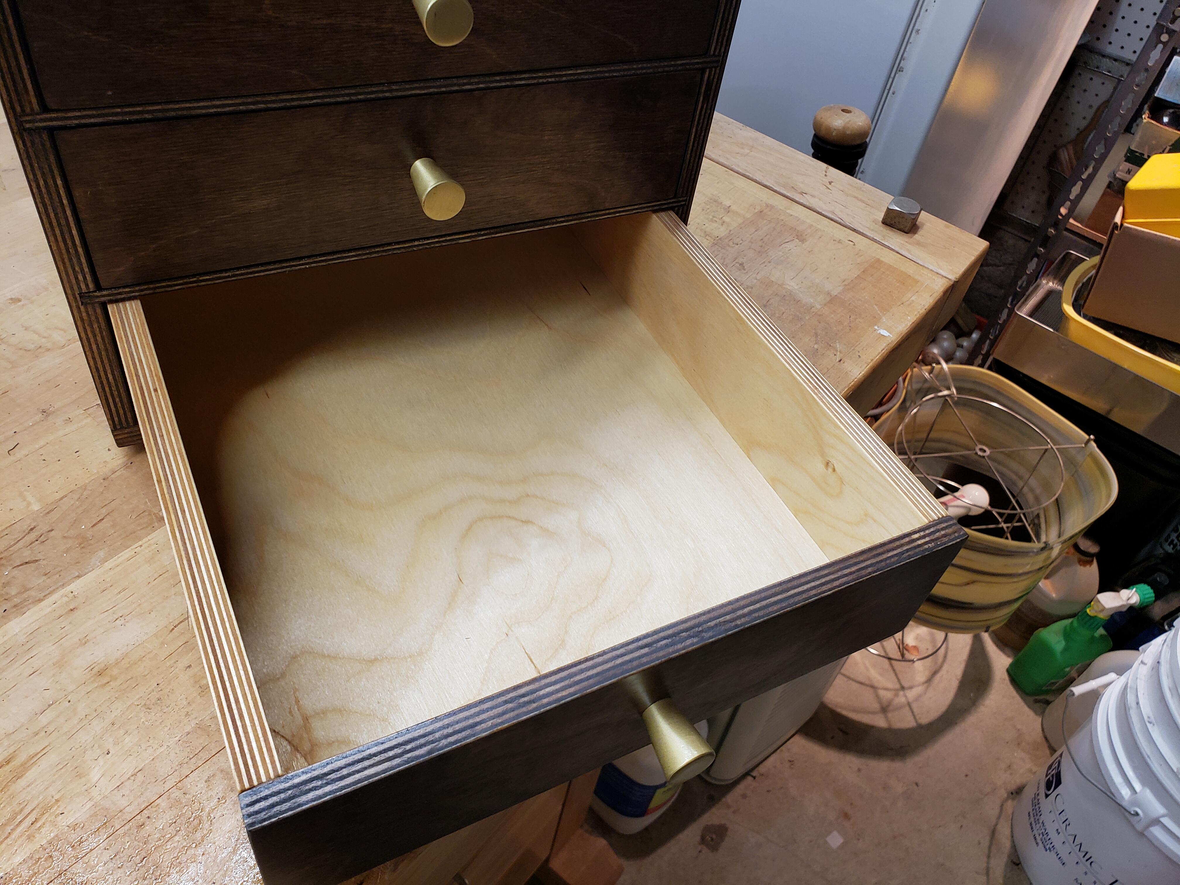

luvdunhill Posted July 20, 2021 Author Report Share Posted July 20, 2021 1 hour ago, swt61 said: Thanks. Fitz isn't looking at this thread, because he wants it to be a surprise when it arrives. I hope he likes it, as he just gave me the dimensions he wanted, and gave me free reign after that. Nice! Would some small adhesive Teflon tape or something on the bottom help the drawers slide in easier? It seems if you apply the pull or push force on the end of the drawer it might bind up? Quote Link to comment Share on other sites More sharing options...
dsavitsk Posted July 20, 2021 Report Share Posted July 20, 2021 53 minutes ago, luvdunhill said: Would some small adhesive Teflon tape or something on the bottom help the drawers slide in easier? Ā On 7/17/2021 at 1:25 PM, swt61 said: I have some drawer glide tape coming. This will attach to the bottom of the drawer sides and allow the drawers to slide with minimal friction. The box is too small for mechanical drawer glides. Ā Quote Link to comment Share on other sites More sharing options...
swt61 Posted July 20, 2021 Report Share Posted July 20, 2021 The drawers slide in and out easily now, even though I kept the tolerances tight. But as Doug pointed out, I have 1/64" thick glide tape coming. It's made out of the same thing as a butchers cutting board. That slick, White plastic. Quote Link to comment Share on other sites More sharing options...

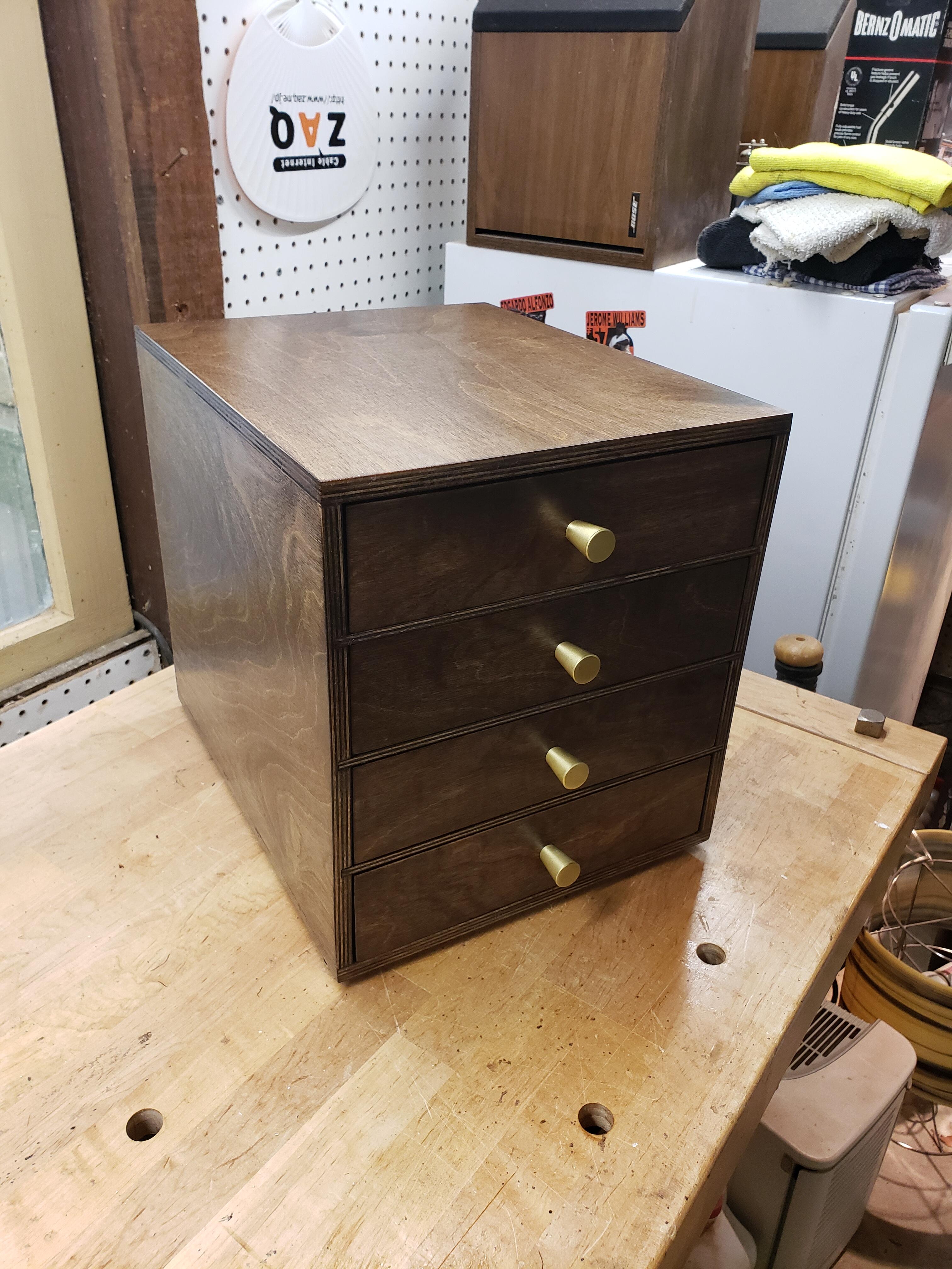

swt61 Posted July 22, 2021 Report Share Posted July 22, 2021 I'm pretty happy with the finished product. May it house many fine incense boxes. 18 Quote Link to comment Share on other sites More sharing options...
