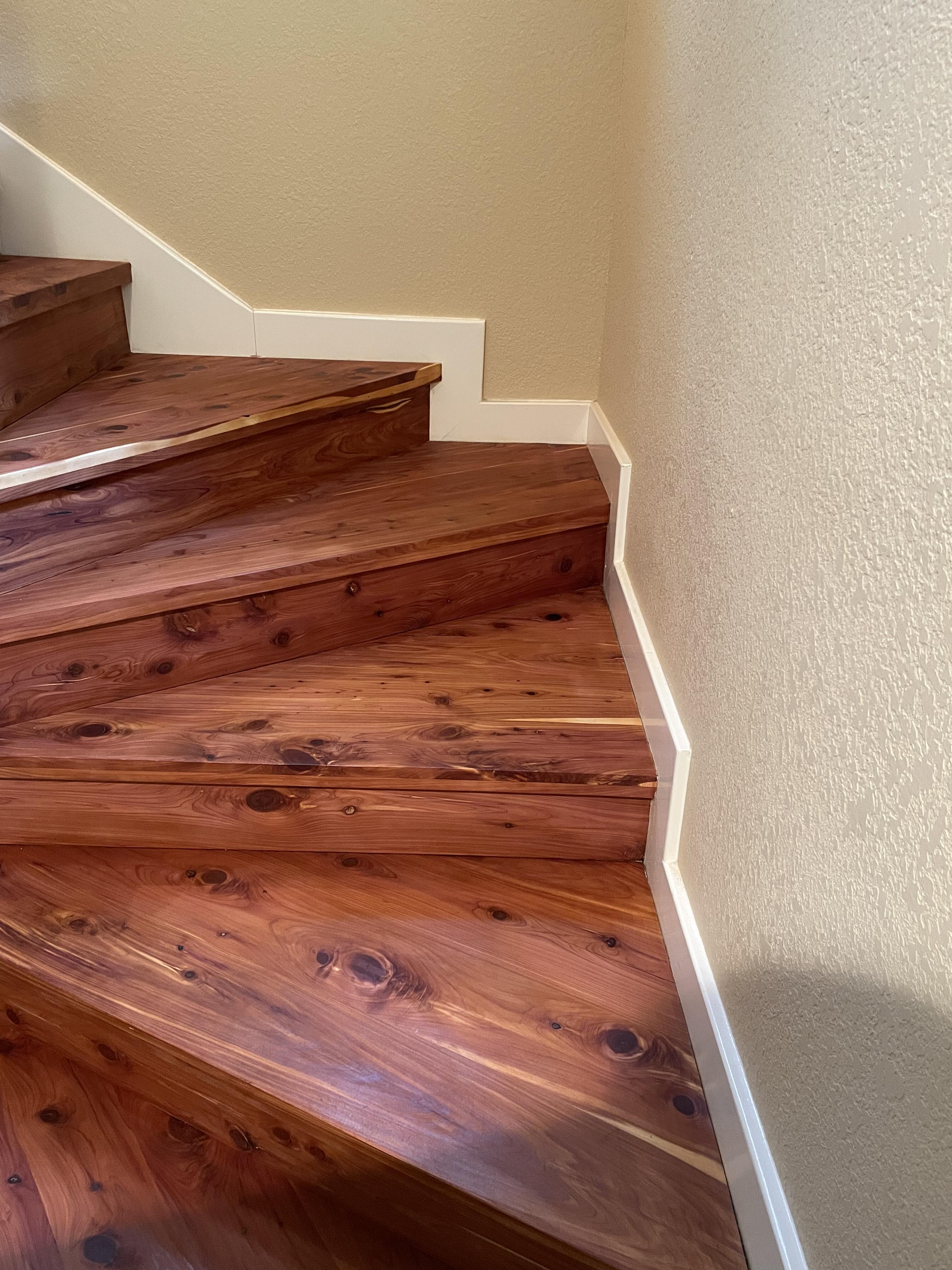

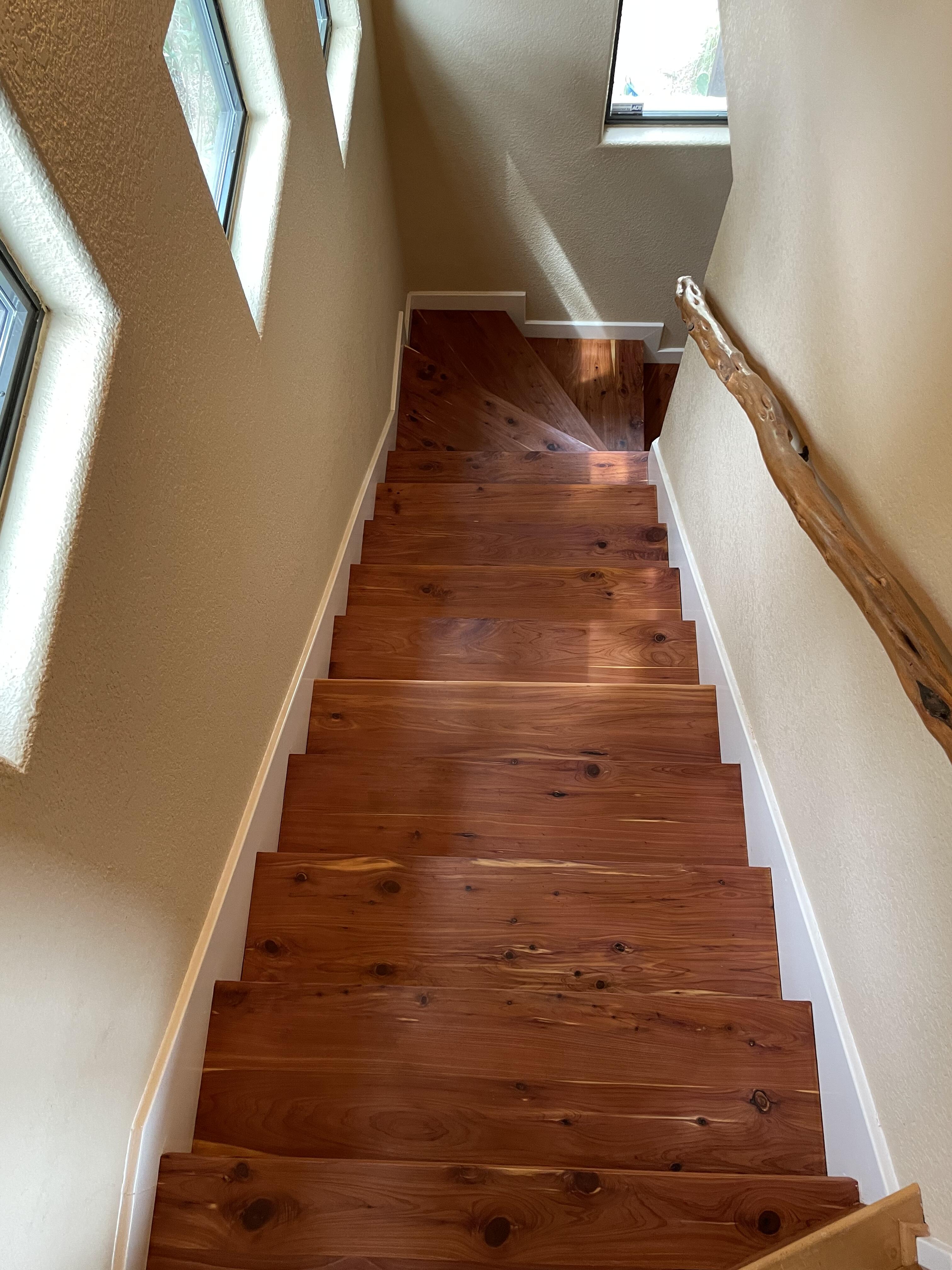

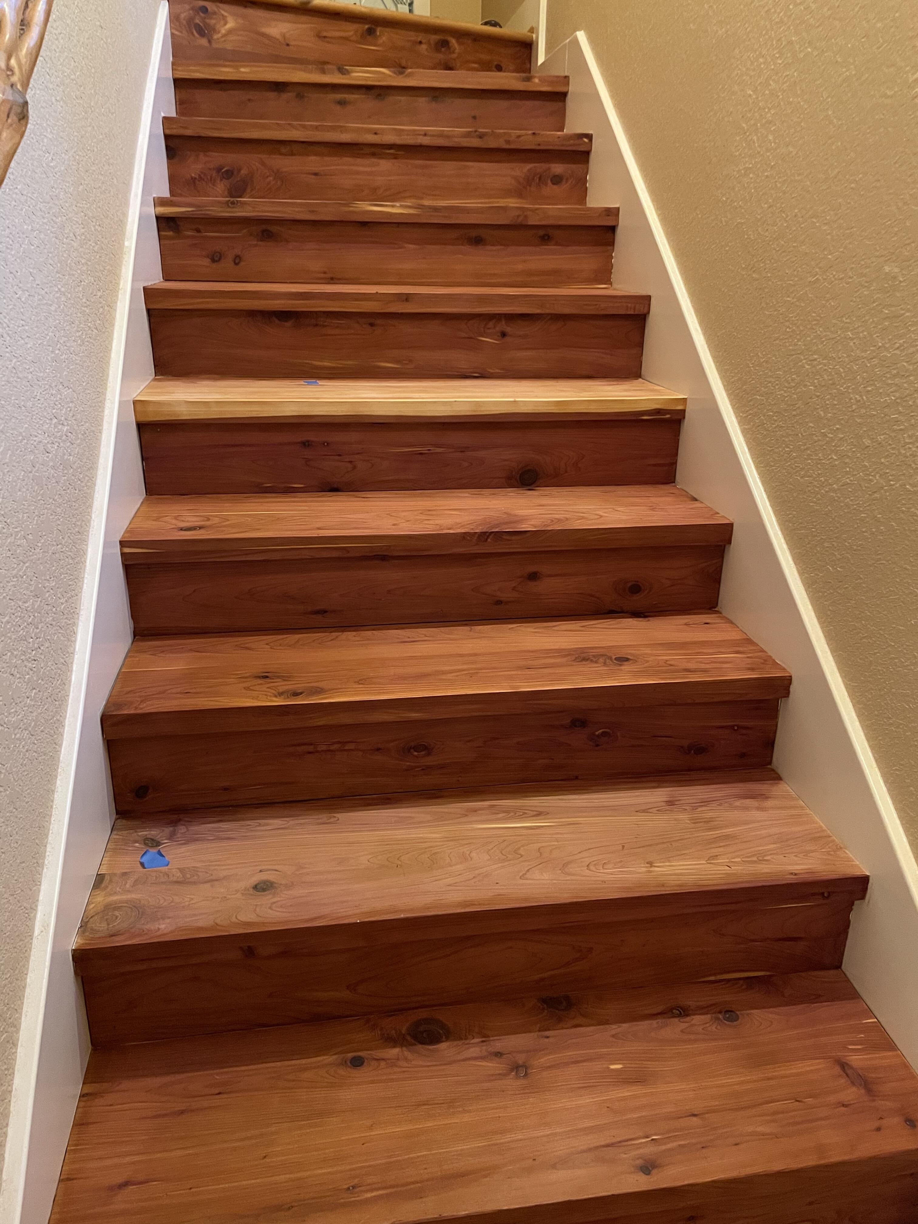

naamanf Posted June 25, 2021 Report Posted June 25, 2021 22 hours ago, luvdunhill said: Got the first coat of Osmo on these stairs - before, during and after… Looking good, that’s a lot to rub on. What version did you use? I’m looking to switch to pre-cat lacquer for most of the stuff I’m doing. Applying by hand and waiting just takes to long. For those that need a new safe saw, checkout out the Felder Kappa 550 with PCS. It’s only a couple more bucks than a SawStop 🙄 Quote
swt61 Posted June 25, 2021 Report Posted June 25, 2021 I've never seen Western Red Cedar stairs before, but they're kind of cool. Quote
luvdunhill Posted June 25, 2021 Author Report Posted June 25, 2021 13 minutes ago, naamanf said: Looking good, that’s a lot to rub on. What version did you use? I’m looking to switch to pre-cat lacquer for most of the stuff I’m doing. Applying by hand and waiting just takes to long. For those that need a new safe saw, checkout out the Felder Kappa 550 with PCS. It’s only a couple more bucks than a SawStop 🙄 I used the 1101 and planning on 3011 for the second coat. Quote
swt61 Posted June 25, 2021 Report Posted June 25, 2021 37 minutes ago, naamanf said: For those that need a new safe saw, checkout out the Felder Kappa 550 with PCS. It’s only a couple more bucks than a SawStop HAWT! Quote
Fitz Posted July 4, 2021 Report Posted July 4, 2021 I really love the occasional light strips in the wood, it's some great contrast. Quote

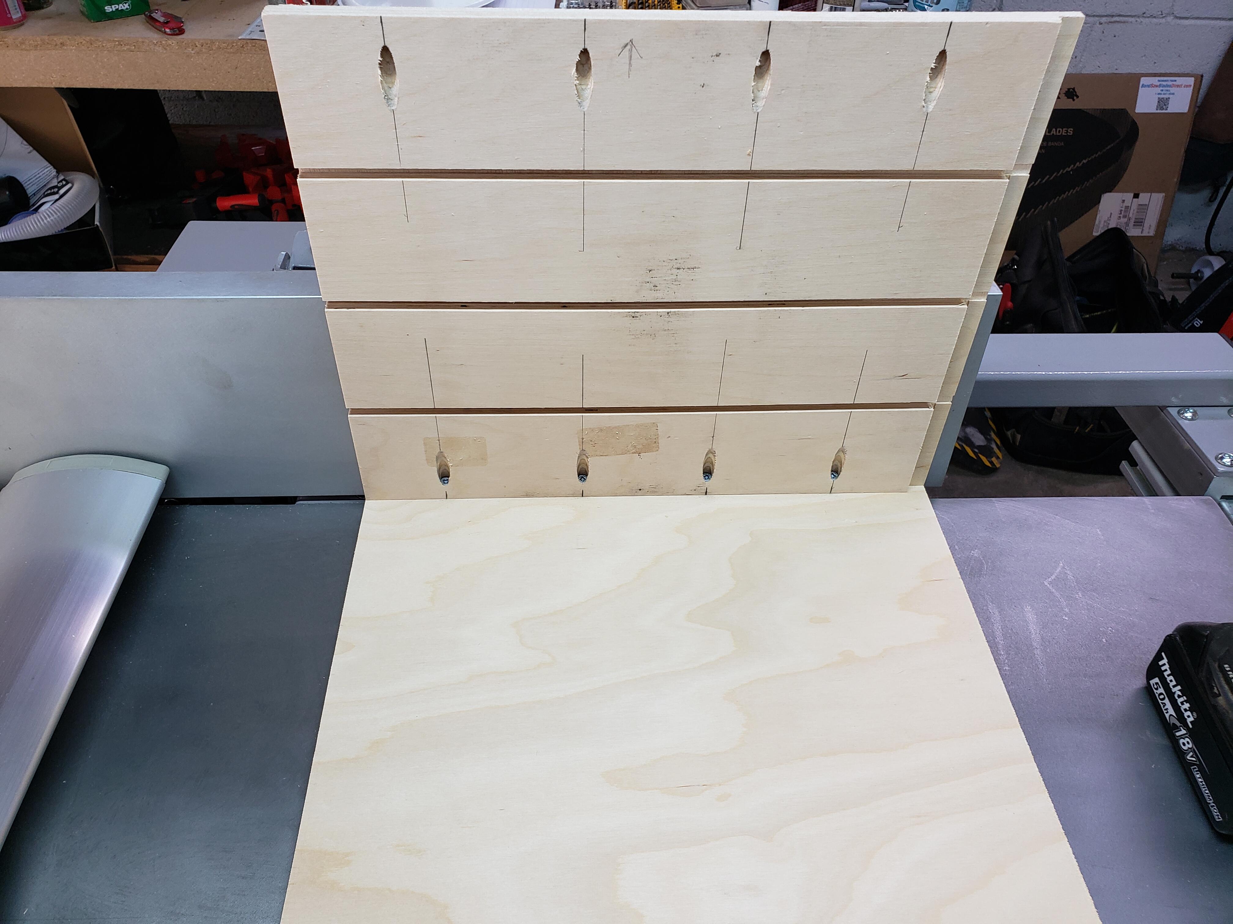

swt61 Posted July 15, 2021 Report Posted July 15, 2021 (edited) A small box, to house incense for Fitz. It will have 4 drawers. Going to highlight the plywood edges, and stain it all. Carcass is cut, glued and assembled with micro pocket screws. Edited July 15, 2021 by swt61 9 Quote
VPI Posted July 15, 2021 Report Posted July 15, 2021 I like the look of those corner clamps. I have tried several varieties and have not liked the results from any. How are those? Quote
swt61 Posted July 15, 2021 Report Posted July 15, 2021 (edited) They're pretty good. These are Al's. What I like is that you can snug them up, tweak the wood, then clamp tight. Edited July 15, 2021 by swt61 Quote

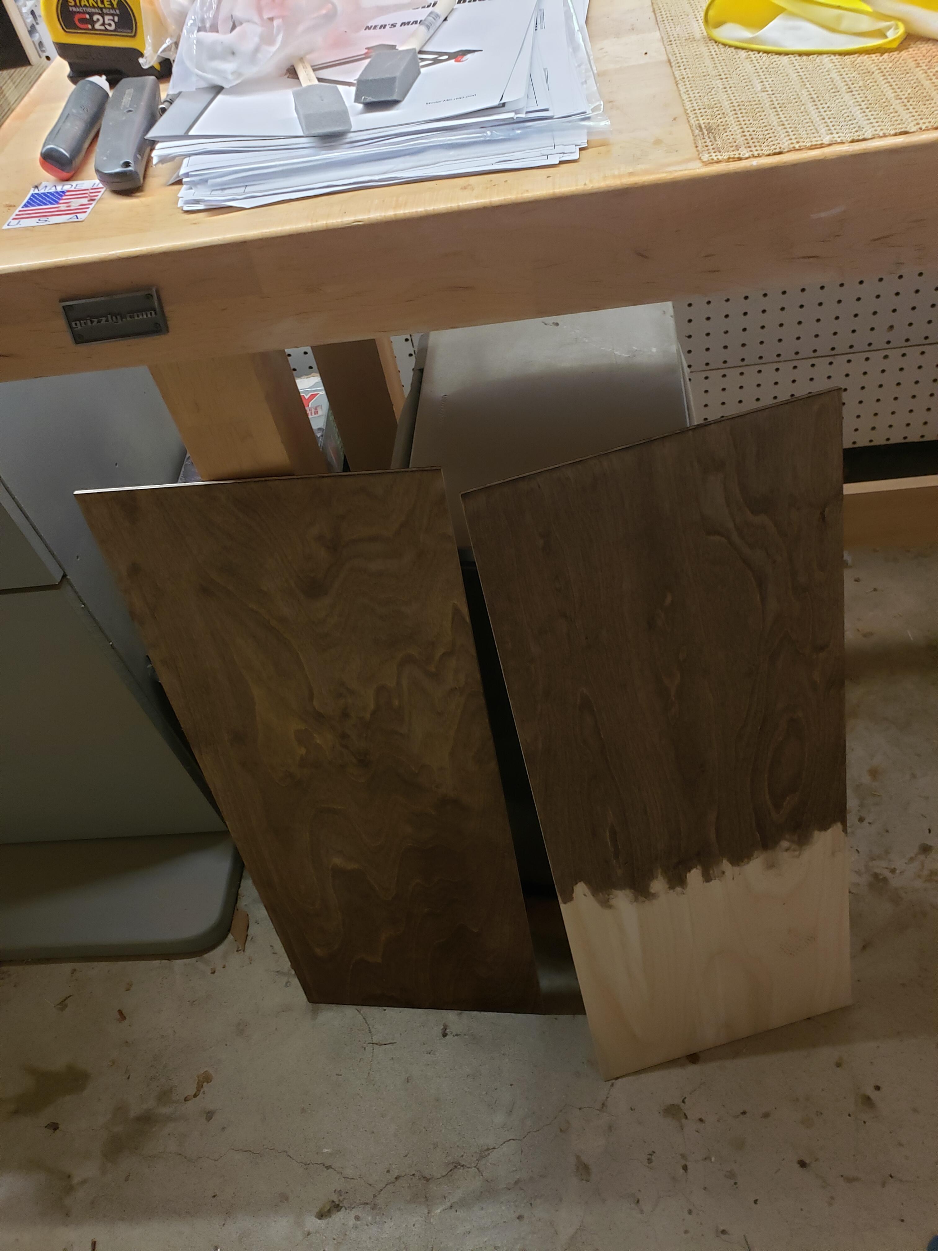

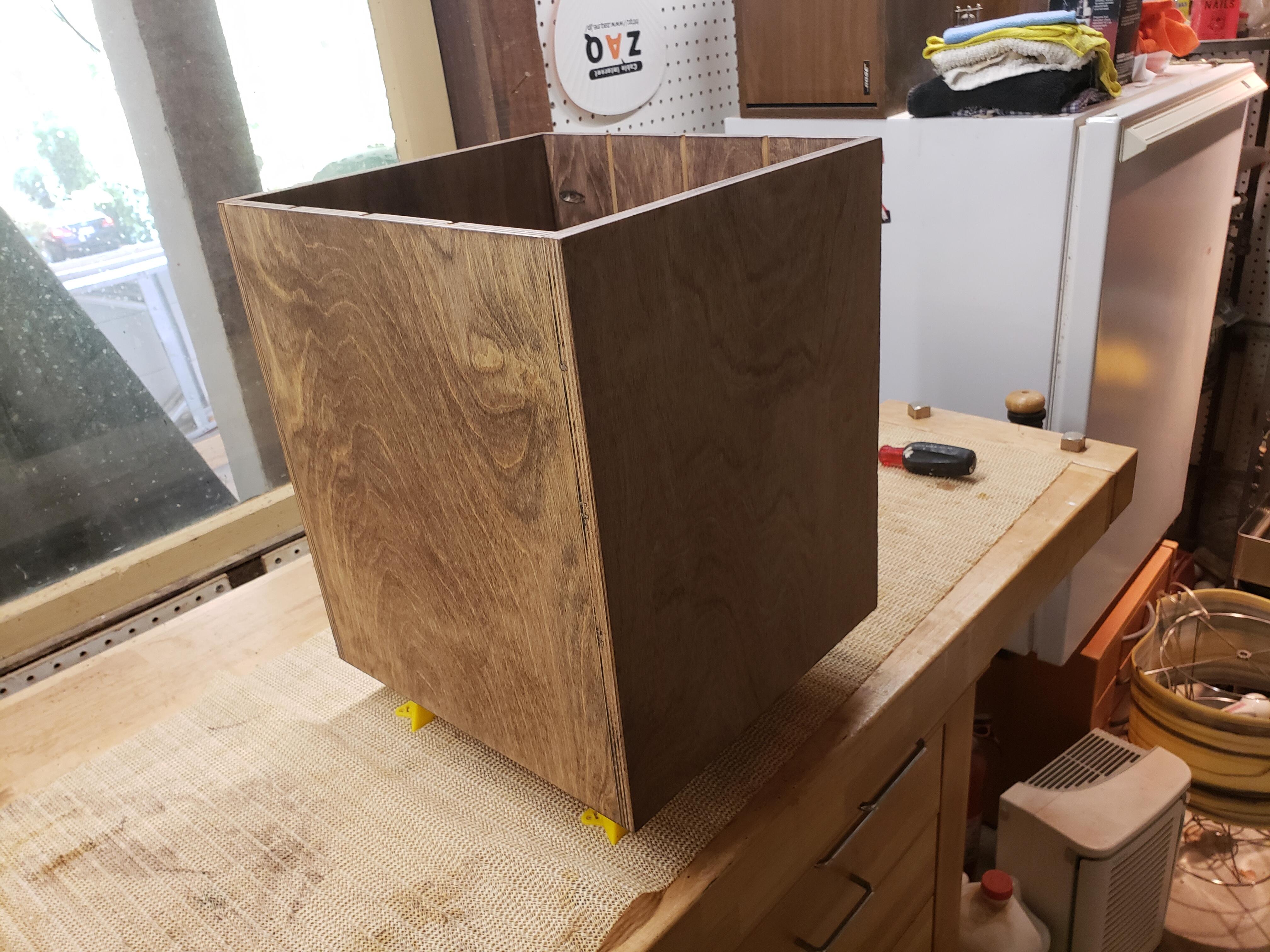

swt61 Posted July 16, 2021 Report Posted July 16, 2021 (edited) I wanted to stain the box, inside and out, before the drawer dividers made that almost impossible. I made sure to leave the datos stain free, so that I can get a good glue up on the dividers. Stained the 1/4" ply for the dividers as well. When I cut the dividers to fit, that will give me good unfinished edges for glue. I decided on Espresso. I think I may give it another coat once it dries. That'll require another day before I can get the dividers in, but I think a bit darker is what I'm looking for. Edited July 16, 2021 by swt61 11 Quote
swt61 Posted July 16, 2021 Report Posted July 16, 2021 Got the second coat on today. Just right. 6 Quote
