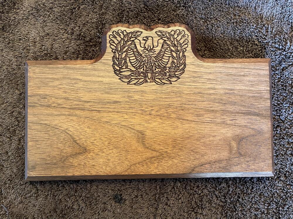

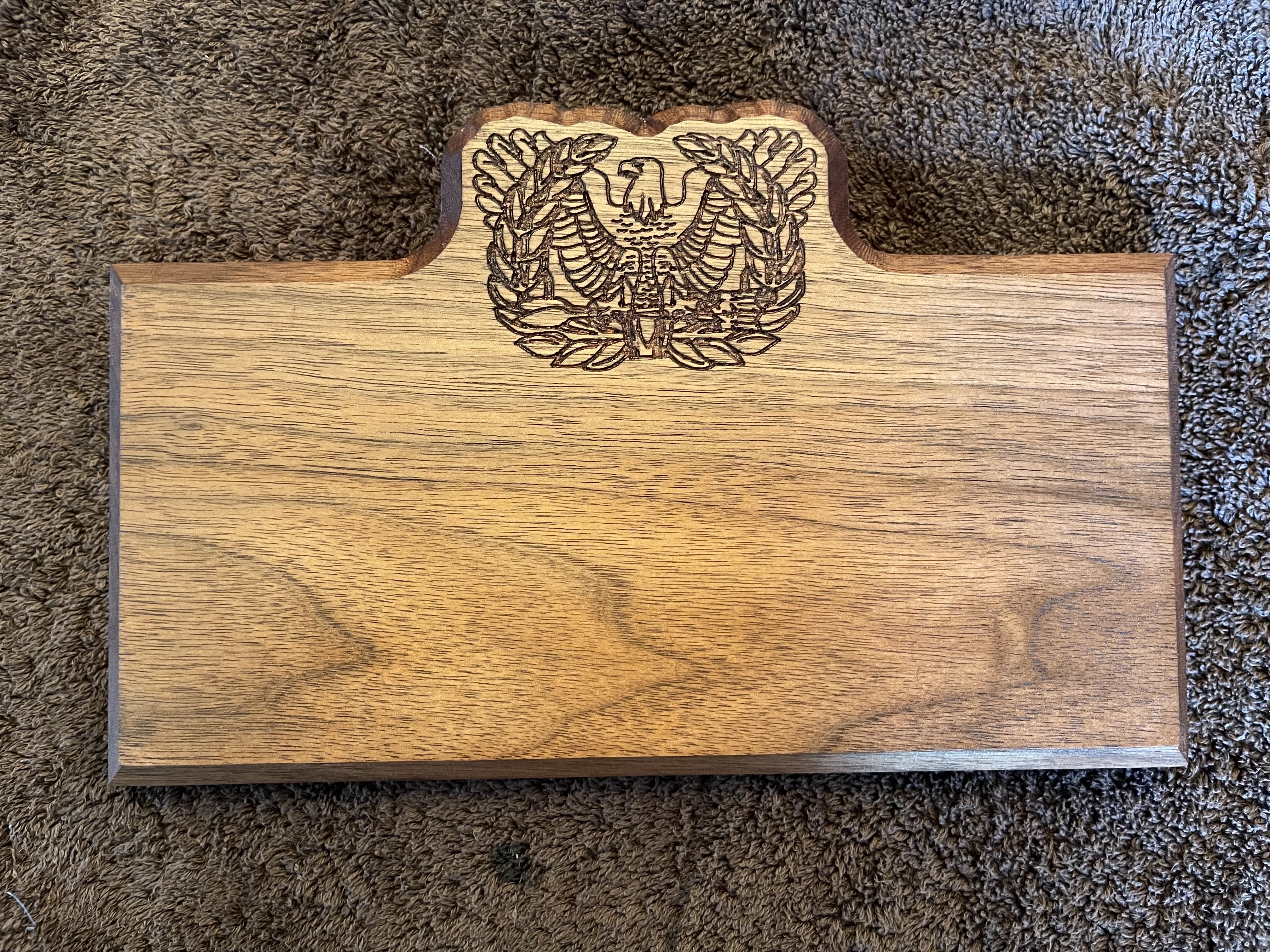

naamanf Posted May 25, 2021 Report Posted May 25, 2021 On 5/24/2021 at 11:51 AM, swt61 said: You may have a future career in glory hole manufacturing. Like most careers, you gotta deal with a lot of dickheads, but the demand is good. As long as I don’t have to test them I’m out. Made this little plaque, first time doing a small intricate V carve. I was a little worried it was going to be a tear-out disaster but it actually turned out well. 10

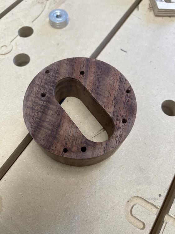

naamanf Posted June 3, 2021 Report Posted June 3, 2021 Marc sent me a really nice piece of figured walnut to turn into record player parts. Part is going to be 1.35” thick but board was 2.5”. Seemed to be a waste to machine/plane it down to the correct thickness. Nice finally having the right tools for the job. 9

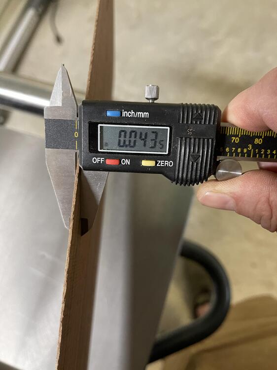

naamanf Posted June 3, 2021 Report Posted June 3, 2021 1 minute ago, Voltron said: Very nice. How thin are the veneers? Still need to run them rough the sander. Goal was to have them be 1/32 when finished. I’m sure I could go thinner but wanted to err on being thicker until I’m really good at resawing them. 6 1
swt61 Posted June 4, 2021 Report Posted June 4, 2021 Flippin' awesome! That is such a game changer to be able to resaw to that thickness! 1
naamanf Posted June 4, 2021 Report Posted June 4, 2021 19 hours ago, Voltron said: We're going to go thinner with the Hammer! Challenge accepted.
luvdunhill Posted June 4, 2021 Author Report Posted June 4, 2021 1 hour ago, naamanf said: Challenge accepted. How much do you loose due to the blade to dust?
dsavitsk Posted June 4, 2021 Report Posted June 4, 2021 (edited) 47 minutes ago, luvdunhill said: How much do you loose due to the blade to dust? none at a veneer factory as it is done with slicing blades Edited June 4, 2021 by dsavitsk 2

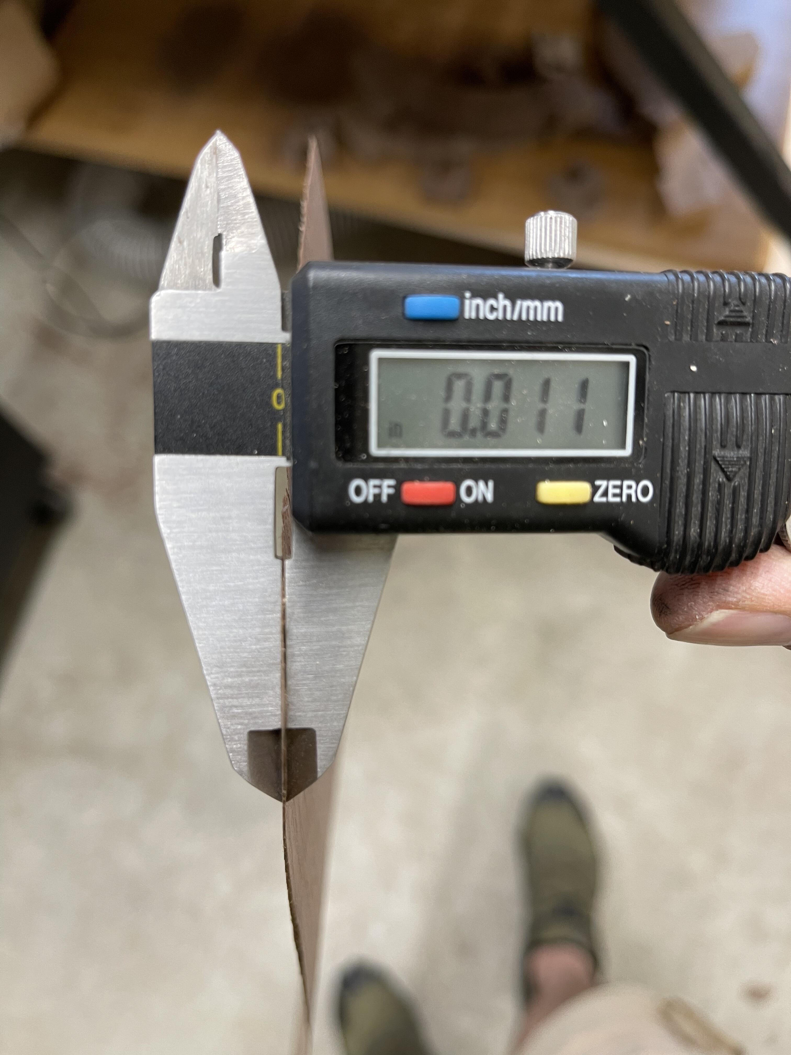

naamanf Posted June 7, 2021 Report Posted June 7, 2021 Made some footers for Marc and some sheets of walnut paper. 6
luvdunhill Posted June 7, 2021 Author Report Posted June 7, 2021 Wow that’s great! We need a video of the paper making! Do you need both sides of the board to be parallel before you put it through the bandsaw?
naamanf Posted June 7, 2021 Report Posted June 7, 2021 15 minutes ago, luvdunhill said: Wow that’s great! We need a video of the paper making! Do you need both sides of the board to be parallel before you put it through the bandsaw? Just one side. Running the blade right up to the stock fence. I really need to make a resaw fence. 3

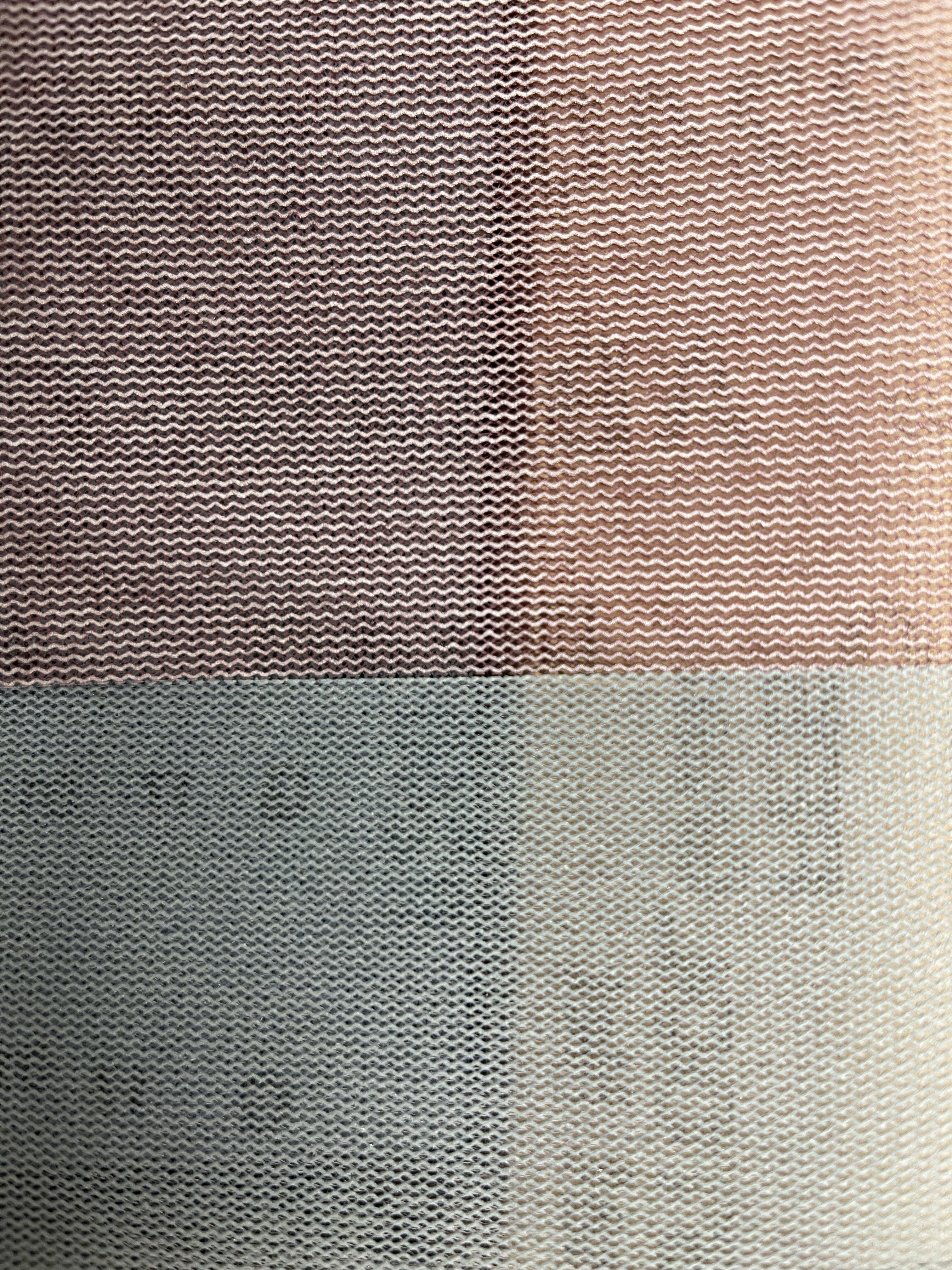

naamanf Posted June 11, 2021 Report Posted June 11, 2021 Going to give the nod to the Mirka paper, it’s a little thicker, the Festool version just doesn’t hold up as well to edges and rips easier. Thought If having to sand on edges or corners, neither is the way to go. 2
