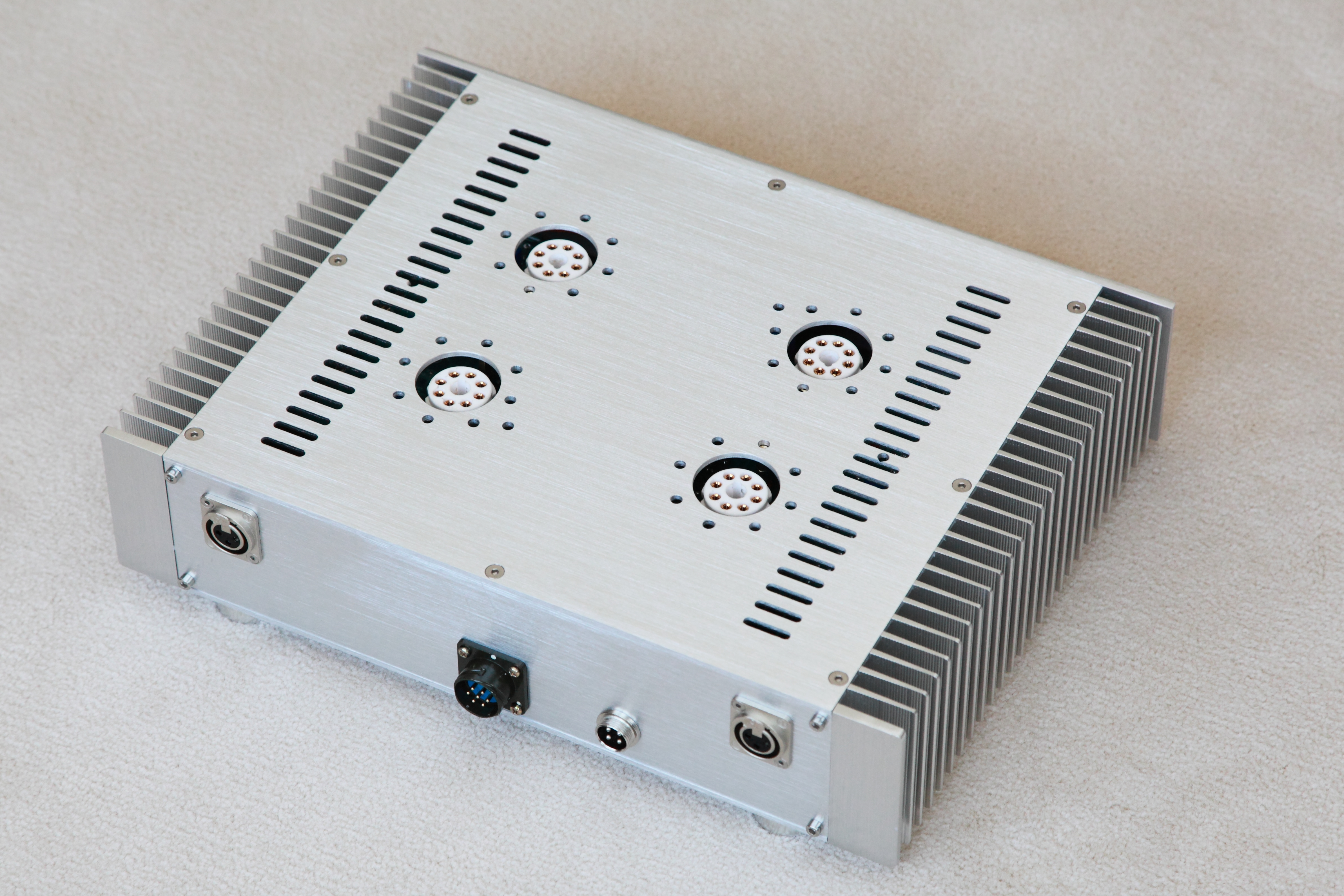

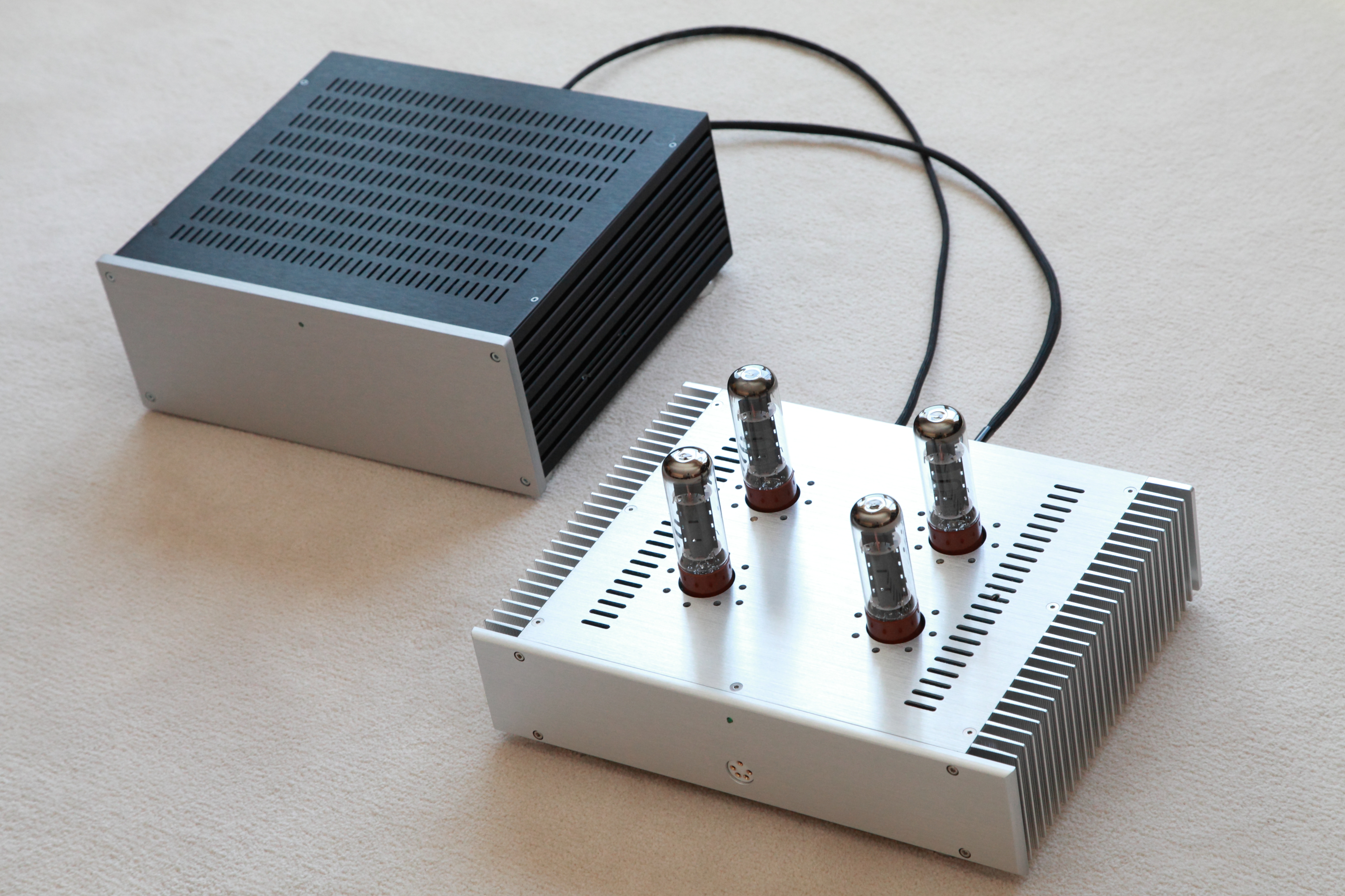

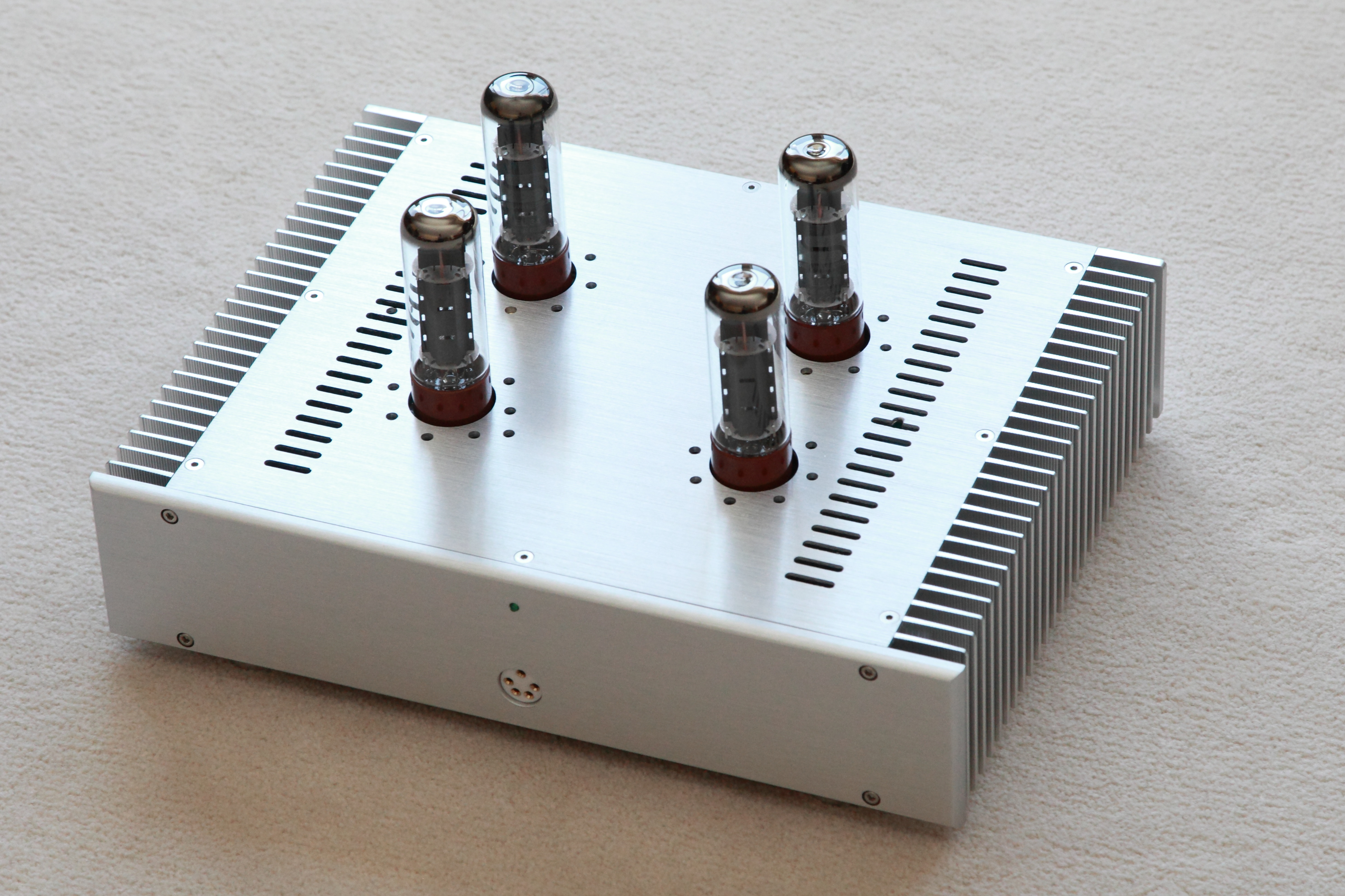

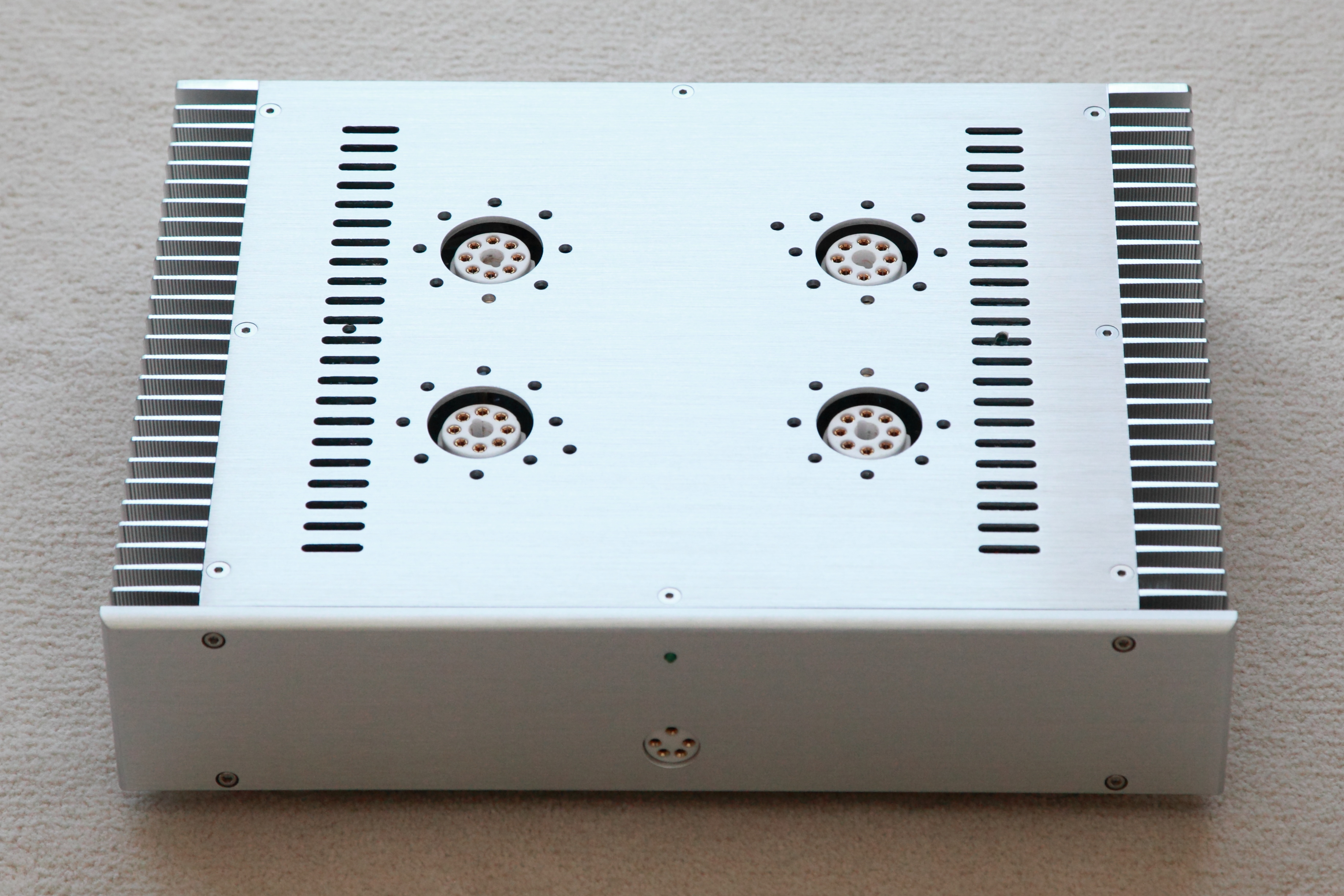

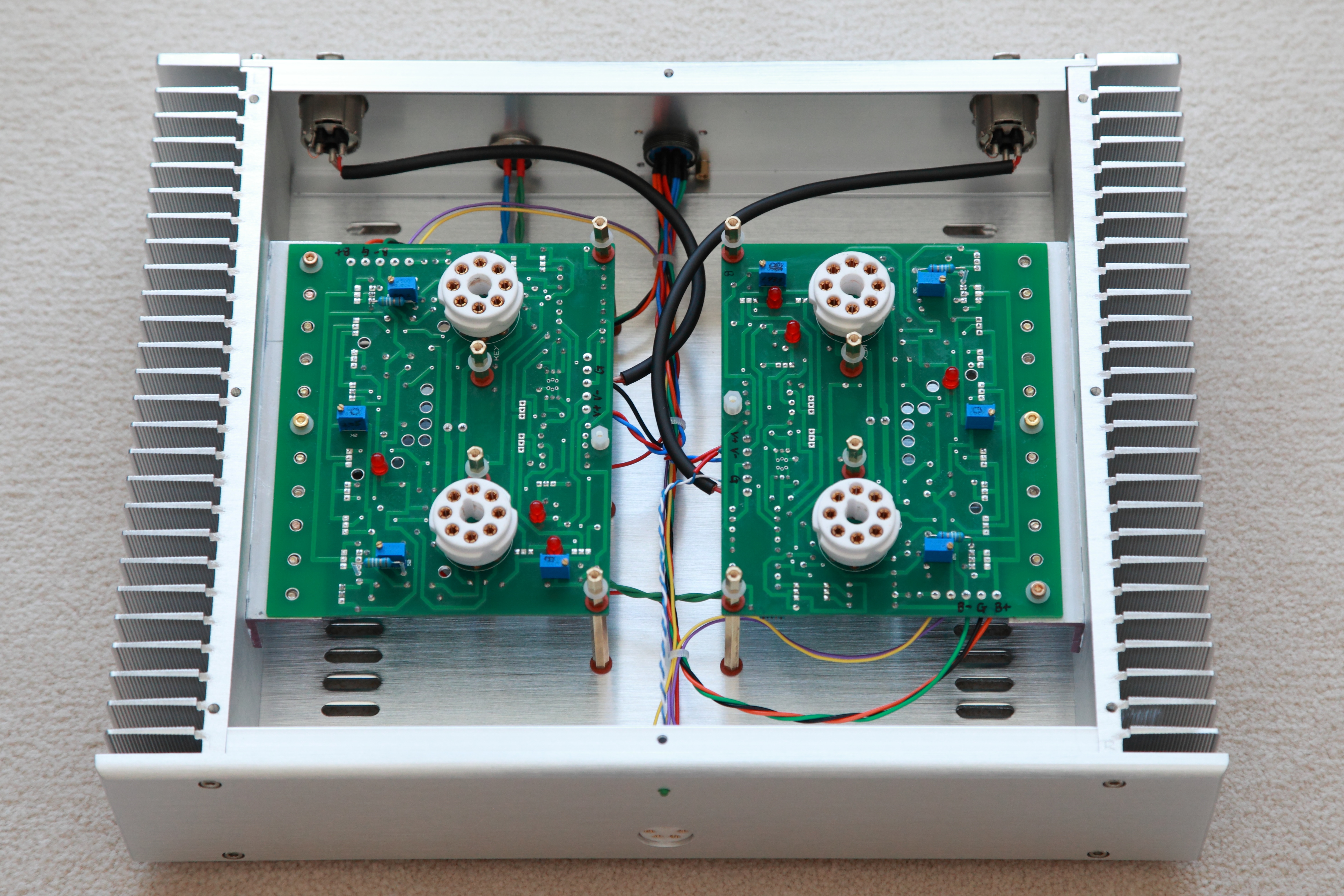

mwl168 Posted February 5, 2017 Report Posted February 5, 2017 (edited) FinallyĀ finished casing my Blue Hawaii today. Running on my "universal" PSU that also powers my HV Carbon. 400VDC and 18VDCĀ rails,Ā 20mA plate current. The heatsinks warmĀ up to about 42C (108F) and stabilize, about 22C (40F) rise from ambient temperature. Ā Ā The chassis is a Breeze Audio 3608A, one of 5 chassis I bought from Breeze Audio at TaoBao. I requested that the front and rear panels be left plane, un-drilled. Works quite well.Ā Ā Edited February 5, 2017 by mwl168 18 Quote
JoaMat Posted February 5, 2017 Report Posted February 5, 2017 Very nice! Low voltage +/-18 volts, right? 1 Quote
mwl168 Posted February 5, 2017 Report Posted February 5, 2017 Yes, the GRLV 18VDC rails are for the 2SK170 front-end. Quote
Rossliew Posted February 6, 2017 Report Posted February 6, 2017 Hows the amp sounding compared to your Carbon? Quote

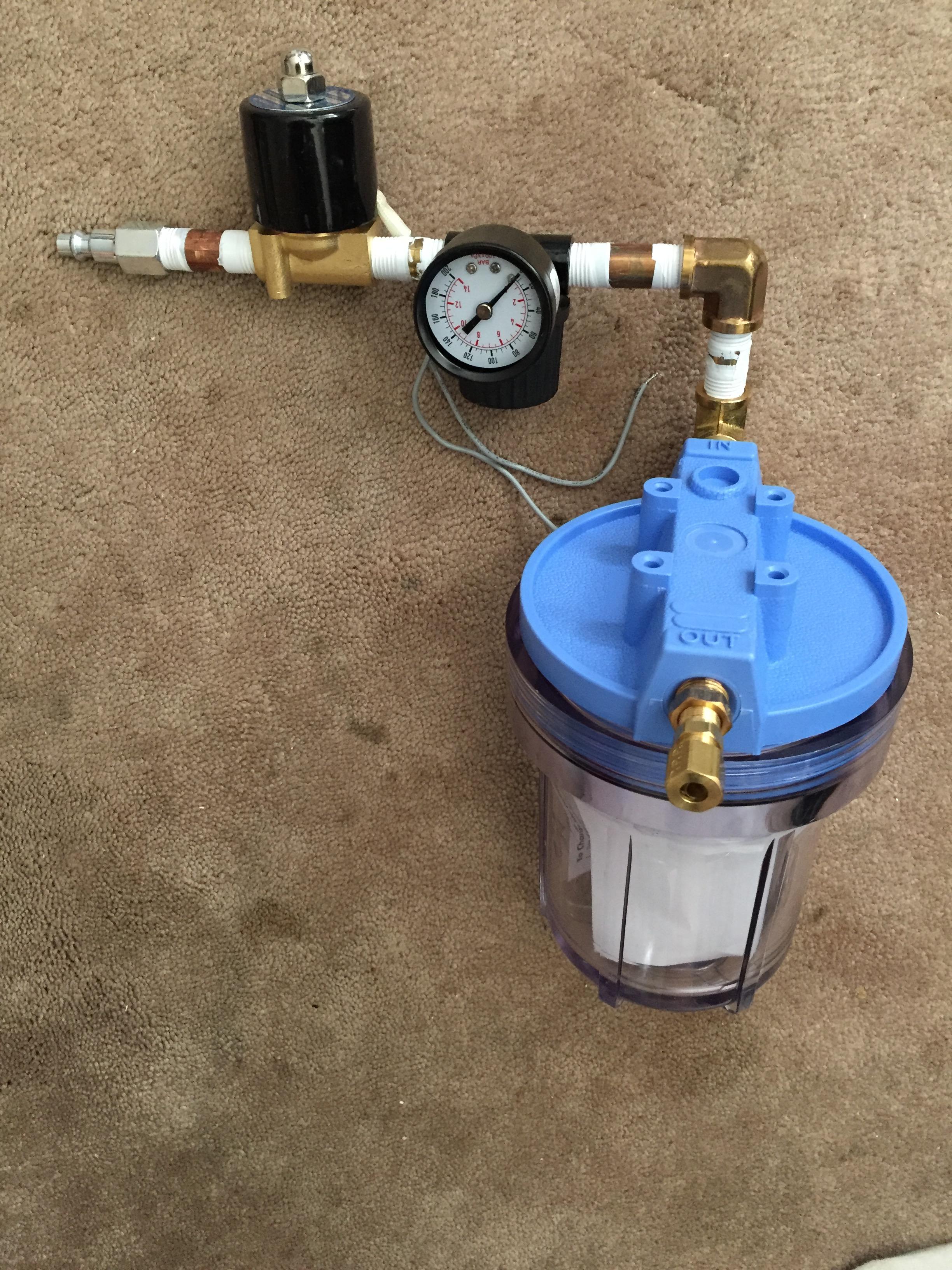

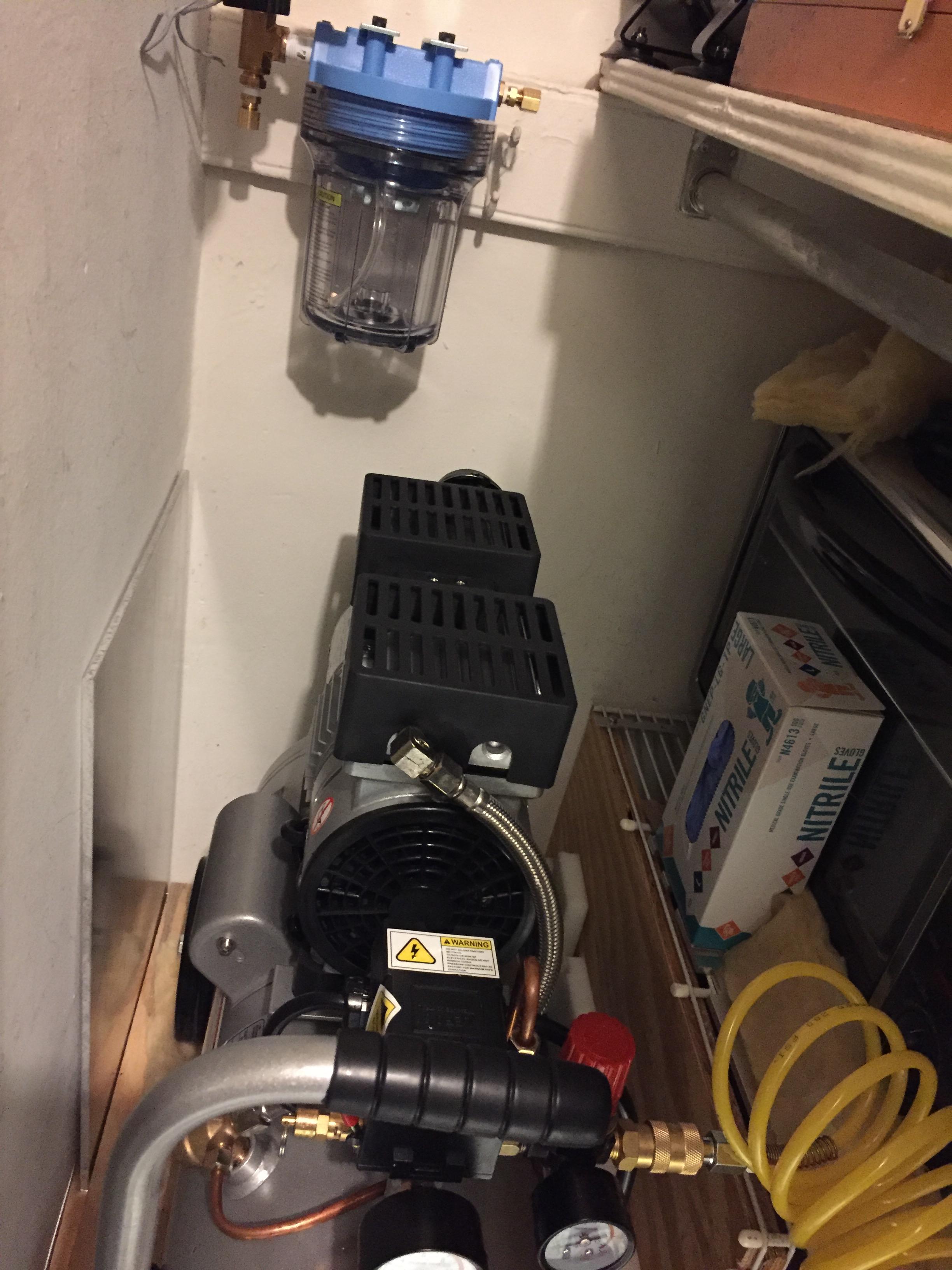

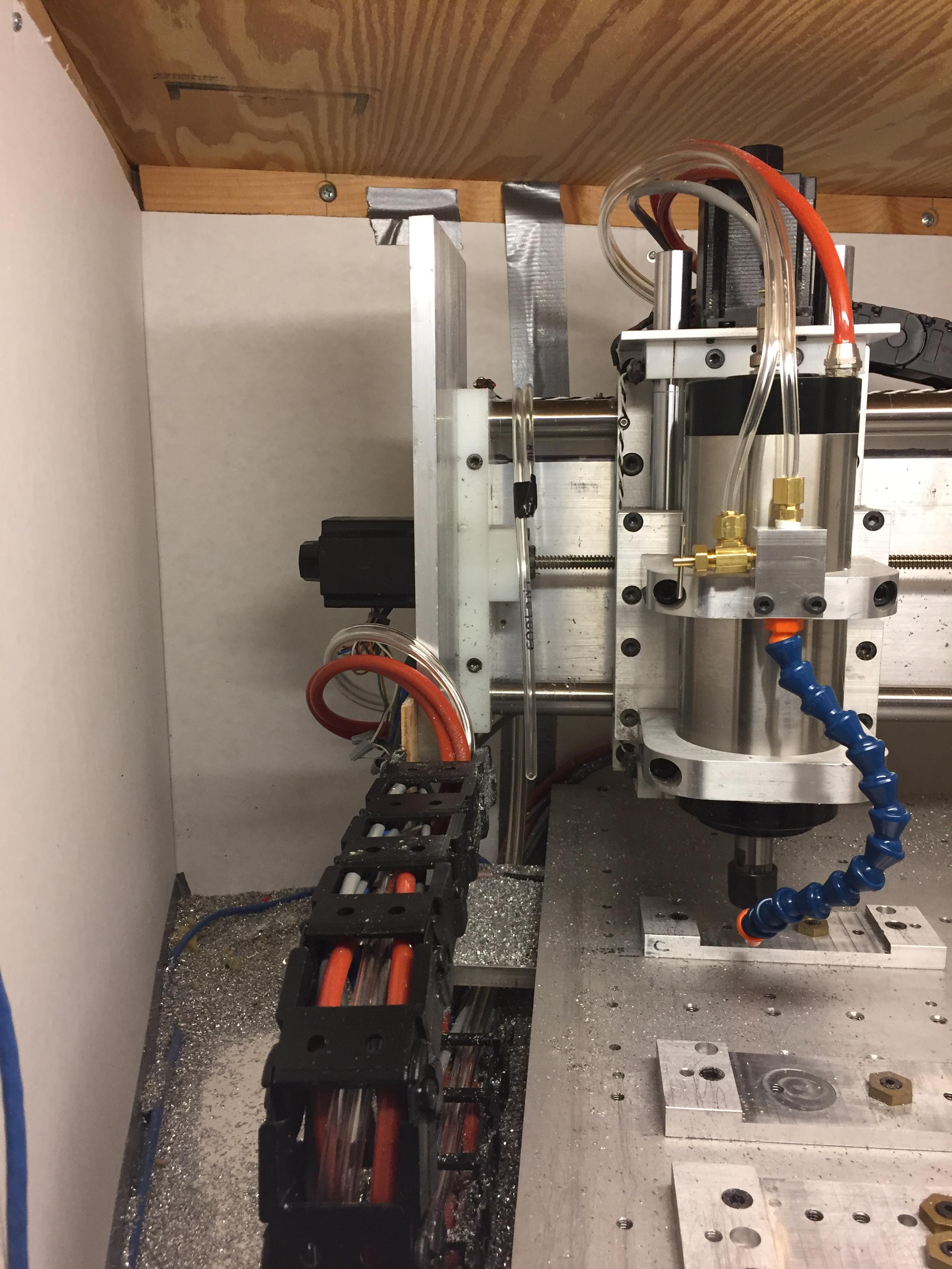

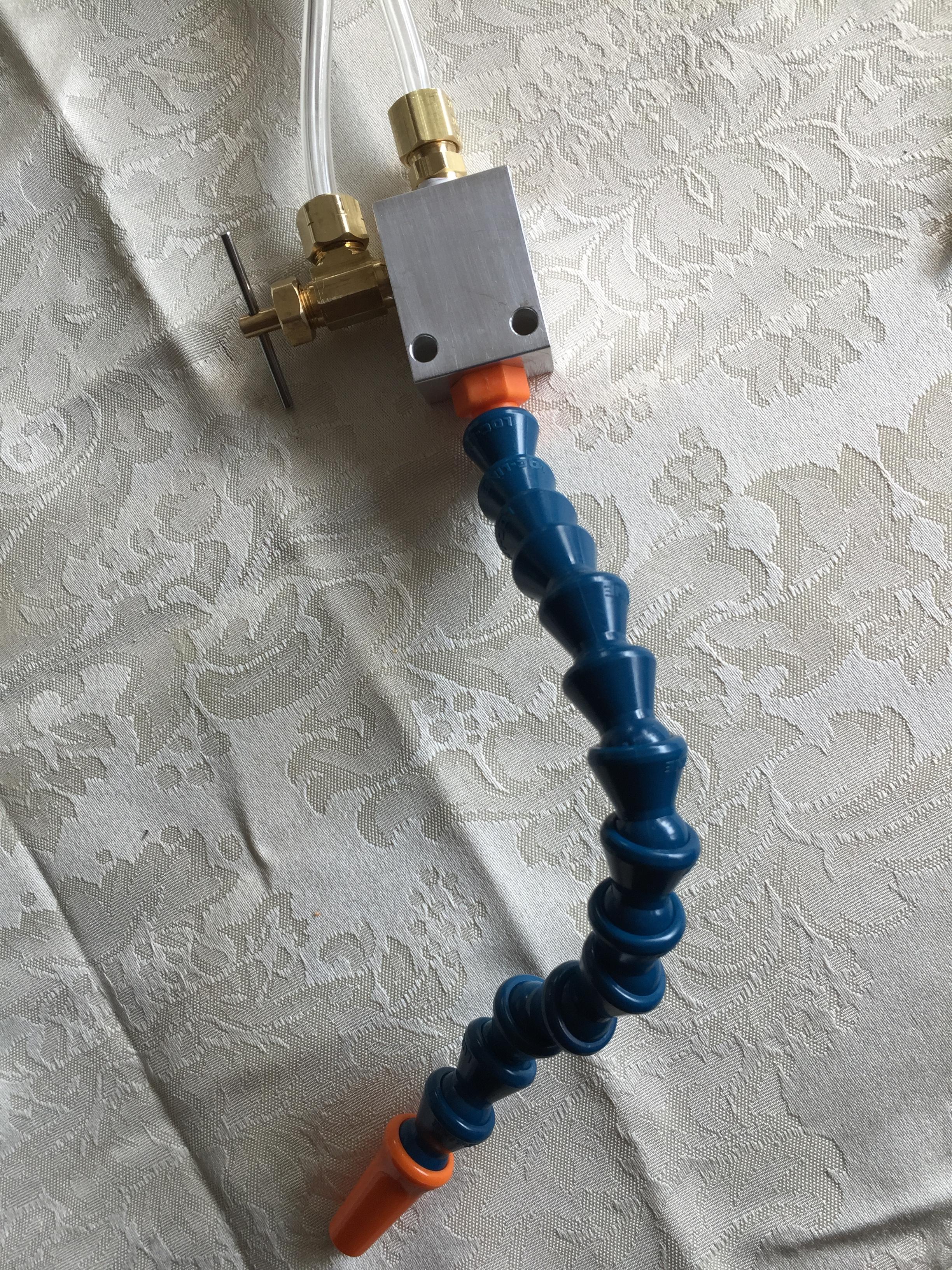

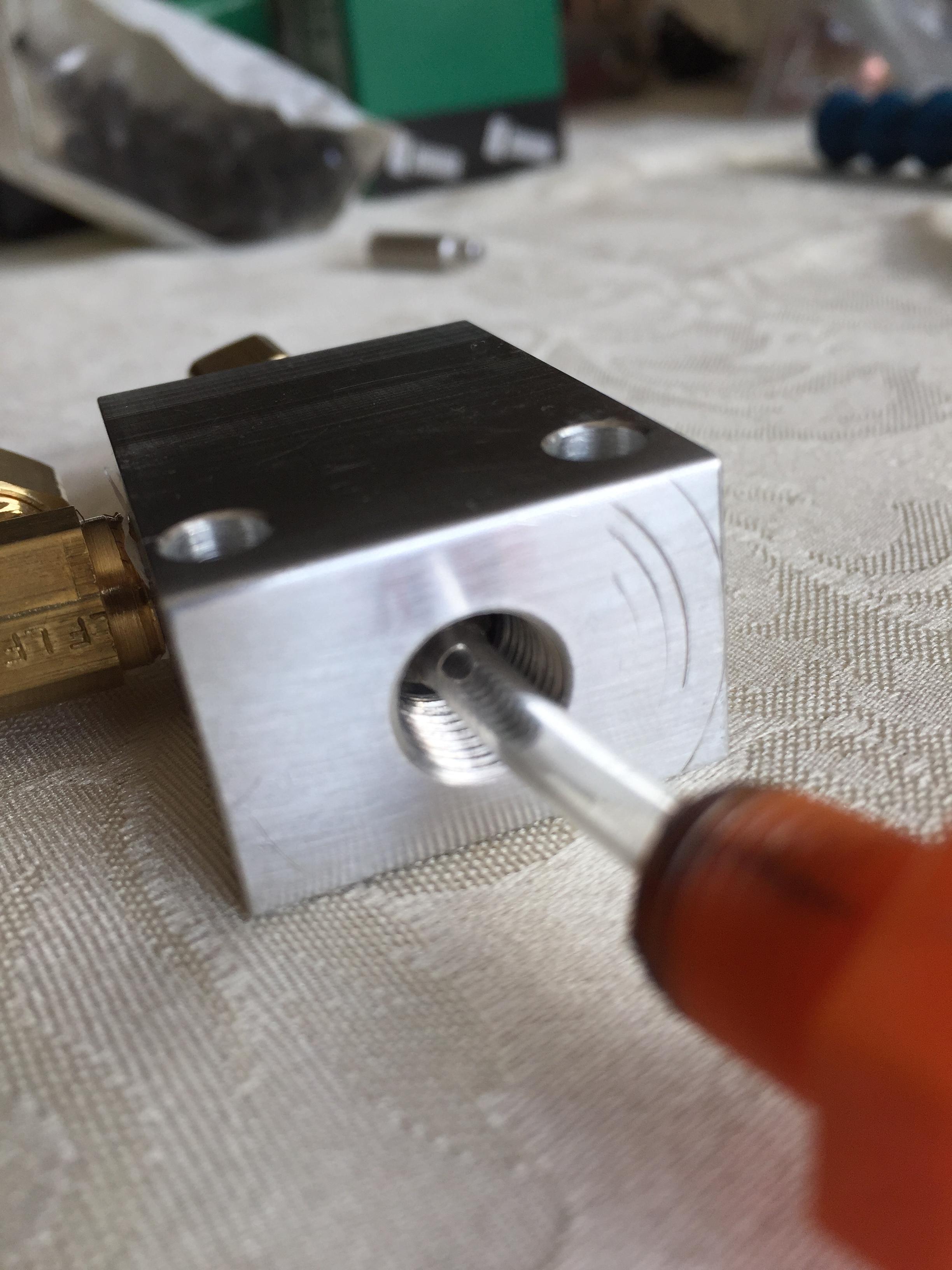

Kerry Posted February 6, 2017 Report Posted February 6, 2017 Fogless misting system for my mill Ā I'll be able to turn this on and off from the milling software via the solenoid on the left (below) 15 Quote
