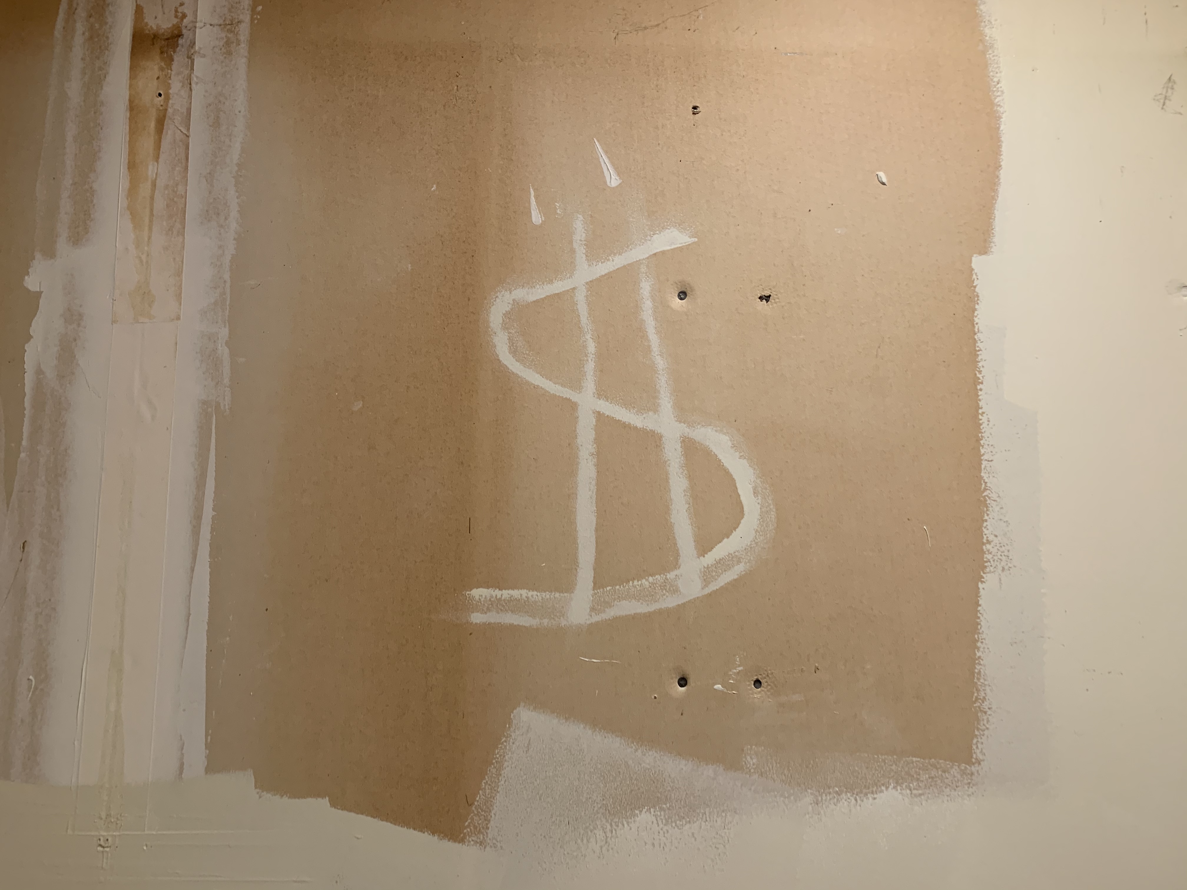

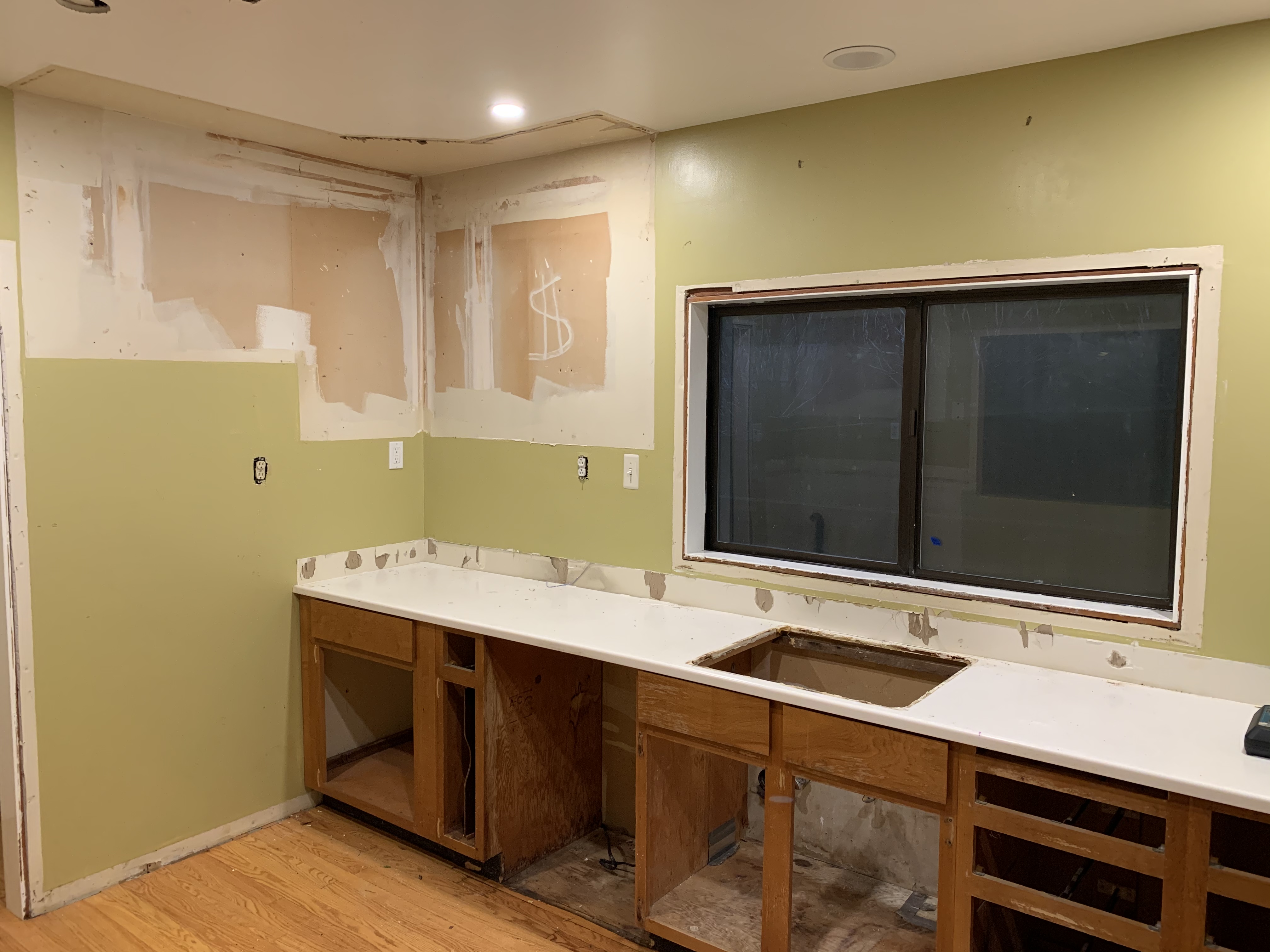

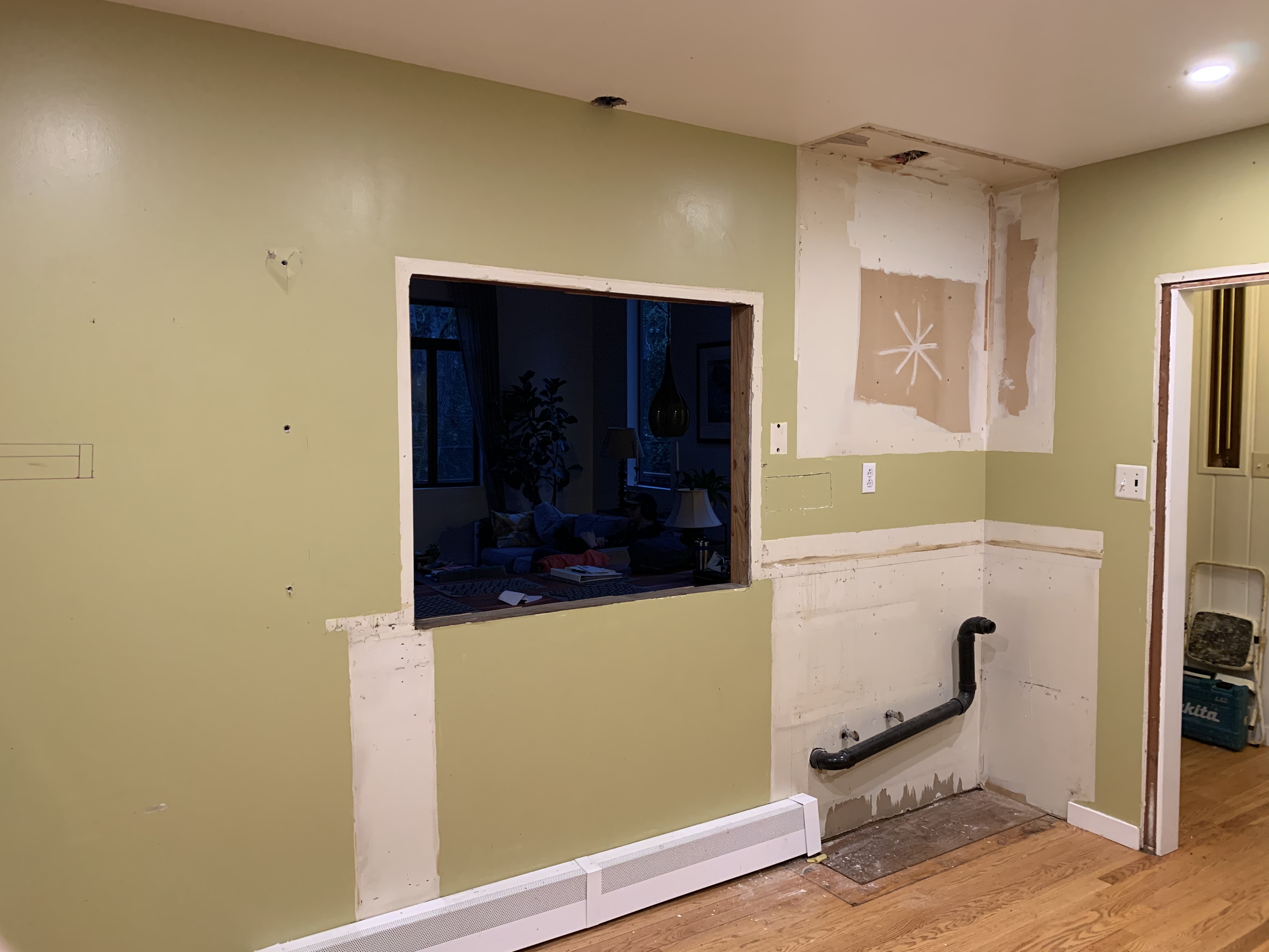

Voltron Posted February 16, 2021 Report Posted February 16, 2021 (edited) I didn't build shit today, I took it apart. Forgot the before shots but there were lots more cabinets in there. Along with some potentially anti Semitic graffiti. Edited February 16, 2021 by Voltron 4 Quote

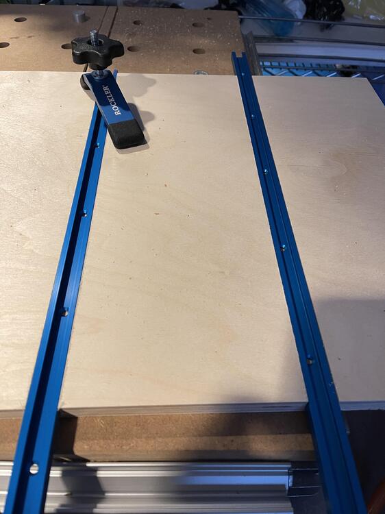

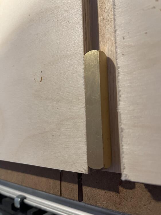

VPI Posted February 16, 2021 Report Posted February 16, 2021 Made the mistake of trying to work my way up to 3/8” on the first one to make sure I did not big it down and my failures in fractions left the rail just below the surface. Just did the full 3/8 on the second one and it is perfect. Not sure if I need a 1/16”ish shim under the first one or not. 3 Quote

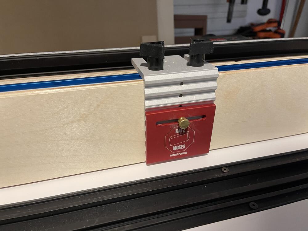

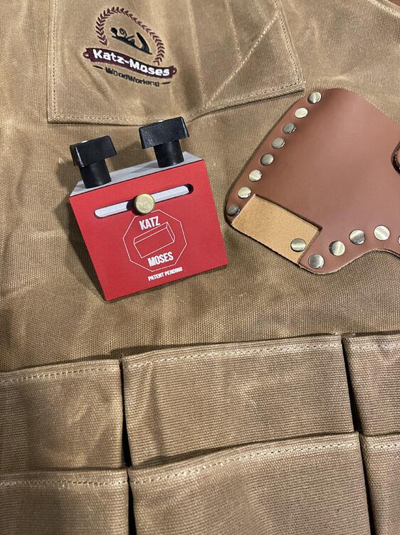

VPI Posted February 16, 2021 Report Posted February 16, 2021 And my Katz Moses stop blocks and apronlet showed up just in time to get this all built up. 3 Quote

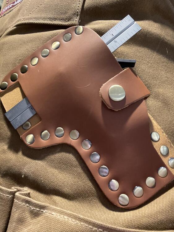

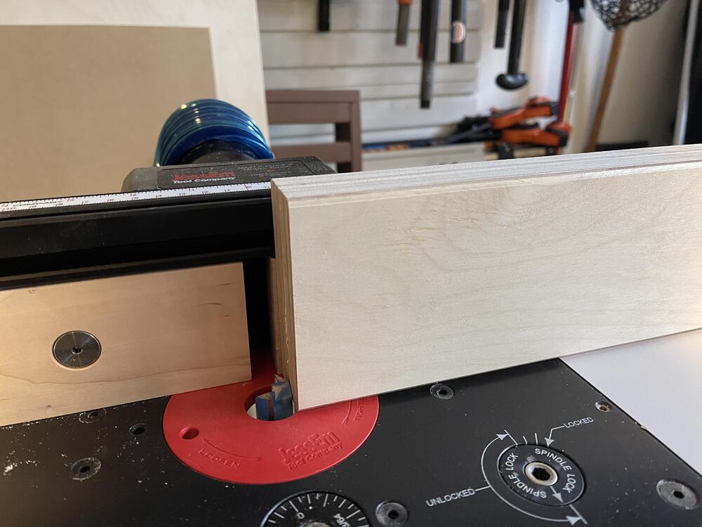

VPI Posted February 17, 2021 Report Posted February 17, 2021 Well, the Festool track worked well for the plywood cuts, but the fence is a bit tall so I it comes down to making several cuts on the table saw or the router table for this top mounted track. Seems to me like going up a 1/4” at a time should be manageable on the router table. Oh, also added my sidearm and marking dagger to the apronlet this morning. Shit is getting serious up in here. 3 Quote
VPI Posted February 17, 2021 Report Posted February 17, 2021 Survived the Murder Machine again. Seems I should have gone with a much more open ring kit as the chips got all packed into the groove. 1 Quote
