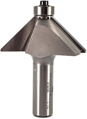

swt61 Posted December 20, 2020 Report Posted December 20, 2020 ^ You need a router table with fence, because there's nowhere for the bearing to ride if you're cutting a full miter. Unless you tack a strip on top for the bearing to ride against. Still, not the cleanest way to miter plywood. Quote

dsavitsk Posted December 20, 2020 Report Posted December 20, 2020 29 minutes ago, swt61 said: ^ You need a router table with fence, because there's nowhere for the bearing to ride if you're cutting a full miter. You can clamp a board to it to act as a straight edge for the bearing. Or the festool router can run in the track saw track. 30 minutes ago, VPI said: if the Festool setup had some way to lock down the angle besides holding it down when the saw tries to fall over. I'm not sure I'm understanding your complaint. The track saw should be able to lock in the angle. Quote

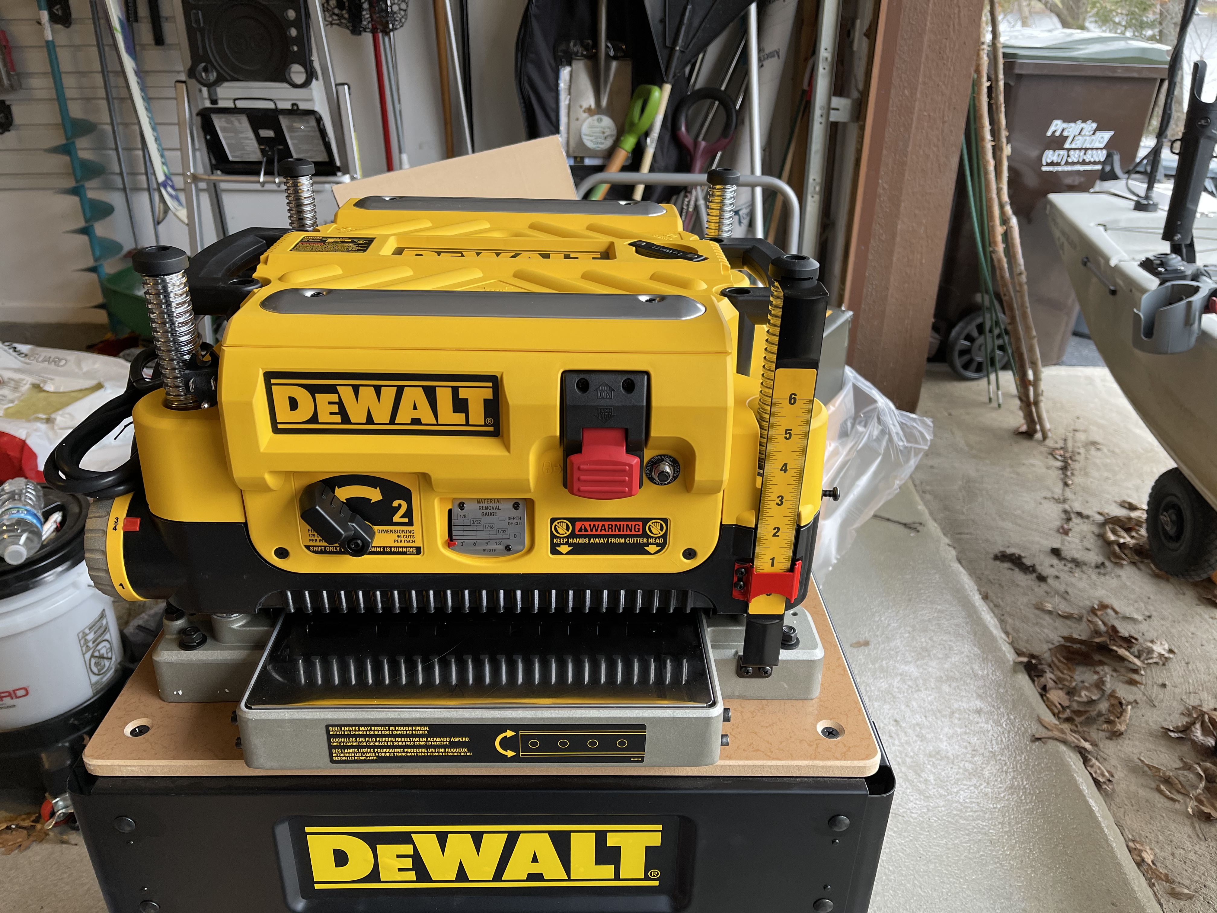

VPI Posted December 22, 2020 Report Posted December 22, 2020 Got the stick squasher mounted on its table. Now off to YouTube to figure out how the hell it works. The instructions say not to connect it to a shop vac, do I actually have to get another dust extraction system for this? Quote
swt61 Posted December 22, 2020 Report Posted December 22, 2020 It won't really make dust per se, just little chips. Still messy, but not something you're going to breath in. Quote
dsavitsk Posted December 22, 2020 Report Posted December 22, 2020 2 hours ago, VPI said: do I actually have to get another dust extraction system for this? Yes. If you use it outside, you might get away without one. They used to sell it with just a bag, but the internal fan wasn't enough and they clogged so it didn't really work. Also, what good is a planer without a jointer? 1 1 Quote
naamanf Posted December 22, 2020 Report Posted December 22, 2020 4 hours ago, VPI said: Got the stick squasher mounted on its table. Now off to YouTube to figure out how the hell it works. The instructions say not to connect it to a shop vac, do I actually have to get another dust extraction system for this? You might as well order this along with a large cyclone extractor. https://byrdtoolexperts.com/shelix-head-for-dewalt-dw735-planer-lander?utm_source=google&utm_medium=cpc&utm_campaign=dynamic-search&utm_content=lp-from-standard-groups&gclid=CjwKCAiAz4b_BRBbEiwA5XlVVpc4u6gdRQ-M-Eaqqoj6w9iIqE7V5AwATyFqVlOebRB72OWGf5p3WhoC95gQAvD_BwE 1 Quote
swt61 Posted December 22, 2020 Report Posted December 22, 2020 The install of the helix head isn't quite as simple as they make it out to be. Quote
swt61 Posted December 22, 2020 Report Posted December 22, 2020 (edited) 1 hour ago, dsavitsk said: Yes. If you use it outside, you might get away without one. They used to sell it with just a bag, but the internal fan wasn't enough and they clogged so it didn't really work. Also, what good is a planer without a jointer? A portable/jobsite planar that needs more dust collection than a shopvac? Yeah, that's perfectly sensible. Edited December 22, 2020 by swt61 Quote
