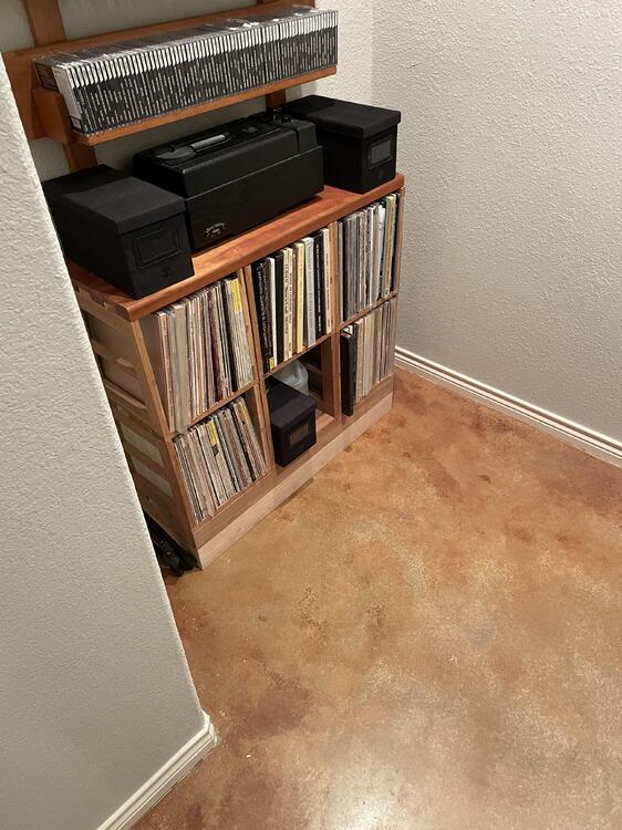

swt61 Posted December 6, 2020 Report Posted December 6, 2020 Nice job Marc! I'm now done with my latest project. Building two turntable stands back to back, I learned a few things. One, was that I'd like a second shelf above the record storage shelf, accomplished. Two, is that I'd like some kind of stop to keep the records from pushing in too far on the shelf, accomplished. I used Amber shellac on the base to try to get that golden tone of the Burled Maple top of the Colossus. Worked well, and it also provides a complimentary warm tone next to the Cherry of the Parasound tower and speakers. I also like the dark top with the Colossus. 7

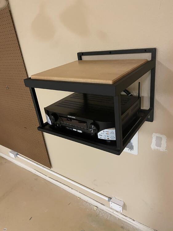

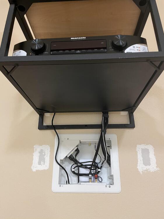

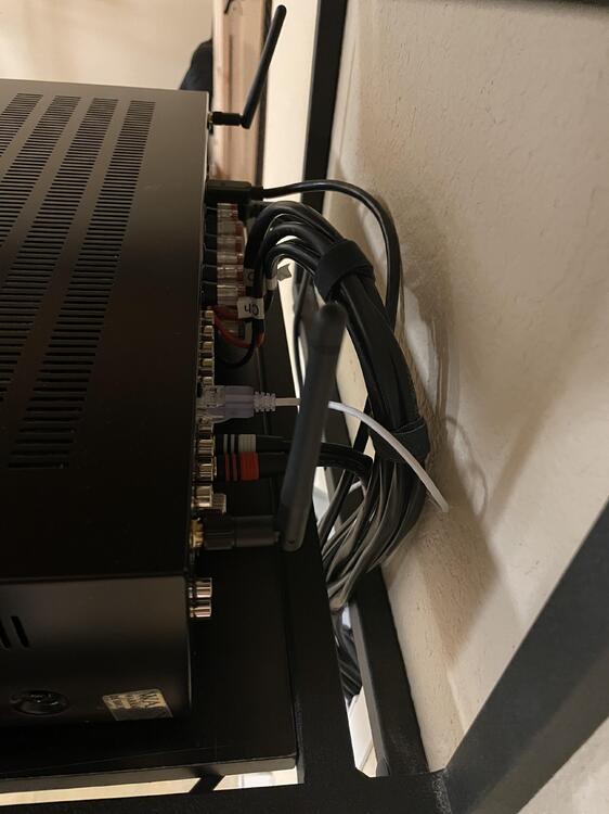

luvdunhill Posted December 6, 2020 Author Report Posted December 6, 2020 So, here is the other side of the wall behind the TV - putting a receiver in a garage is either genius or the worst idea ever. I got a nice cover for it to attempt to keep it somewhat clean, but time will tell. Got the wiring as tidy as I could. with eARC I don’t think I really will need a remote. I am using two wires from an Ethernet run for a 12v trigger to switch over subs to HT duty and could use another pair to run an IR blaster if needed. there is a plate that can be installed on the Arlington box but I am not sure how I would get the wires out. I do imagine this will be a good source of A/C leaks during the summer time but not sure what I can do to make it any better than what I have. ... plus there is room for a garage turntable! 8 2

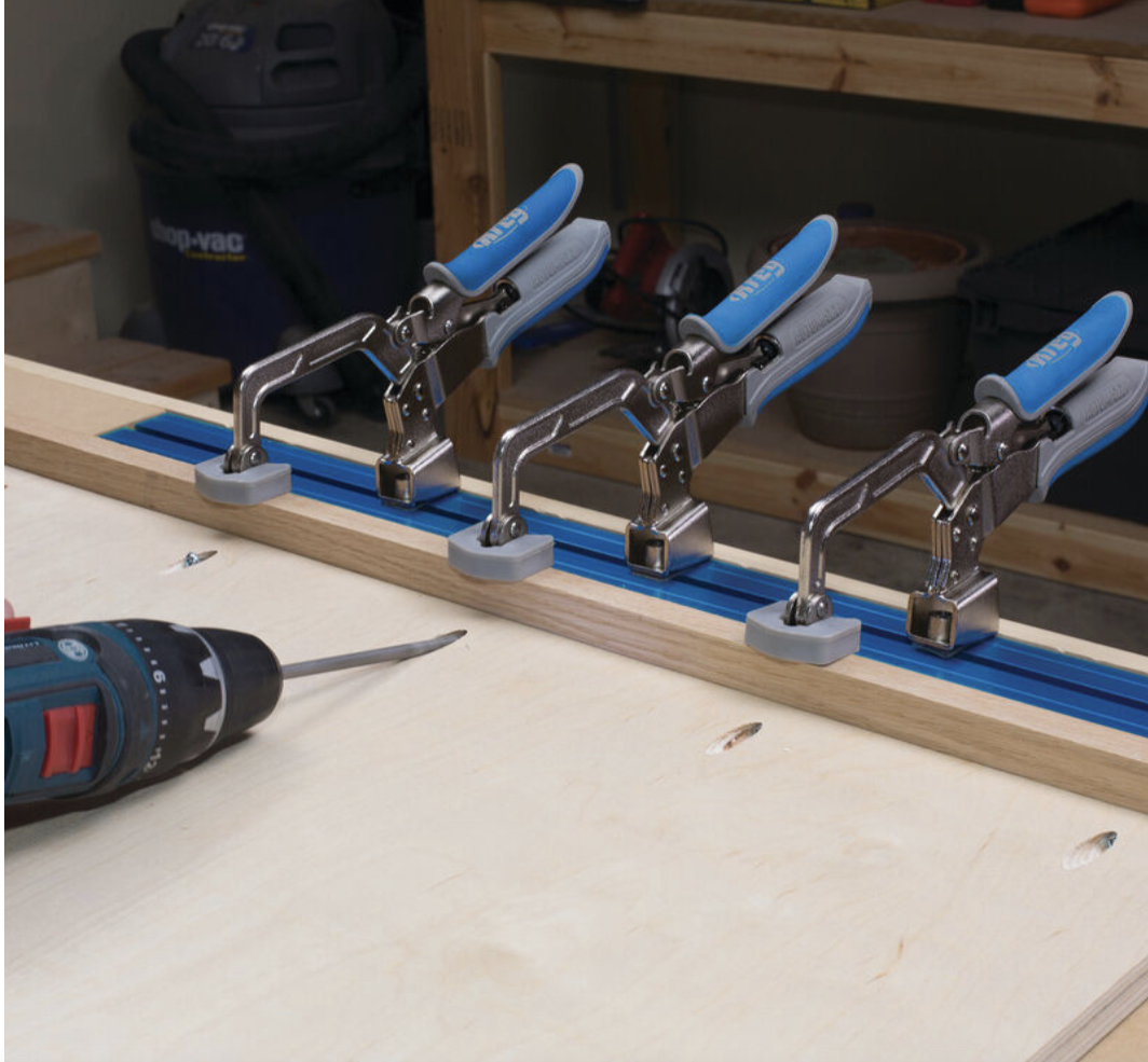

Voltron Posted December 7, 2020 Report Posted December 7, 2020 I like the Kreg Automaxx bench clamps. 2

Voltron Posted December 7, 2020 Report Posted December 7, 2020 3 hours ago, naamanf said: Those look pretty solid, I’ll have to check them out. They automatically clamp down on various thicknesses without adjustment or tightening. You can set the tension +/- for thicker or thinner material before clamping but the range is wide. They work in t-tracks but also come with mounts that fit in bench dog holes. They also make them as hand clamps, which are great for one handed clamping. 1
swt61 Posted December 7, 2020 Report Posted December 7, 2020 As most things Kreg, they're well thought out. 2

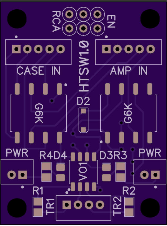

luvdunhill Posted December 13, 2020 Author Report Posted December 13, 2020 I am looking to use a pair of subwoofers for both HT and Hi-Fi duty. Both systems have a 12V trigger output - a receiver and preamp. I decided to build a small circuit that isolates each trigger (amp has an aux supply to drive the relays) and toggles between an RCA input for the HT and a XLR input for Hi-Fi (depending on which remote trigger was asserted) and defers to a selectable input when both signals are sensed. Both triggers will come in on a single cable through a 3.5mm TRRS jack that will replace an existing toggle switch in each monoblock amp chassis, that currently is used for manual RCA or XLR input selection. One last feature is the board will keep the amp in standby whenever no trigger is asserted. Super custom use-case, but that’s what makes DIY fun! 5
