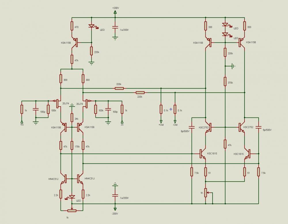

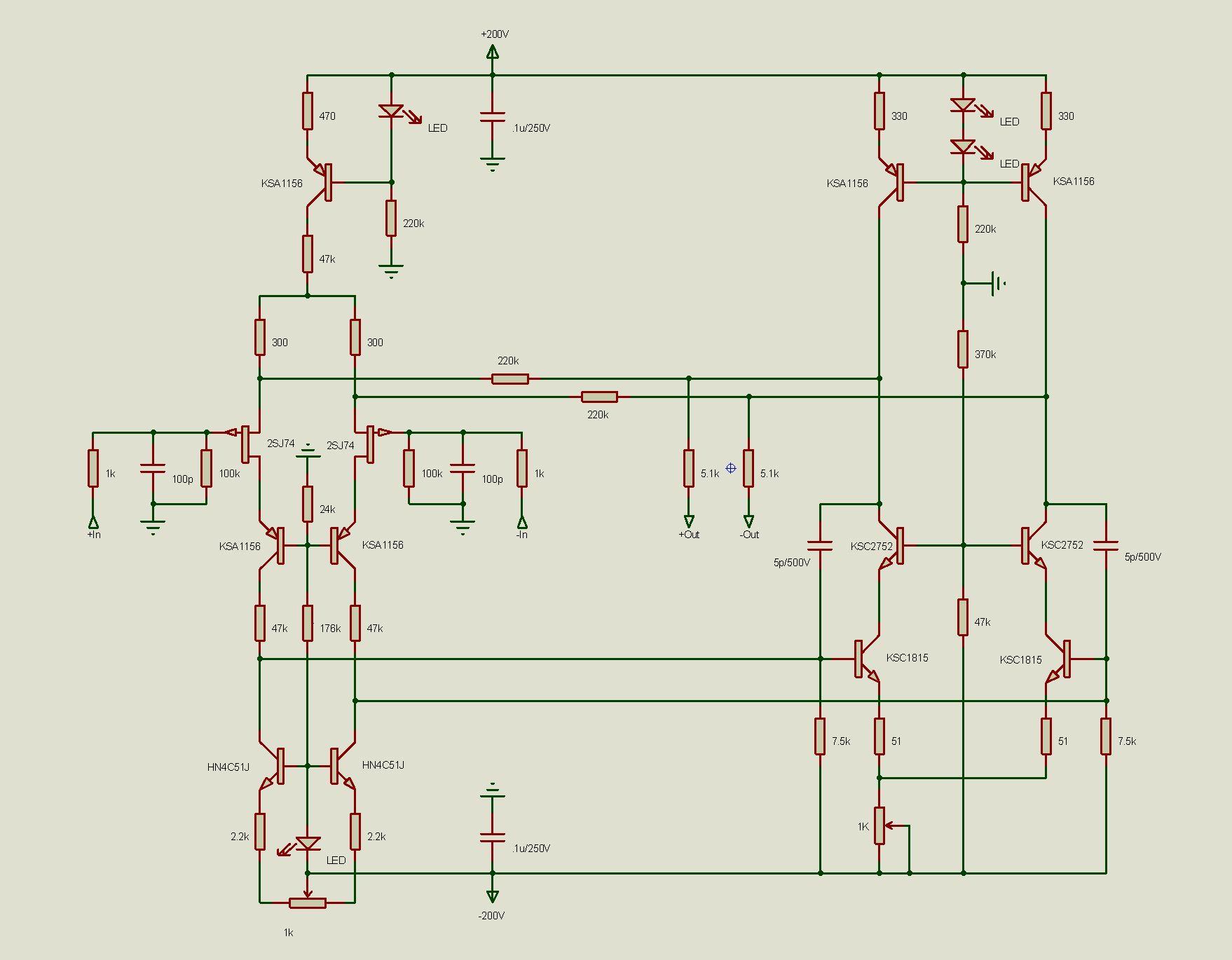

JoaMat Posted January 17, 2020 Report Posted January 17, 2020 A gentleman told me about the electrostatic amplifier Sirrah designed by Andreas Rauenbuehler. See http://www.high-amp.de/ . Inspired by Sirrah I draw this sketch……20 mA per channel. Accompanied with small GRHV regulators and 50VA transformer - could be built in a small box for the bedside table? maybe it won't work at all. 4
mwl168 Posted January 17, 2020 Report Posted January 17, 2020 I have a bunch of the obsolete 2SC1815 on hand. I can send some to you if you decide to build it ?
JoaMat Posted January 17, 2020 Report Posted January 17, 2020 Thank you, Michael. Working on a layout... we'll see what happens.

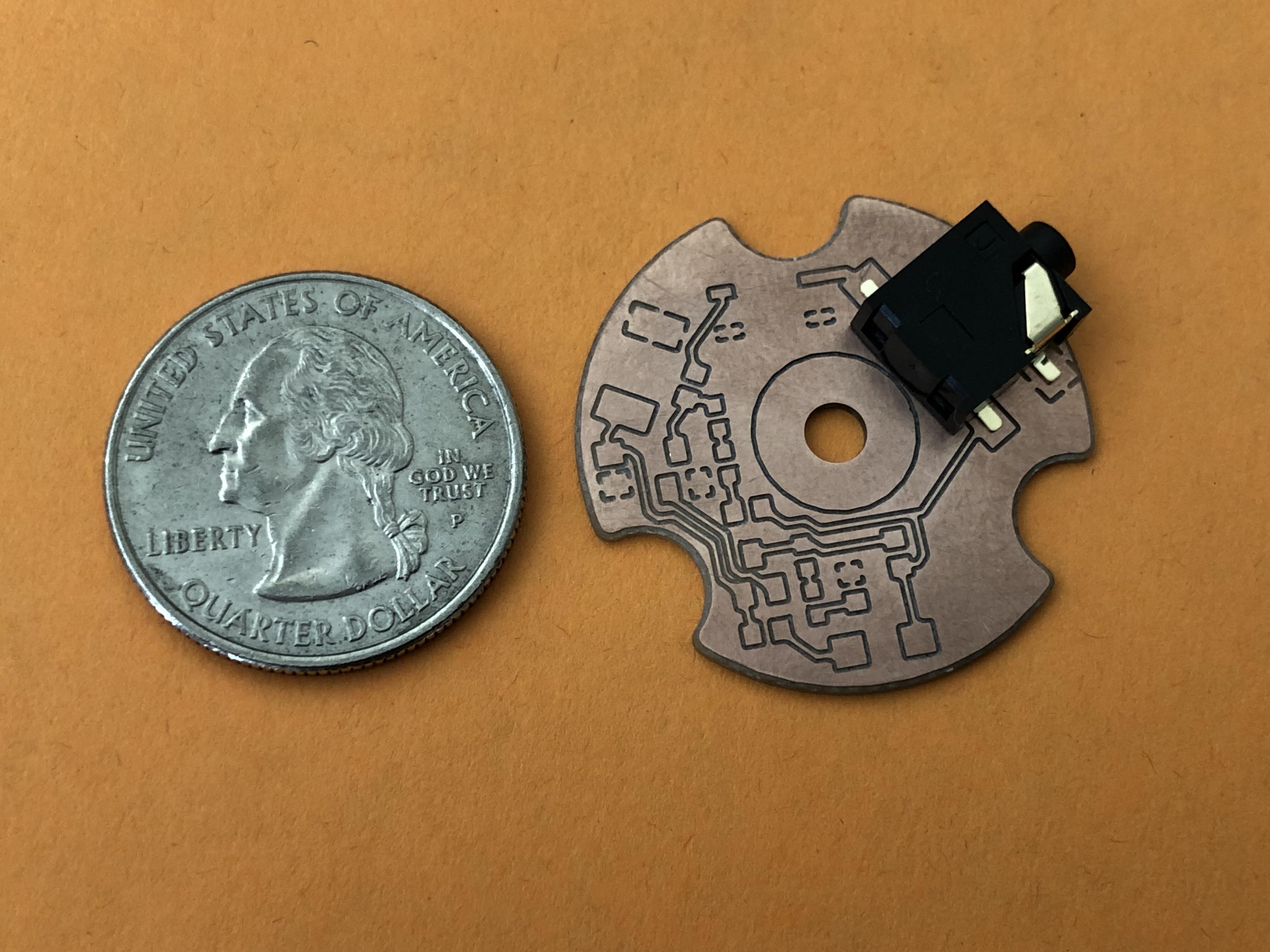

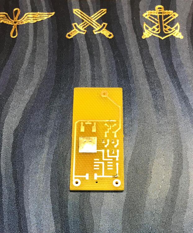

Kerry Posted March 1, 2020 Report Posted March 1, 2020 I just milled this board for a CNC probe I’m working on. Those are .01” slots. I’m surprised I could do this 7 1
JoaMat Posted March 1, 2020 Report Posted March 1, 2020 Looks nice! What tool did you use? I use 15th end mill but as I understand V shaped tools are more commonly used.
Kerry Posted March 1, 2020 Report Posted March 1, 2020 (edited) I used a 10 mil flat end mill. You need a really short flute. Length of cut should be about 15 mils. I did several passes since the board wasn’t completely level. Fun stuff Edit: I’ve had no luck with v shaped tools. Edited March 1, 2020 by Kerry
JoaMat Posted March 1, 2020 Report Posted March 1, 2020 (edited) Good to know that 10th worked for you. I didn’t dare to buy smaller than 15th even it’s a short flute. When I did my digital attenuator I had 10th clearance so I had to make a conventional chemical etching. Same here, no luck with the V shaped things – probably only for the pros. Edited March 1, 2020 by JoaMat 2

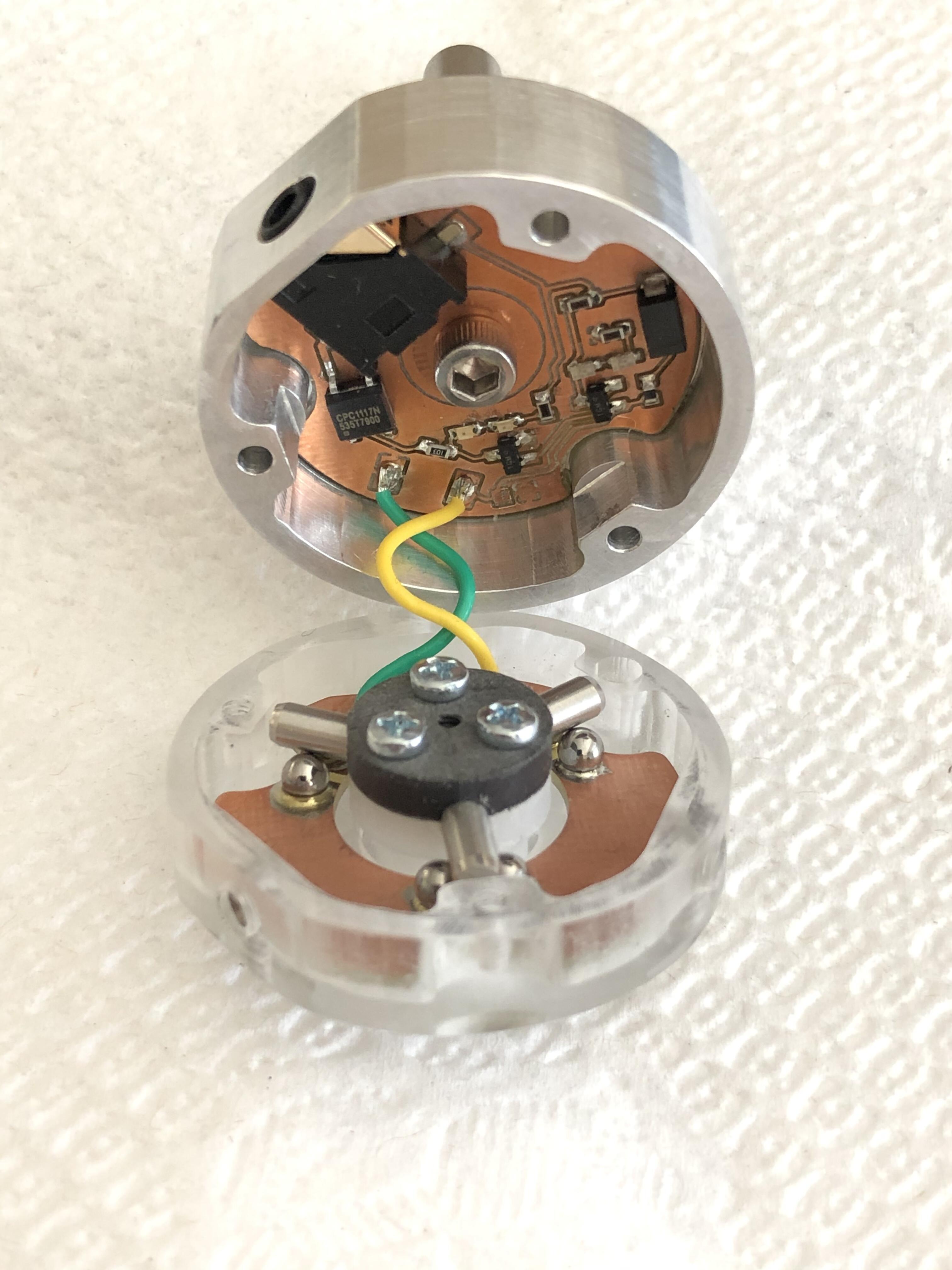

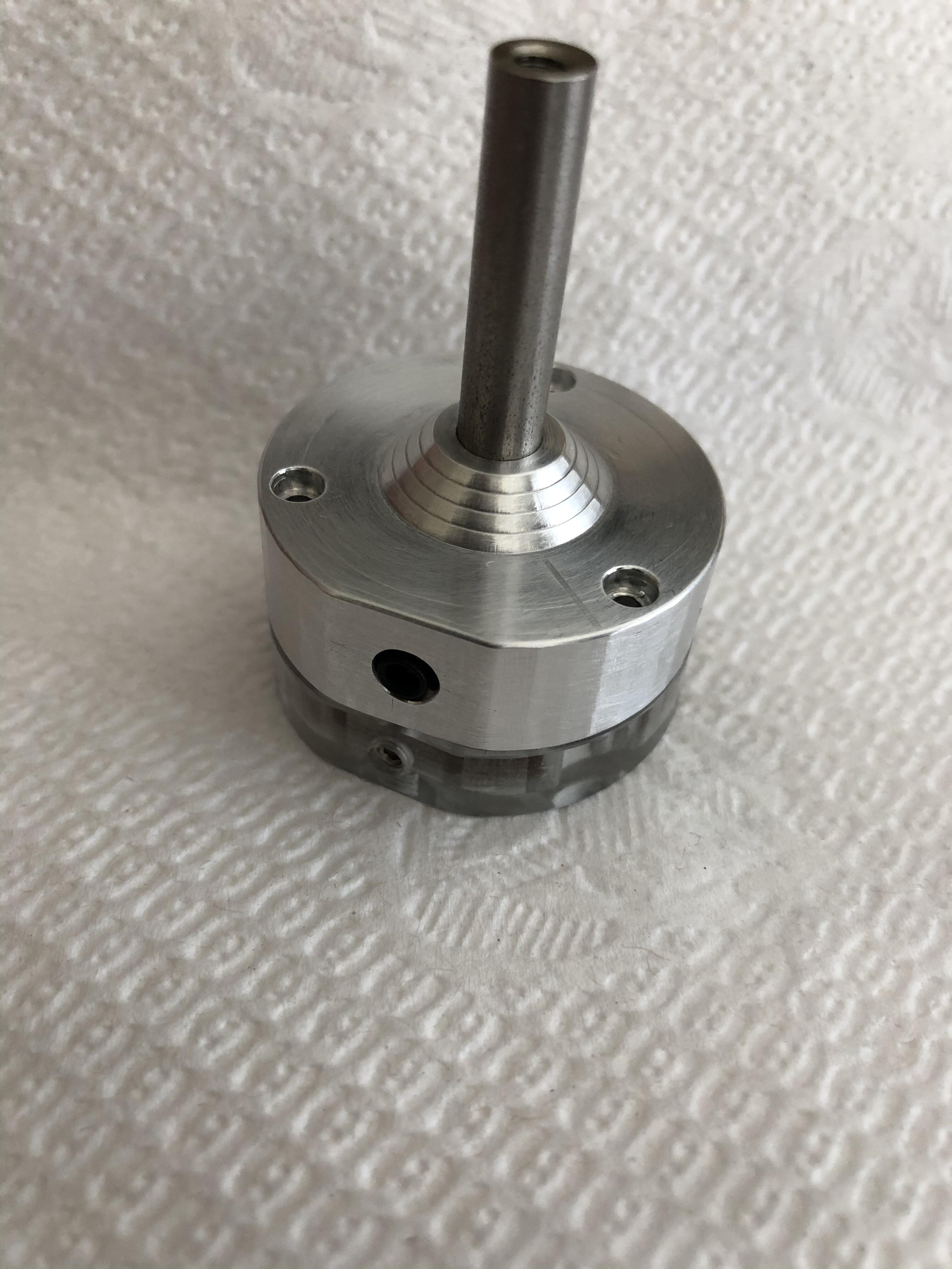

JoaMat Posted March 3, 2020 Report Posted March 3, 2020 Looks even nicer today. But my brain is about to overheat – how does the probe work?
Kerry Posted March 3, 2020 Report Posted March 3, 2020 (edited) It’s based on this project... 3D Probe I had to re-do all of the models to fit my needs. Edited March 4, 2020 by Kerry

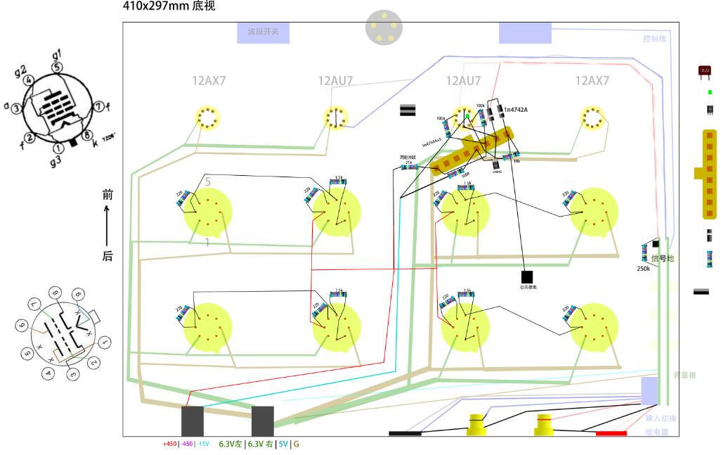

hyperma Posted March 30, 2020 Report Posted March 30, 2020 Not making anything yet, but planning. After the Carbon I guess Megatron will be the next,so... A Megatron on more Old school style...not finished yet

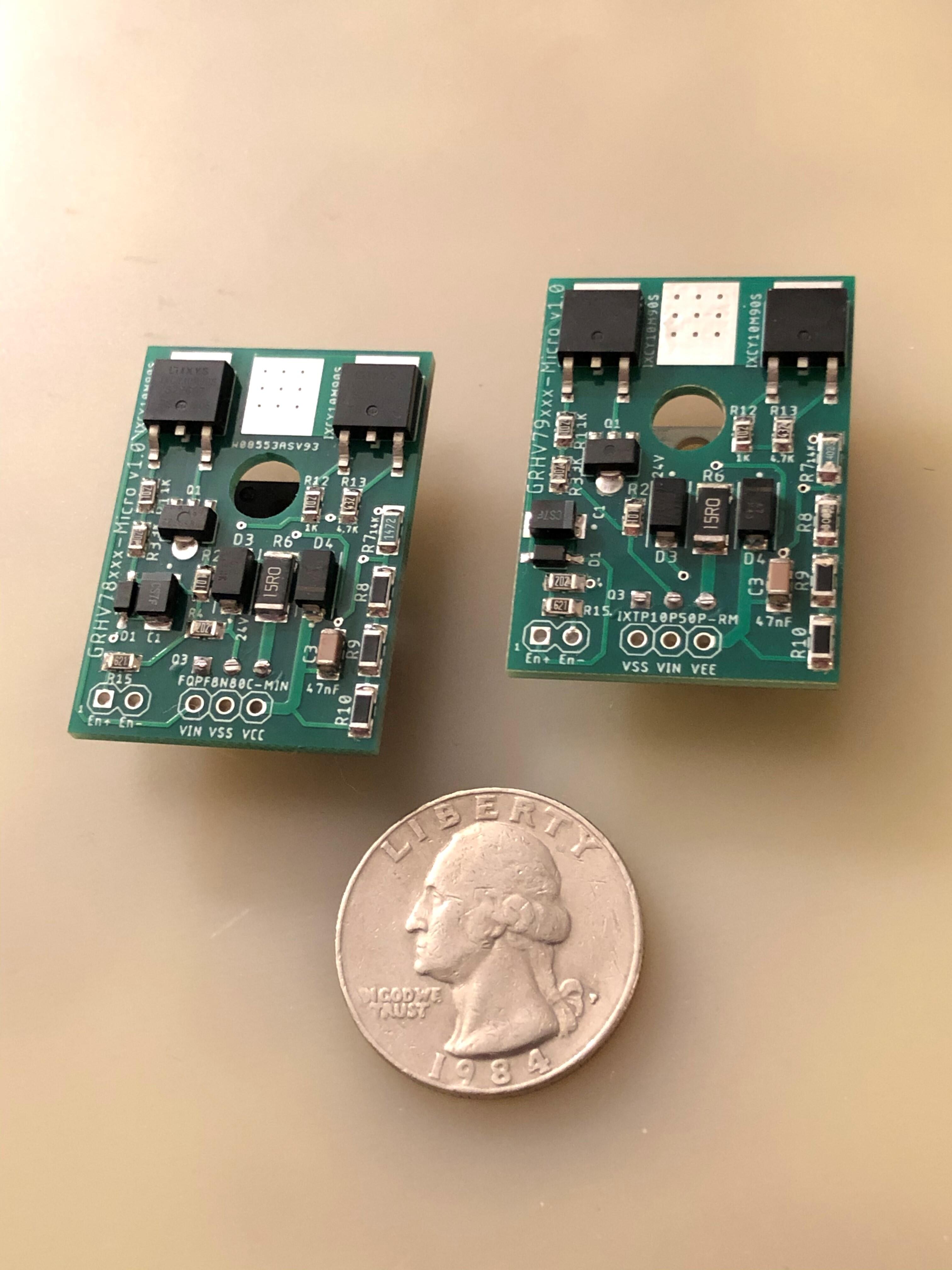

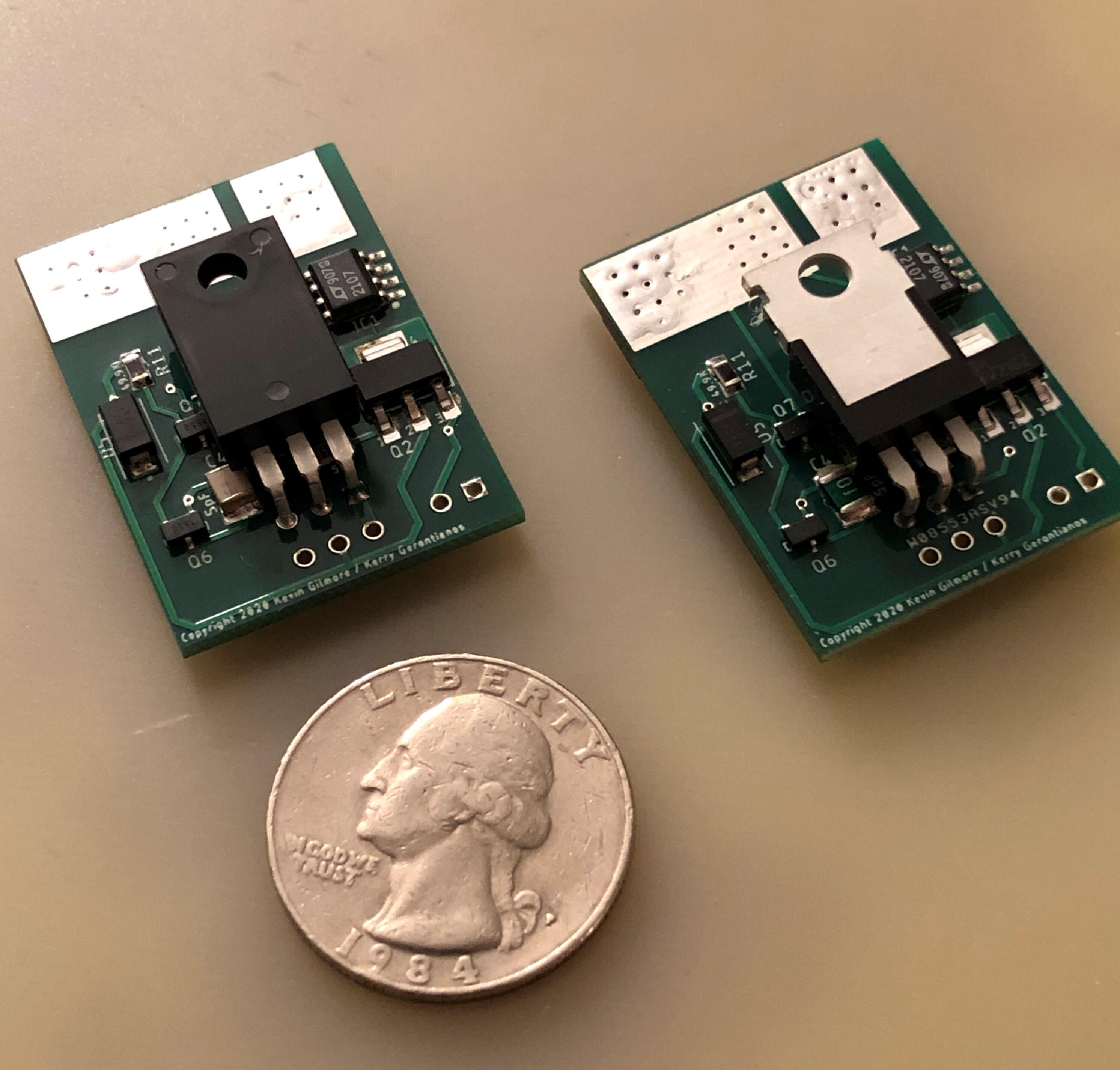

Kerry Posted April 1, 2020 Report Posted April 1, 2020 I'm playing with a new project and I needed to shrink the GRHV and also build the negative supply. Here's the positive and negative supplies. I'm going to test them tomorrow 🤞 9 2
JoaMat Posted April 1, 2020 Report Posted April 1, 2020 Looks very nice. I like the negative regulator. Milled today. Board has 13 vias and I think I've found a good way to make it in our kitchen (turnaround time is an hour or so (more likely a couple of hours)).STN9360 is too big for this board. STR2550 is much smaller and there is room for four of them plus LT1021, 10M90S, HN4C51J and a few other components on the other side. 1

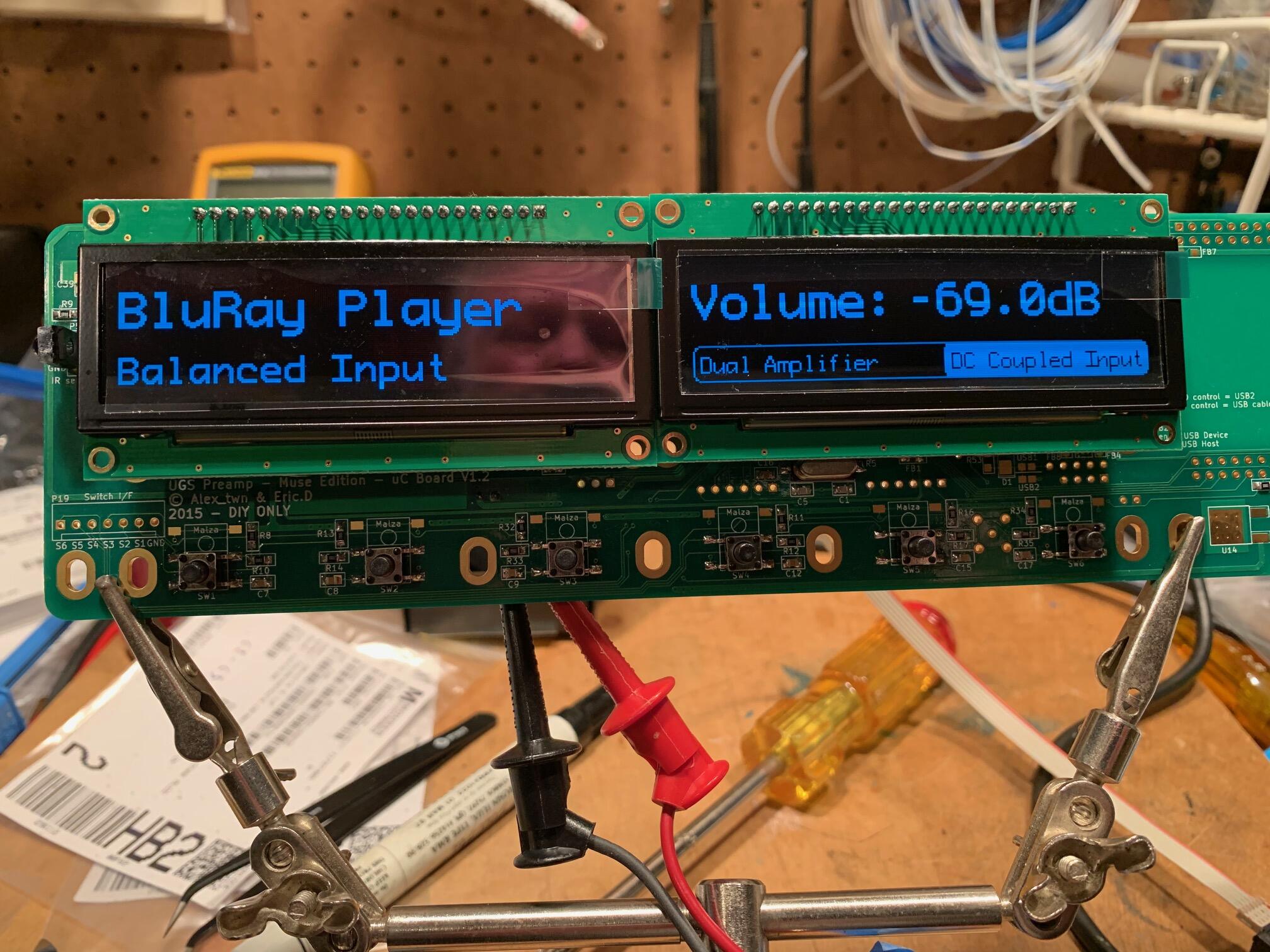

Pars Posted April 2, 2020 Report Posted April 2, 2020 (edited) OLEDs in the house. UGS Muse preamp (x2). This one is for HC user DrizztDo (who I am building the Carbon for and previously built an SS Mini Dynalo for). The previous processor pic(s) were from my board (in the mini T2 build thread I believe). The 0.5mm 100 pin LQFP-100 package caused me to buy a USB microscope to see what the fuck I was doing... Jose had posted one in that thread. Edited April 2, 2020 by Pars 8
