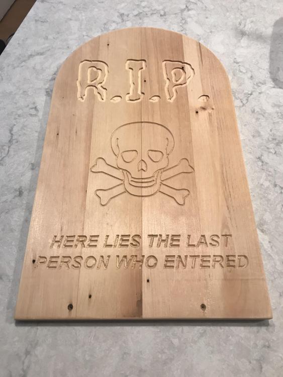

n_maher Posted October 28, 2019 Report Posted October 28, 2019 I'll certainly share them. I can't quite tell if I've got a persistent z-axis issue or not. It seems to do some weird things every once in a while where it plunges to a different depth than it finishes but I haven't really taken the proper time to troubleshoot it. It's essentially doing what I ask if it right now but there's no freakin' way that it could do metal as-configured. The z-axis is not rigid enough and can't develop enough down pressure to hold position. I think the first upgrade I'm likely to make is the HDZ option. Today's handiwork, which Andrew requested so that we could have a gravestone outside for Thursday. It's pretty fun to be able to whip something up like this and have it cut out in less than an hour. 4

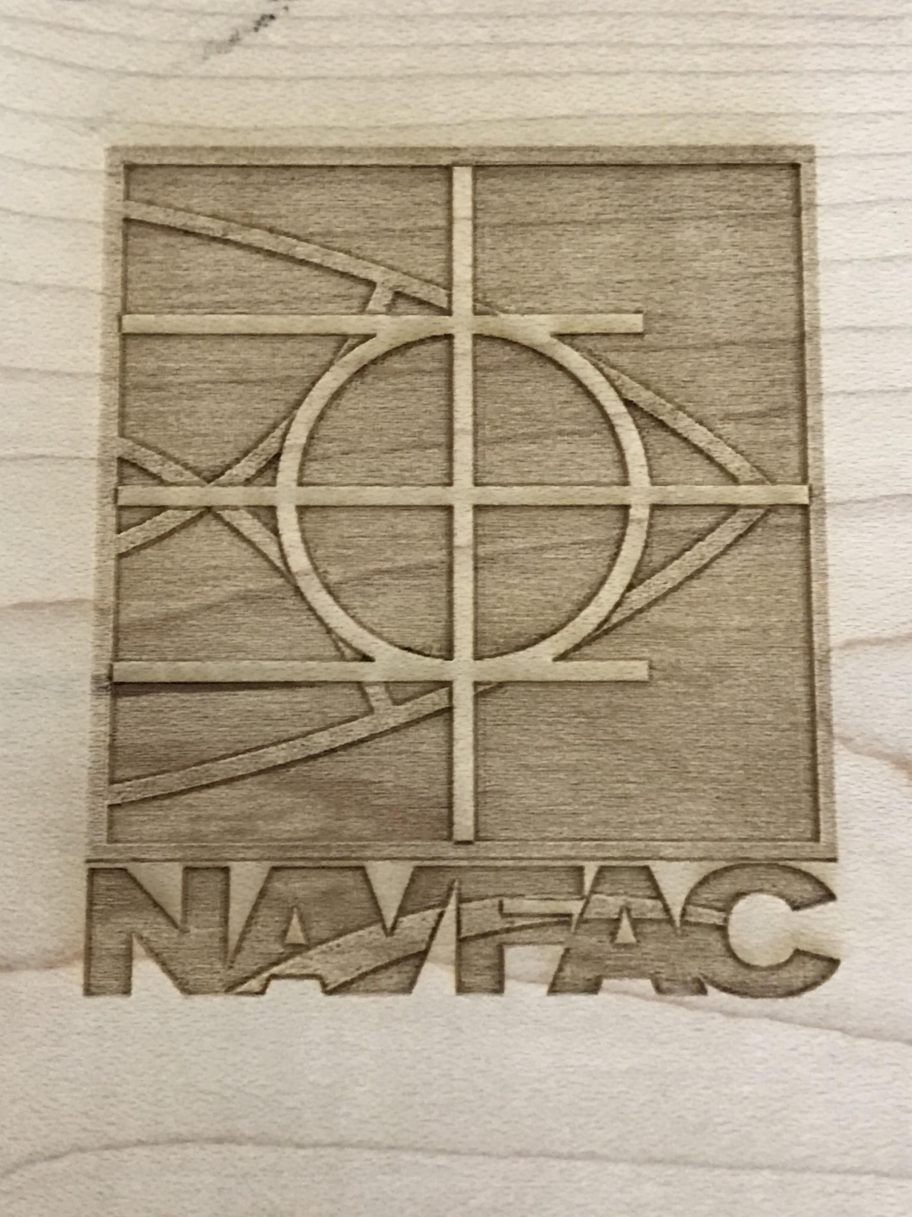

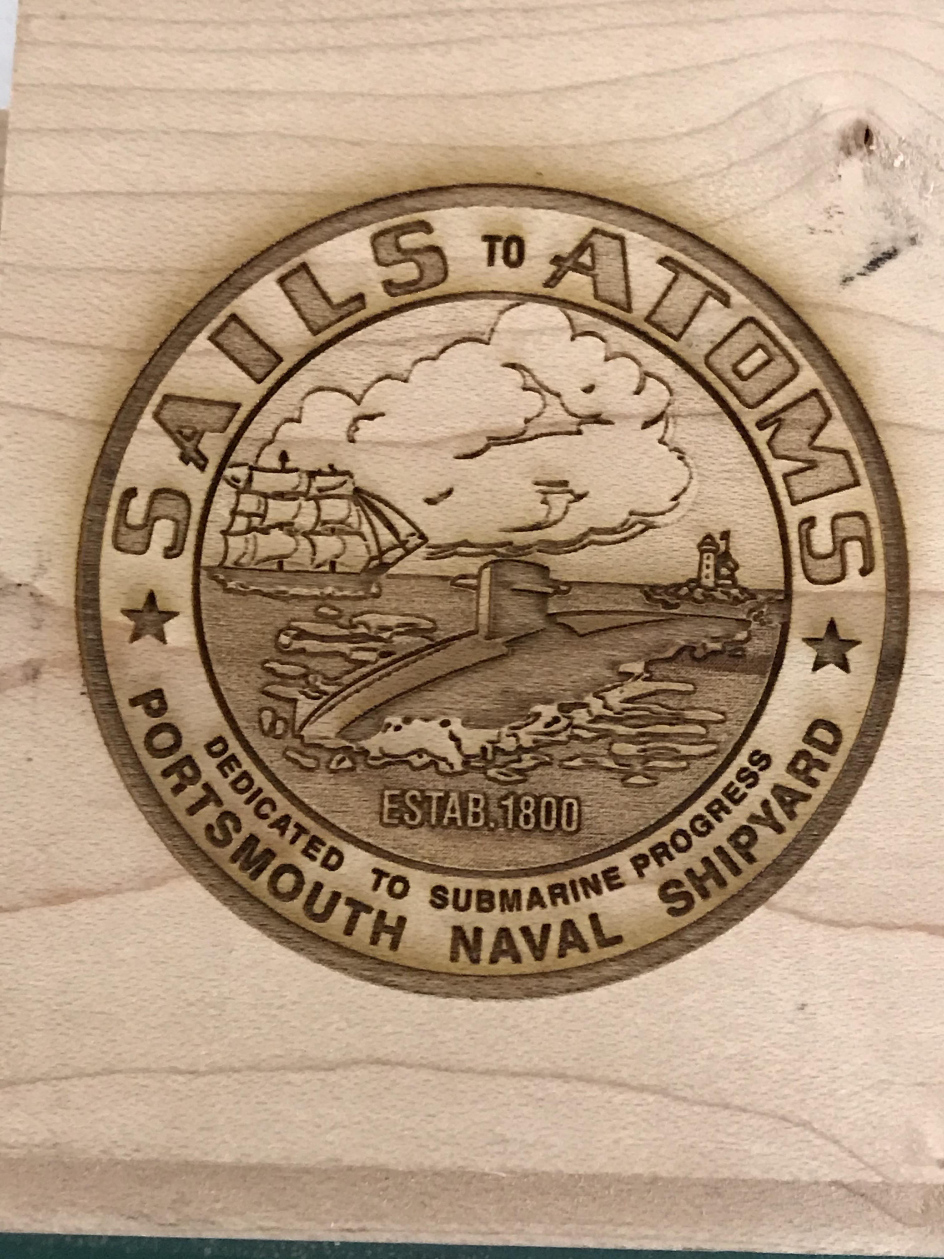

n_maher Posted November 24, 2019 Report Posted November 24, 2019 The laser has been successfully tested with logos from work. Each of those is about 2" across so the level of detail that can be achieved is (at least in my opinion) impressive. 9 1
Kerry Posted November 24, 2019 Report Posted November 24, 2019 Those are great results. I haven’t hooked up a laser yet, but I feel I need to. What laser are you using?
n_maher Posted November 24, 2019 Report Posted November 24, 2019 6 minutes ago, Kerry said: Those are great results. I haven’t hooked up a laser yet, but I feel I need to. What laser are you using? Dremel DigiLab LC40. Not cheap ($6k) but work needed something UL rated that wouldn't let people kill/blind themselves. https://digilab.dremel.com/products/lc40-laser-cutter 1
Craig Sawyers Posted November 24, 2019 Report Posted November 24, 2019 There was a guy on another list I'm on who was asking how to wire up a high power diode laser he'd bought with the intention of making a laser machining unit. Of course these diodes can be bought by any tom fool cheaply from Amazon etc. I pointed out to him that he could cheerfully drill a hole in his retina, or anyone who inadvertently walked in. Even scattered light when in use was way above eye-safe That he needed laser safety goggles with the correct specifications for the laser, door interlocks, a red warning light outside, blacked out windows. All usual precautions if you are going to frig around with multi-watt lasers. Particularly as he was totally unaware that these small diode lasers produce enough power to cause real damage. At that point he went very quiet. It surprises me not at all that a commercial unit that has all the necessary laser safety features is $6k, Nate. Superb results from it, by the way!
