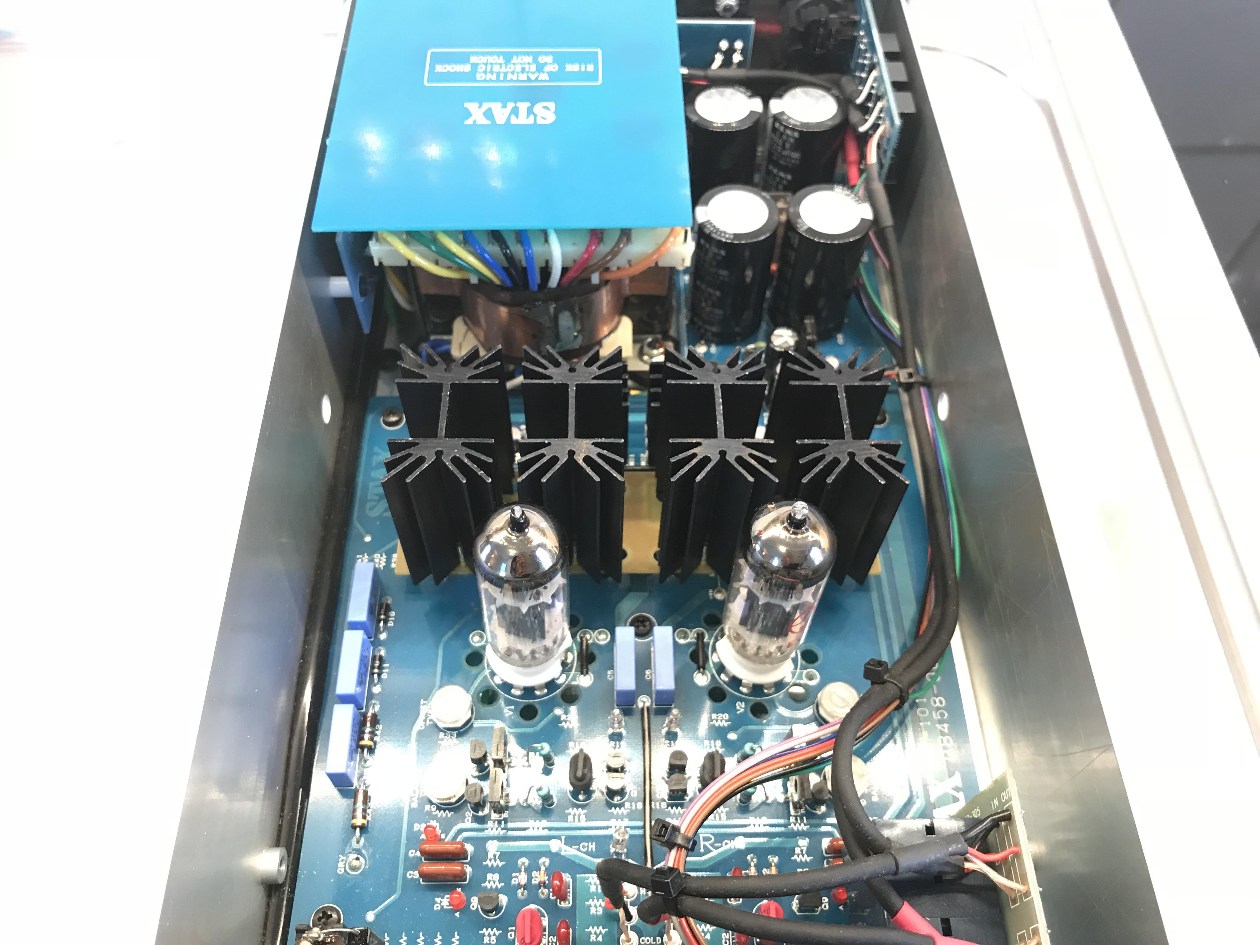

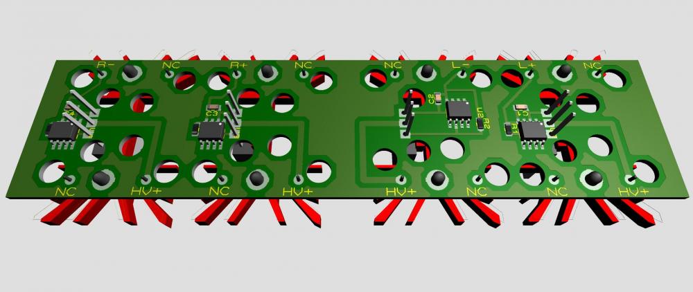

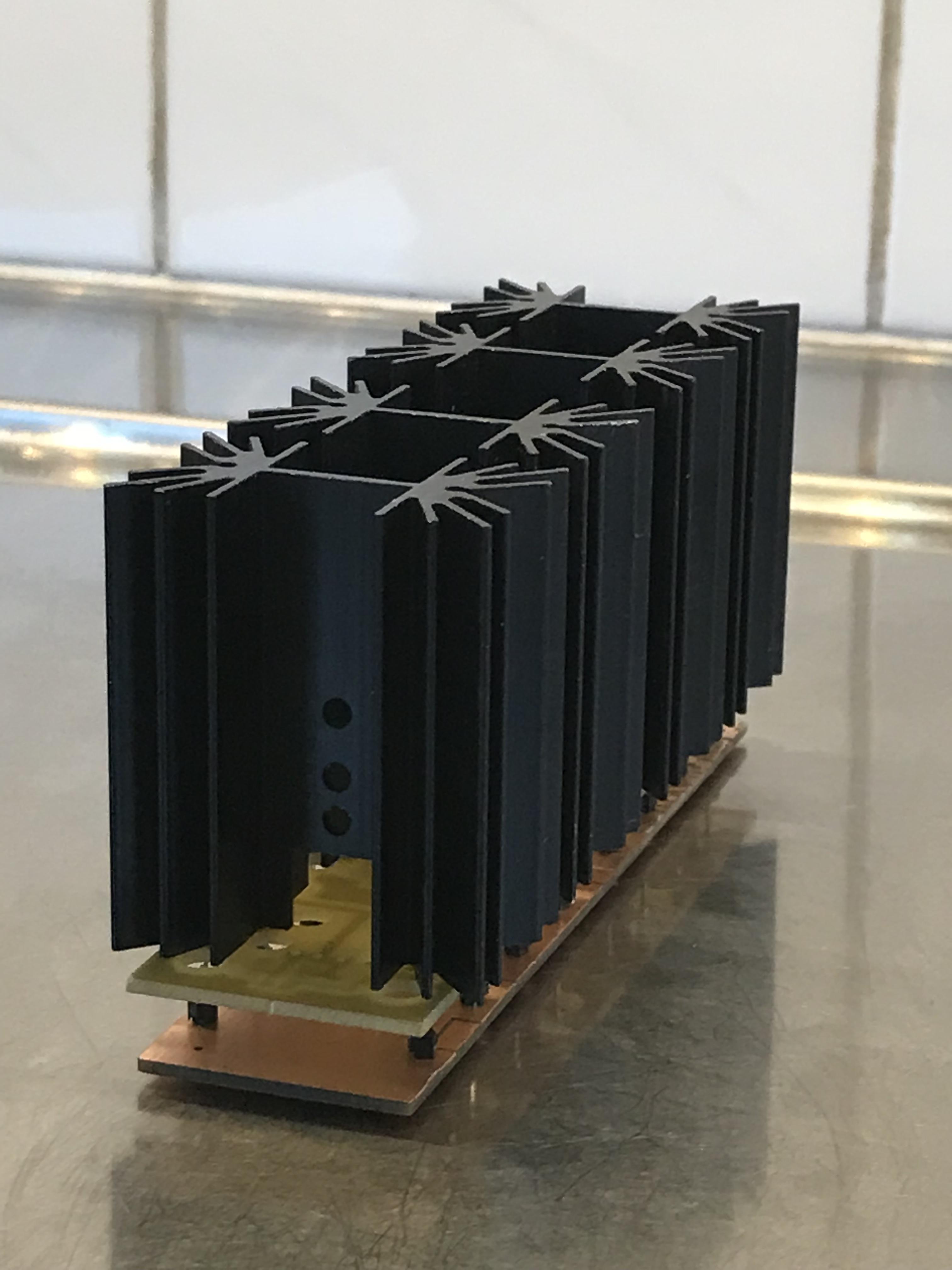

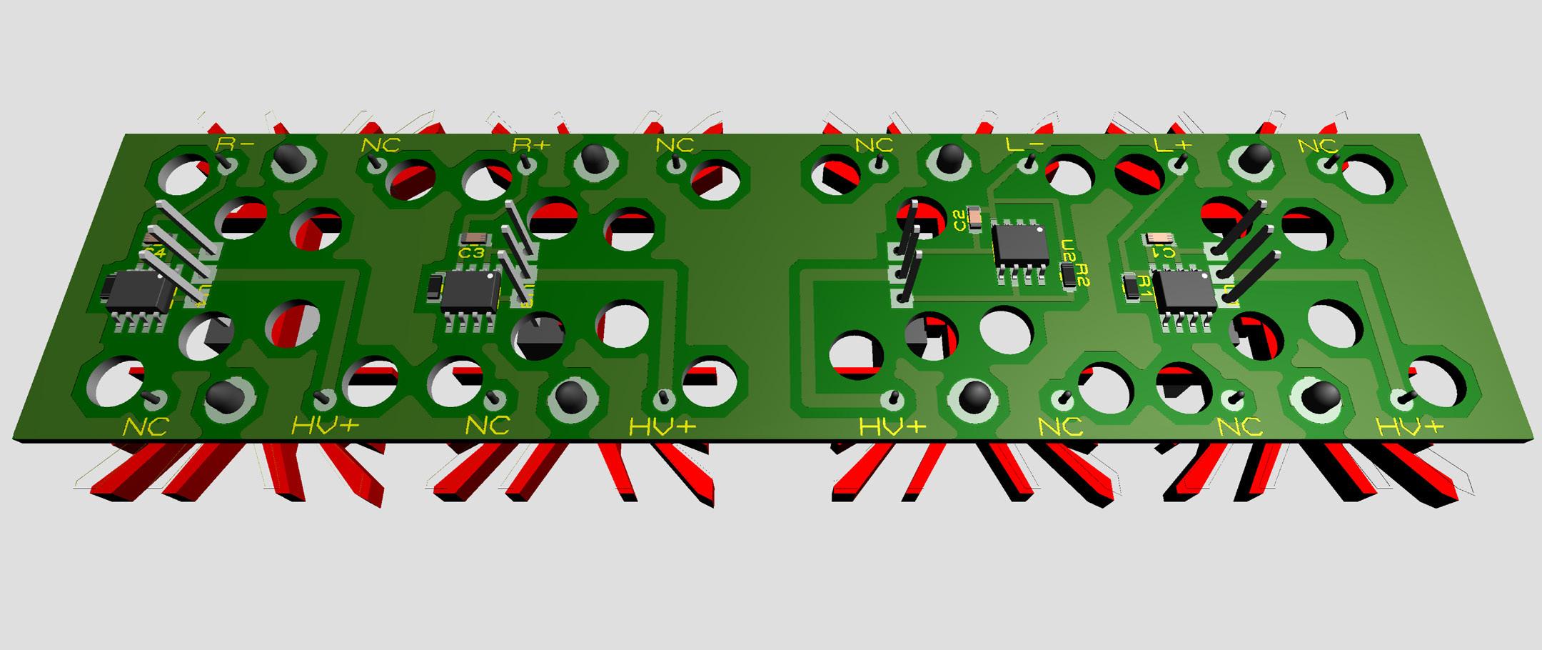

It’s a Stax SRM-600 Limited. Now I’ve got it modified with constant current sources instead of the power resistors. The CCSs are 01N100D/LT1021 by Kerry – see this post.
The board looks like this and is connected to the main board via 16 pin headers to the holes for power resistors. Current sources set to 6.0 mA.

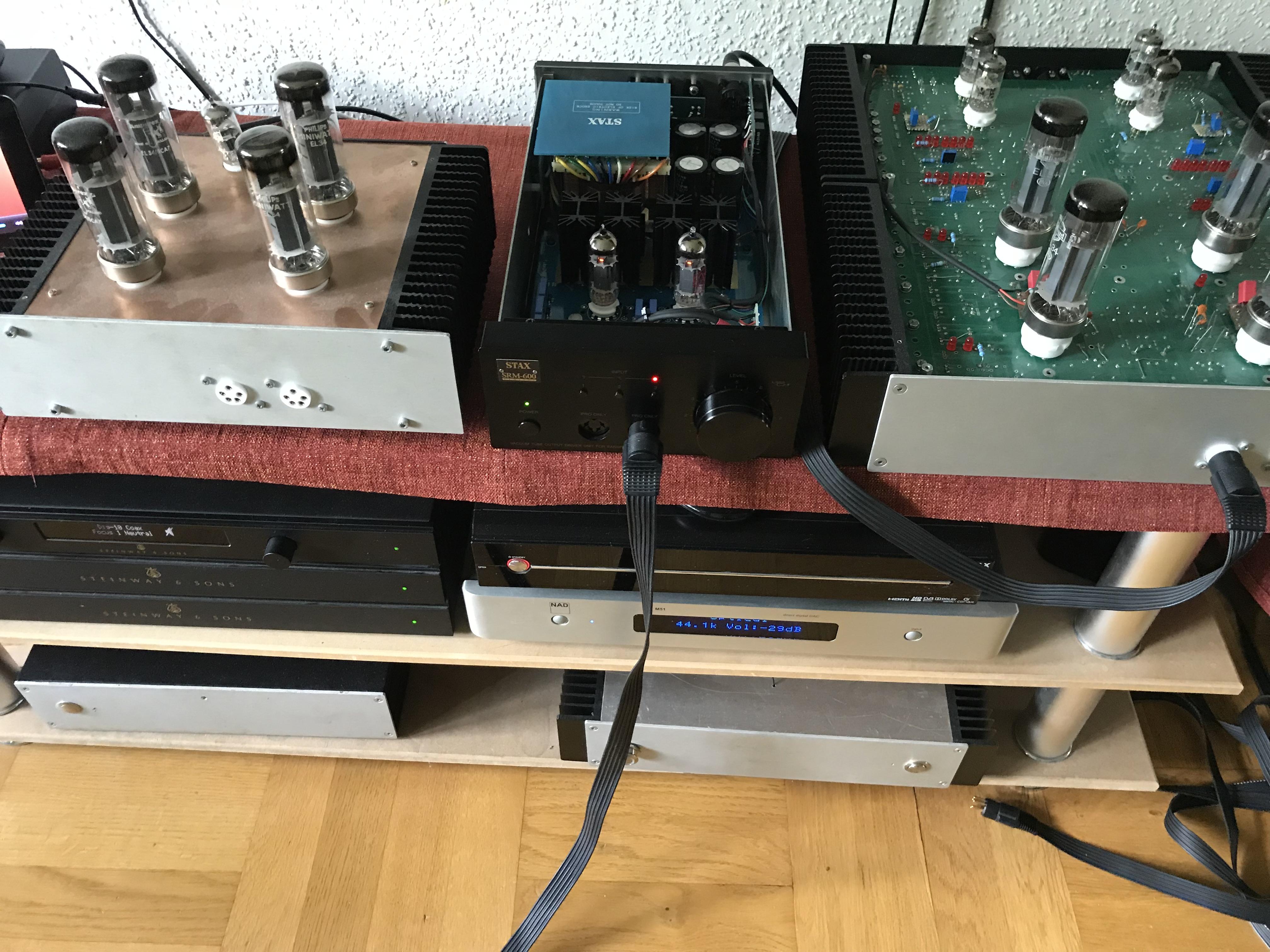

I’m presentlyĀ  enjoying the Schwanensee from Wiener Staatsoper through ā€œSRM-600 Limited Modifiedā€ and I like the sound. Drove 400 km from our summer cottage to apartment and back today to assemble the CCS board.
Here is picture of the Limited surrounded byĀ a couple ofĀ nice electrostatics.

My name on the schematic and layout files are KG Tube input + GG output.*. Based on Kevin’s KGSSHV-TUBE-SANDWICH board. Different CCS, offset/balanceĀ servos and most parts are surface mounted. I did pollute the stax t8000 clone (well sorta) thread with posts during built last summer - an extremely rainy summer.
