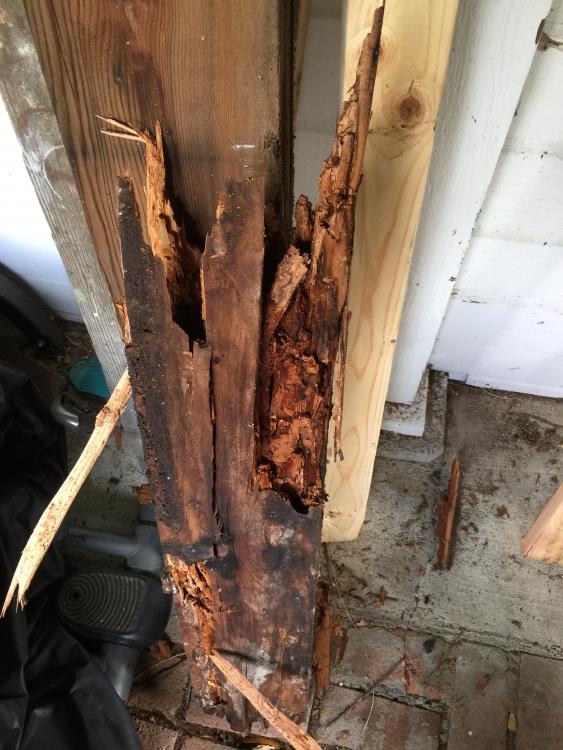

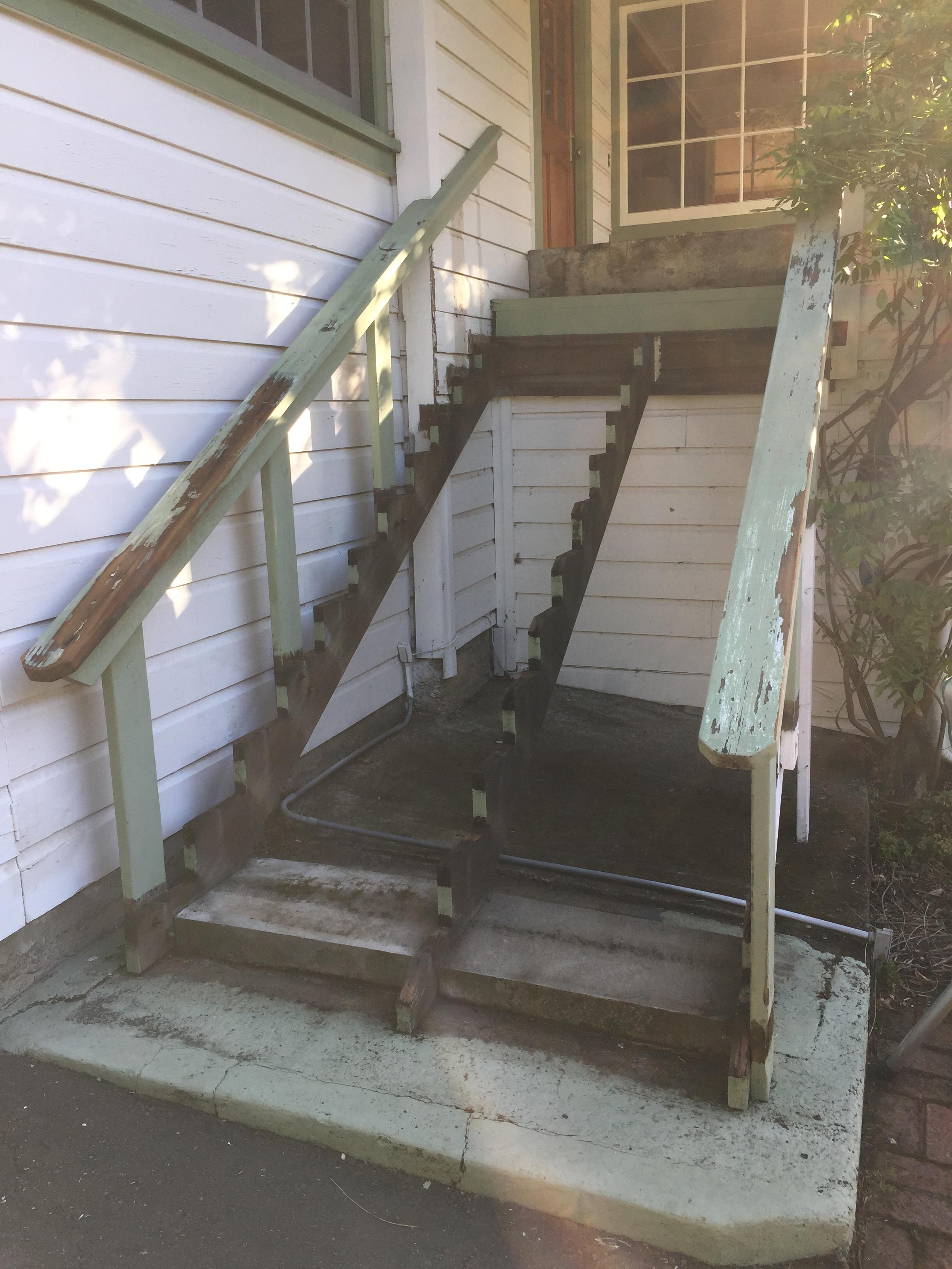

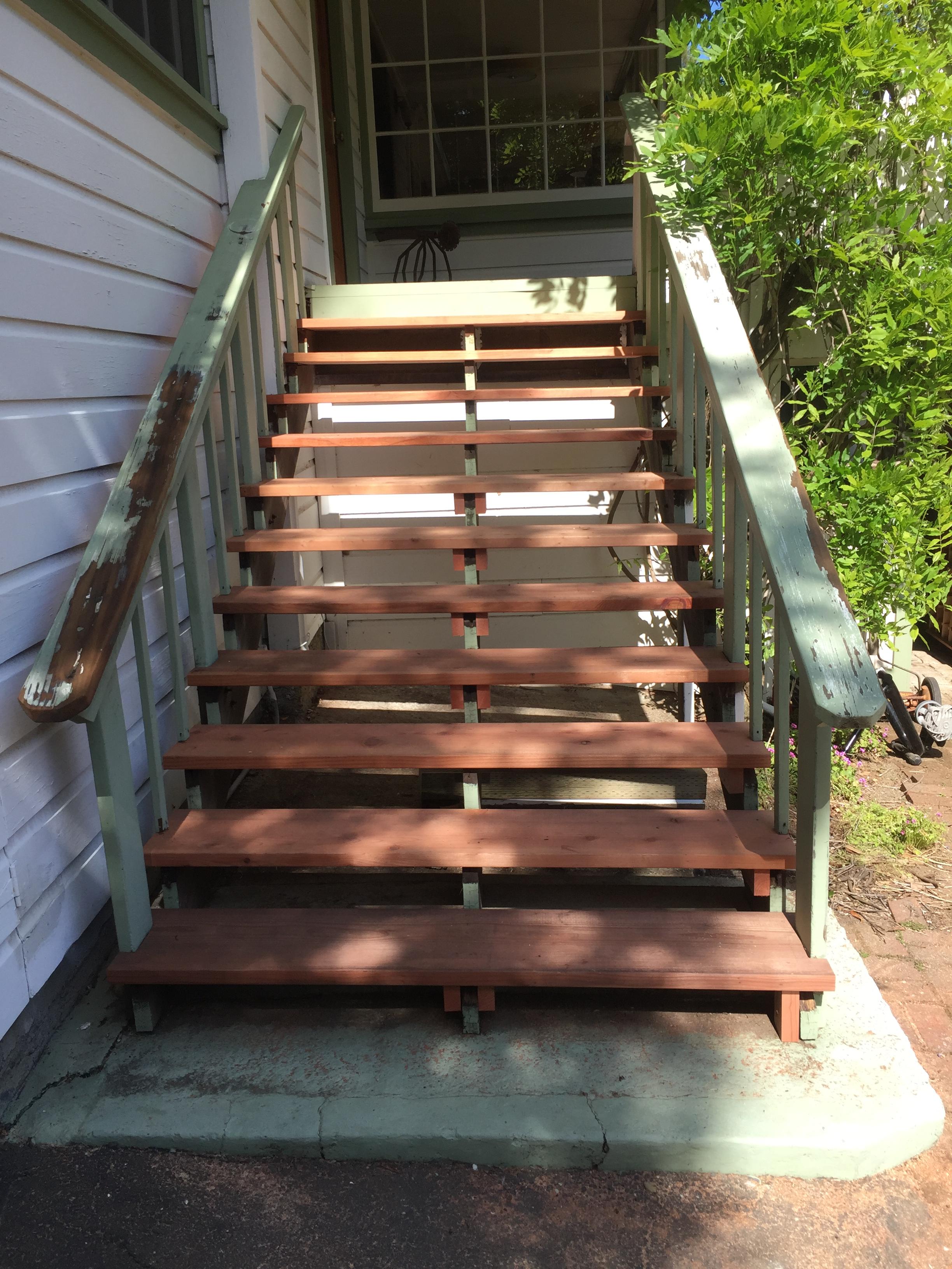

Voltron Posted April 15, 2018 Report Share Posted April 15, 2018 Stairs went in easy yesterday. Solid as a rock. Not sure these beams holding up our front porch had to be replaced, but we did it anyway. 10 4 Quote Link to comment Share on other sites More sharing options...

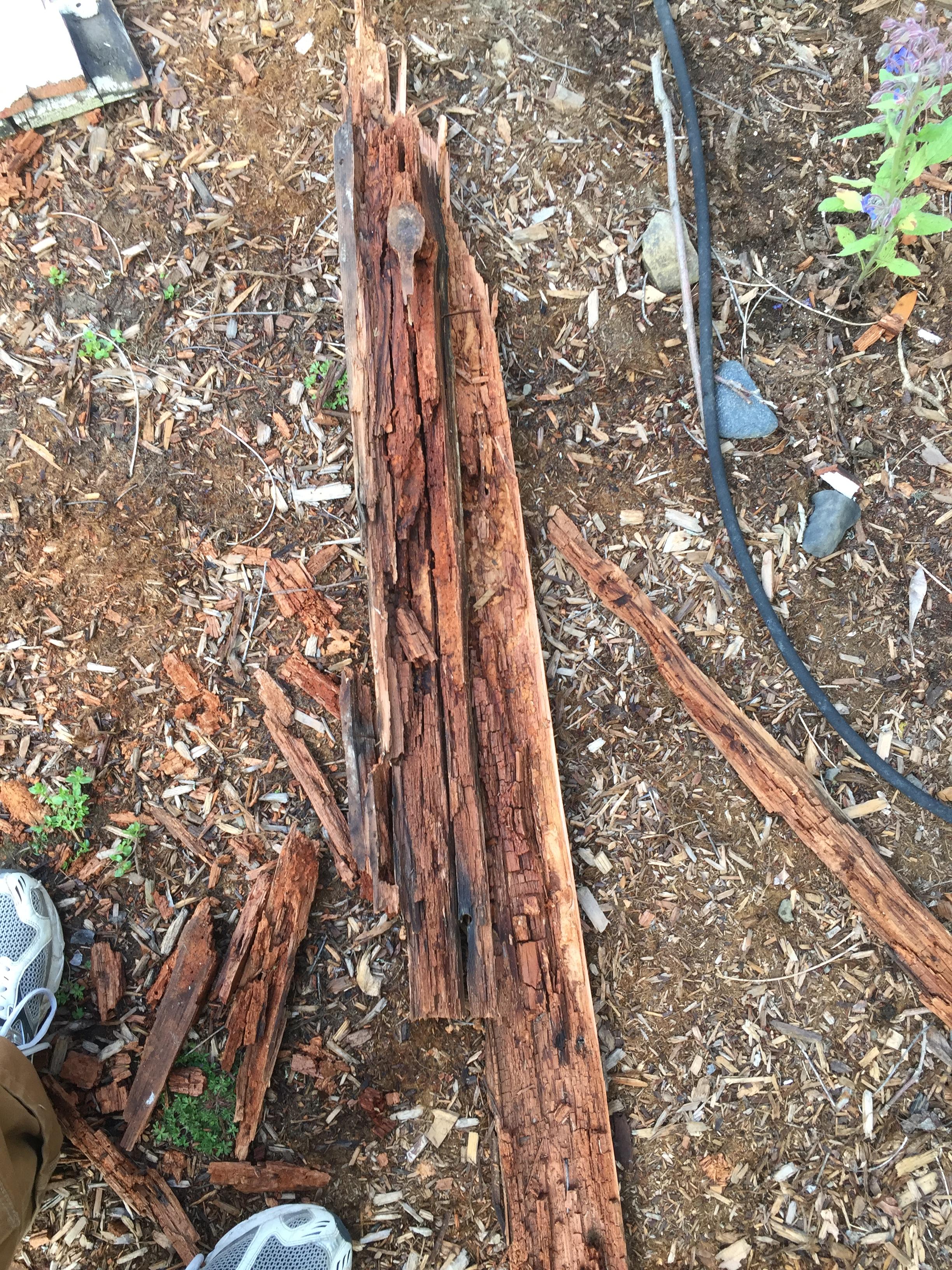

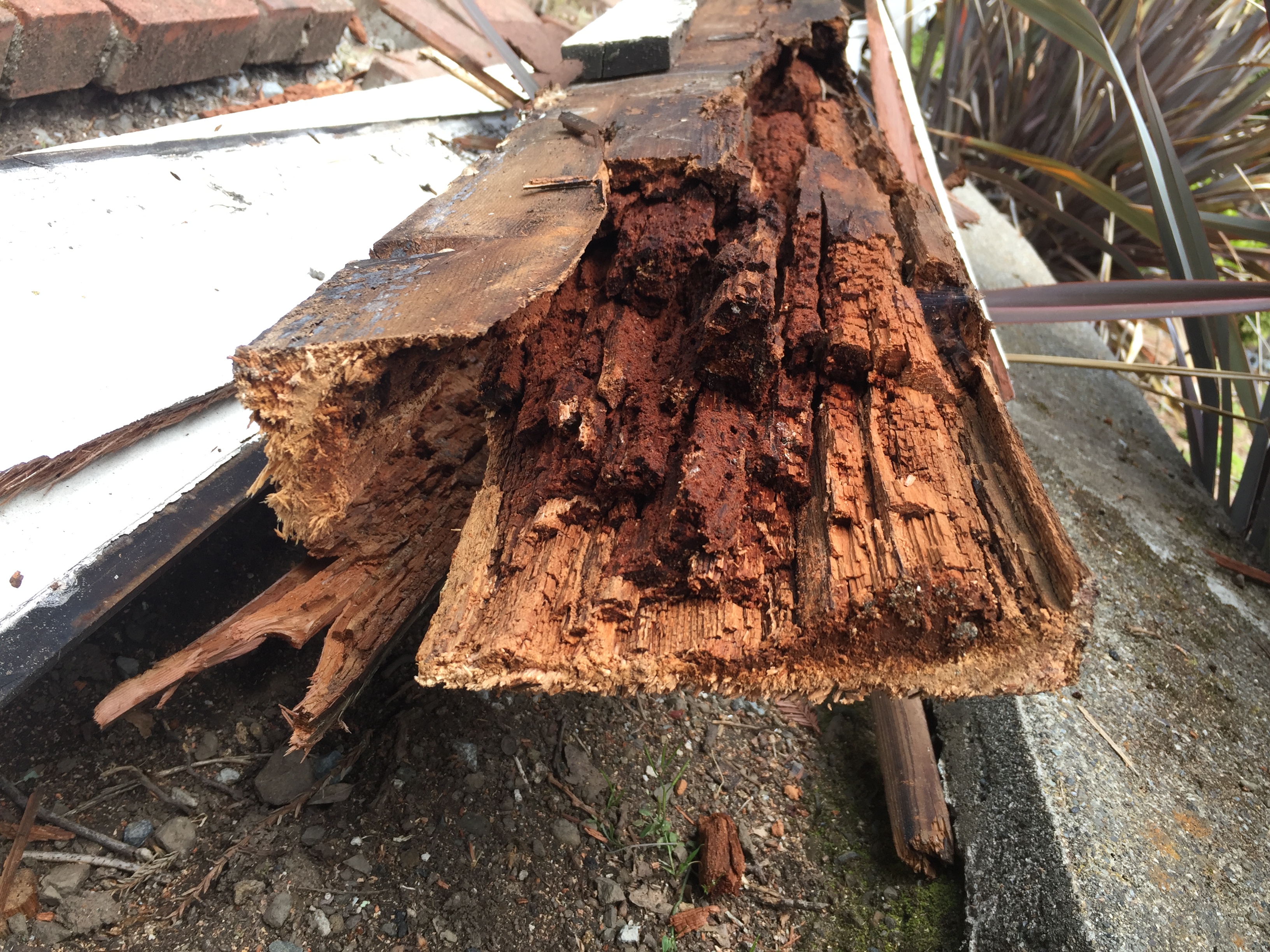

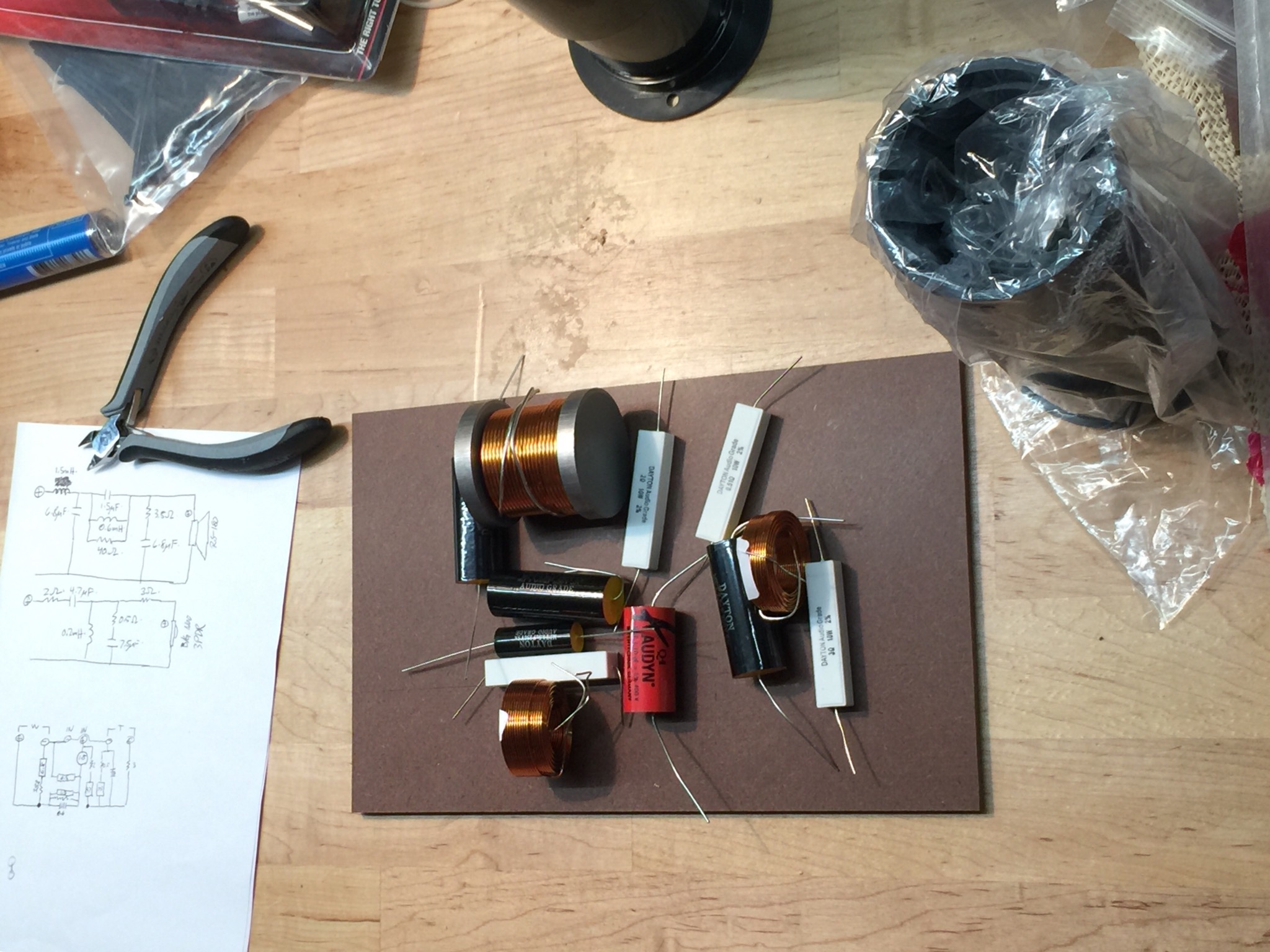

Voltron Posted April 16, 2018 Report Share Posted April 16, 2018 It stopped raining long enough to take a couple of pics of the beams we replaced. I'm especially psyched about the LVL that replaced a completely rotten beam perpendicular to the house. And now we've turned into an electronics shop with Dr. Luvdunhill building the crossovers for Otis's speakers. 13 Quote Link to comment Share on other sites More sharing options...

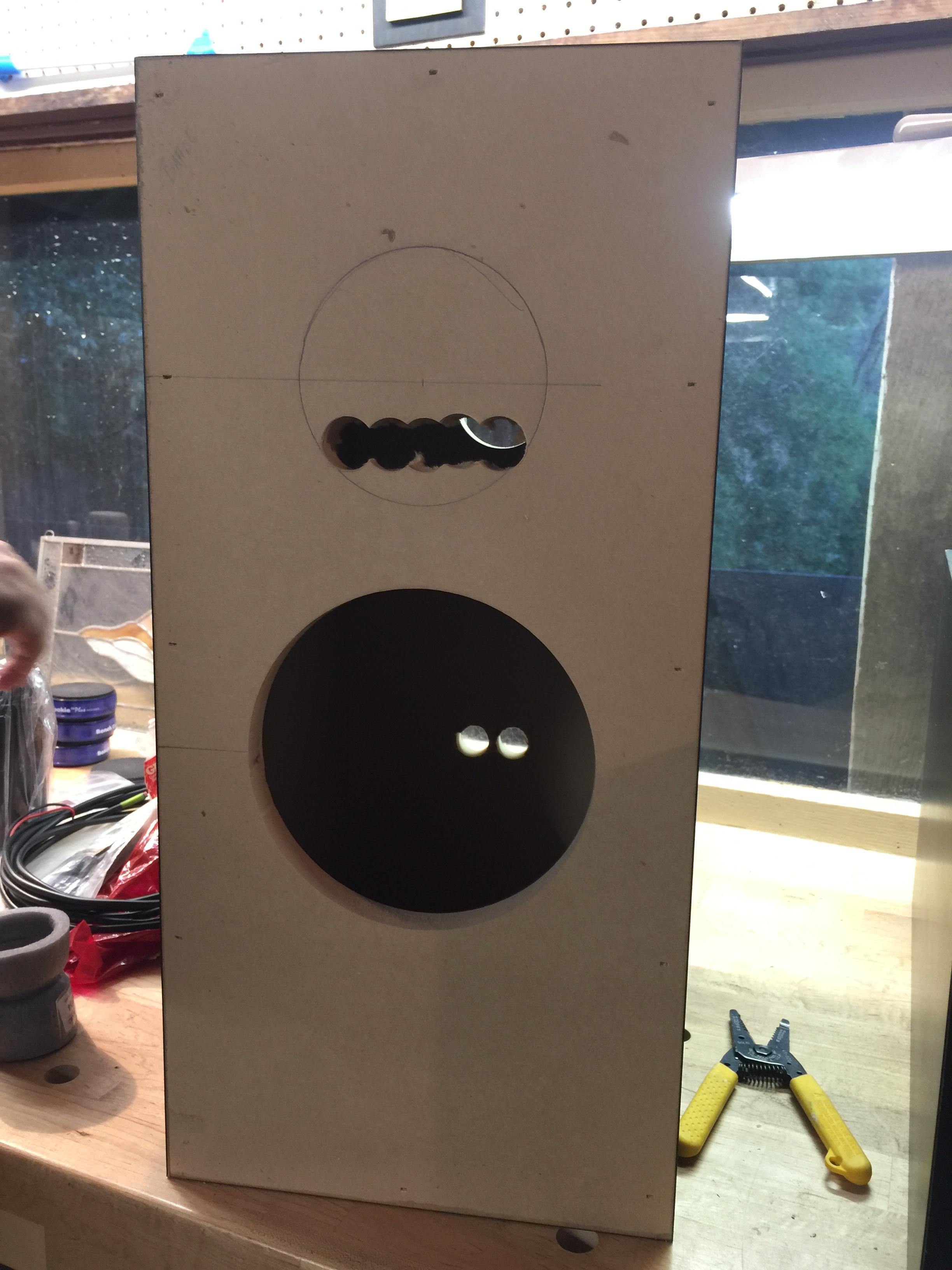

swt61 Posted April 16, 2018 Report Share Posted April 16, 2018 I had a pair of these... And a 50" Panny Plasma in a small class C motorhome. This will be a walk in the park. We got one crossover finished, will most likely finish the other Tuesday eve. I'll glue on the Cherry baffles tonight, then it's just a matter of soldering on a few spade lugs. 8 Quote Link to comment Share on other sites More sharing options...

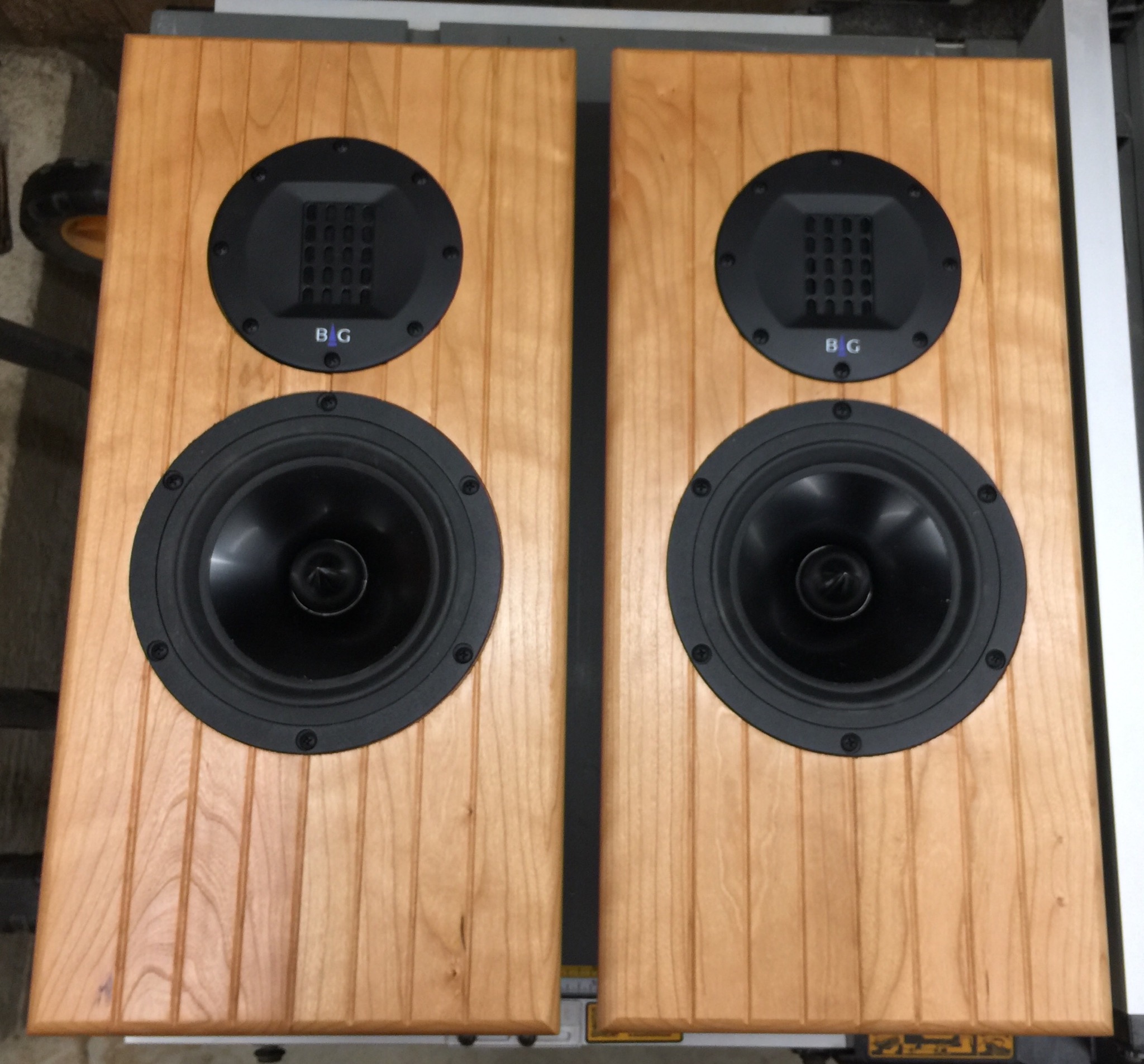

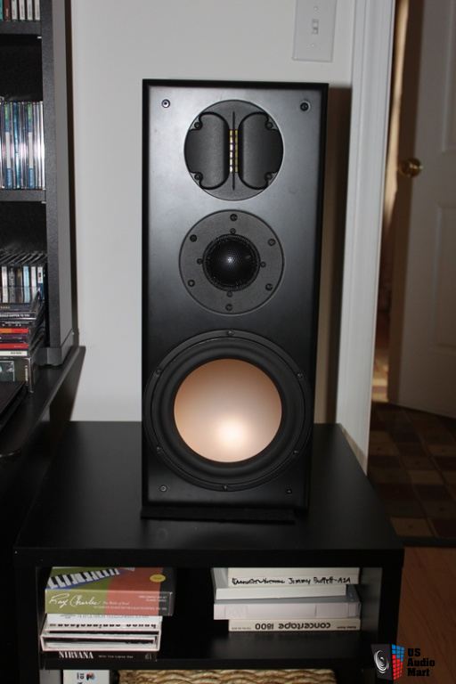

swt61 Posted April 21, 2018 Report Share Posted April 21, 2018 Done! These are not just your standard two ways. Instead, Marc has paired basically a full range driver and a super tweeter, then customized a crossover to take best advantage of that pairing. These drivers have to stretch their legs before I can really assess them, but so far I'm impressed. They're bigger than I had originally thought I'd build them, but still, make a pretty good nearfield monitor. Bass is far better than I expected. Eventually, they will darken to match the Parasound case. The window will speed that process up. 16 Quote Link to comment Share on other sites More sharing options...
luvdunhill Posted April 21, 2018 Author Report Share Posted April 21, 2018 Also, both those drivers are magneticly shielded - so no fear putting sensitive things nearby [emoji4] First time really pushing the boundary of a woofer up to the higher end, had to control cone breakup in the crossover, but curious how it ends up. One huge benefit is a wide sweet spot and great imaging. It does simulate well, that’s all that counts, right? Quote Link to comment Share on other sites More sharing options...
swt61 Posted April 21, 2018 Report Share Posted April 21, 2018 Acoustic guitar is wonderful. Haven't really rocked out yet, still loving Alison Krauss and Adele ATM. Hey, I'm gay, what'd you expect? 2 Quote Link to comment Share on other sites More sharing options...
dsavitsk Posted April 21, 2018 Report Share Posted April 21, 2018 35 minutes ago, luvdunhill said: Also, both those drivers are magneticly shielded - so no fear putting sensitive things nearby Maybe I missed this earlier - what are the drivers? And is it basically a 25 liter sealed box? Quote Link to comment Share on other sites More sharing options...
luvdunhill Posted April 21, 2018 Author Report Share Posted April 21, 2018 Maybe I missed this earlier - what are the drivers? And is it basically a 25 liter sealed box? It’s a ported box, a bit smaller than 0.75 cu ft. Dayton Audio with BG ribbon. I can post more info in a bit, heading out of the house. Quote Link to comment Share on other sites More sharing options...
swt61 Posted April 21, 2018 Report Share Posted April 21, 2018 .73 cubic feet. w /2" x 6" port behind the tweeter. Quote Link to comment Share on other sites More sharing options...

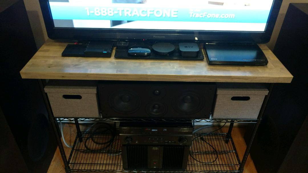

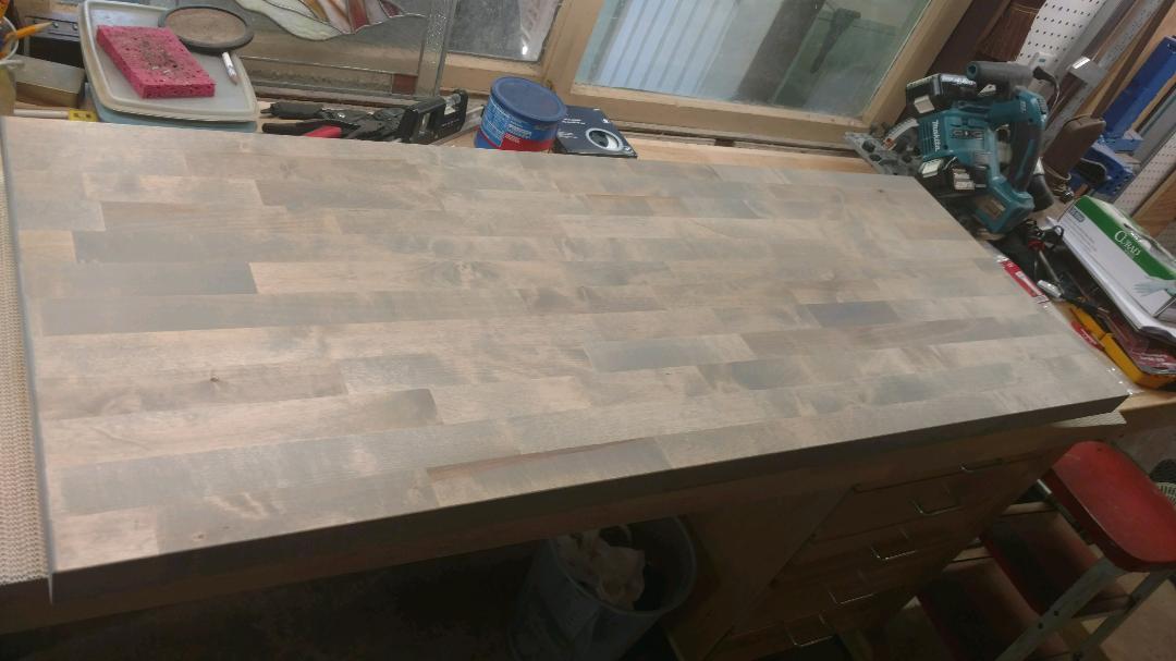

swt61 Posted April 22, 2018 Report Share Posted April 22, 2018 Today's project... 50" X 19" Birch butcher block, stained Gray. This will be the top of my new A/V rack, which is your typical wire shelving, but epoxy coated Black. 11 Quote Link to comment Share on other sites More sharing options...

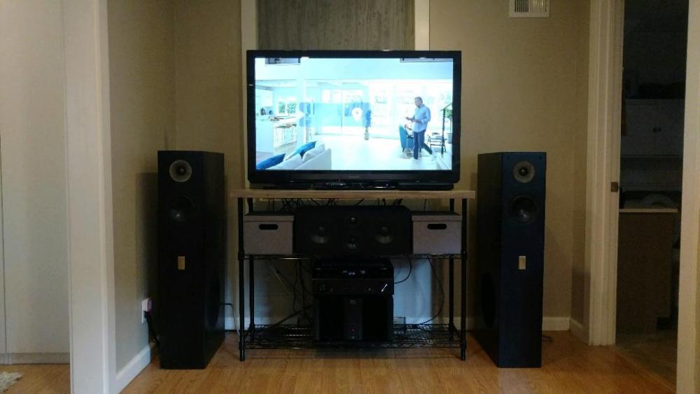

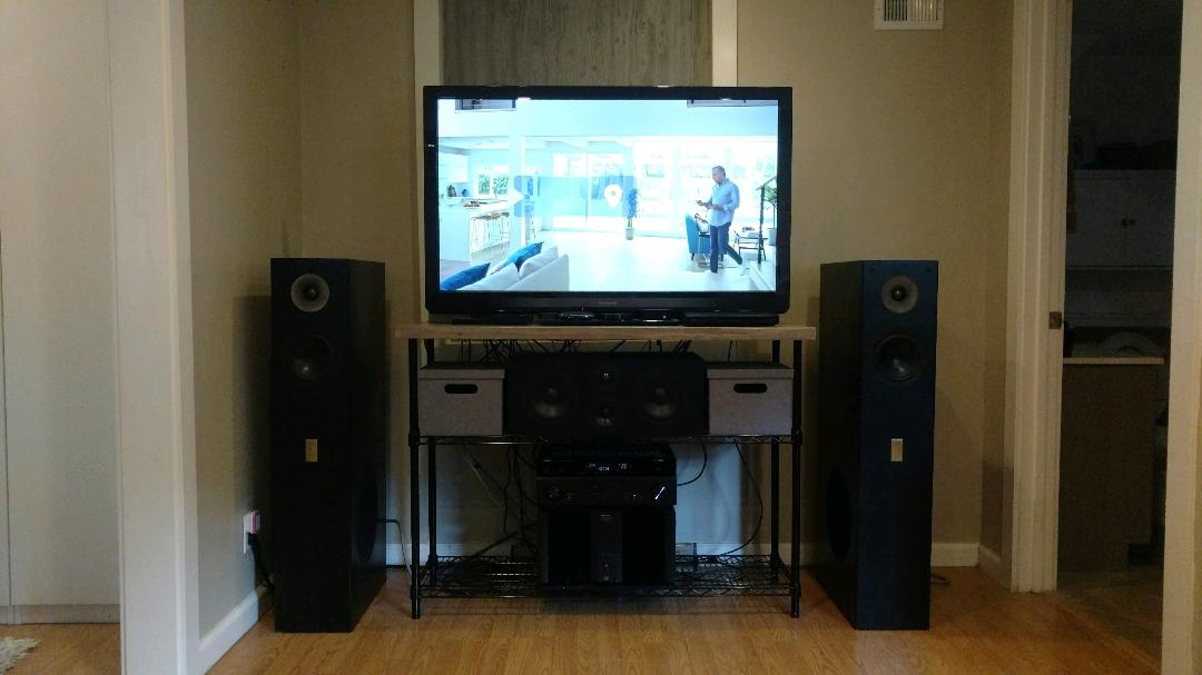

swt61 Posted April 28, 2018 Report Share Posted April 28, 2018 The new A/V rack... The Gray stain on the butcher block is subtle, but Grayer in person. 14 Quote Link to comment Share on other sites More sharing options...

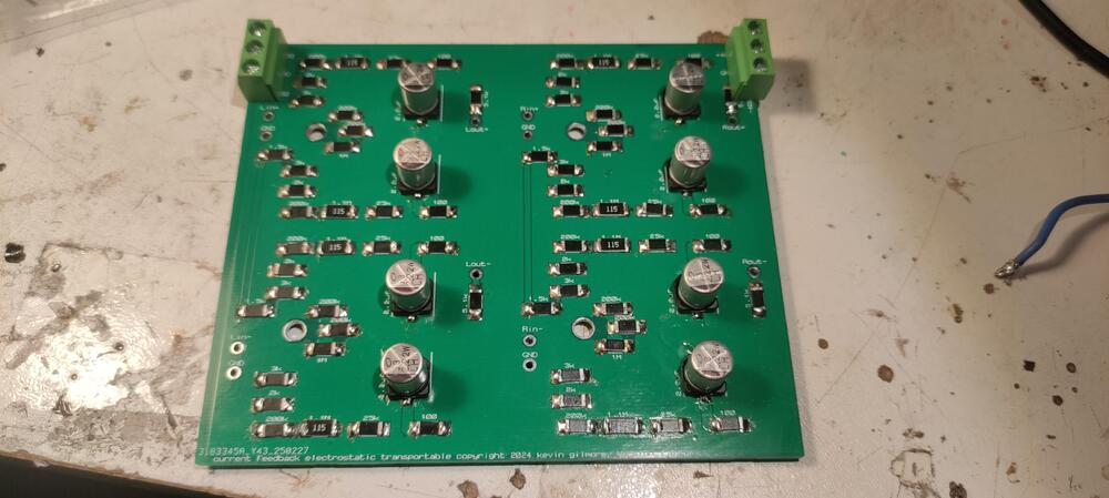

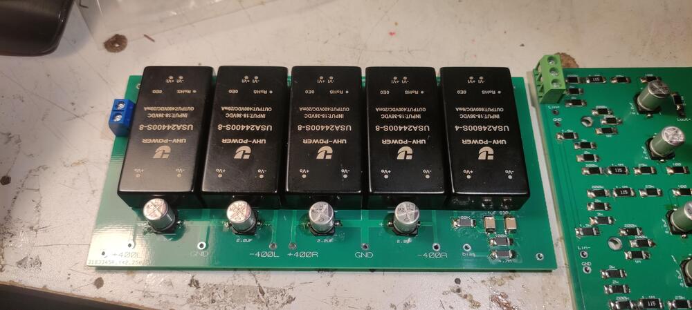

mypasswordis Posted April 30, 2018 Report Share Posted April 30, 2018 (edited) Can't find the right bolts and screws as usual :/ next up are the heatsinks Oh yeah and I forgot, happy belated birthday to Kevin! Edited April 30, 2018 by mypasswordis 11 Quote Link to comment Share on other sites More sharing options...

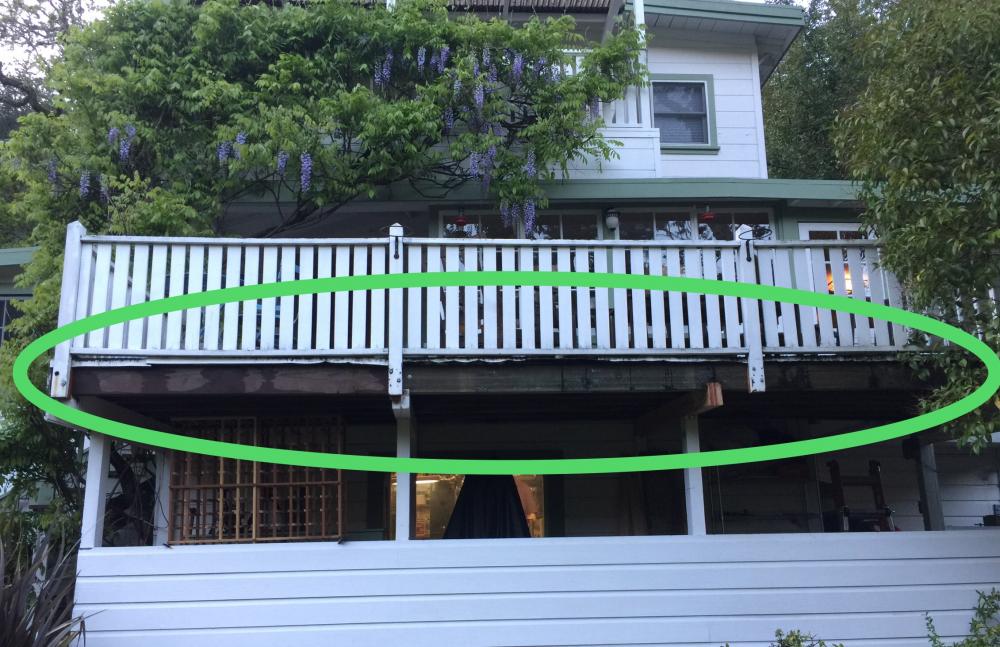

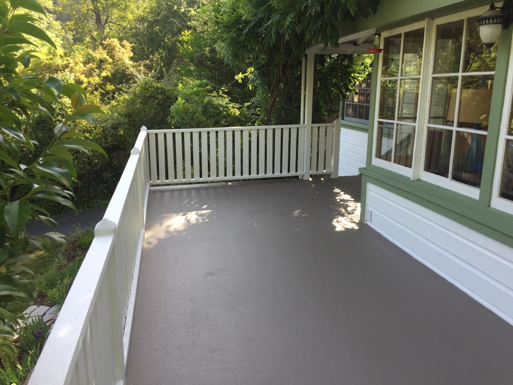

Voltron Posted May 11, 2018 Report Share Posted May 11, 2018 Finished the porch and it simply looks like it did before, just better built, clean, well painted, waterproof, solid and safe. 18 Quote Link to comment Share on other sites More sharing options...
swt61 Posted May 11, 2018 Report Share Posted May 11, 2018 That turned out fantastic! And I love that the rail bottoms were raised, so as not to catch debris and water anymore. Should last a good long time. I hope you pay Milo well, as he's a pretty good hand. 1 Quote Link to comment Share on other sites More sharing options...
