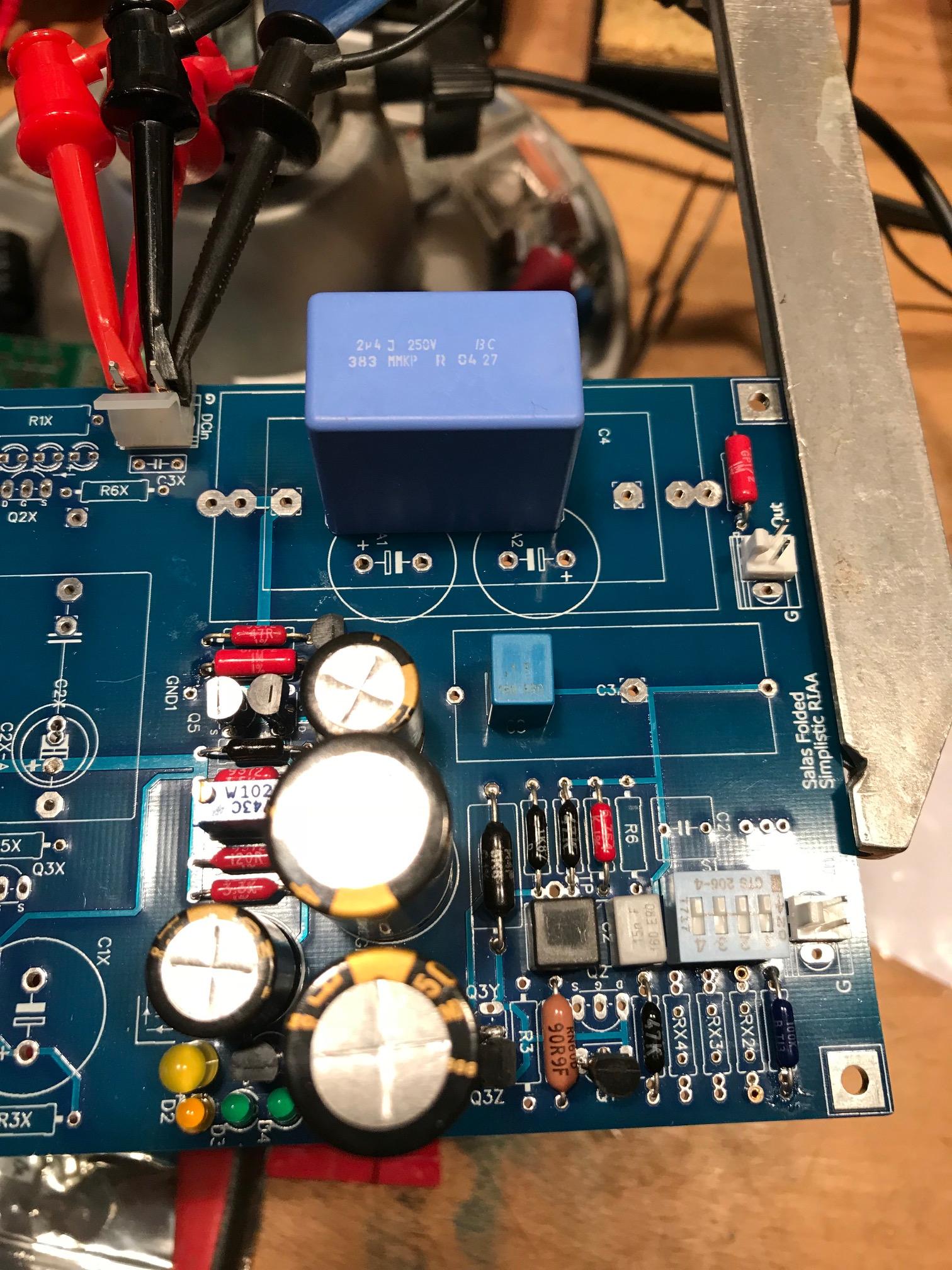

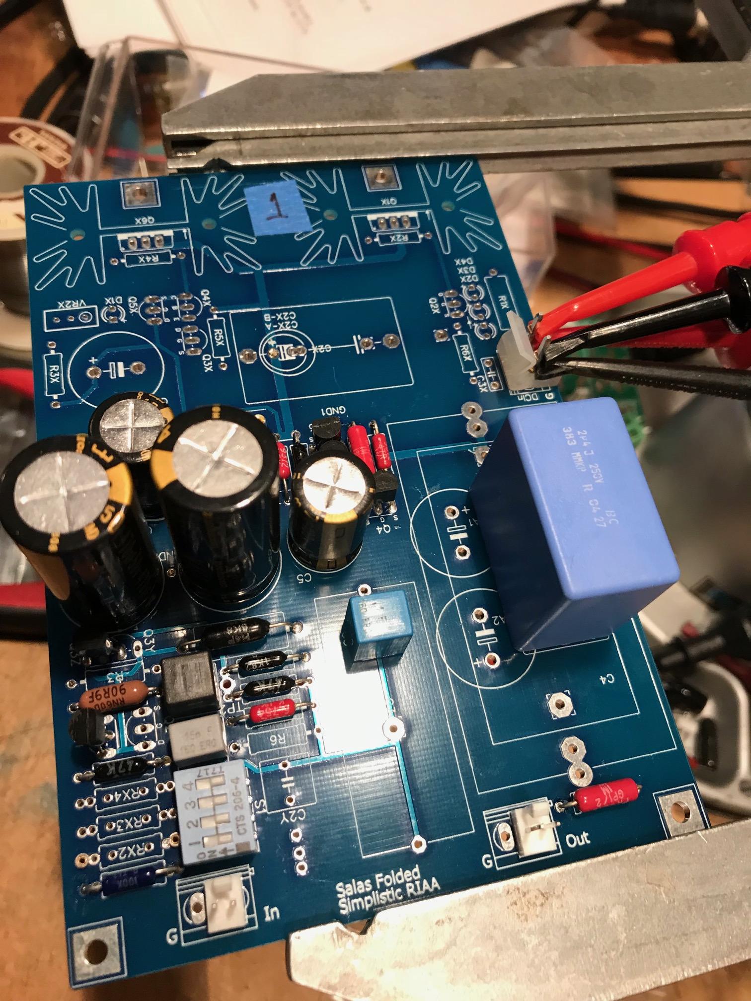

Me: Salas Folded Simplistic Phono stage. I did my own board layout (in Diptrace), based on the diyaudio board, but made a few changes. I built these with parts I had laying around (other than the 2SK369BL quad from Tea Baf on diya and 2SK117GR JFETs which MA Santos was very kind to send to me, as the ones I had weren't high enough in IDSS). Resistors are a combination of Holco 0.1%, PRP, and for values I didn't have, Welwyn RC55 0.1%. I'll probably replace some of the PRPs with Welwyns as well. The caps I had around (MKP1837 and BC MMKP 383), but will probably replace these with some Mundorf Supremes. Target case is a Modushop Slim Line 1U (team single chassis).
Both boards worked fine on initial power up. I am currently leaning towards powering these with either 1 or 2 GRLV plus boards set at 35V (have one built and tested).
If anyone has a good reason to instead use the Salas shunt regs (which I have on the boards, just not populated), let me know what you think. I know a lot of people ooh and ahh over shunt regs, but I'm not quite so sure they are automatically better than a good linear regulator such as the GRLV. Salas' do have a good reputation however.

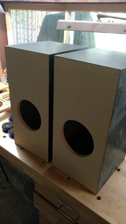

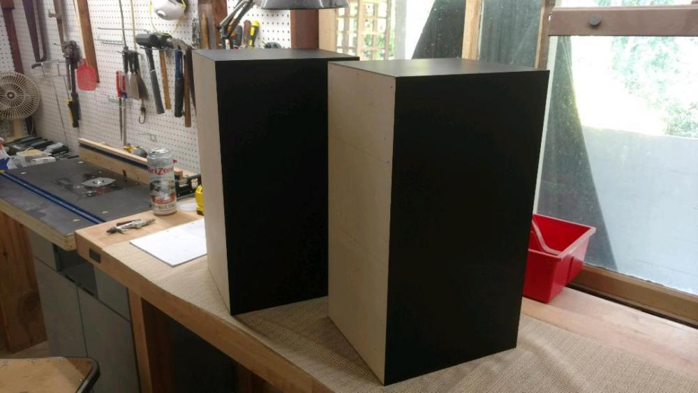

Speaker boxes now clad in Black laminate, because we had enough left over from the router table project...

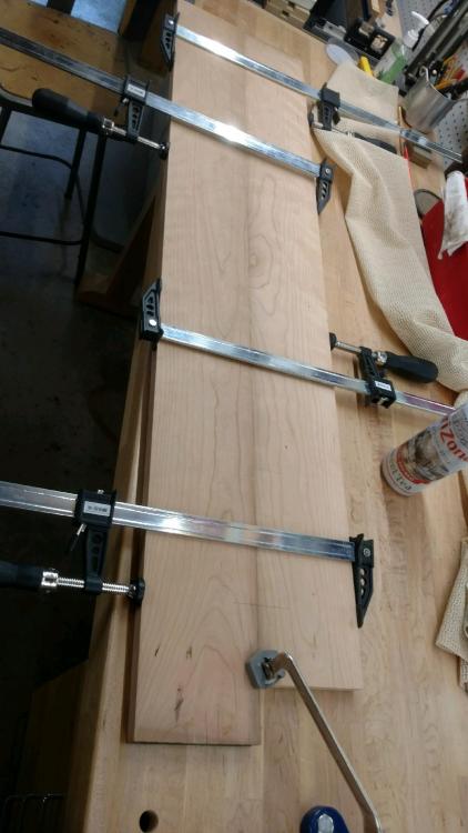

Making a solid Cherry 3/4" thick baffle to glue on top of MDF baffles...

  • Like 7

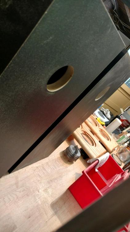

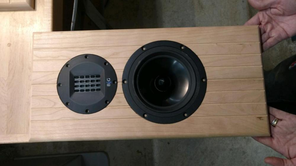

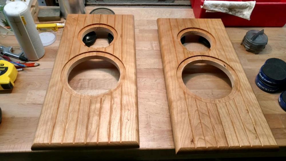

Milo and I got the speaker boxes mostly complete today. Made some round holes and some rectangular panels.
Tweeter holes are in the Cherry baffles only, as they're not deep enough to need holes in the MDF panel too. Woofer holes and port tube holes in back.
Cherry baffles got milled and drilled as well. And the first coat of Arm-R-Seal. The fluting is strictly aesthetics.
  • Like 19

Posted
Very nice Steve (and Milo)!
So you like Arm-R-Seal? I've always used Varithane. Is something like Arm-R-Seal what you would recommend for a natural cherry finish? Thinking about building a Salamander Synergy clone, but need to draw up plans for it.
Posted
Arm-R-Seal is a urethane modified Tung oil. You get the beauty of Tung oil and the durability of Varithane. Plus it's a wipe on finish, so easy as pie.Ā
