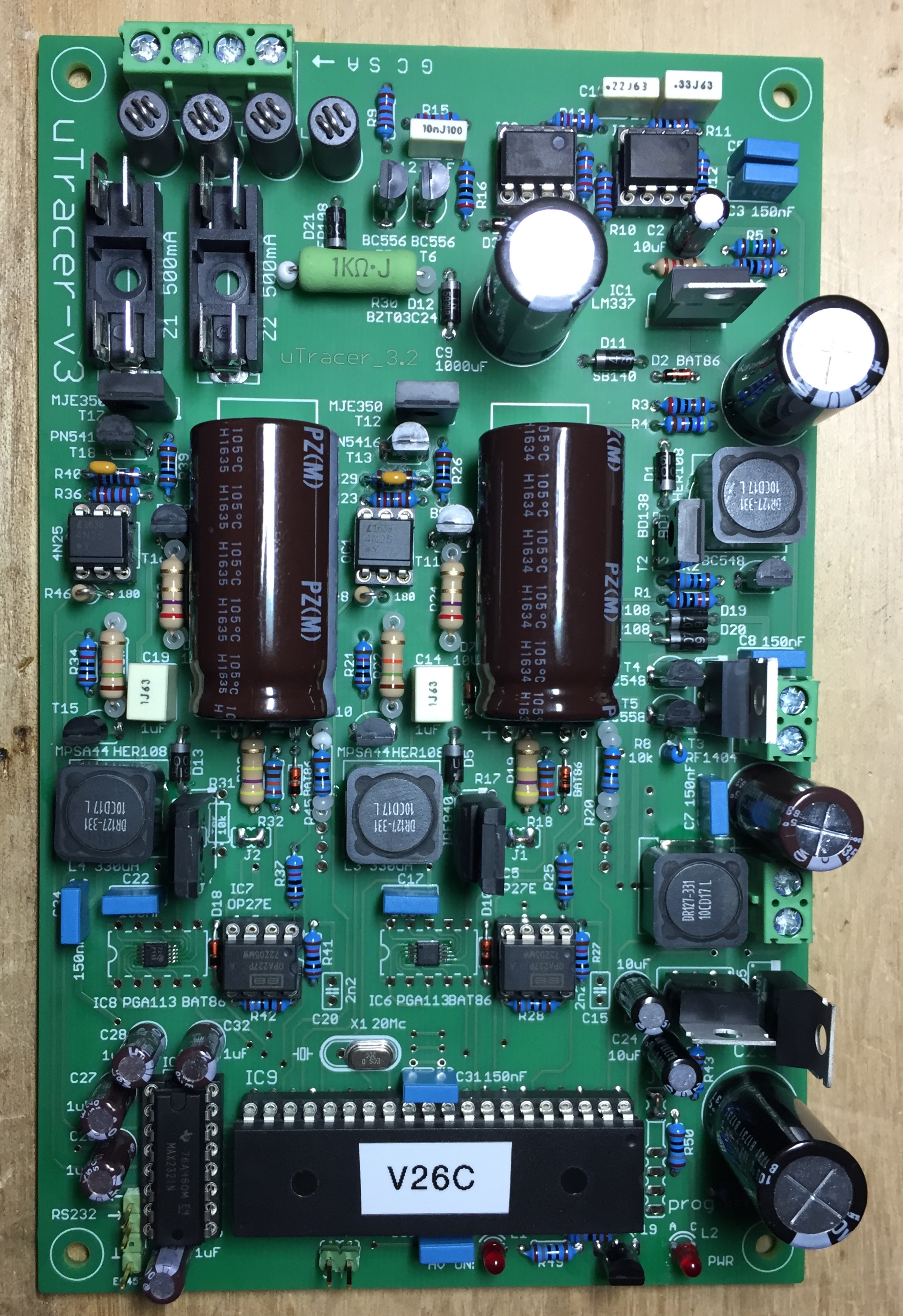

Kerry Posted February 26, 2018 Report Posted February 26, 2018 I just finished building the uTracer 3+. Works nice. Needless to say I spent the day yesterday measuring tubes. 14 Quote

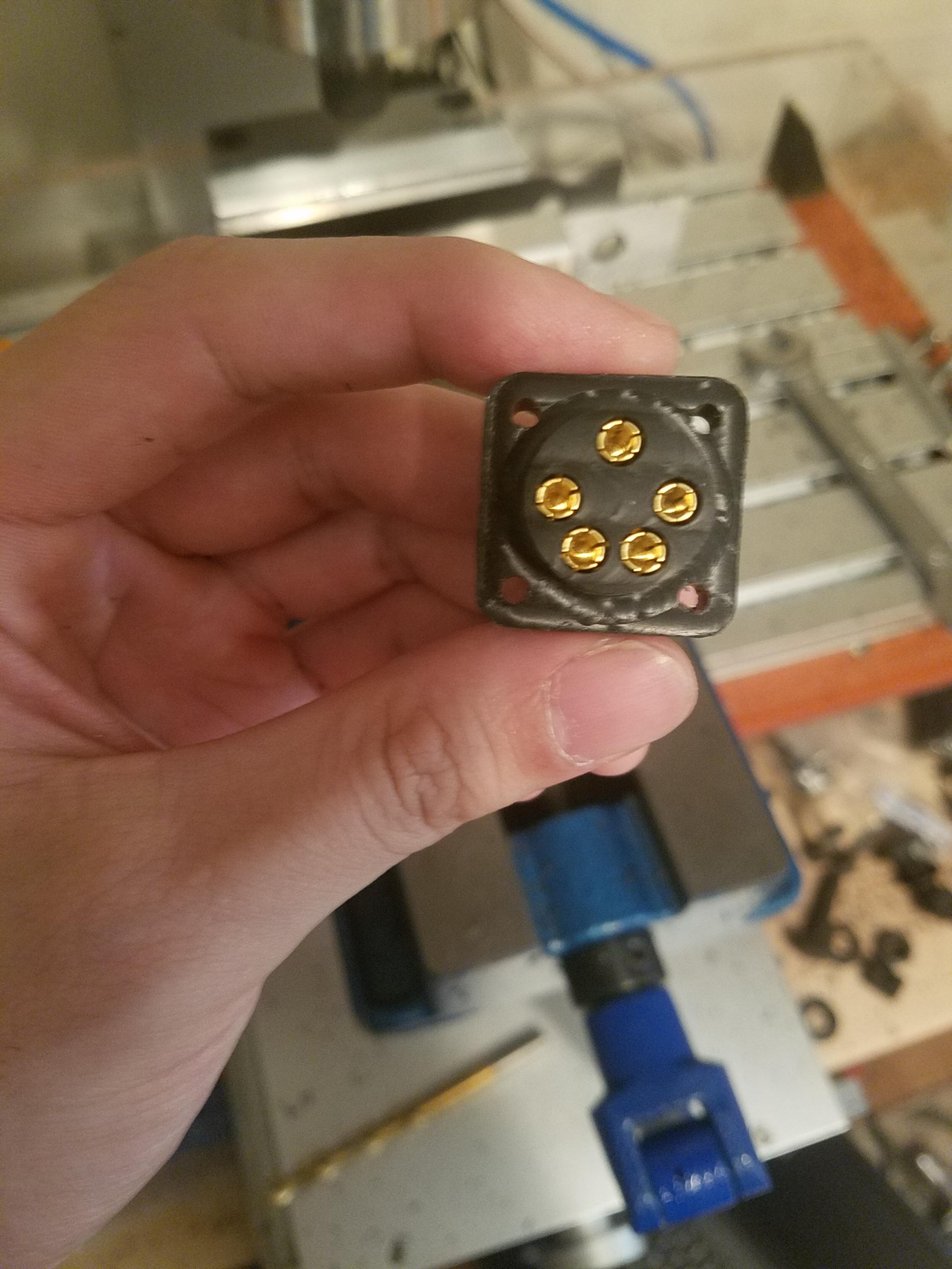

mypasswordis Posted March 4, 2018 Report Posted March 4, 2018 Turns out what are finishing passes in aluminum are not the same in Delrin. Everything surprisingly fits exactly though, except I made the holes on the other side about .1mm too small. I checked with some stax plugs and it fits those nicely too. 7 Quote
Pars Posted March 5, 2018 Report Posted March 5, 2018 Nice! Looks like you have some sort of drill press vise? I need to get one better than the POS Harbor Freight one I have. Yours looks nice! Is it an add-on? Quote
