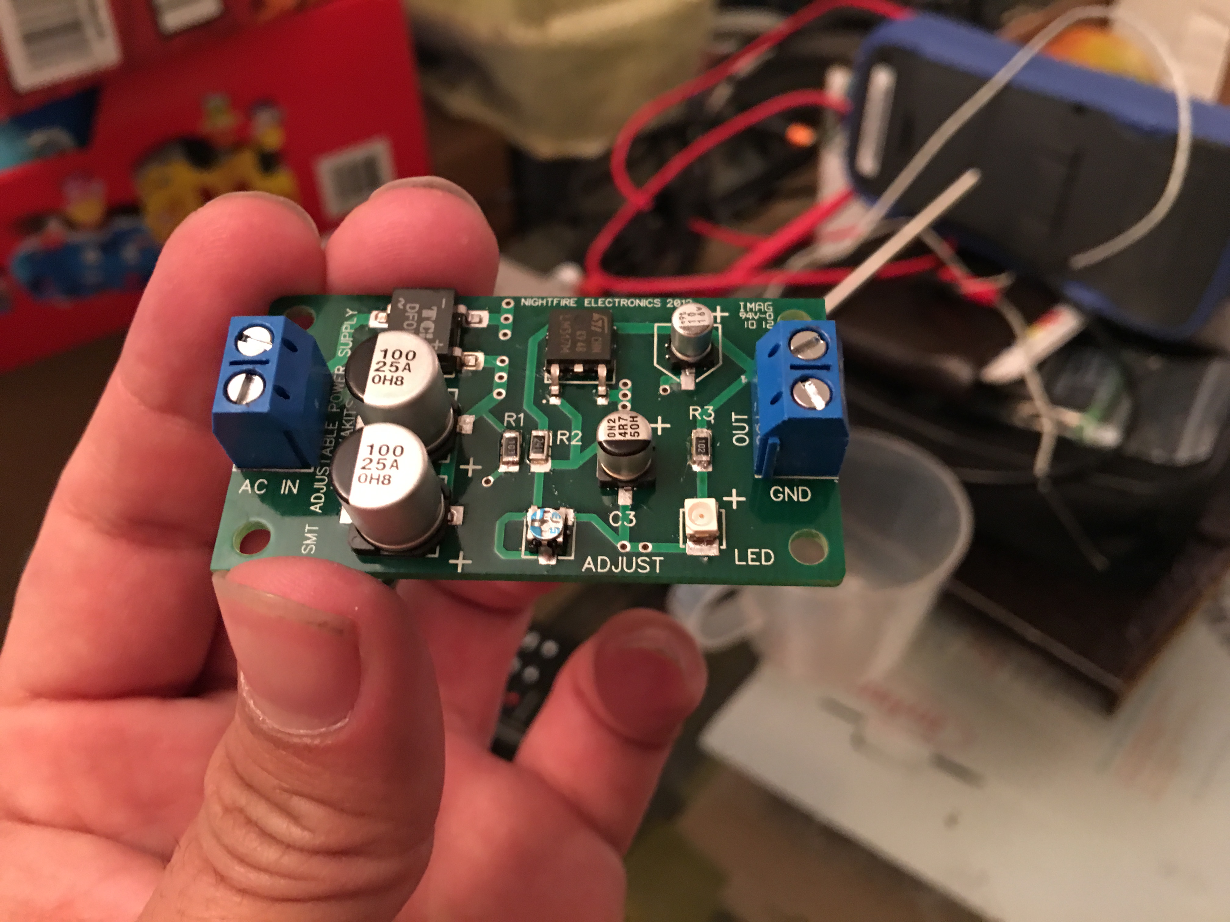

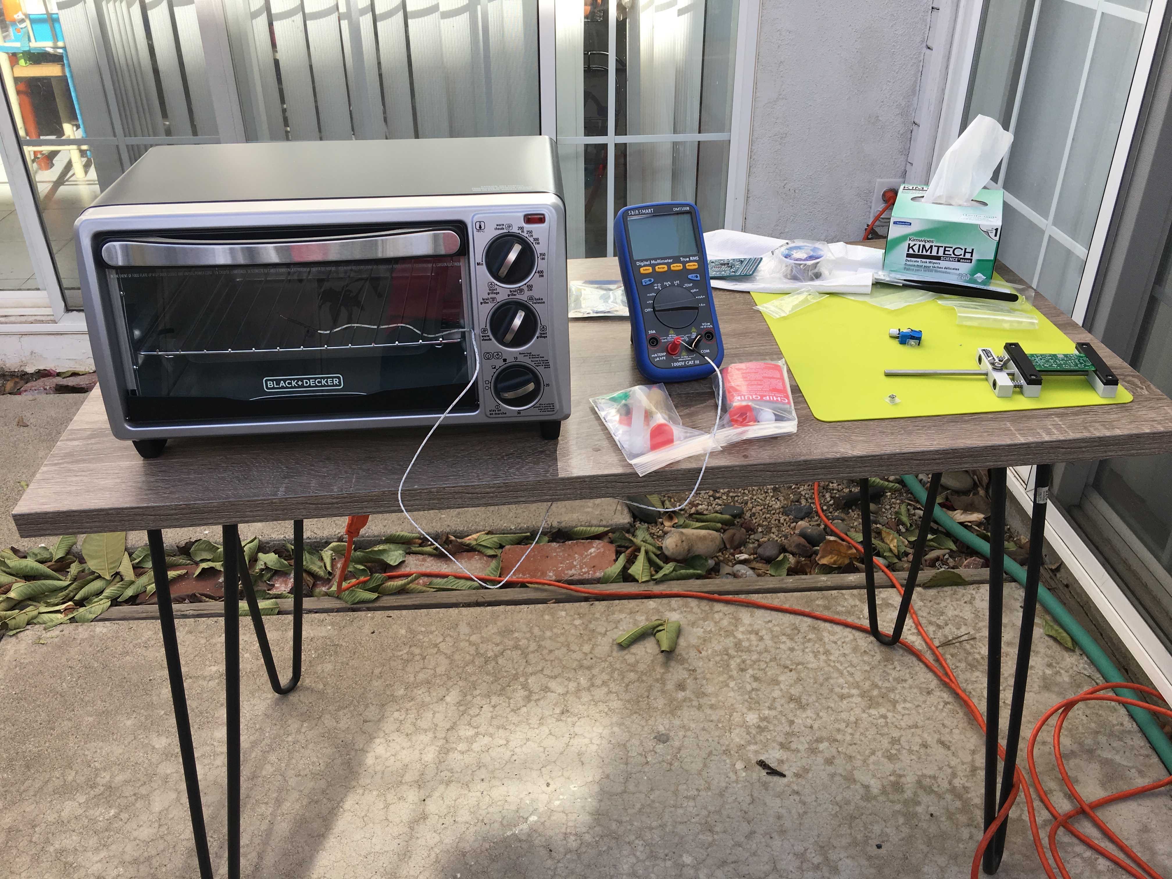

cspirou Posted December 9, 2017 Report Posted December 9, 2017 (edited) So I thought I would try out reflow oven soldering with a toaster oven. The AMB regulators for the Dynalo Mini are $40 whereas the toaster oven was practically free. I figured trying to solder with the toaster would be worth a try. It would also help with all the other SMD projects I have. I don't have a controller for now so I did it manually. As a test I bought an SMT adjustable power supply kit from Nightfire electronics. I had a little too much solder for the LM317 and one resistor didn't self-center but I'm pretty satisfied with the result. I'm thinking about using this for the R2R attenuator board. Anyone know what the procedure is for doing reflow on 2 sided boards? Edited February 28, 2018 by cspirou 3 Quote
JoaMat Posted December 9, 2017 Report Posted December 9, 2017 Nice, manual control seems to work well. 1 Quote

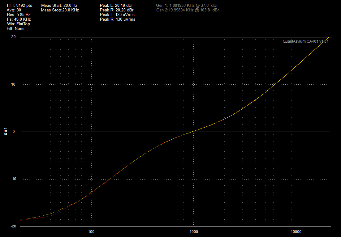

luvdunhill Posted December 22, 2017 Author Report Posted December 22, 2017 (edited) Inverse RIAA filter (have some extra PCBs, if anyone is interested) Edited December 22, 2017 by luvdunhill 4 Quote

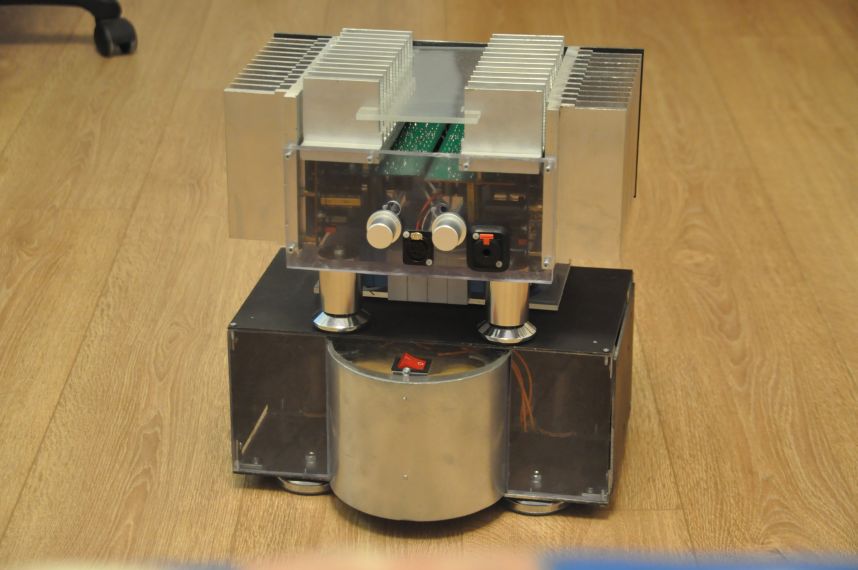

bbest Posted January 5, 2018 Report Posted January 5, 2018 Were made 2 years ago. But wanted to post it here. Balanced Beta22. Weight ~ 22kg. More photos on https://cloud.mail.ru/public/HozE/Ap7NVDRwo 1 Quote
gepardcv Posted January 6, 2018 Report Posted January 6, 2018 That looks like an adorable robot. Quote
bbest Posted January 8, 2018 Report Posted January 8, 2018 On 1/6/2018 at 5:43 AM, gepardcv said: That looks like an adorable robot. On Ti Kan forum wrote Quote A Russian military style built! Unusual and cool. This amp will never overheat. Quote

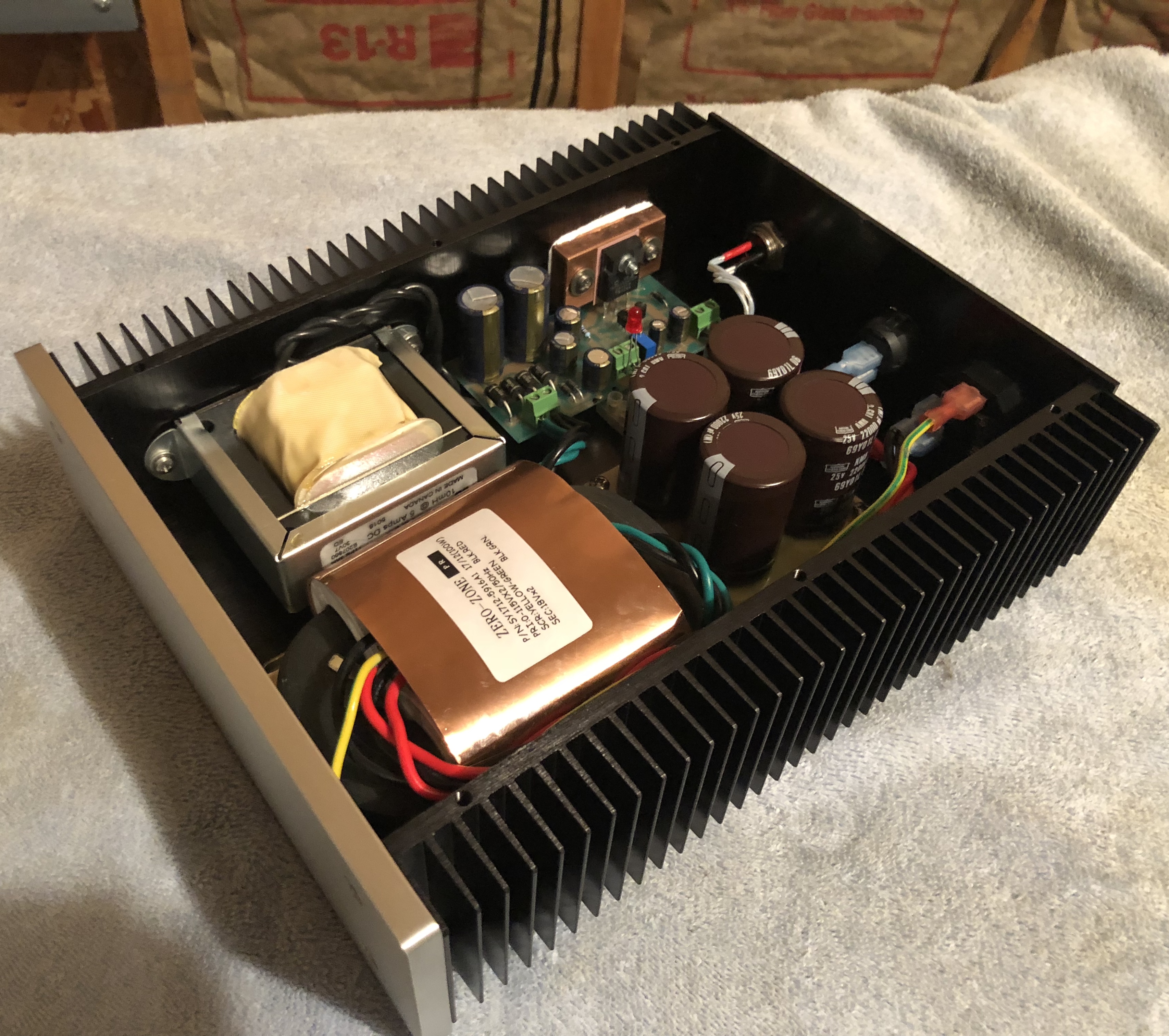

Laowei Posted January 15, 2018 Report Posted January 15, 2018 Mostly a packaging job. Had around an old Paul Hynes PR-3HD 18.5VDC voltage regulator and 2x 18VAC Rcore transformer I bought years ago to use in powering an old Mac mini. It’s capacitor input. Wanted remake as a 12VDC supply and was able to adjust it to design. Bought a bare case off eBay. Added a inductor and capacitor bank to use as choke input expecting ~35% rectified DC voltage drop. Powers up no-load OK. Need to now get some power resistors to stress test at 5A to see if drop out is exceeded and starves the regulator. Might have to go to a 2x 22VAC. 3 Quote
mypasswordis Posted January 17, 2018 Report Posted January 17, 2018 @Laowei wow someone measured a few times before putting everything into the chassis Nice Finally about to finish up a solenoid driver board to send out. Was gonna make it smaller but got too lazy 3 Quote

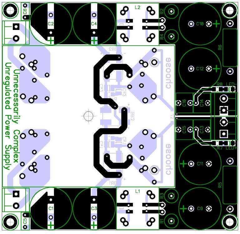

luvdunhill Posted January 28, 2018 Author Report Posted January 28, 2018 (edited) 15 hours ago, UFN said: One thought of mine was a steady stream of swear words upon realising that the footprints of PCB mount transformers aren't always 100% identical between manufacturers [emoji57] I waited a couple of weeks for boards only to realise that the secondary side footprints were off by 0.2" because I chose a different manufacturer, but the physical size of the transformer was identical. This obviously doesn't apply to e.g. the Talema PCB mount toroids, but it's worth remembering to always check the manufacturers datasheets [emoji4] Other than that I think it is a great idea for transformers under 30VA or so, because PCB mounting is more flexible than bolt mounting IME [emoji4] I have a nearly universal footprint. It pretty much confirms that every vendor is slightly different. The board looks like crap - plenty of nearly overlapping drill hits. Edited January 28, 2018 by luvdunhill 2 Quote
mypasswordis Posted January 28, 2018 Report Posted January 28, 2018 Cool, do you have a list of which ones fit the board? Looked at the Talema units but Digikey doesn't have the one I want in stock :/ went with a Triad. I assume it works well with no noise or EMI issues? Quote
luvdunhill Posted January 28, 2018 Author Report Posted January 28, 2018 Triad, Hammond, Talema, Block and whatever else I had. Seems to work well. I might have a few transformers and boards left? I will look next week. 1 Quote

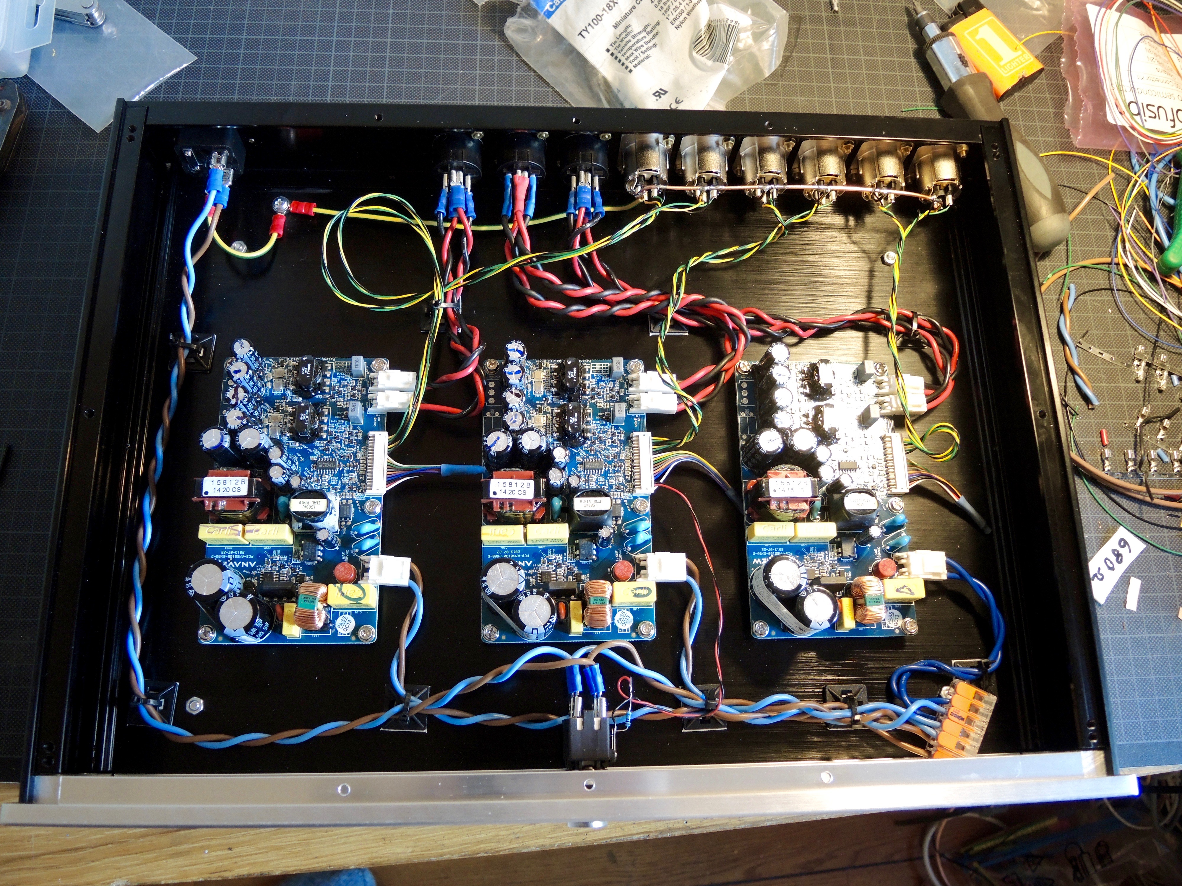

bjarnetv Posted February 5, 2018 Report Posted February 5, 2018 Finished up a 6 channel Anaview AMS0100 to use with my horns, as the old amps were to noisy. A pretty plug and play build by DIY-standards, but since it was my first try that suited me just fine. Only had the time to plug it in and check the channel routing using test noises, so i haven't tried playing music on it yet, but hopefully everything will be ok when i try it out later today. I still have a Holton NXV500 to build, which is a bit more difficult, so having this as a warmup to get rid of my cabinet-drilling fright was perfect 1 Quote
