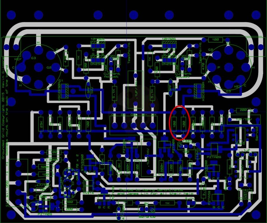

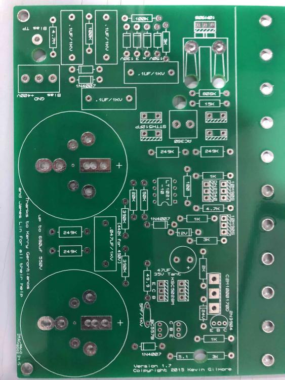

chinsettawong Posted May 8, 2018 Report Posted May 8, 2018 22 hours ago, sorenb said: lower the tail resistor by some ~50ohms and re-adjust Are these the two resistors that I should replace? Quote
mwl168 Posted May 8, 2018 Report Posted May 8, 2018 (edited) No, I think it’s the 120R resistor below, right of the 50K resistor and left of the 12V zener. Need to confirm with the schematic - it’s the resistor between the offset trim pot and B- in series. Edited May 8, 2018 by mwl168 2 1 Quote
spritzer Posted May 8, 2018 Report Posted May 8, 2018 Yup, the 120R resistor. Measure from B- to the other side of the pot and then you'll know if you need a larger or smaller value. 1 Quote
chinsettawong Posted May 9, 2018 Report Posted May 9, 2018 It sings! Thanks for all your advices. For some reasons, the silkscreen on my PCB asks for 250 ohm for tail resistors. I replace it with 120 ohm and now everything can be adjusted correctly. Now I need to work on the top cover. The amp sounds awesome. 9 Quote

chinsettawong Posted May 22, 2018 Report Posted May 22, 2018 I need a little help here. When the amp is running, my B+ voltage keeps on swinging between 370-410V while B- is stable at 465V. Is my B+ supply running out of juice? What can I do to fix? I'm using this PS board. Quote
kevin gilmore Posted May 22, 2018 Author Report Posted May 22, 2018 try removing the 2n3904 current limit transistor if the voltage is right without any load Quote
chinsettawong Posted May 22, 2018 Report Posted May 22, 2018 The voltage was about 465V without load. Took out the 2n3904 and connected the amp board. Fired the amp up and the B+ became around -12V. Switched it off and the voltage gradually came up to around 45V then went down to 0. Can I try to change some R to increase the current limit a bit more instead of taking the 2n3904 out? Quote
Blueman2 Posted May 22, 2018 Report Posted May 22, 2018 (edited) 3 hours ago, chinsettawong said: The voltage was about 465V without load. Took out the 2n3904 and connected the amp board. Fired the amp up and the B+ became around -12V. Switched it off and the voltage gradually came up to around 45V then went down to 0. Can I try to change some R to increase the current limit a bit more instead of taking the 2n3904 out? I had this issue with my Blue Hawaii. It was drawing more power than the GRHV was set to output. As I recall, I changed the 5R1 resistor (the large 3W one) to 2R5 or thereabouts and that solved the issue. I just soldered another 5R1 on top of the existing one and it worked fine. The 5R1 sets the amount of current that the PSU will supply. Edited May 22, 2018 by Blueman2 2 Quote
sorenb Posted May 22, 2018 Report Posted May 22, 2018 3 hours ago, chinsettawong said: The voltage was about 465V without load. Took out the 2n3904 and connected the amp board. Fired the amp up and the B+ became around -12V. Switched it off and the voltage gradually came up to around 45V then went down to 0. Can I try to change some R to increase the current limit a bit more instead of taking the 2n3904 out? you might check the current sources: Quote
chinsettawong Posted May 27, 2018 Report Posted May 27, 2018 Thank you so much for all your advices. I've finally fixed the problem. The C2M1000170 and 10M90S on my board have gone bad for some reasons. I replaced C2M1000170 with a SCT3080KLGC11 from a local store, and luckily it worked. I parallel the 5R with one more 5R, and now the power supply is working perfectly. The amp has been running for at least 2 hours with no problem. I couldn't have fixed it without your help, Kevin, Blueman2, and Soren. Thanks again. 4 Quote

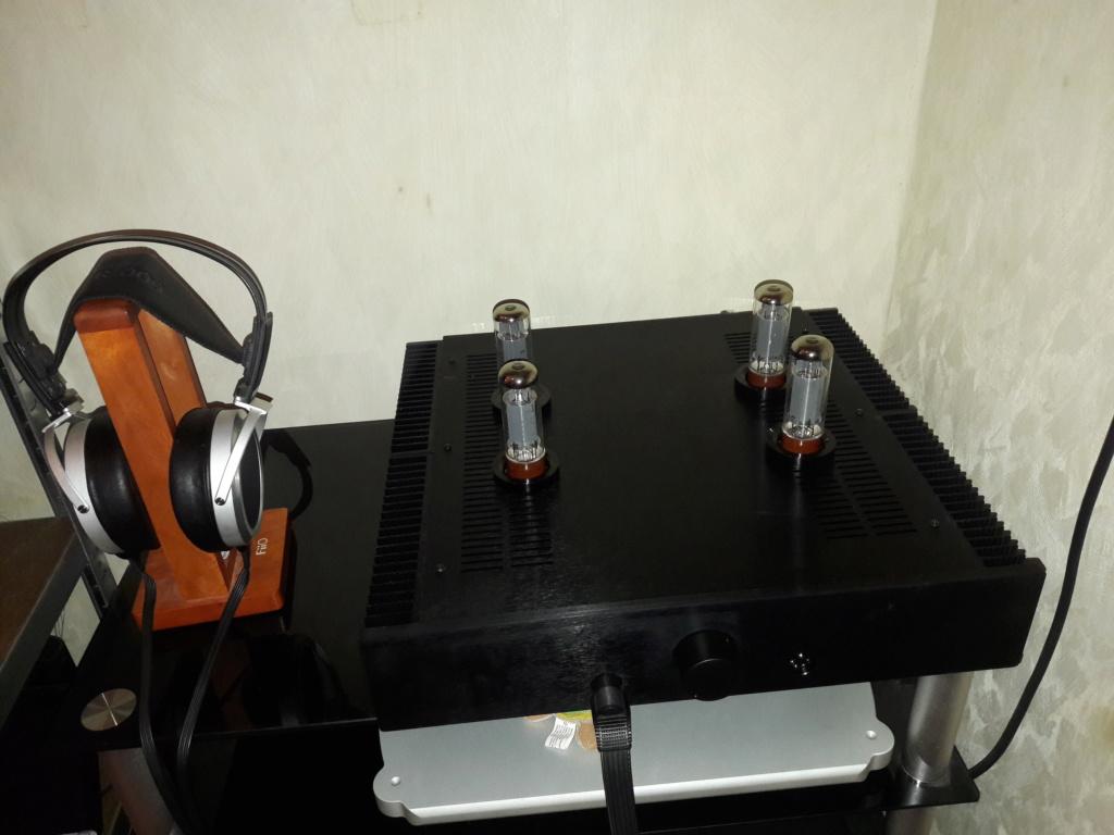

phaeton Posted November 11, 2018 Report Posted November 11, 2018 a new baby GG is born! a fantastic build by Soren, thank you!! 6 Quote

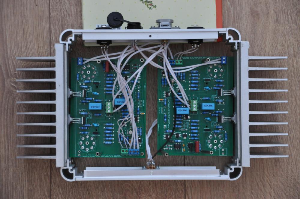

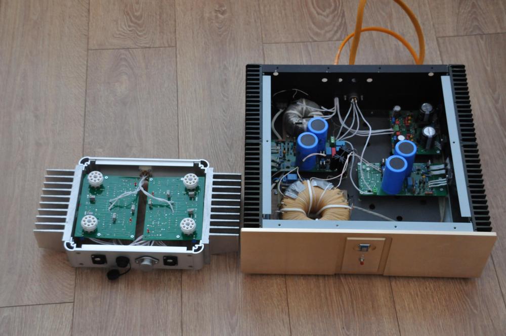

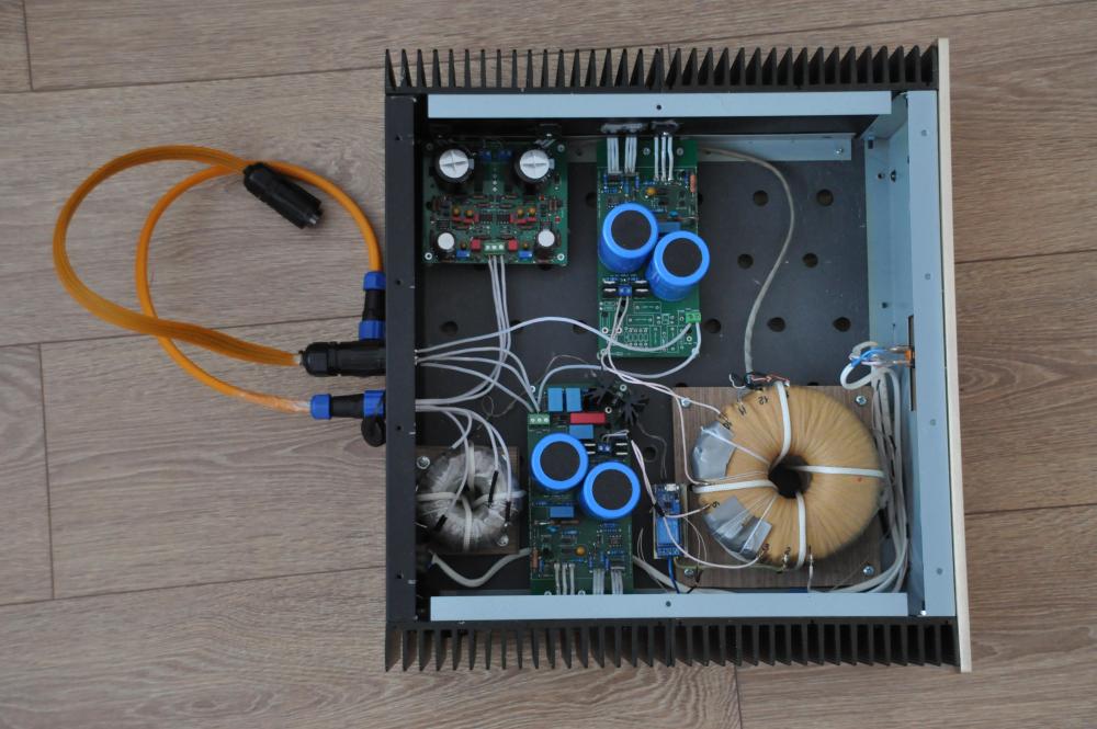

bbest Posted January 8, 2019 Report Posted January 8, 2019 (edited) Some quartet tubes wanted to say "Hello! We are here." Neotech UP-OCC wires in teflon tubes, power delay board. Simply plugged power and tested both boards that they are working. Not heard sound yet. Edited January 8, 2019 by bbest 5 Quote
Blueman2 Posted January 8, 2019 Report Posted January 8, 2019 Nice work! Very small amp case, which is pretty neat. What holds the amp boards in place? They seem to be just attached by the silicon right now. Quote
JoaMat Posted January 8, 2019 Report Posted January 8, 2019 Nice work indeed. I like the two box approach. The transformers – are they DIY made? Quote
bbest Posted January 9, 2019 Report Posted January 9, 2019 (edited) 19 hours ago, Blueman2 said: Nice work! Very small amp case, which is pretty neat. What holds the amp boards in place? They seem to be just attached by the silicon right now. Thanks! Right now boards holds by transistors only. 17 hours ago, JoaMat said: Nice work indeed. I like the two box approach. The transformers – are they DIY made? factory plus cosmetic DIY. Edited January 9, 2019 by bbest Quote

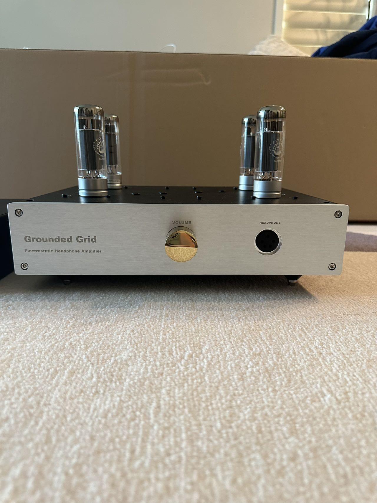

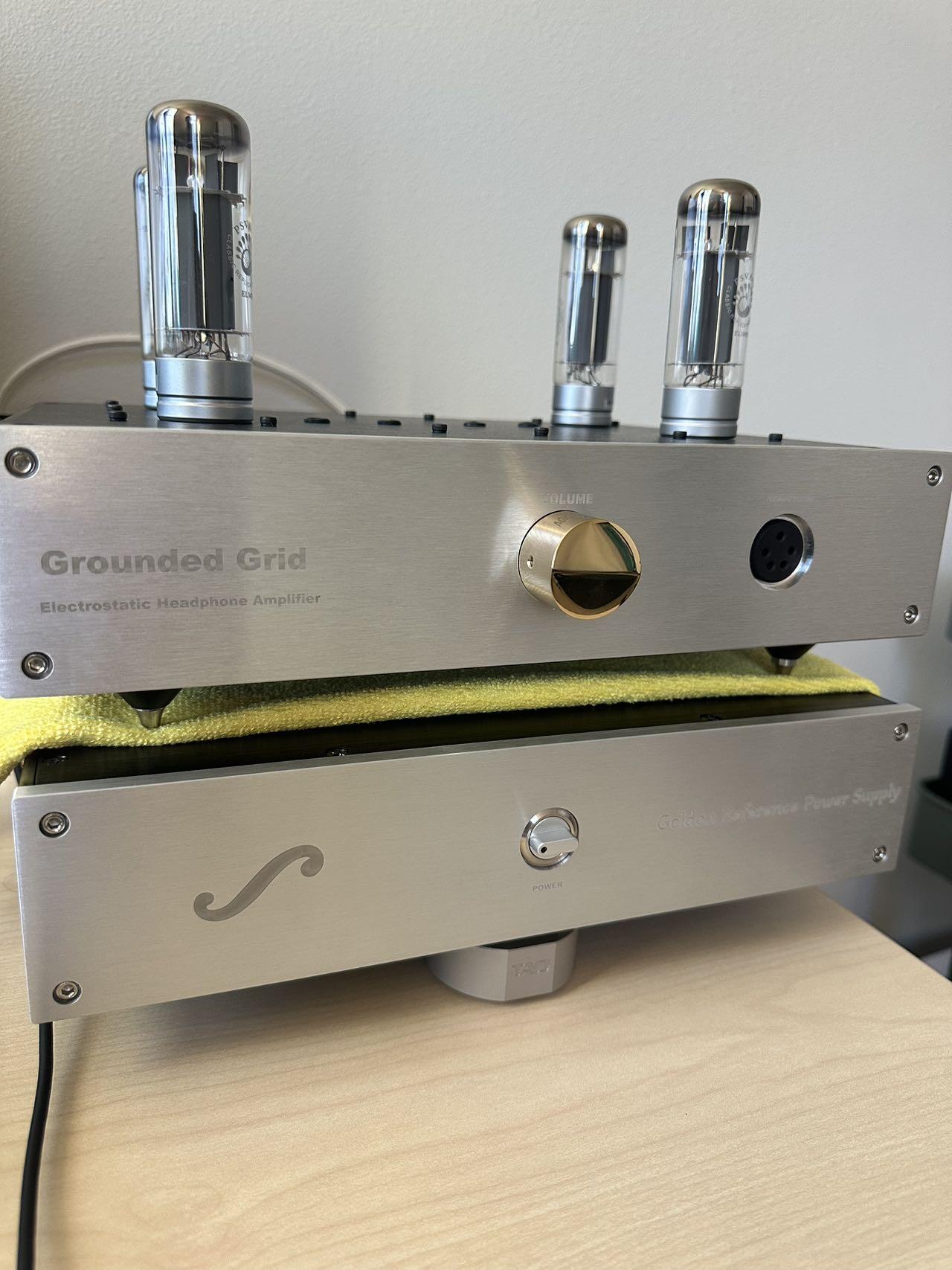

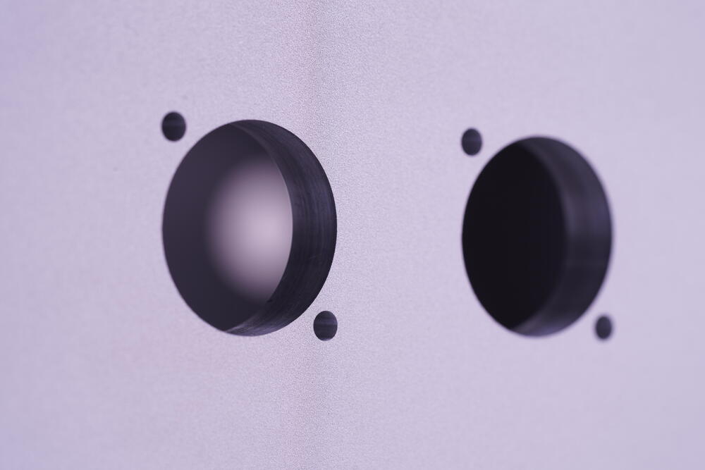

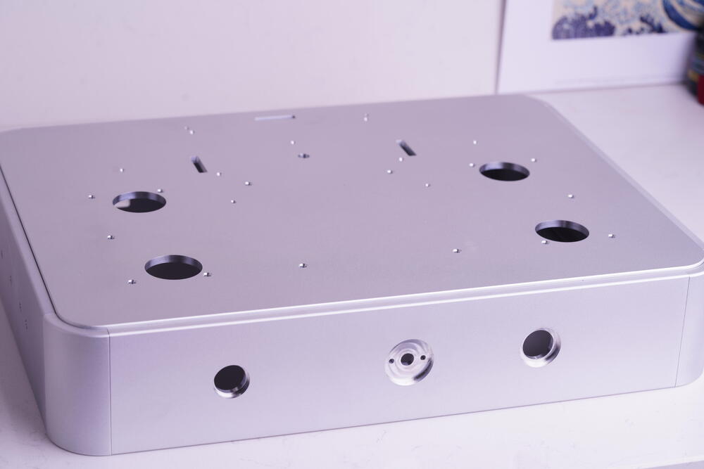

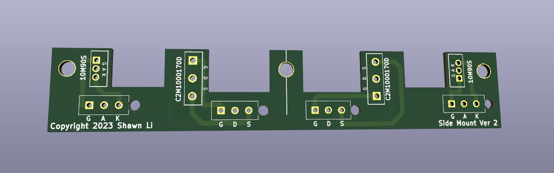

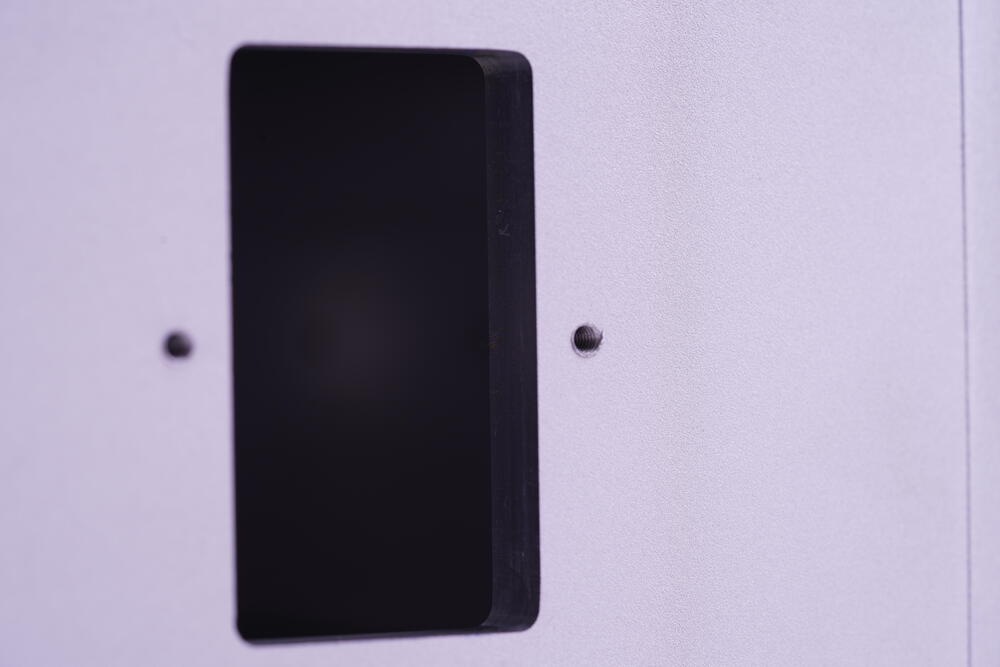

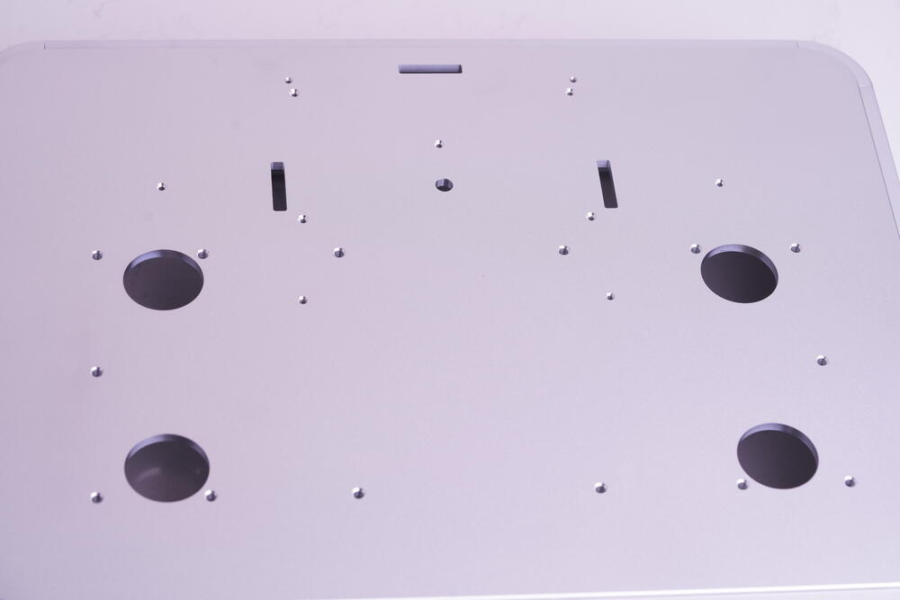

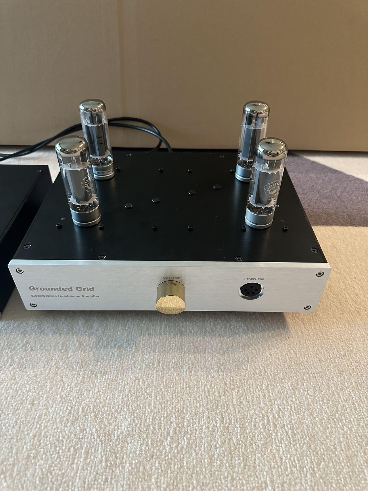

Shawn Posted January 9 Report Posted January 9 Another KGGG alive. I separated the GR power supply and the GG amp into two chassis, making it easy to reuse the GR power supply for the next project. The four holes with the rubber blocker on top of the amp are for balance and offset adjustment. I made a side mount board for the 10M90S instead of using the L bracket. The side mount board is attached if someone is interested in it. It is a 450V version, The tail resistor near the offset pot is 200ohms to track the offset voltages down to 0. To make the servo work, offset voltages must be higher than 15v. The power supply comes with a soft starter of about 50s. I don`t want to talk more about the sound since many comments were mentioned. Pretty decent with my Omega and 009. Thank Kevin Gilmore for bringing the project to the table. SideMountV3.zip 7 Quote
