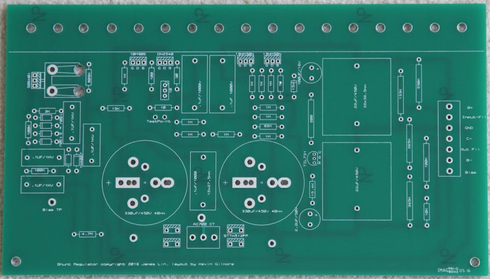

JimL Posted January 16, 2016 Report Posted January 16, 2016 Update for those of you who will be buiding my shunt power supply. I changed the large C- resistor from 133k to 100k. This ensures that the input stage tail current sources will get enough current to run properly. Quote

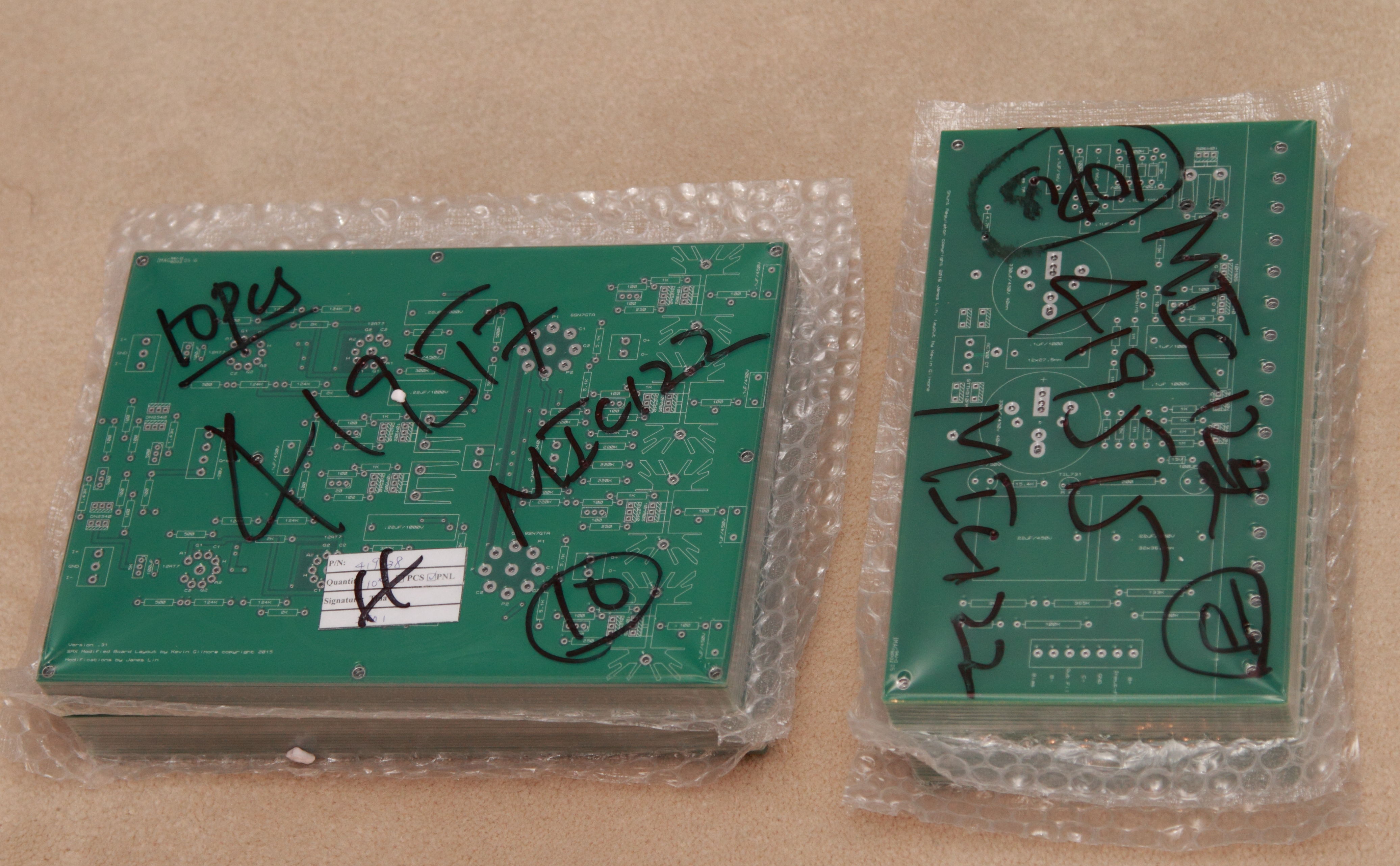

mwl168 Posted February 5, 2016 Author Report Posted February 5, 2016 (edited) Got home very late tonight to find the PCBNet package sitting in the foyer. Delayed one day by the snow storm that hit upper Midwest Tuesday. Quick visual inspection of boards shows typical quality fabrication as can be expected from PCBNet. These 2mm, 4oz boards have a hefty feel to it. Will post better quality picture this weekend under daylight. Shipping will start next week. Edited February 5, 2016 by mwl168 Quote

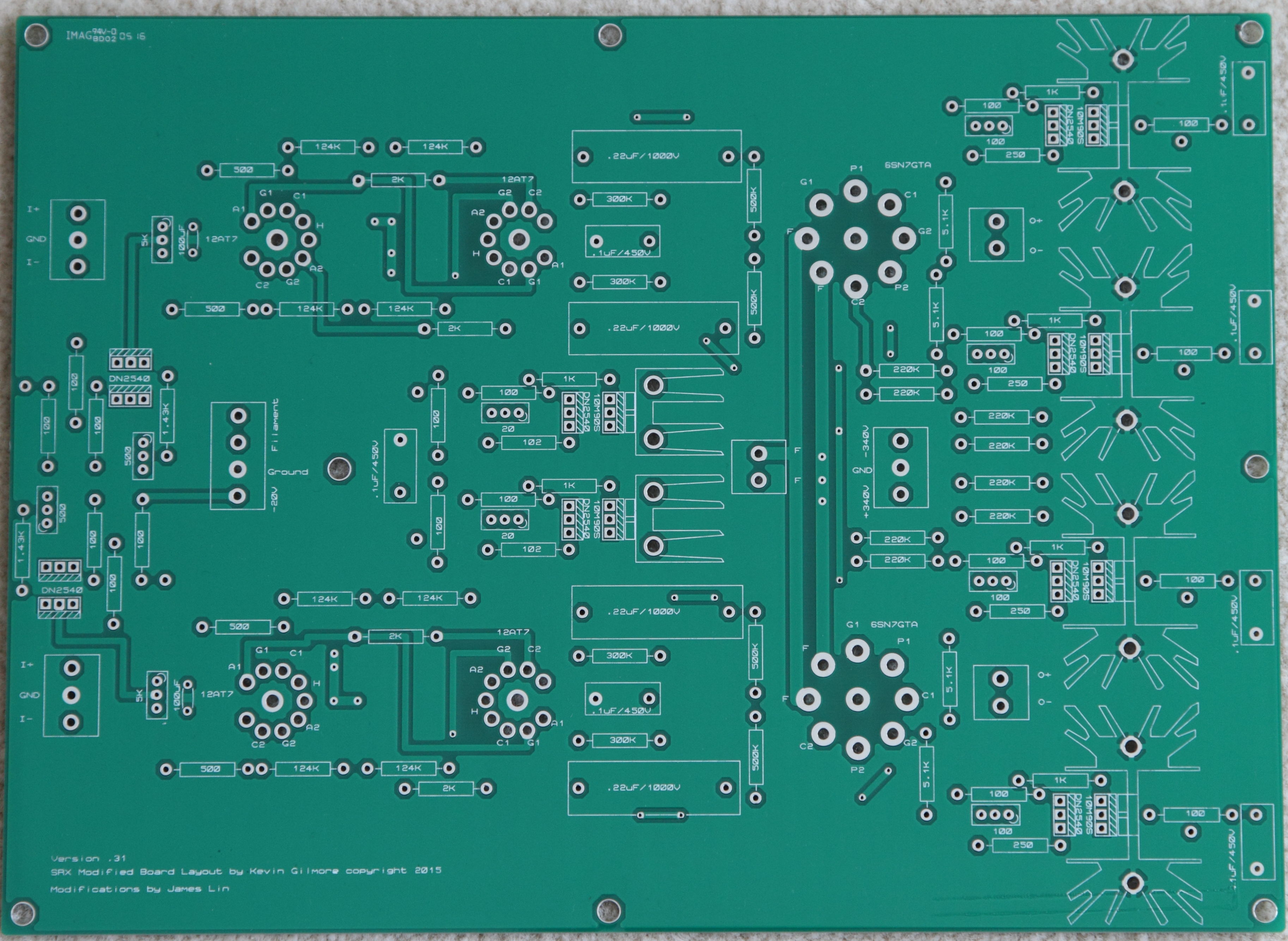

JimL Posted February 5, 2016 Report Posted February 5, 2016 BTW, MLA noted a "problem" on his original board, which is that the input stage plate resistors are specified as 300k, which is what the original SRX has. With that value, you have to set the input tail current source to about 1.1 mA to get the input stage plate voltage to 1/2 way between ground and B+. I changed the input plate resistors to 250k - for that value, the input tail current source should run about 1.3 mA. Either value is acceptable, just that you have to adjust the current source to give the proper plate voltage on the upper tubes, which is 1/2 way between ground and B+, or 160 volts if you're running a +/- 320 volt PS. Quote

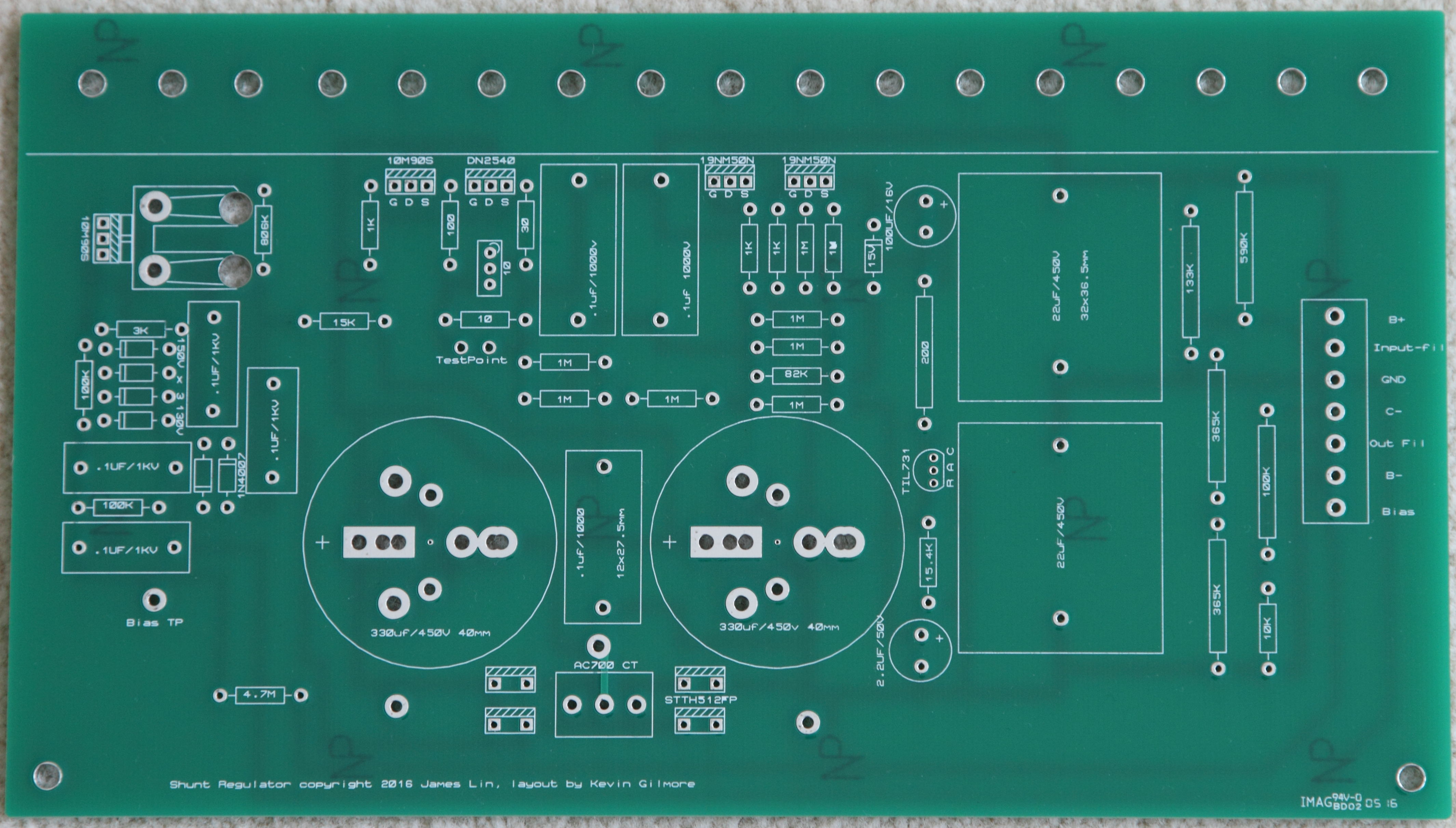

mwl168 Posted February 6, 2016 Author Report Posted February 6, 2016 (edited) Better quality photos of the boards as promised. Edited February 6, 2016 by mwl168 Quote
