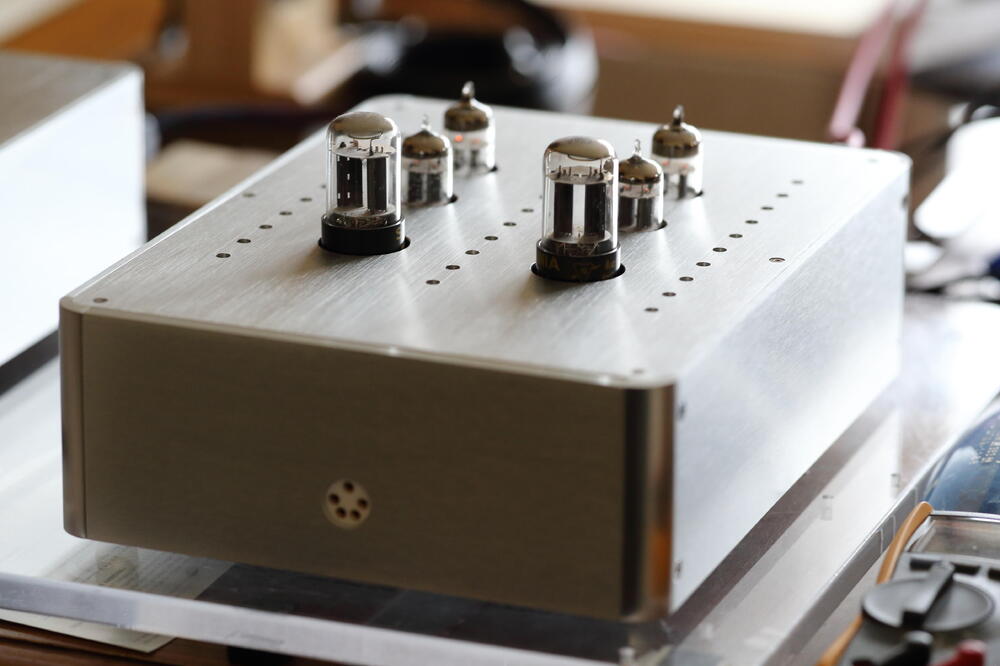

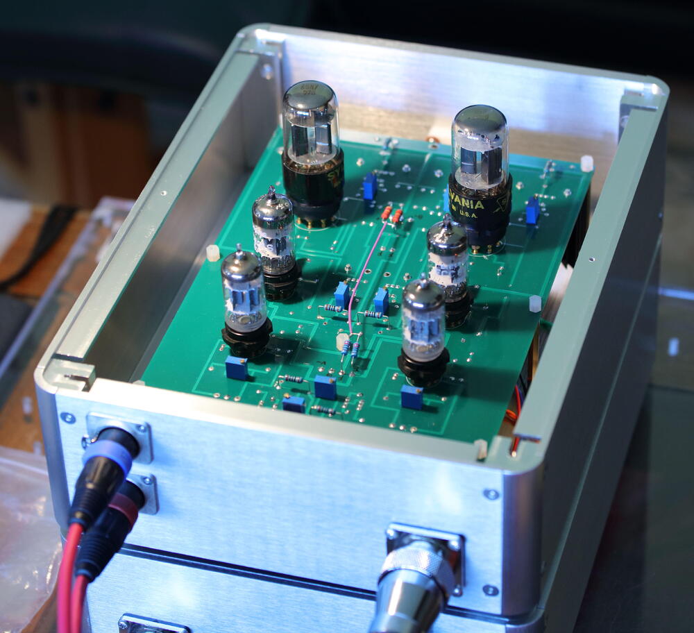

  • I finished my first SRX+ build yesterday. It is overall quite satisfying. It doesn't have the breathtaking bass or unforgiving resolution of KGSSHV Carbon, but is rather non-fatiguing for long-term li
  • tomislavkufrin
    tomislavkufrin
    not the prettiest build, but i'm learning. goal was to make it work, and worry about the looks later. metal works was something new for me, you need to have good tools. these are my first two amps i h

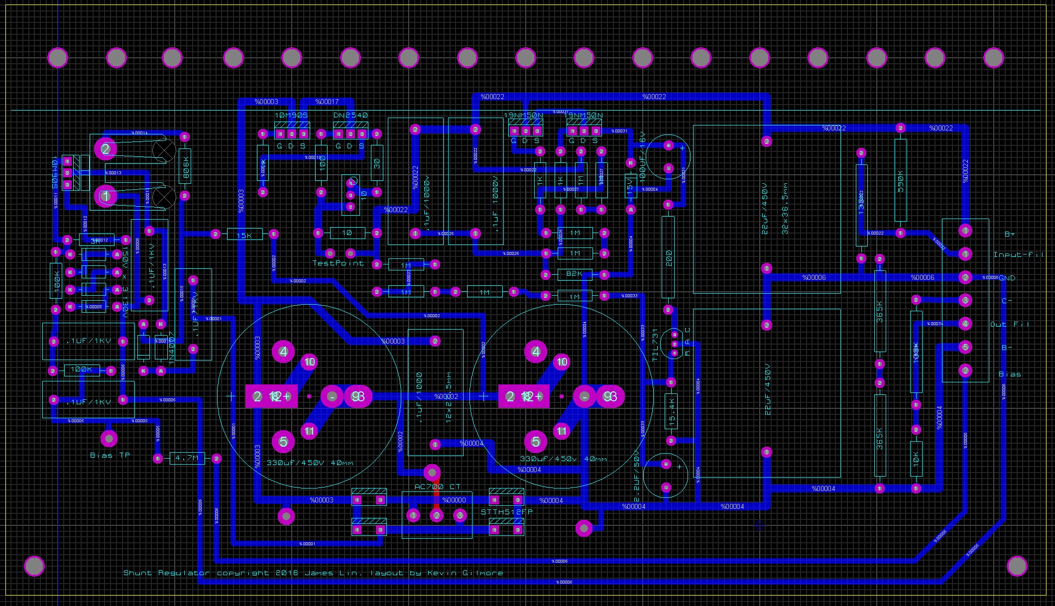

However, I do not understand one thing. On the scheme of your PSU I can see the SPX431 but on the layouts PCB Dr. Gilmore uses the TIL731. You say that it didn´t work in this circuit ... I´m not sure. Please, Is it correct?
Edited by jose
add PSU file
Sorry Dr. Gilmore :(. I guess m one of the first to make the psu
Fortunately It's easy to fix.
As did I, and I thought I checked...
Anyway, good that you caught it, and since you're very likely the first builder, please report if you run into any other issues...

Jose, aka Strawhat, noticed another error on the shunt power supply board.  There is a missing connection between the input ground terminal and the output terminal ground terminal.  The easiest way to fix this is to run a wire from the center tap of the HV transformer to both the input ground terminal and the output ground terminal.  Thanks to Jose for catching this.
so i'm not sure that is what you want because then the minus supply is completely unregulated which is the problem when you try to split the ground with only one regulated power supply. in effect it shorts out the 2 x 365k resistors.
http://gilmore.chem.northwestern.edu/srxshunt3.zip
has a position to short the unreg ground and regulated ground.
Well, maybe I'm confused, but the regulator is regulating the voltage between the B+ and B- rails but is not directly regulating either B+ or B-, other than the fact that the resistor chain across the output caps is dividing the voltage between B+and B- with respect to ground.  So, the total voltage between B+ and B- are regulated but they "float" around ground with the average value set by the dividing resistor string.  This is as opposed to KGs designs (as well as many others) where both B+ and B- are "hard" regulated with respect to ground.  This is a disadvantage of this design topology.  Does that make any sense?

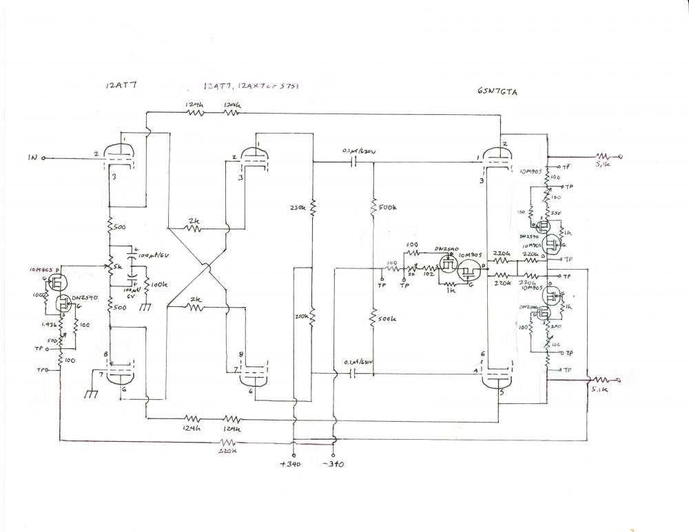

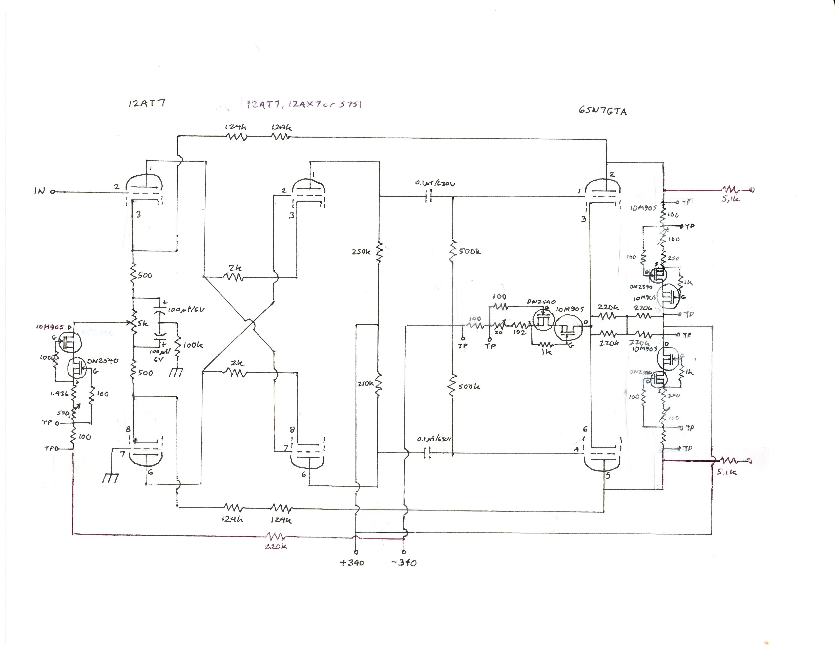

SRX Plus.jpgA couple weeks ago one of the 12AT7s in my SRX Plus failed, and in troubleshooting it eventually took out both input sections.  On analyzing the failure it appears that I may have been just a bit too much of a cheapskate.  Therefore I have slightly revised the circuit so that at least a failure won’t take out both channels, and hopefully won’t even take out one.
The revision is pretty straightforward.  Rather than supplying both input current source tails with a single resistor from B-, I substituted a 220k/500V rated resistor (270k/500V if you are using the original 300k plate resistors) from the B- rail to the input tail current source of each channel (which was previously marked on the schematic as being connected to -20v).
The revised schematic is shown (ignore the +/-340 volt numbers, they should be +/-325 v).  This resistor takes the place of the 10k and100k resistor chain in the shunt power supply that ran from B- to -C.  This means that C- in my original power supply is no longer connected to anything, and the only connections between the high voltage power supply and amp boards are B+, B- and ground.
For those using my shunt regulated current supply, you have to make a couple changes on the amp board.  First, you have to cut the connection between the -20 volt terminal and one of the 100 ohm sense resistors, and then you have to cut the connection between that 100 ohm resistor and the other 100 ohm sense resistor.  Then you have to connect each of those two sense resistors to a 220k resistor, which then runs to the B- rail – probably the closest place to do this on the amp board is the connecting point for the 100 ohm sense resistors on the output tail current sources – a bit of a kludge but it will work.
In addition, I substituted a 10M90S in place of the upper DN2540 on the input current source. This modestly improves its performance, but more importantly should prevent the input current source from failing due to overvoltage.
This modification does not need to be done for those of you who built the SRX Plus circuit using a Gilmore regulated PS, as that supplies the -15 volts that can be used for the input current sources.
