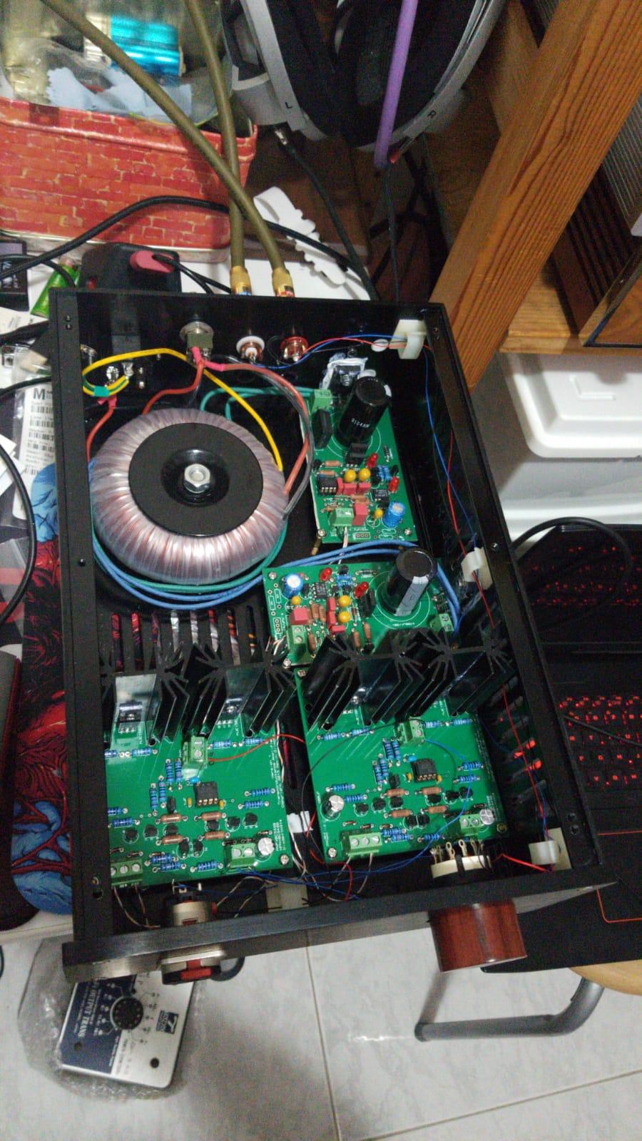

jose Posted June 6, 2019 Report Posted June 6, 2019 I forget to hang some photos of this amplifier.Sorry, I did not have any GRLV at that time ready. 6 Quote
