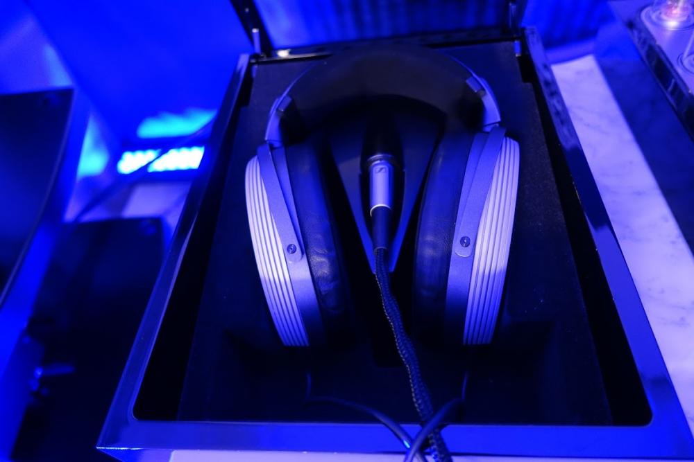

Pirx Posted April 6, 2016 Report Share Posted April 6, 2016 Picture from show in Warsaw (the same where Padam was.): In short, old Orpheus still rocks 1 Quote Link to comment Share on other sites More sharing options...
