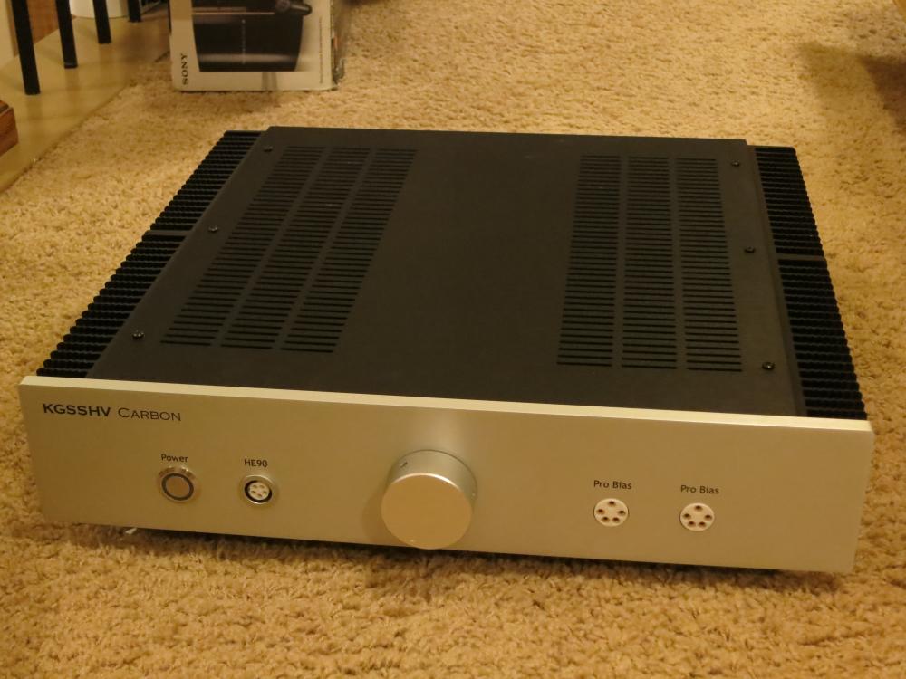

kingofsnake Posted December 3, 2015 Report Posted December 3, 2015 (edited) mwl168 Congratulations nice one. I look forward to seeing what it looks like all cased up with a few topless shots for good measure. purk: That sure is a mighty fine looking Carbon you have there 2xPro Bias AND HE90 sockets Yummy! Edited December 3, 2015 by kingofsnake Quote
sorenb Posted December 3, 2015 Report Posted December 3, 2015 13 hours ago, mwl168 said: I have music! Fiat lux ... Fiat musica Quote
purk Posted December 3, 2015 Report Posted December 3, 2015 3 hours ago, kingofsnake said: purk: That sure is a mighty fine looking Carbon you have there 2xPro Bias AND HE90 sockets Yummy! That way I can entertain Mulveling at any time. However, he does listen at louder level than me. Quote

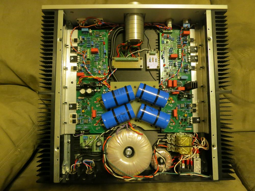

purk Posted December 4, 2015 Report Posted December 4, 2015 (edited) I can take better pictures if needed. Thanks to Steve for the awesome build and Andy for help with voicing the amp as well as running mine in. Edited December 4, 2015 by purk 6 Quote
spritzer Posted December 4, 2015 Report Posted December 4, 2015 A lot of this amp is an example of how not to wire any electrostatic amp. There is so much fail in there but lets start off on the big stuff, how the caps are mounted... Never do something like that!!! Uninsulated spades on all of the AC input wiring when they clearly should be insulated. Input wiring runs right under the transformer when it should be kept as far away from it as is possible. Last but not least, the output wiring. Twisting it like that is bad idea as it adds to the output capacitance of the amp. 1 Quote
sorenb Posted December 4, 2015 Report Posted December 4, 2015 12 hours ago, purk said: I can take better pictures if needed. Thanks to Steve for the awesome build and Andy for help with voicing the amp as well as running mine in. Nice build you've got there Purk :o) Un-twisting the output wires, isolating the AC wiring and some hot snot to further secure the caps would be an easy fix. 1 Quote
purk Posted December 4, 2015 Report Posted December 4, 2015 1 minute ago, sorenb said: Nice build you've got there Purk :o) Un-twisting the output wires, isolating the AC wiring and some hot snot to further secure the caps would be an easy fix. Thanks Birgir and sorenb for your input. It sounds pretty spectacular. Quote
sorenb Posted December 4, 2015 Report Posted December 4, 2015 Just now, purk said: Thanks Birgir and sorenb for your input. It sounds pretty spectacular. I'm sure it does ... a pretty fine amp that is ;o) Have you notice any change in how the Carbon presents the deep end during the time you've had it? Quote
kevin gilmore Posted December 4, 2015 Report Posted December 4, 2015 I would mount the caps on the board, and punch holes in the top panel. Quote
purk Posted December 4, 2015 Report Posted December 4, 2015 Just now, sorenb said: I'm sure it does ... a pretty fine amp that is ;o) Have you notice any change in how the Carbon presents the deep end during the time you've had it? The biggest advantages so far has been bass output & quality of the low frequency in general. However, I'm more impressed at how the amp is able to portray the soundstage. Exceptionally in width and depth. It just sounds a lot more "real" and 3-D than any KGSSHVs that I've auditioned before. Quote
sorenb Posted December 4, 2015 Report Posted December 4, 2015 Just now, purk said: The biggest advantages so far has been bass output & quality of the low frequency in general. However, I'm more impressed at how the amp is able to portray the soundstage. Exceptionally in width and depth. It just sounds a lot more "real" and 3-D than any KGSSHVs that I've auditioned before. Appriciate your description, thanks. In terms of change in sound, have you noticed any difference during the time you've had it? Quote
