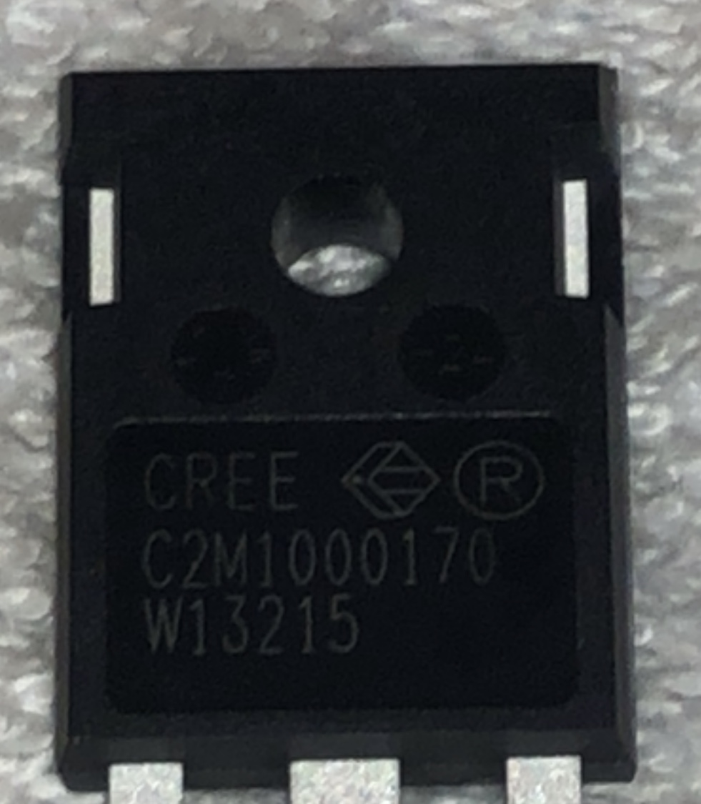

Kung Posted February 17, 2018 Report Posted February 17, 2018 On 2018年2月10日 at 10:09 AM, bui501 said: A stack of 20 ea. CREE C2M1000170 SiC’s newly arrived directly from China... you’d think they’d be cheaper from China, but alas, no. I’m just happy to be able to (hopefully) finish my boards this weekend. In case anybody wants to order from the Chinese vendor, this is a link to them on Alibaba. You have to start a request for quote with them to get started. I paid $5/piece plus $20 for fed ex International shipping within Asia:https://m.alibaba.com/product/60636916771/C2M1000170D-C2M1000170-TO-247-4-9A.html?s=p&spm=a2706.7843299.1998817009.1.r8CLBF (On a side note, I had originally ordered from Newark.com when they claimed to have some in stock, but they never shipped my order and ended up refunding my money after weeks of delays. I won’t be using newark again.) Sent from my iPhone using Tapatalk it looks like fake c2m1000170 in the picture,but ones in the alibaba link below is real Quote
Laowei Posted February 17, 2018 Report Posted February 17, 2018 Yes, the ones in the photo are probably fake . This is one of my stash bought around a year ago from Mouser. Notice the stepped face the p/n is printed on. Quote
bui501 Posted February 18, 2018 Report Posted February 18, 2018 (edited) 2 hours ago, Laowei said: Yes, the ones in the photo are probably fake . This is one of my stash bought around a year ago from Mouser. Notice the stepped face the p/n is printed on. Damn!! Thank you, Laowei & Kung. I’ve adjusted my original post so nobody else orders from the same vendor. The link is where I purchased from. The photo I posted was of what I received from them. so does anybody have some spare CREE SiCs they can resell to me? Edited February 18, 2018 by bui501 Quote
