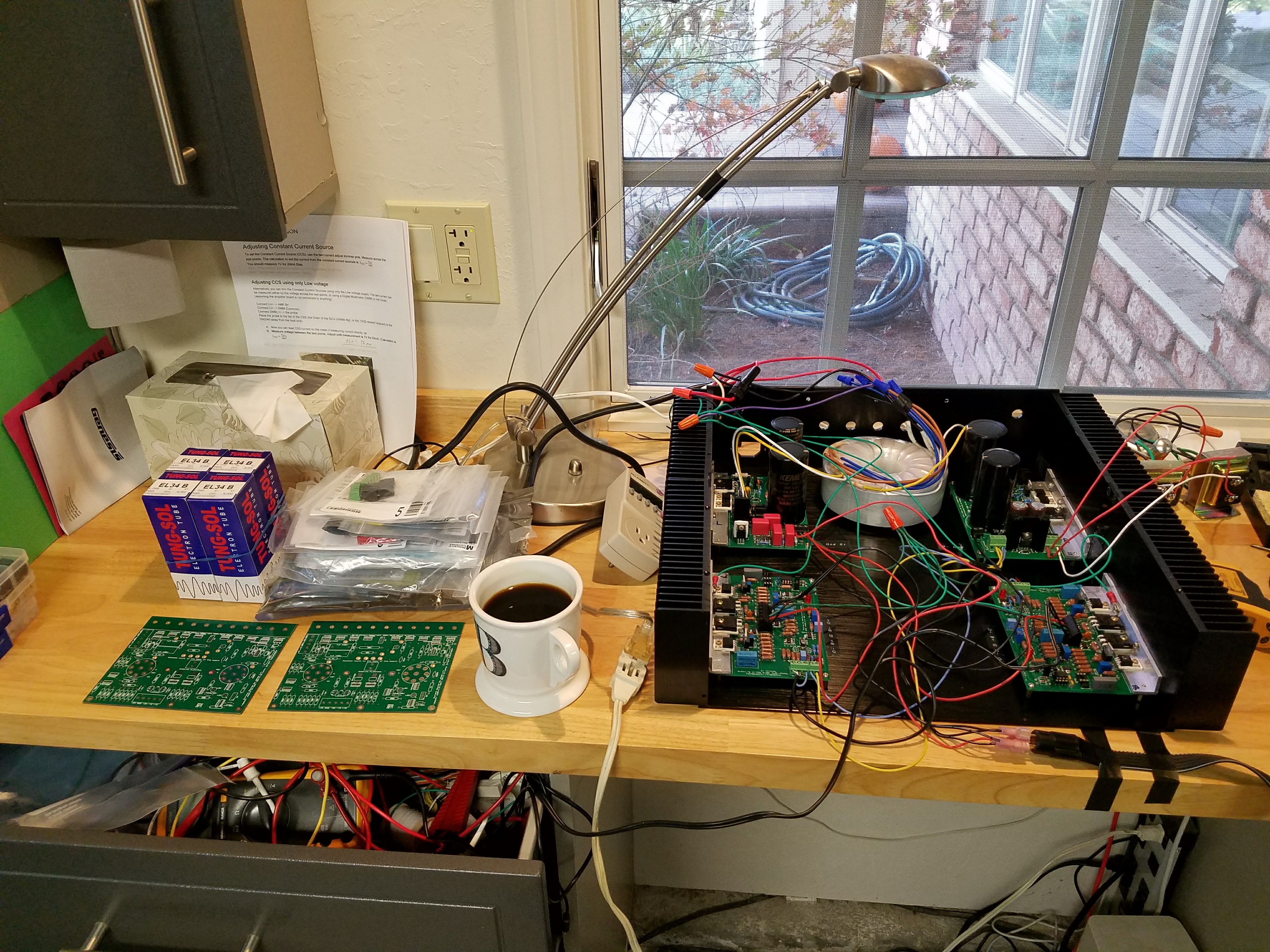

Blueman2 Posted November 19, 2017 Report Posted November 19, 2017 3 hours ago, jose said: Now... you need a BH/GG My wife already hates each and every one of you. It is about to get worse, though. Let me pan back on the Carbon build: And zooming in on the left: Guess my wife is not inviting any of you guys over for dinner anytime soon. Too bad. She really is a good cook. 2 3 Quote

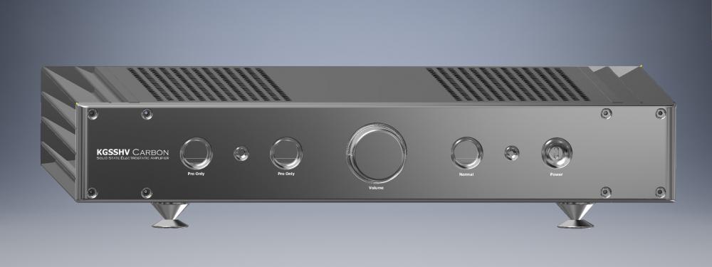

P3t4 Posted November 22, 2017 Report Posted November 22, 2017 Sneak peek of my custom enclosure to be. I have spent way too much time in the modelling software. 3 Quote
mwl168 Posted November 22, 2017 Author Report Posted November 22, 2017 Hard to tell from the rendering the size of the heat sinks. The Carbon runs hot, make sure the heat sinks are adequate. Quote
