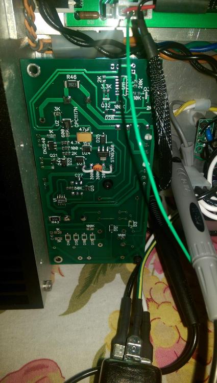

JoaMat Posted April 3, 2016 Report Posted April 3, 2016 Managed to open it in DipTrace. Looks very interesting. Anyone capable of making it in .jpg format or similar? Worth showing!
congo5 Posted April 3, 2016 Report Posted April 3, 2016 (edited) looks to be 5" x 2.5" Edited April 3, 2016 by congo5 2
Kerry Posted April 3, 2016 Report Posted April 3, 2016 That's a nice Gerber viewer. Which one is it? I'll try to publish the BOM shortly.
G600 Posted April 3, 2016 Report Posted April 3, 2016 You boys are a wild overtalented bunch. This one looks sweet and tiny !
congo5 Posted April 3, 2016 Report Posted April 3, 2016 https://www.zofzpcb.com/ 57 minutes ago, Kerry said: That's a nice Gerber viewer. Which one is it?
mwl168 Posted April 3, 2016 Author Report Posted April 3, 2016 Looks like there is a built-in delay and it uses SMD, other than that, what's the difference between this one and the GoldenReference HV PS?
Kerry Posted April 3, 2016 Report Posted April 3, 2016 (edited) 1 hour ago, mwl168 said: Looks like there is a built-in delay and it uses SMD, other than that, what's the difference between this one and the GoldenReference HV PS? That's it. I just needed something small and wanted to use the Antec transformers and have the HV delay. Works perfectly on my Blue Hawaii. I've been listening to it for the past couple of days. Really nice to have it back in service. I'm in the middle of re-casing it. EDIT: This is the negative rail so no control logic (just the relay - CPC1117N) and no bias supply. Edited April 3, 2016 by Kerry
mwl168 Posted April 3, 2016 Author Report Posted April 3, 2016 5 minutes ago, nopants said: beautiful work That! I,too, like to be able to use the off-the-shelf Antek transformers. No promise but if there is enough interest, I may organize a GB for this version of PS together with the BJT version of the Blue Hawaii Kevin recently posted.
UFN Posted April 3, 2016 Report Posted April 3, 2016 5 minutes ago, mwl168 said: No promise but if there is enough interest, I may organize a GB for this version of PS together with the BJT version of the Blue Hawaii Kevin recently posted. Interested. Kerry: Nice work (as usual I should say ) //UFN
mwl168 Posted April 5, 2016 Author Report Posted April 5, 2016 @ Kerry: for those that like to use this smaller footprint PS board, is there a way to hot-wire the board to bypass the delay?
Kerry Posted April 5, 2016 Report Posted April 5, 2016 (edited) Just don't add the opto relay (CPC1117N) and the 600 ohm resistor (not necessary). It is a normally closed relay that prevents the HV from starting up. EDIT: Also, the 3K resistor above the relay is not required. Edited April 5, 2016 by Kerry

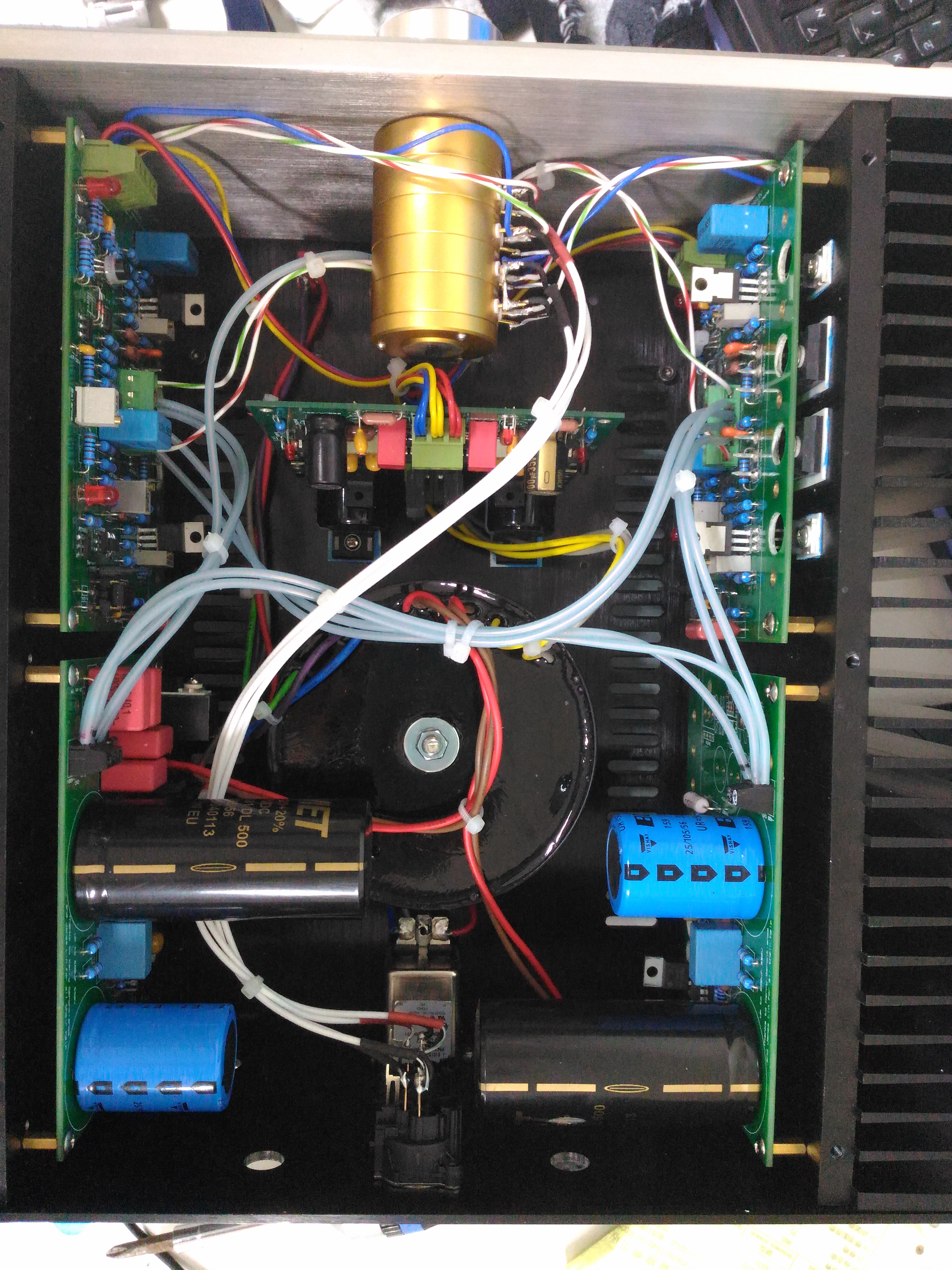

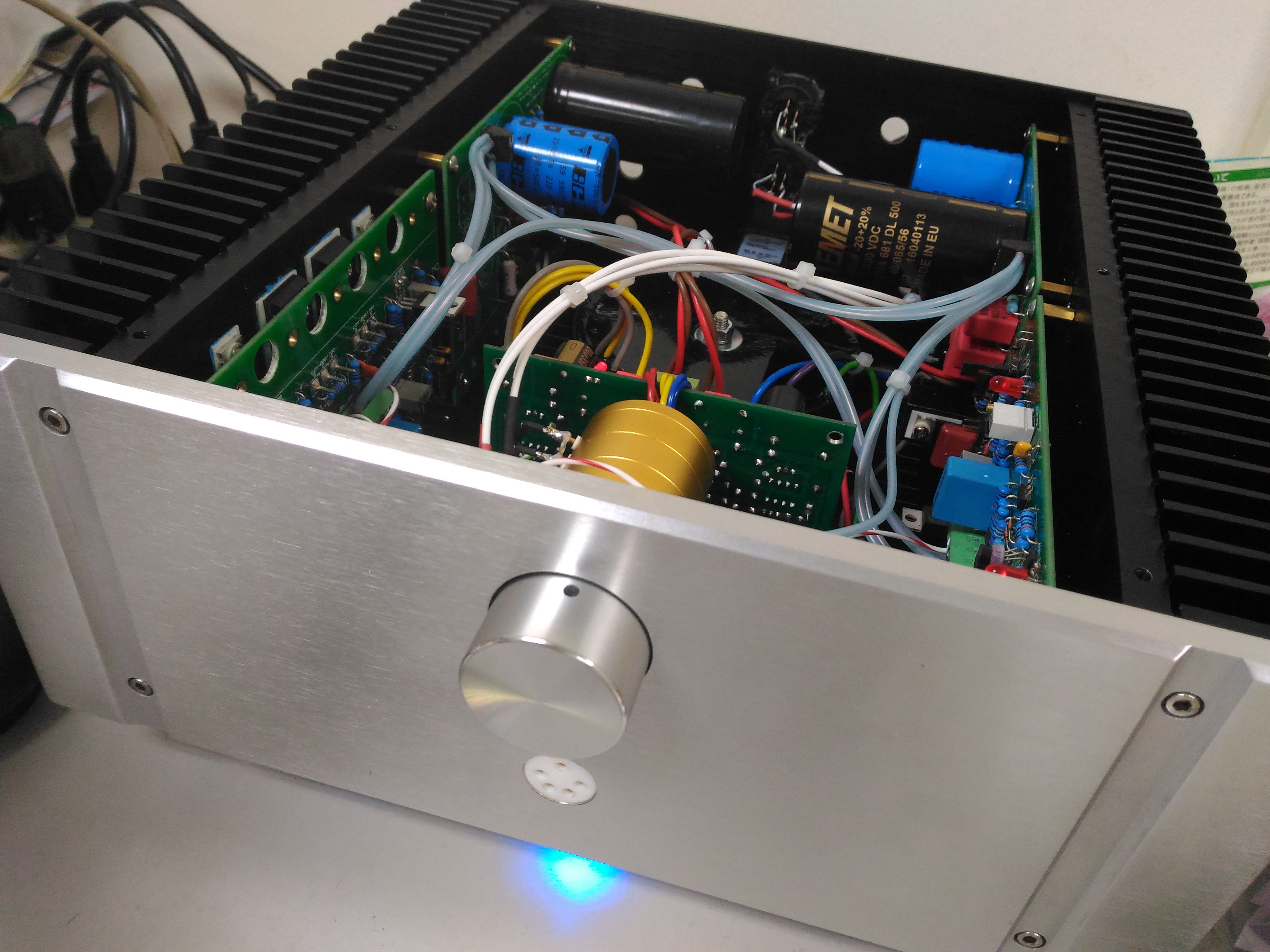

wokstarr26 Posted April 11, 2016 Report Posted April 11, 2016 Hello Geoff, I hope thats your name [fading memory] I really admire your fantastic case work. Remember the old KGSShv blue pcb you did a mini group years ago. I still have a spare set. I will be resuming build the carbon KGSShv soon [pcb only] Any chance of helping with a chassis design. I have great difficulty in casing.
headinclouds Posted April 12, 2016 Report Posted April 12, 2016 Hello Fred, Yes the beginning of my Stax adventure. On cases I can help easier with a design than I can with parts, I've been waiting 6 weeks for the front panels for my Carbons to be done. The guy gives precedence to his industrial customers. I'd do them myself but they are too big for our cnc mill. I'll pm you
