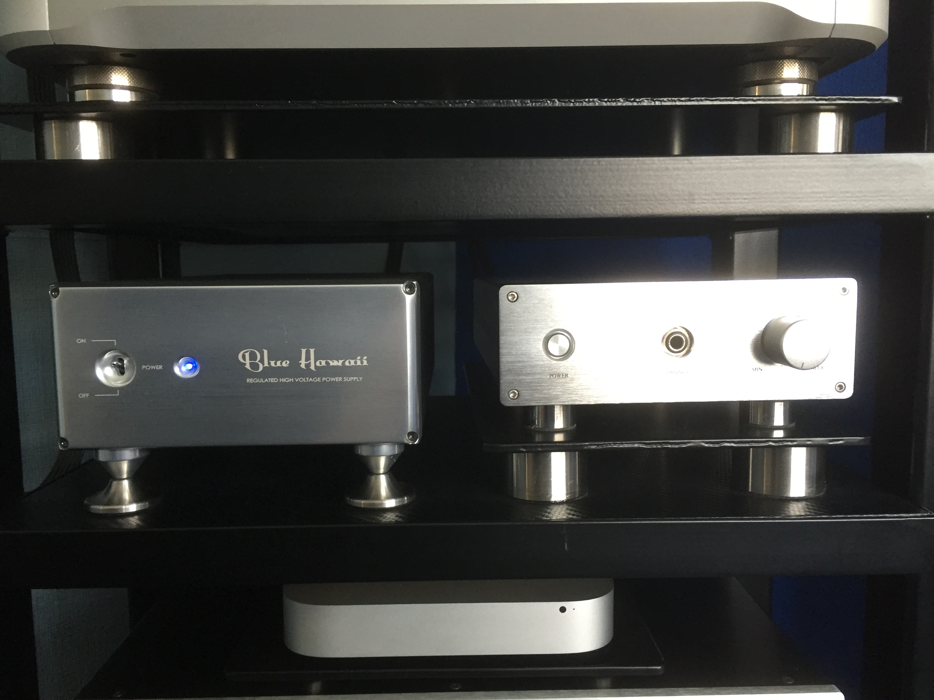

Dave R Posted August 8, 2015 Report Posted August 8, 2015 (edited) Hi Rod,Although I've never heard any stats amps built by Birgir, I am a very happy owner of a Dynalo mk1 built by him.I use that dynamic amp with my HD-600's, and while that combo isn't as open sounding, detailed and transparent as the 009/BHSE, the two together still sound very good, so much so I use that 600/Dynalo combo almost as much as the 009/BHSE, so I'm sure Birgir's stats amps will also sound very good, and even more so his KGSSHV Carbon.Regarding the Woo Wee, to what I recall, when I heard it along with the Chord integrated amp and 009's in November, the SQ was something like an SRM-007t, however even if the SQ would've been better, it's obviously not worth the risk damaging Earspeaker's. The photo is of that Dynalo mk1 at the side of my BHSE's PSU, the power light is on that PSU because I've already been listening to my 009/BHSE, and I'm listening throughout the rest of today. I've been listening to CD's, but that below the PSU & Dynalo is my MacMini which I use as a music server with my sources DAC. Edited August 8, 2015 by Dave R Quote

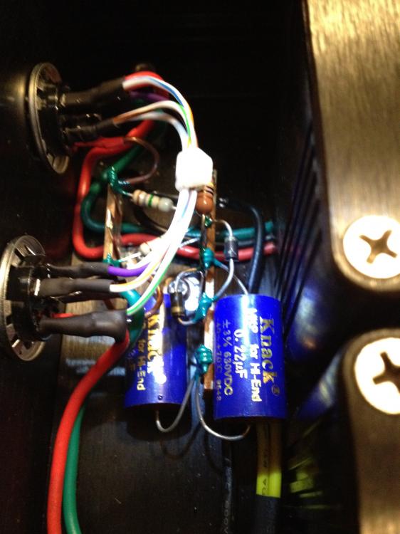

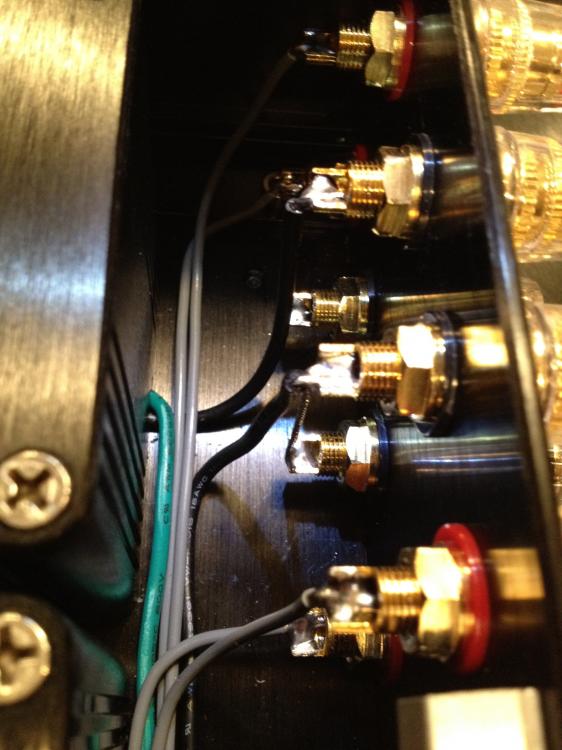

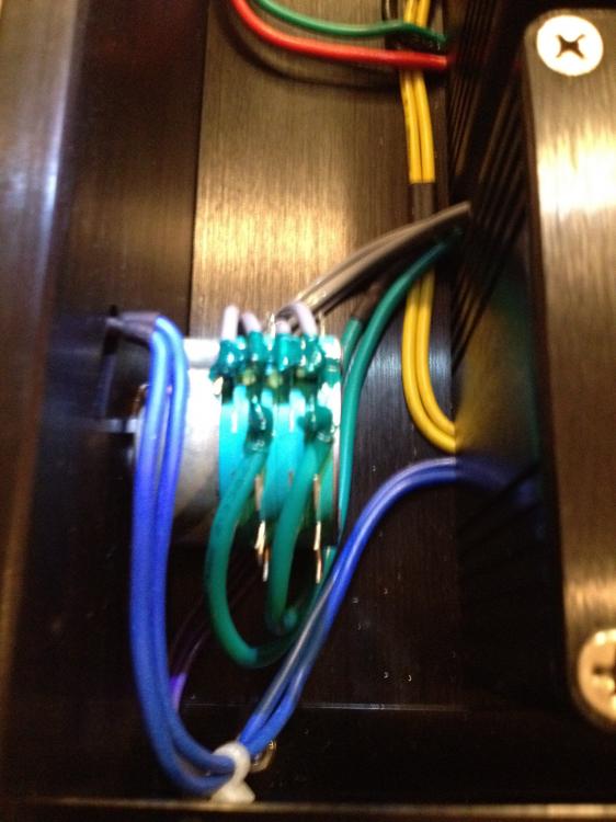

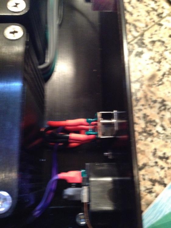

HeadphoneAddict Posted August 10, 2015 Report Posted August 10, 2015 It will take some time for this to happen but in general I wouldn't recommend connecting headphones to them as they are essentially broken. What's wrong is they use the wrong ballast resistors for the bias supply or, as I've seen twice, just don't use any. This will burn off the coating and fuck up the diaphragm. I recall that you once looked at pics of my WEE guts and said it looked safe. Was I mistaken? It's been in a box ever since someone offered to buy it but backed out 2 years ago, so I suppose I should not bother to unbox it and use it? Quote
nopants Posted August 12, 2015 Report Posted August 12, 2015 You can post a picture of the inside here and Birgir/anyone here should be able to re-verify Quote
spritzer Posted August 12, 2015 Report Posted August 12, 2015 Some are ok, some are far from it. Quote
HeadphoneAddict Posted August 12, 2015 Report Posted August 12, 2015 In hindsight my pics weren't very good, as I didn't know what parts take to photos of with my crappy iPhone camera and poor light. Here they are. Quote

JamesV Posted December 18, 2017 Report Posted December 18, 2017 Hi All, new member here. Reviving an old thread. If I post a photo on this thread, would someone be able to check and see if they can confirm if my GES is safe to use with the Stax 009s. If yes, which part of the amp casing do I need to remove? Many thanks in advance James Quote
spritzer Posted December 18, 2017 Report Posted December 18, 2017 Certainly. You need to remove at least the bottom panel so we can see how it is built. Maybe the top covers for each of the modules there but I don't think it would be necessary. Quote
JamesV Posted December 18, 2017 Report Posted December 18, 2017 Thank you so much. So I will flip it over (tubes removed) and remove that bottom panel. I can remove the top covers as well if need be. Thanks so much again. James Quote
spritzer Posted December 18, 2017 Report Posted December 18, 2017 The bottom should do it. You might want to check the top covers as well as they have been known to use some pretty crappy PSU caps in these... Quote
