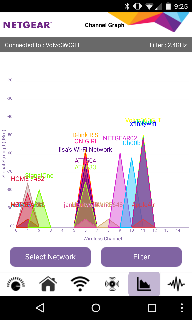

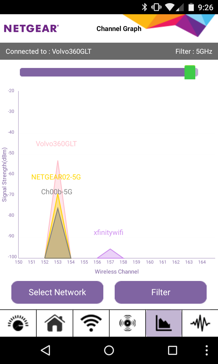

roadtonowhere08 Posted July 25, 2015 Report Share Posted July 25, 2015 (edited) Just shooting in the dark here, but I am assuming you are running a wireless network. If you are saying that the connection completely cuts out completely sporadically, I am inclined to believe it might be either wireless channel interference from other wireless devices in the immediate area (perhaps your post church service coitus seeking neighbors) or something router related. But the predictable trouble on Sunday night is odd. Easy way to rule out the modem is to hardwire it to a computer or smart TV and use it all Sunday night. If no problems, the modem is not to blame. I really doubt it is the modem though. It being on all the time is perfectly fine. Just some thoughts. Edited July 25, 2015 by roadtonowhere08 Quote Link to comment Share on other sites More sharing options...
Grahame Posted July 25, 2015 Report Share Posted July 25, 2015 If you have Android /non apple gear, you can run various scanners to see how congested your local airwaves are. Apartment living does have some downsides 1 Quote Link to comment Share on other sites More sharing options...

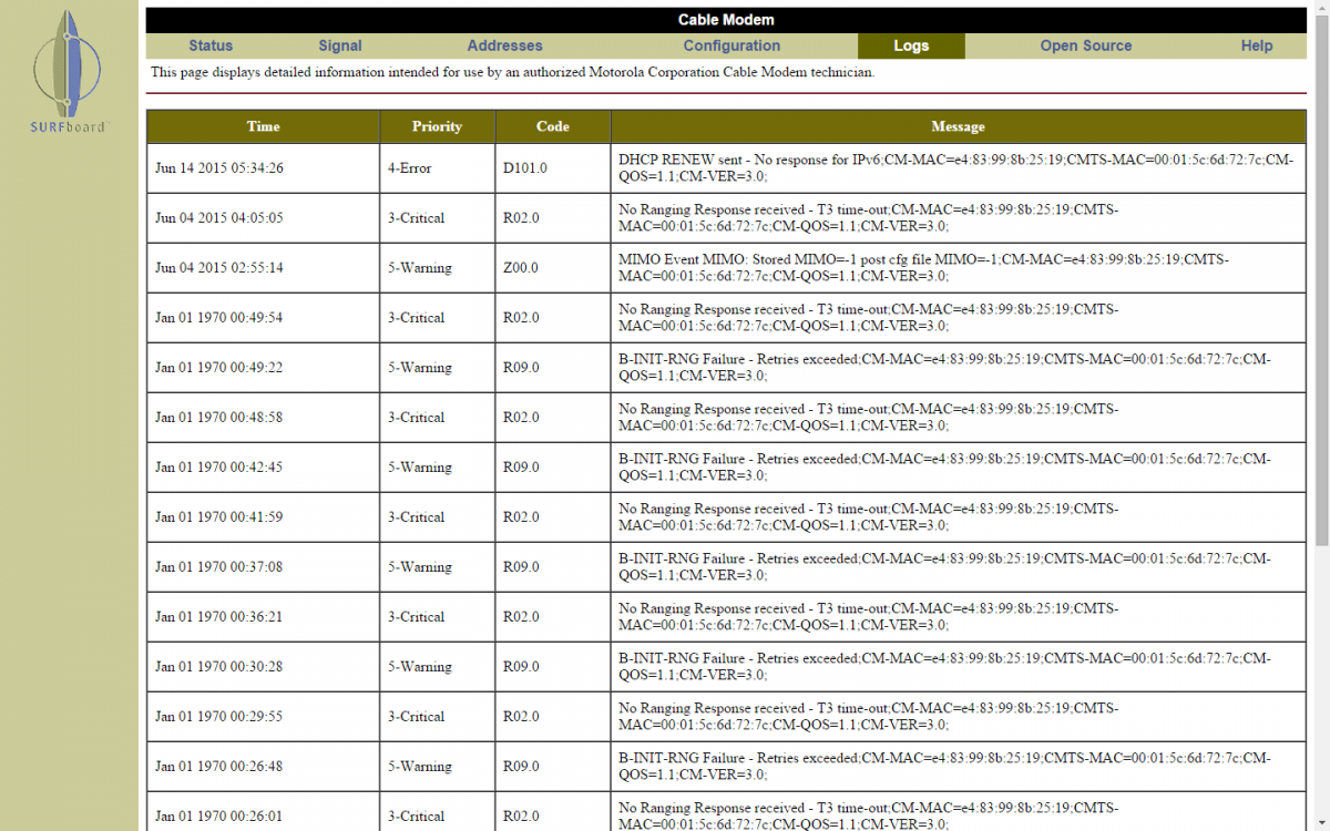

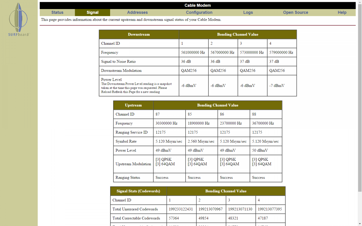

Grahame Posted July 25, 2015 Report Share Posted July 25, 2015 Apple seemed to remove all their scanner apps, because they could be used for "other purposes" .... If you know your modems IP address (typically its the default gateway seen from the router), you can look at status information from its built in webserver (if it has one) So on my network its http://192.168.100.1/ giving me ... You can look at the logs to see if there are any issues after reboot and it has aquired (local) network time .... 1 Quote Link to comment Share on other sites More sharing options...
