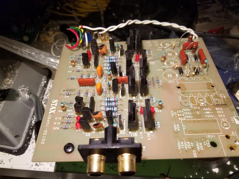

mypasswordis Posted April 26, 2017 Report Posted April 26, 2017 @Tinkerer 's power supply plan inspired me to swap out the onboard stepup switcher to a real regulated supply (modified ksa5 supply) and crank the bias. So far only got to the taking out the power supply part because I'm waiting on parts. Any advice on how to mount the output transistors to a heatsink much appreciated. I have some ideas so far but none of them jump out as ideal.
