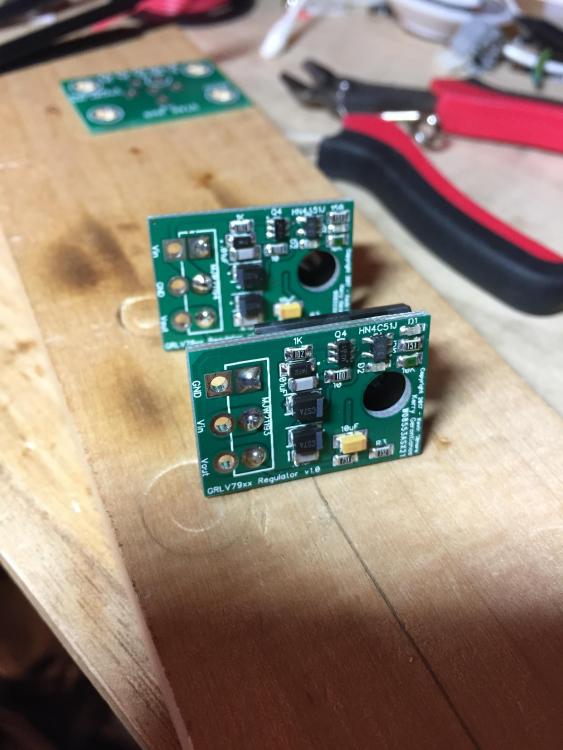

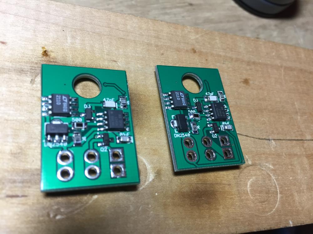

Kerry Posted April 1, 2017 Report Posted April 1, 2017 Just built my mini GRLV supplies. The Negative came up just fine and works perfectly The positive supply is giving me some issues and I'll need to debug it. Here's some pictures... This pic shows a board I made for the Blue Hawaii that has the +5V, Digital Controller (ATMega328P) and Digital attenuator board along with the GR7/9xx regulators. I'll mount them once the positive supply is working. 9
gepardcv Posted April 1, 2017 Report Posted April 1, 2017 What is the heatsinking story with these mini-GRLVs?
congo5 Posted April 1, 2017 Report Posted April 1, 2017 1 hour ago, gepardcv said: What is the heatsinking story with these mini-GRLVs? For low amperage/wattage like in pic above, copper on the board is the heatsink for higher power you can mount it to whatever size heatsink it needs.

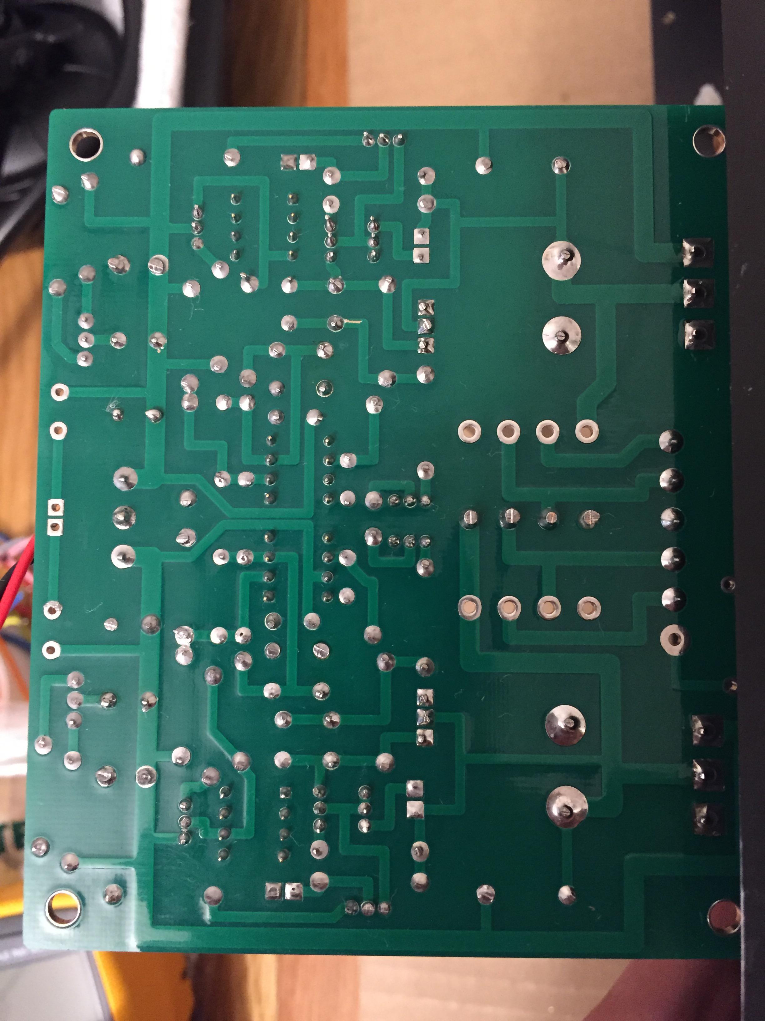

gepardcv Posted April 7, 2017 Report Posted April 7, 2017 Well, I finally got around to making a GRLV. Three of them, actually. The positive rail works fine on all three, outputs perfect voltages (one +20V, two +30V, exactly as expected). The negative rail on all three outputs 0V. What's a good place in the circuit to start digging?
mwl168 Posted April 8, 2017 Report Posted April 8, 2017 Can you post a close up photo of the negative side?

gepardcv Posted April 8, 2017 Report Posted April 8, 2017 On MJW21193, emitter voltage is 0, collector 0.117V, base 0.012V. Picture attached. I'm using a center-tapped transformer winding, so just one bridge.
spritzer Posted April 8, 2017 Report Posted April 8, 2017 I assume there is a trace to connect the second output from the rectifier so what is the raw DC on the input cap?
congo5 Posted April 8, 2017 Report Posted April 8, 2017 The main storage cap connects directly to bridge rectifier and collector so .1v bad bridge or no connection to transformer? That board is nice and clean! What is ACV at terminal block? the voltage is not making it through the first two inches............
spritzer Posted April 8, 2017 Report Posted April 8, 2017 Hehe didn't read what was above the pic... Yeah has to be a bad connection...
congo5 Posted April 8, 2017 Report Posted April 8, 2017 just stating fact, the best I know, not to infer anything there should be continuity between collector and pin of bridge closest to input connector and second pin of rectifier to transformer input a dead short like a bad cap would make the transformer unhappy, buzz and hot. I assume that isn't the case. usually its a very simple cause, but hard enough when its in front of you to find. I have one that is a bit noisy, like 5v of ripple at 80hz, I did the layout so you know where the problem stems from.
Tinkerer Posted April 8, 2017 Report Posted April 8, 2017 Probably the trace on the top of the board for the bridge, that last leg closest to the AC input.
gepardcv Posted April 8, 2017 Report Posted April 8, 2017 Interesting! I'm measuring no continuity between the collector of the MJW21193 and the bridge leg closest to the AC input. Would that explain it? In which case I guess I should just jumper those two points?
cspirou Posted April 8, 2017 Report Posted April 8, 2017 Since it's all three I would say it's a bad PCB?
kevin gilmore Posted April 8, 2017 Author Report Posted April 8, 2017 highly unlikely the board is bad maybe you are connecting the transformer to the wrong place, center tap of transformer goes to the middle pin and for single bridge the other 2 wires go next to the center pin if there is no raw dc voltage on either of the main power caps, the bridge is toast or not the correct type for this board
congo5 Posted April 8, 2017 Report Posted April 8, 2017 (edited) transformer input vac? blue to pink, and each to green? (center three) brown trace connects though via on right bridge footprint? 7 hours ago, gepardcv said: In which case I guess I should just jumper those two points? Lets find out where the break is first. is it just the via? that is easy to fix. Edited April 8, 2017 by congo5
congo5 Posted April 8, 2017 Report Posted April 8, 2017 when using single bridge it seems like a good idea to solder a wire in that one hole rather than rely on the through hole plating
Tinkerer Posted April 8, 2017 Report Posted April 8, 2017 The problem with the single bridge on my boards (blue ones from the last GB) was the holes were smaller than the side ones so you had to drill it out to fit. I left the bridge lifted up a bit from the board so I could solder that top board trace from the top side to be sure it was connected right.
kevin gilmore Posted April 8, 2017 Author Report Posted April 8, 2017 why no one tell me I got the wrong hole size... updated goldenreference6d file. 1
Pars Posted April 8, 2017 Report Posted April 8, 2017 It was mentioned in the group buy thread, but not here. Our bad
