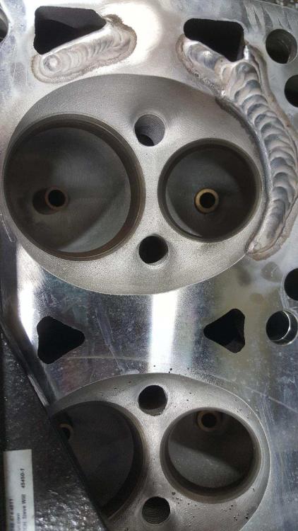

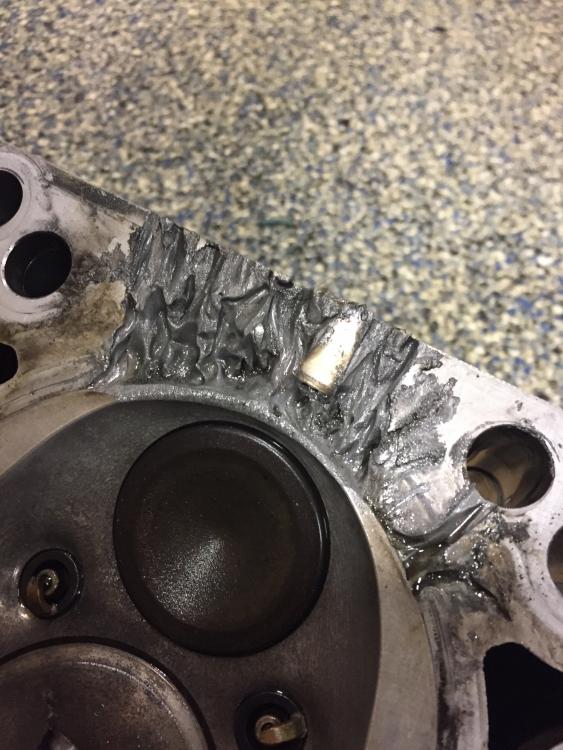

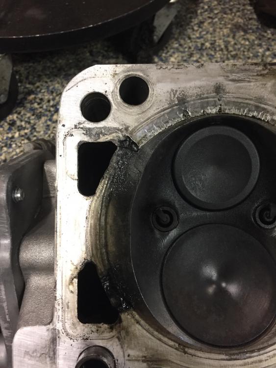

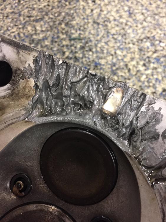

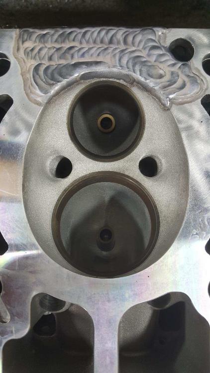

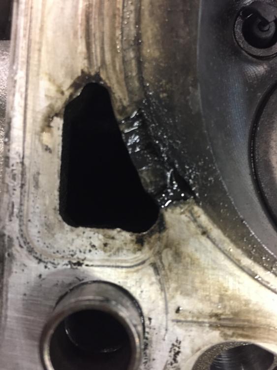

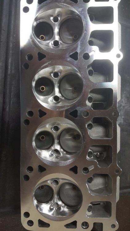

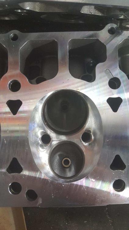

HemiSam Posted April 8, 2018 Report Posted April 8, 2018 So I pushed my motor a bit more than I intended. Long story short I have a transmission controller and now that I converted the car to an automatic (could not get a manual to survive) I have been playing with locking the torque converter (fluid coupler). At the quarter mile, worked like a dream. Feels like a shift to another gear...powerful and great for my elapsed times and trap speed. Well, I tried the same at the standing mile last year and I had a different result than I planned. Basically, I use overdrive in the standing mile and when I finally got the transmission to take OD (4th gear for me) by getting out of it and bumping it to neutral and back, it made crazy power and pulled like I've never felt her go. That was the good part. The bad part is it excited the turbos more than planned and she made more boost at the manifold than I expected. Result...I raised the heads. So if you haven't seen this before, imagine all they dynamic cylinder compression created by the piston stroke with the benefit of turbo compression flaming out the side of the head/block area. Basically...a blow torch. Managed to get the car safely to a stop and aside from a bit of fire suppressant to ensure the smoking under the hood was not fire, not too hard on the motor/car. But I did do this to the heads and I wanted to share so you could 1) see what it looks like if you haven't before and 2) see some craftsmanship the gent that made these for me does on heads. Basically three steps thus far: my trashing them, welding and rough machining, and then cleaning them nicely. Note on the last step the chambers have been "softened"...there's an edge within the chamber if you will. That's for quenching and better handling the heat from boost and avoiding pre-detonation. vroom vroom... HS 5 Quote
Dreadhead Posted April 9, 2018 Report Posted April 9, 2018 I hope those repairs last for you Your dedication to straight line speed is epic. 2 Quote
wink Posted April 11, 2018 Report Posted April 11, 2018 Inspiring.... I remember a friend of mine who used to race a Triumph bike on dirt track, and in the dark you could see light between the cylinder and the head. Later models motors had more studs..... Quote
HemiSam Posted April 11, 2018 Report Posted April 11, 2018 Studs stretch some or they break. Metallurgy... Not for the faint of heart when combined with high pressure, heat, detonation... HS Quote
ironbut Posted April 11, 2018 Report Posted April 11, 2018 Those are amazing pic's Sam! I wouldn't want to be a spark plug in your cylinder head in another life! 1 Quote
Laowei Posted April 11, 2018 Report Posted April 11, 2018 Must have been heart stopping to have that happen when you were hard on the throttle at speed. Your mechanic/welder/machinist is a magician. His work in restoring the damaged heads is incredible. Hope you bought him a beer afterward. ? 1 Quote

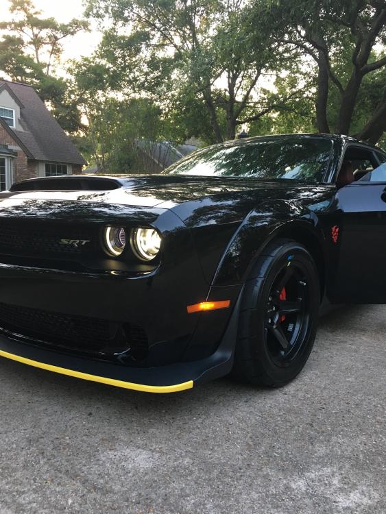

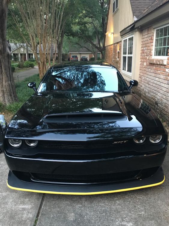

naamanf Posted May 12, 2018 Report Posted May 12, 2018 Nice! Seems a little bit like cheating though. 1 Quote
guzziguy Posted May 12, 2018 Report Posted May 12, 2018 28 minutes ago, HemiSam said: Whoops.... HS I usually don't like Plymouth/Dodge products but yours is a little nicer than most. 1 Quote

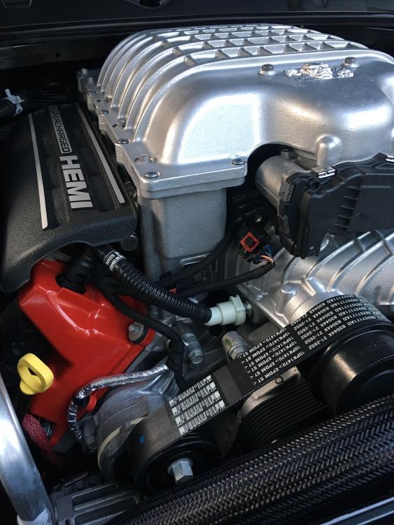

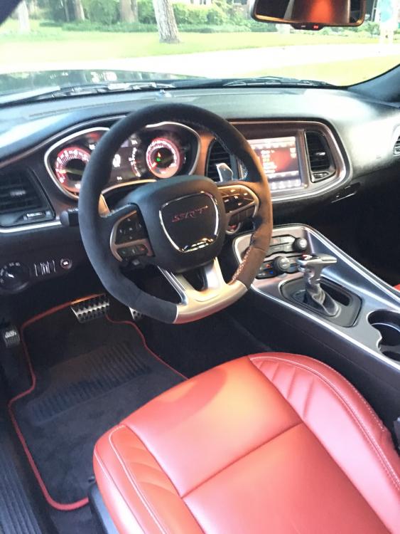

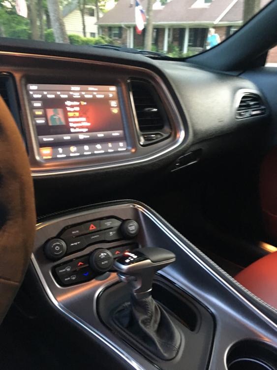

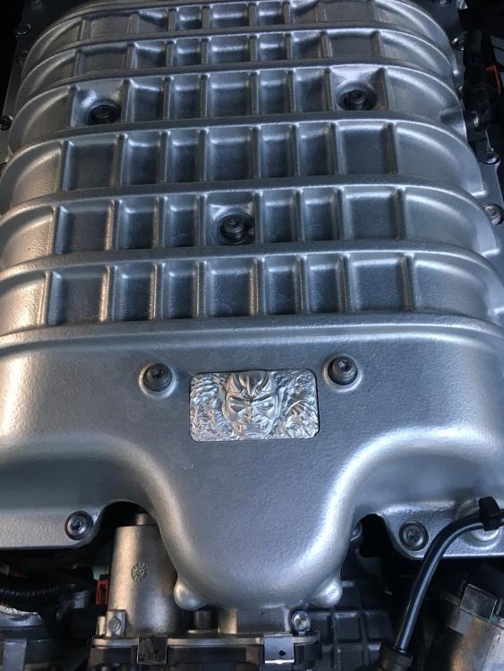

HemiSam Posted May 12, 2018 Report Posted May 12, 2018 10 minutes ago, naamanf said: Nice! Seems a little bit like cheating though. Great, ain’t it?!? In all seriousness, my blue 2009 Dodge Challenger R/T weighs more due to the addition of safety and go-fast kit and is ~1.5 seconds faster in the quarter mile at this point. Low 10’s @ 13x mph vs 8.7 secs @ 161 mph in the quarter is a huge delta. The Demon sure is nicer to drive though HS 3 Quote

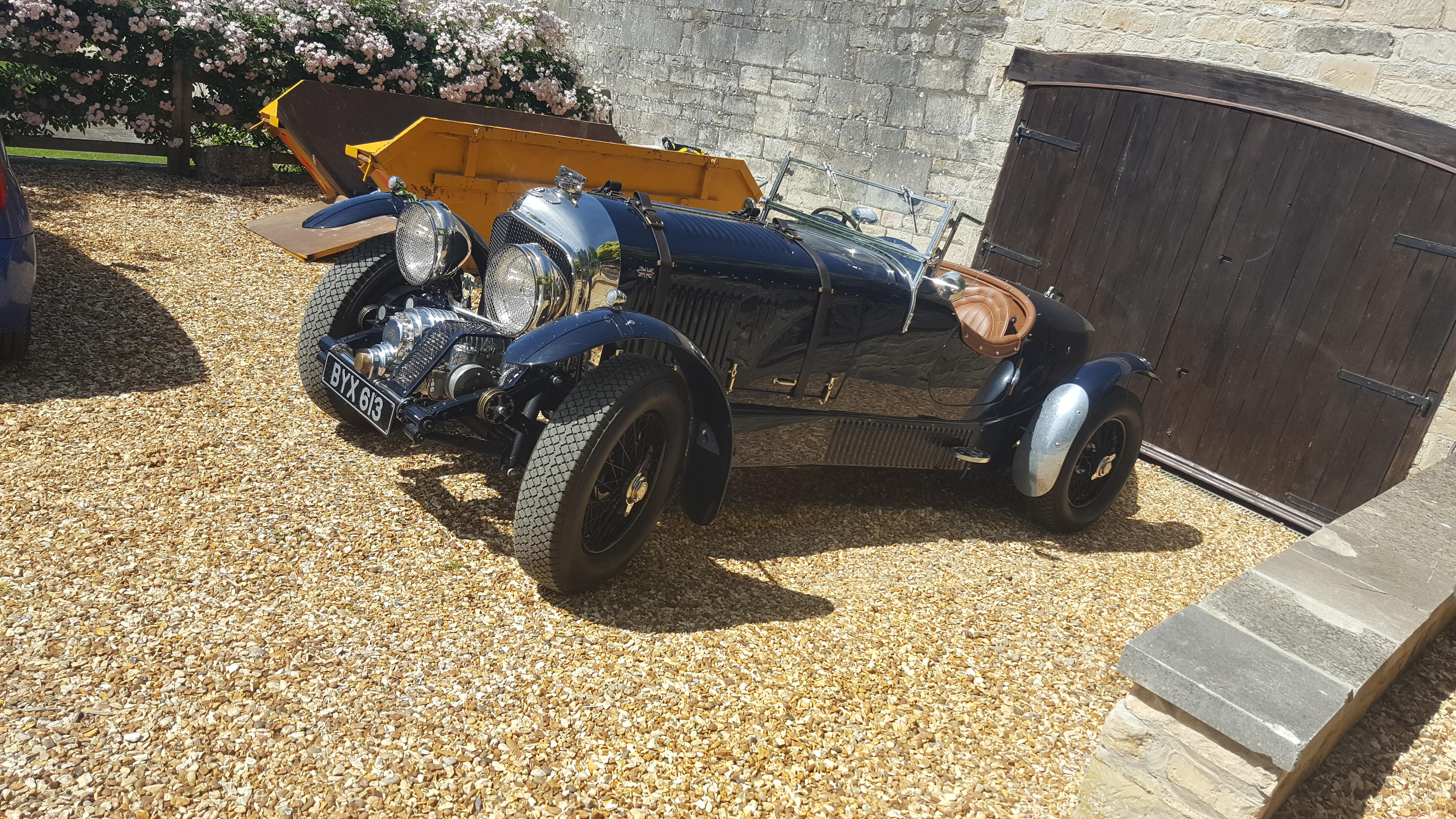

Craig Sawyers Posted June 25, 2018 Report Posted June 25, 2018 Spotted on a walk this weekend. Bentley Blower. Probably a replica, but still at least $1.5m worth. 6 Quote
HemiSam Posted June 25, 2018 Report Posted June 25, 2018 5 hours ago, Craig Sawyers said: Spotted on a walk this weekend. Bentley Blower. Probably a replica, but still at least $1.5m worth. Very nice! What I struggle with on these older cars is visualizing proportions. In other words, they can be quite a bit longer/bigger than they appear to me on the photo. Is that a big car relative to say something modern? The craftsmanship looks amazing. HS Quote

Hopstretch Posted June 25, 2018 Report Posted June 25, 2018 (edited) They are pretty small by comparison to a modern race car, but not at all flimsy -- built like tanks under the skin. Know I posted about it maybe a year back, but this reminds me again of when I got to see maybe my favorite car ever taken out for one of its few drives a year at the Brooklands Museum. http://www.speedhunters.com/2013/01/napier-railton-car-feature/ Edited June 25, 2018 by Hopstretch 2 Quote
HemiSam Posted June 25, 2018 Report Posted June 25, 2018 37 minutes ago, Hopstretch said: They are pretty small by comparison to a modern race car, but not at all flimsy -- built like tanks under the skin. Know I posted about it maybe a year back, but this reminds me again of when I got to see maybe my favorite car ever taken out for one of its few drives a year at the Brooklands Museum. http://www.speedhunters.com/2013/01/napier-railton-car-feature/ Very cool...I recall this pic you posted previously! This is why I ask...to me those tires look huge as does the bonnet. Cool stuff! Gotta love the stainless finish...all business. HS Quote
Craig Sawyers Posted June 26, 2018 Report Posted June 26, 2018 The blower I posted pics of is definitely a replica - there are only two of the 40 originals in existence. But it produces 182hp using 10lbs per square inch of boost from the supercharger and a top speed of up to 120mph. Engine was a 4.4 litre straight four with twin carbs. Physically it was pretty imposing. 14 foot 4 inches long. There is a good write up here https://www.telegraph.co.uk/motoring/classiccars/10068232/Bentley-4-Litre-Blower-review.html Particularly that there are reputedly 100 replicas out there 1 Quote

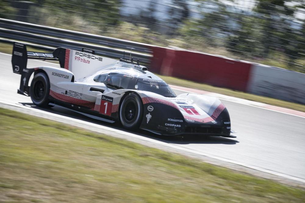

Hopstretch Posted July 1, 2018 Report Posted July 1, 2018 OMG that thing is insanely fast. That's nearly a minute off the previous record! I wonder how they extracted the seat cushion from the driver's asshole afterward? ? 1 Quote
HemiSam Posted July 2, 2018 Report Posted July 2, 2018 OK....that gave me a chubby! Wow that was sexy driving. 225-226mph for extended period....yummy chow. To beat prior vehicles by that kind of margin I need to better understand. Regardless...that driver is a fricken rock star. Wow. HS Quote
Hopstretch Posted July 2, 2018 Report Posted July 2, 2018 The 919 tribute is a hybrid with a mere 1100 HP and active aerodynamics. Dude went through a chicane at 300 km/h, so you know that shit works as advertised. Former lap record was a Group C Le Mans winner as the circuit is too dangerous for Formula One. Also Porsche (958) at 6:11:13 in 1983. Vroooooooooooooooooooooooooooooom .... 1 Quote
