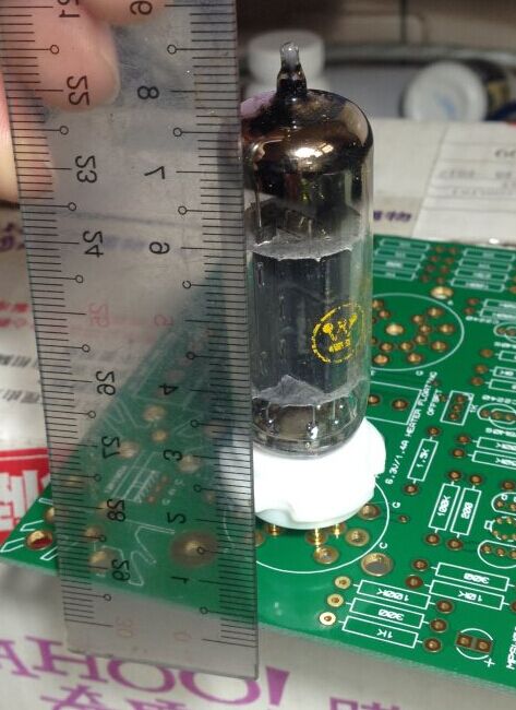

Earspeakers Posted February 12, 2015 Author Report Posted February 12, 2015 Just use your own words - 9 pin Teflon. teflon cmc 9 pin Yes I saw those but I believe they are chassis mount. Spot checking they all mention chassis mount only http://www.ebay.com/itm/NEXUS-MUSIC-Premium-9-PIN-9P-Gold-Plated-Teflon-Tube-Socket-12AU7-ECC83-2PCS-/181469359862?pt=LH_DefaultDomain_0&hash=item2a406aaef6 So are you saying these also will work in the KGST PC mount? Quote
GeorgeP Posted February 12, 2015 Report Posted February 12, 2015 As Kevin said, .... you just don't use the chassis strap Yes I saw those but I believe they are chassis mount. Spot checking they all mention chassis mount only http://www.ebay.com/itm/NEXUS-MUSIC-Premium-9-PIN-9P-Gold-Plated-Teflon-Tube-Socket-12AU7-ECC83-2PCS-/181469359862?pt=LH_DefaultDomain_0&hash=item2a406aaef6 So are you saying these also will work in the KGST PC mount? Quote
Earspeakers Posted February 12, 2015 Author Report Posted February 12, 2015 As Kevin said, I did wonder what he meant by that, Parts Connection has the PC mount I'm used to (older style with leaf flanges) which is what I thought he was talking about. Well thanks for all the help, learned something new and saved myself some money. Quote

palchiu Posted February 18, 2015 Report Posted February 18, 2015 Yes I saw those but I believe they are chassis mount. Spot checking they all mention chassis mount only http://www.ebay.com/itm/NEXUS-MUSIC-Premium-9-PIN-9P-Gold-Plated-Teflon-Tube-Socket-12AU7-ECC83-2PCS-/181469359862?pt=LH_DefaultDomain_0&hash=item2a406aaef6 So are you saying these also will work in the KGST PC mount? Yes, it's fit. May cut pin shorter let sockets lower. Quote
