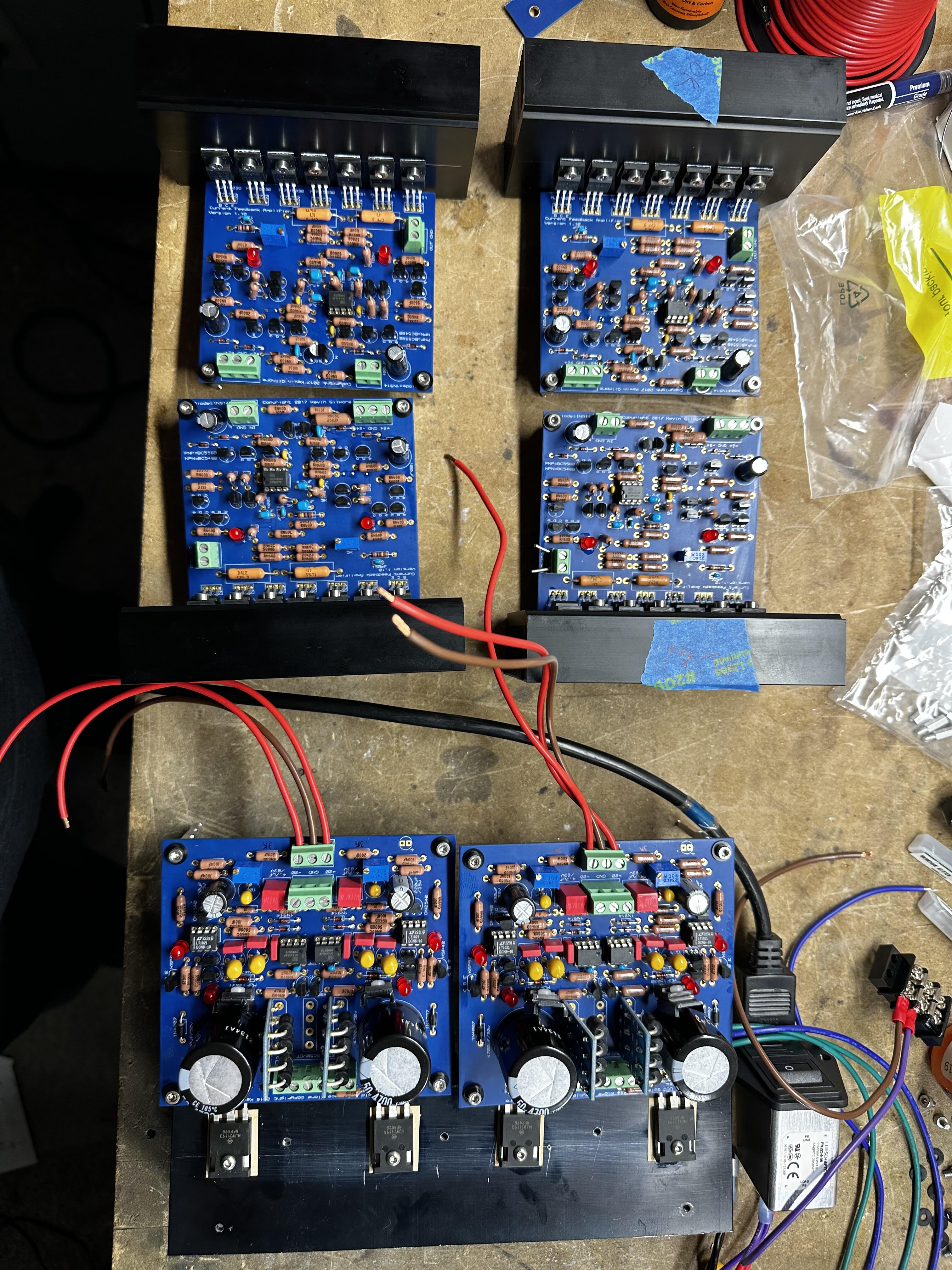

Satyrnine Posted May 26, 2023 Report Share Posted May 26, 2023 I built a protector board up for this. When I connect it to one of the grlv set to 30v (also powering 2x CFA boards), it causes pretty bad high frequency noise on the outputs. Right now in SE mode, grounding negative inputs. I tried grounding two ways: 1) GRLV ground AND cfa output grounds all connected to protector board. (hf noise was present) 2) Only GRLV ground connected to protector, cfa output grounds and protector input ground connected to star ground. (hf noise was worse) When I remove the protector, cfa is dead quiet. I've read these can be used with 30v, but maybe I'm stressing 12v regs too much? Quote Link to comment Share on other sites More sharing options...

migo Posted May 28, 2023 Report Share Posted May 28, 2023 On 5/26/2023 at 3:51 AM, Satyrnine said: I built a protector board up for this. When I connect it to one of the grlv set to 30v (also powering 2x CFA boards), it causes pretty bad high frequency noise on the outputs. Right now in SE mode, grounding negative inputs. I tried grounding two ways: 1) GRLV ground AND cfa output grounds all connected to protector board. (hf noise was present) 2) Only GRLV ground connected to protector, cfa output grounds and protector input ground connected to star ground. (hf noise was worse) When I remove the protector, cfa is dead quiet. I've read these can be used with 30v, but maybe I'm stressing 12v regs too much? When do you disconnect one of CFA3 boards from power is that noise still there while using protector board? Quote Link to comment Share on other sites More sharing options...

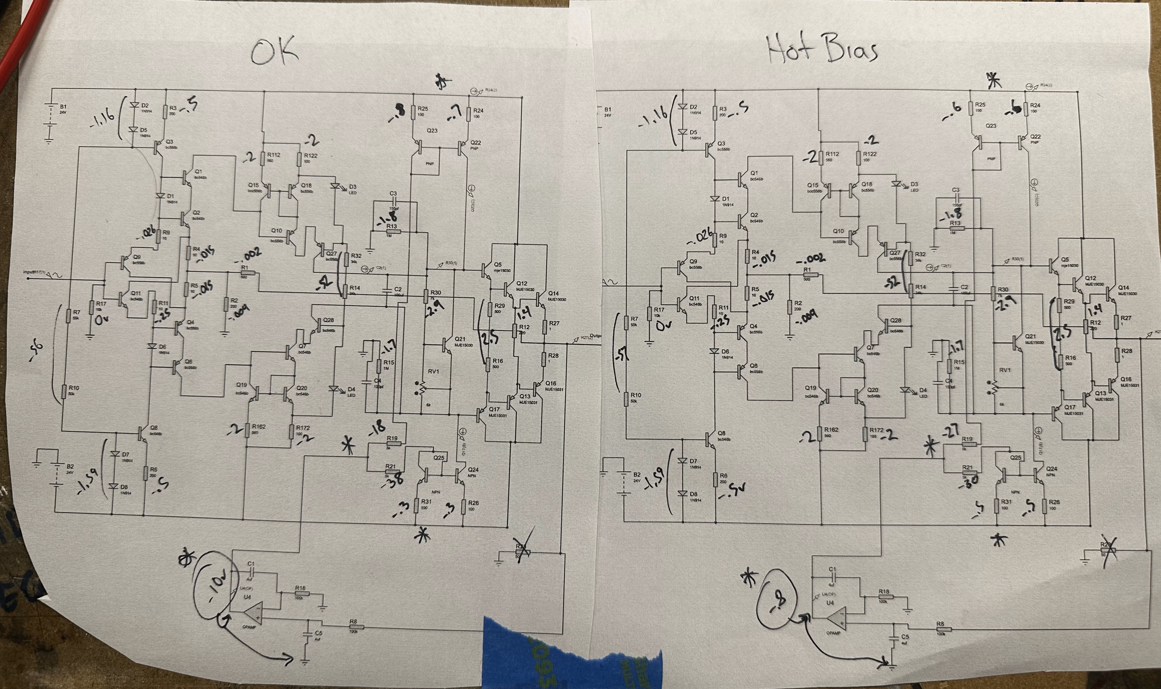

Satyrnine Posted June 8, 2023 Report Share Posted June 8, 2023 (edited) I bit the bullet and took measurements of an OK and the "Hot Bias" CFA2 boards. Here is what I found: Test conditions: OK board biased to around 120ma, trimpot in middle-ish position. Hot bias board has trimpot all the way down, which gives about 100ma of bias. Ran from the same GRLV at 30v. Clearly the big difference is the output of the servo is showing 10v on OK board, and only .8v on hot bias board. Servos getting proper voltage on each board. I swapped in a known good chip, no difference. The 5k feeders after servo are showing dif drops between boards too. Can anyone give me some guidance on where to go from here? Edited June 8, 2023 by Satyrnine Quote Link to comment Share on other sites More sharing options...
