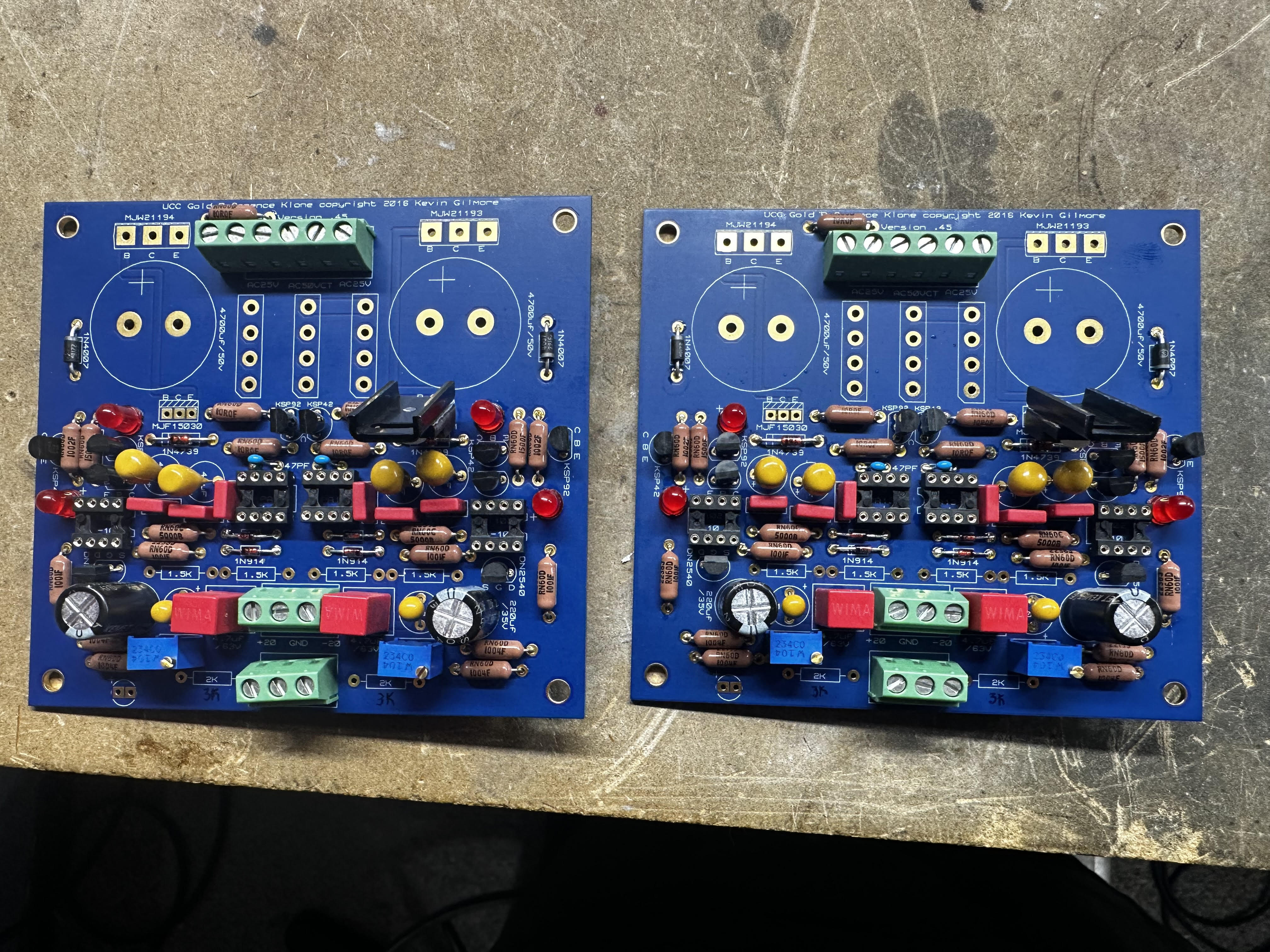

Satyrnine Posted April 29, 2023 Report Posted April 29, 2023 (edited) I started populating my grlv's tonight. I tested my MJF15030 and 31's and they vary quite a bit. I recall it said that matching isn't too terribly important, but want to double check. I know I'll get scolded, but I DID source the 30's from a seemingly legit and well reviewed ebay seller, since they are out of stock everywhere. I'm wondering if I got a batch of rejects. Here's what I found: MJF15031 from mouser: All around 280hfe +/- 5. MJF15030 from THIS ebay seller: 80-150hfe. Oof. Visually they look identical, even with a loupe. I know that doesn't nec. mean much. Is this normal? If these are questionable, anyone have a source for 30's? Also, the larger tantalums are 36v, not sure if they see full 30v or not, that's a bit too close to 30v if so. I ordered from an existing bom, and didn't catch this. Edited April 29, 2023 by Satyrnine Quote
jamesmking Posted April 29, 2023 Report Posted April 29, 2023 (edited) 1 hour ago, Satyrnine said: MJF15031 from mouser: All around 280hfe +/- 5. MJF15030 from THIS ebay seller: 80-150hfe. Oof. Visually they look identical, even with a loupe. I know that doesn't nec. mean much. Is this normal? If these are questionable, anyone have a source for 30's? almost no authorized seller except farnell has MJF15030G in stock at the moment. Farnell has 347 https://uk.farnell.com/on-semiconductor/mjf15030g/transistor-npn-150v-8a-to220fp/dp/9556303 meanwhile the nonauthorized sellers claim to have about 300000 in total between them - I call BS... using a atlas dca75 pro I get hfe values of 89, 79, 87, 87, 95, 91, 98, 75, 108 for the 9 in my current stock (from radio spares, all purchased at the same time) - known good and used in GRLV. test conditions are: Ic 5mA, VBE 0.675V IB 5mA NPN silicon BJT. Spec sheet says 40hfe minimum for sensible currents.. no range or max is given.... My MJF15031 (from mouser) measure much higher hfes than the MJF15030. hfe 265, 263,264, 270, 263, 265,265, 269, 264, 266. So im getting a similar difference in hfe between the 30s and 31s as you are and a similar spread of hfes. Edited April 29, 2023 by jamesmking 1 Quote
Satyrnine Posted April 29, 2023 Report Posted April 29, 2023 7 minutes ago, jamesmking said: almost no authorized seller except farnell has MJF15030G in stock at the moment. Farnell has 347 https://uk.farnell.com/on-semiconductor/mjf15030g/transistor-npn-150v-8a-to220fp/dp/9556303 meanwhile the nonauthorized sellers claim to have about 300000 in total between them - I call BS... Oh wow, that must have been recent stocking! I just ordered from Farnell/Newark. Thanks! Definitely not something to risk. Quote
