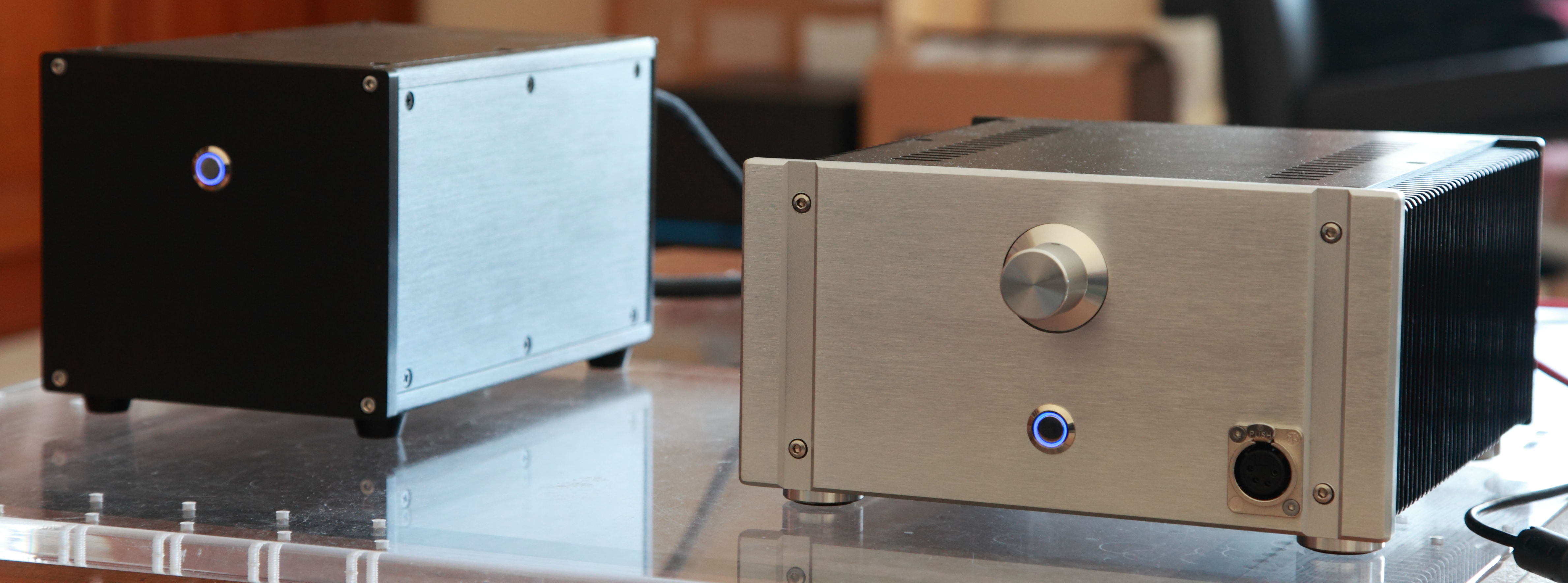

mwl168 Posted December 23, 2017 Report Posted December 23, 2017 I like the CFA2 so much I want to give it a separate PSU to move the transformer away from the amp circuit. The PSU chassis came in a few days ago. Still debating if to go dual-mono with 2 GRLV. 5 2 Quote
jose Posted December 23, 2017 Report Posted December 23, 2017 (edited) I´ll probe with one and two PSU´s. The amperage of the r-core is small (25volt@1A x 2) so I do not know if one can supply enough voltage to all four channels. For other hand, I have toroids with secondaries 30volt@3A x2 that I guess can use if it's necessary. Edited December 23, 2017 by jose Quote

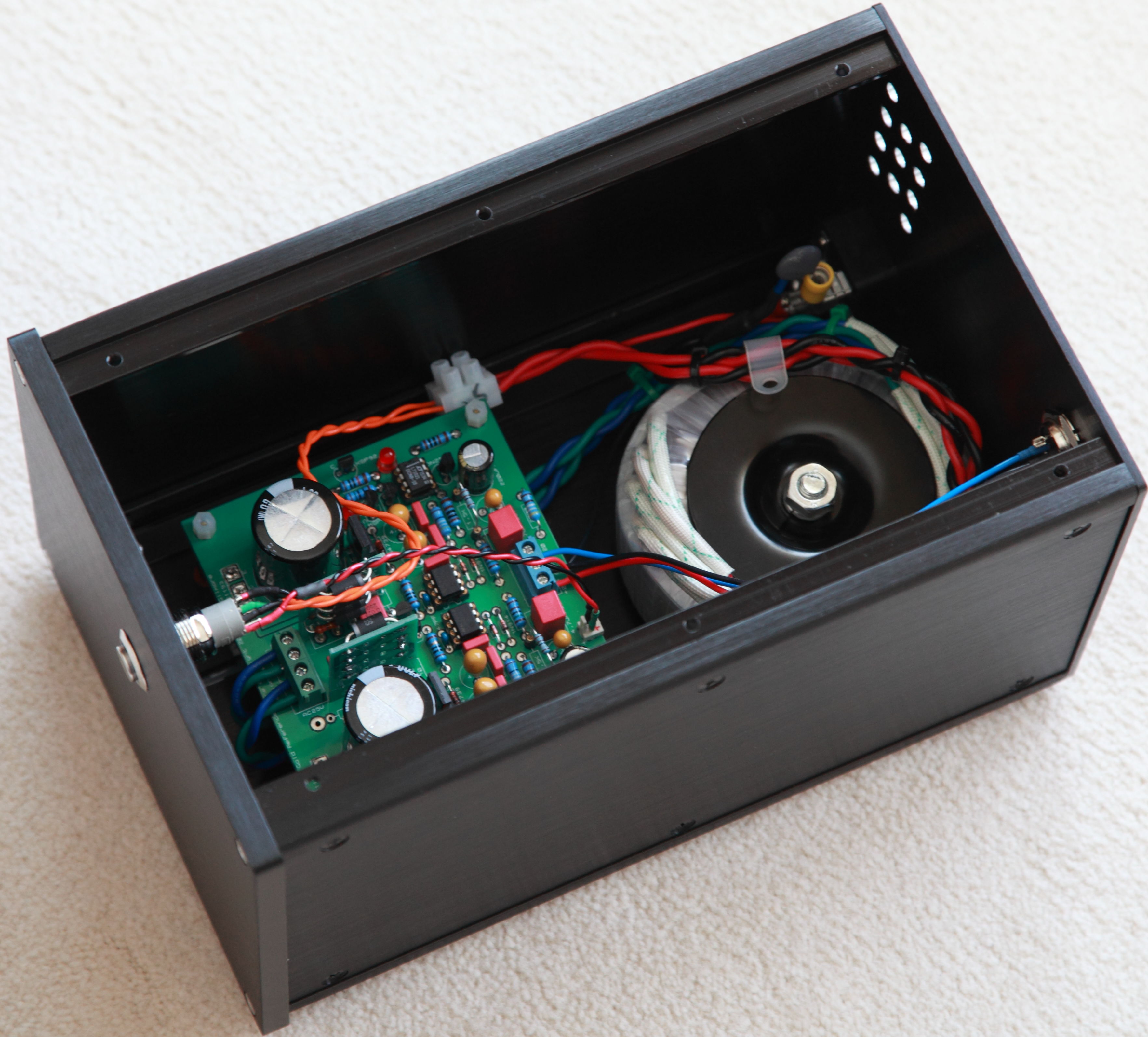

jose Posted January 26, 2018 Report Posted January 26, 2018 On 03/01/2018 at 10:07 PM, kevin gilmore said: Should be just fine I'm listening my system; Dac, Classé preamp, CFA/bal and the LCD2. All system on Bal connection. Guys, this is just brutal. Thanks Dr. Gilmore !! I consider that the Dynahi has a more "musical" sound and the CFA/bal has a flatter and more precise sound being a beast in terms of power. Now I am considering whether to do my unbal/bal or to use the CFA directly using the preamp outputs of my Classé. 3 Quote
jose Posted February 13, 2018 Report Posted February 13, 2018 My amp module is ready. Now I'm working on a second Psu for the amp (dual-mono) and at the same time I work on the unbal/bal preamp (I have the PSU ready). I want to do a three module system. 3 Quote
