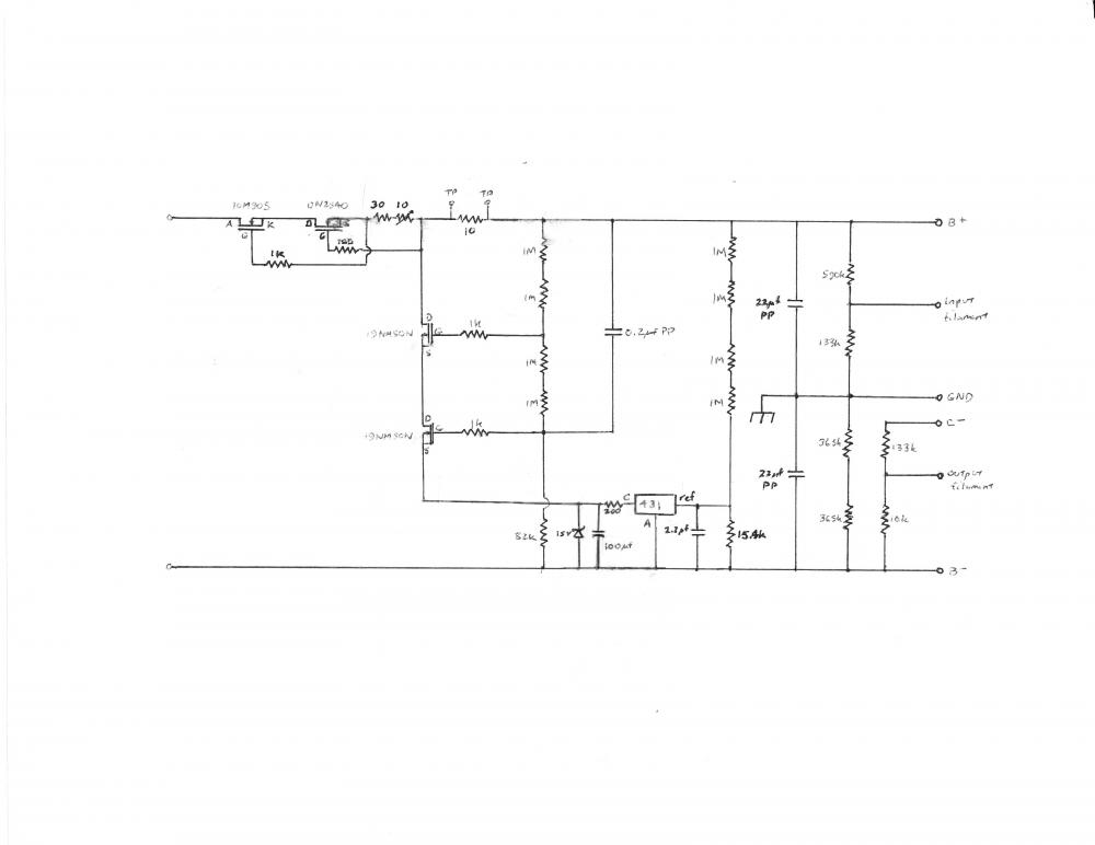

Shunt_regulator.thumb.jpg.4327d279002b22The second part of my SRX Plus article is now published in the Dec 2015 issue of AudioXpress so I can complete the discussion of the shunt power supply.  The schematic is posted above.
It is almost deceptively simple, but with some neat design touches.  There are dropping resistors for the input stage tail current source, resistors to set the voltages across the output capacitor, and taps to bias the filament voltages for the input and output tubes.
The regulator tube in the July 1999 TubeCAD circuit is replaced by two cascoded MOSFETs.  Since MOSFETs have a much higher transconductance than any triode, this significantly improves its performance with minimal additional complexity.  It uses an Exar SPX431 IC shunt regulator, a temperature compensated chip with about 10 dB lower noise compared to the basic TL431, specified to sink up to 100 mA at a maximum of 30 volts – though not simultaneously, since its maximum power dissipation is 775 mW.  The noise specification appears comparable to the LT1021-10.
Kevin Gilmore and Linear tried to design a shunt regulator using the 431 back in 2011, however they abandoned it because of oscillation/stability problems and noise issues.  In basic form it had a tendency to oscillate, but stabilizing the IC against oscillation slowed down its response significantly, making it an ineffective AC regulator.  Broskie’s design addresses this problem by bypassing it – literally. In so doing, he converts the liability that KG and Linear were plagued with into a benefit, although that was not his primary intent.  Sometimes, you get lucky.
The raw B+ goes into a cascode constant current source (CCS) like those in the SRX Plus circuit.  The total current is set by the fixed resistor and trimmer pot on the DN2540 source leg.  The circuit appears to be asymmetric, but the CCS forces any current variations caused by the amp to be exactly compensated in the regulator so that the total current remains constant, and thus the current in the negative leg must also remain constant.
If the amp load disappears, 40+ mA goes through the regulator, resulting in more than 30 watts dissipation.  A Wakefield 421K heatsink or bigger should provide sufficient heatsinking, at least for a while.  All active devices except the SPX431 are mounted on the heatsink.   An adequate heatsink is very important, particularly if you use an all solid state bridge rectifier, because in that case, the power supply voltages rise to their final values almost immediately.  However, since the amp circuit does not start drawing current until the tubes warm up, for 10-15 seconds all of the power supply current runs through the shunt.
The shunt element is two cascoded high transconductance STP19NM50N MOSFETs buffering the high voltage to the 431 IC, with a resistor string setting their quiescent voltages and a zener protecting the 431 from overvoltages.  A second resistor string for the 431 reference terminal sets the DC voltage, while the 2.2 µf capacitor between the reference terminal and B- bypasses audio frequencies above 5 Hz, limiting its function to setting the DC voltage.  Broskied did this primarily so the shunt tube would perform the AC regulating function rather than the IC – but as a side benefit, stabilizing the IC will not affect the regulator’s AC performance.
The 200 ohm/100 µf RC network between the 431 anode and cathode stabilizes the IC against oscillation, provides a measurement point for the static shunt current, and filters the 431’s output noise above 8 Hz.  The RC filter was suggested in a note by John Curl.  This network slows the response of the 431 considerably, but that is actually a benefit as it further restricts its AC activity.  Should the output load disappear, the additional current through the resistor drops the voltage across the IC, limiting its dissipation to a safe level, but leaving the regulator on.  Accomplishing four functions with two components is elegantly simple.   As Broskie notes, separating the DC and AC functions limits the sonic effect of the mediocre op amp in the SPX431, while using it to do what it does best, setting a stable DC voltage.
B+ noise and signal variations are fed by a 0.20 µf capacitor into the gate of the lower MOSFET, which acts as a fast AC shunt regulator. Since this MOSFET’s source sees B- noise and signal variations via the 100 µf capacitor, any changes between B+ and B- will alter its gate-to-source voltage, and hence the current flow through the shunt, to maintain regulation.  It is generally considered desirable for the power supply frequency response to be greater than the amp circuitry.  MOSFETs can respond well into the MHz range, hence the gate stopper resistors to prevent oscillations. Cascoding the MOSFETs preserves the transconductance of the lower MOSFET, minimizing its AC resistance.
Hold on a minute, doesn’t a cascode have a high output impedance?  Yes – but it also has a high gain.  The regulator circuit has 100% feedback so the overall gain is -1. With feedback, the output impedance of the shunt is roughly the on-resistance of the lower device.
Broskie notes that this design provides a single simple pathway, a virtual AC short, between B+ and B-.  Since the B+ and B- are set by the resistor dividers, they track each other, and since the power supply ground is not directly involved in the regulation, interaction between power supply and audio signal grounds is reduced.  By contrast, in the usual bipolar regulated supply, B+ and B- are regulated separately with respect to ground, the two supplies do not track each other, and the regulating currents flow through the power supply ground – a less optimum topology.

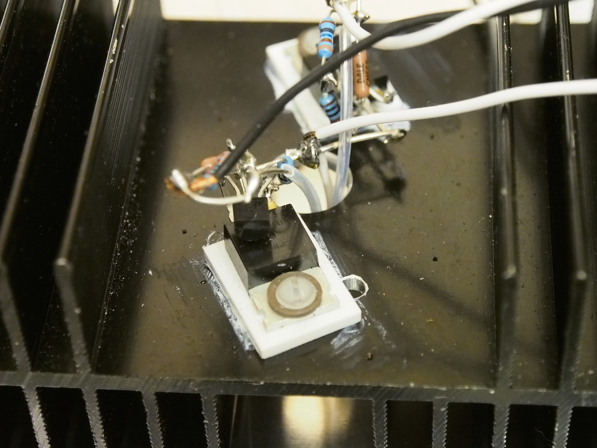

Small circuit modifications improved performance significantly.  The regulator was wired point-to-point on perfboard, making modifications easy to implement.
Initially, I used a TL431 with its cathode connected to the lower MOSFET source by a 100 ohm resistor, and a 10 µf cap between its anode and cathode, similar to the TubeCAD circuit.  With this, the amplifier output noise, measured with a Fluke 189 DMM with an AC bandwidth of 100 kHz, was about 200 mV RMS with the input grounded.
Changing the 10 µf capacitor to a 2 ohm/10 µf RC stabilizing network across the 431, as suggested in Texas Instruments’ application note, the amp output noise decreased to around 50 mV RMS, suggesting that much of the previously measured “noise” was actually ultrasonic oscillations.  In this configuration, the regulator noise measured about 5 mV RMS between B+ and B-.
Finally, changing the RC network to 200 ohms/100 µf, connecting the MOSFET source to the RC junction, and substituting the SPX431 reduced the regulator noise to <2 mV RMS.  More significantly, the broadband amp output noise dropped to 3-5 mV RMS.
By comparison, earlier this year, Kerry measured the newest version KGSSHV power supply noise at around 5 mV RMS, so in real world terms this shunt PS appears to be in the same ballpark or better, although in fairness, NYC is probably an electrically noisier environment than New Mexico.  This is excellent performance for such a simple circuit, although it probably helps that the raw power supply is pretty quiet.  Voltage was very stable, varying by about 0.1 volt (<0.02%) from cold turn-on to fully warmed up, which is also excellent.
The headroom between the raw power supply and the regulated voltage was about 20 volts – this with a 780 VCT transformer.  My system has a line voltage regulator so this is adequate.  Most systems will need around 100 volts headroom to prevent the regulator from dropping out under brown-out conditions, so an 850 VCT transformer is recommended.
This regulator is simple, quiet and stable, but not the lowest impedance, the major limitation of this circuit.  The 431 is only reacting to a small proportion of the overall voltage, so the DC impedance is around 40-60 ohms, but since the amplifier has a constant current draw this is not a significant issue.  At audio frequencies and above, the dynamic impedance is determined by the on-resistance of the 19NM50N, which is specified at <0.25 ohms, although it probably somewhat higher at its low designed shunt current.  At the highest audio frequencies and above, the metallized polypropylene output capacitors contribute to lowering the dynamic impedance.  However, the amplifier circuit presents a very high impedance to the power supply, so this still looks pretty close to an ideal voltage source.  The benefit of a more complex, lower impedance power supply circuit is likely to be subtle.

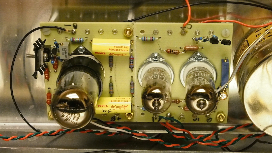

Here is the board layout for one channel, wired point-to-point.  It's pretty straightforward, signal flow from right to left with input on the right and output on the left.  The other pic shows the output current load heat sinks - the wiring goes through the supporting shelf to the current load heatsinks bolted to the other side of the shelf.  Other layouts are possible of course.  The small heatsink on the left is for the output stage current sink, and is a bit marginal - a bigger heatsink would be better.  Everything is soldered together which is good for electrical connectivity but not so good for repairs, but I was building it for myself rather than a commercial design where ability to make repairs easily is an important concern.

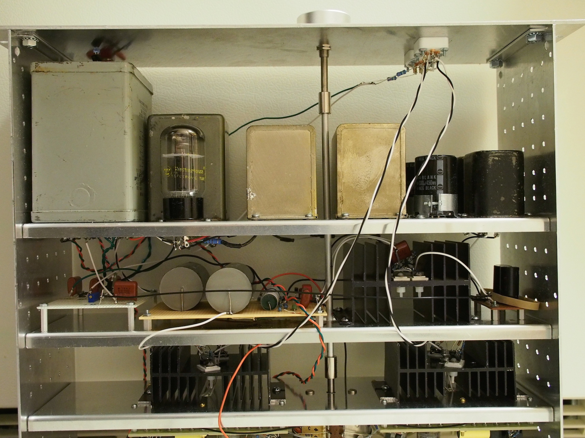

 - in your image above, I see a LOT of big iron in that thing!  Big grey box to left certainly looks like a transformer.  What about the darker grey smaller box and the 2 beige boxes to the right of those?  and the black box to far right?

You don't really need a 5v tap, I just used it to power the delay circuit.  You do need two 6.3 volt windings (on KG's board he actually uses a 6.3 for the 6SN7GTA/B and 12 volt windings for the 12AT7s, so be aware of that.  So the two gray boxes on the left are transformers (the smaller one is actually for the rectifier tube.  The other boxes in the middle and right are chokes.  You can substitute a solid state bridge rectifier for my hybrid rectifier, and you can eliminate the second pair of chokes.  The basic KGBH supply will work also, just set it for +/-350 volts.
You HAVE to have two 6.3 volt windings because the 6SN7GTA cathode sits at around -320 volts and the 12AT7 cathodes sit at around 0 volts and above.  You cannot get away with one 6.3 volt winding, due to exceeding the filament-cathode ratings resulting in premature tube failure.  This is one of the screw-ups in the SinglePower ES-1.
