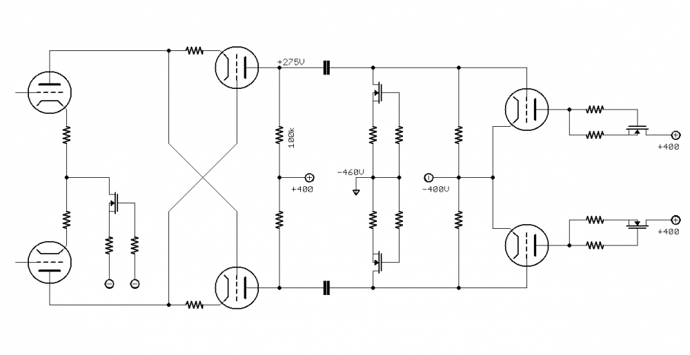

I ended up opening mine to fix a ground loop, and well, one thing led to another until it morphed into this. The outputs are EL34 triodes. Mine never had the tail CCS in the output stage, but rather a shared cathode resistor as well as a C- supply, per this fellow's post over yonder.
update-2015.thumb.png.0a73b8d377e4441e24
The old arangement had a C- supply as well as the common cathode resistor that worked quite well. The SR-X Plus' tail CCS seemed like a smart improvement, but wasn't really as practical to implement in my old point to point build.
Another alternative was fixed bias. I don't think that gain mismatch between the EL34s would actually be an issue; due to the CCS loading, both plates end up in series with each other through the load. There's a single current loop like in the CCS-loaded LTP. The grid is biased by a LND150 CCS into the grid resistor. The grids sit around -440V, which conveniently means that the output will clip into the rails before drawing any grid current. The plate CCS makes this arrangement quite safe-- at worst, the plate voltage might drift, but the tube shouldn't burn up.
I was curious to try the amp without global NFB, so that went next. Considering that a gain of 40 or so is sufficient to drive the output to clipping, I reduced the cascode's plate loads to 100K, which had a few interesting consequences. The lower output impedance is more suitable for driving the EL34's Miller capacitance, which, as JimL said, is a pretty big deal when running without NFB. The 12AT7s are also now idling at 1.25mA per section, and have greater voltage across them. 275V still gives the cascode plenty of headroom.
It's still waiting for a -460V supply, which i should finish up tomorrow. Next step is to add some output transformers, and try it on speakers. :)
That's an interesting variation, will be interested in hearing how it turns out.  I would make one comment - without any global feedback you could have some issues with channel-to-channel balance as Dr. Gilmore has mentioned in his articles about the KGSS and BH which were on Headwize (not sure if they are still there or not).
It works!
I haven't put it on the bench yet but channel balance seems good. The difference in sound is much greater than I expected, going off of memory.
A few interesting side effects of opening the feedback loop: the amp is now a fair bit more microphonic than I recall, and the heater noise is much more noticeable. I ended up elevating the heaters about 30V above the cathode potential, and it's now very very quiet. The bass also seems a bit weaker, I think because the coupling caps aren't in the feedback loop. I'll probably replace them with these.

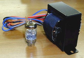

Just tried out a pair of push-pull output transformers on the output. These guys:
6607S.thumb.jpg.d5317e2a757e47fbd5c571cd
They're 8k CT : 16/8/4 rated for 15W/80mA on a core just a bit larger than the SRD-7 stepups, but only have a primary inductance of 11H or so. I was expecting the bass to suck, but the SR-X is happily (?) driving a pair of KEF LS50s now. :) Might mount them to the box and add an output selector.
I thought of doing that at one point, seemed more logical than using transformer-output tube amplifiers specifically intended to drive speakers. How do they sound?
Sounds good enough that I'd consider putting nicer transformers in. After listening a bit longer, the bass isn't quite as nice as I'd like-- similar faults to that I've heard with the Stax step-up transformers, but still quite a bit better and with much more extension. The rest makes up for it, though, and the whole thing gets plenty loud despite the agressive step-down.
Cool!  I bet this is a first - of course Stax built transformers to use with speaker amps but I haven't heard of a headphone amp used with transformers to drive speakers.  I wonder how a T2 or BHSE with transformers would sound driving, say, original Quad ESLs, which don't need all that much power.
