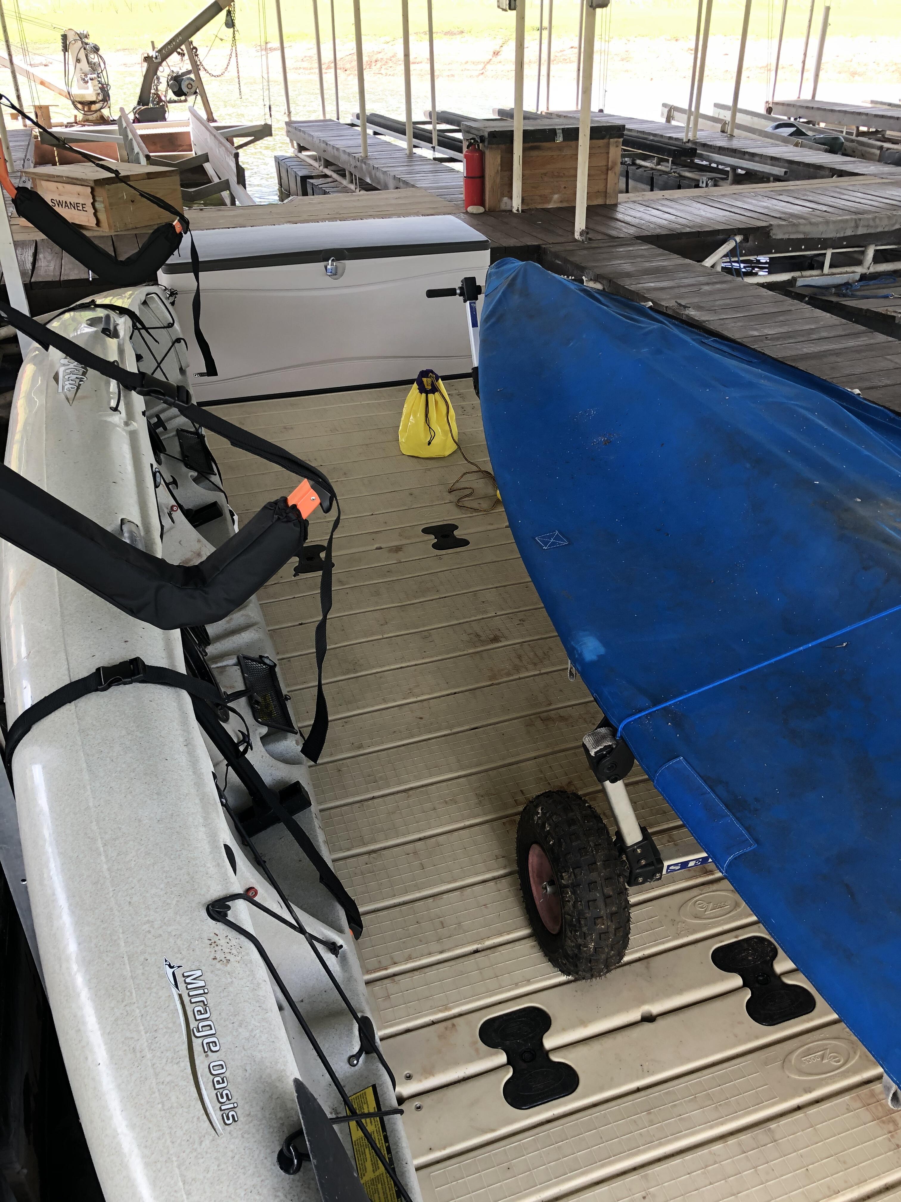

luvdunhill Posted June 22, 2020 Report Share Posted June 22, 2020 I ended up picking a Laser and a Hobie. Mirage Oasis Tandem. I will be storing the sailboat on a Seitech dolly, but looking for a way to store the kayak. I am not sure whether to do a wall mount rack or something on the floor. I likely will end up with two more single kayaks - so some rack system would be nice. Any suggestions? 1 Quote Link to comment Share on other sites More sharing options...
morphsci Posted June 22, 2020 Report Share Posted June 22, 2020 We used a Malone FS Rack to store our three kayaks and it worked fine. We currently only have one kayak and a SUP so I also store a folding ladder on it. Takes up a bit of room but works pretty well. Quote Link to comment Share on other sites More sharing options...
luvdunhill Posted June 22, 2020 Report Share Posted June 22, 2020 My worry is that the Hobie is 93 lbs hull weight and 14.5 ft long. I like the idea of the wall rack but it might just be too hard to get on and off. More research I suppose is needed. 1 Quote Link to comment Share on other sites More sharing options...
morphsci Posted June 22, 2020 Report Share Posted June 22, 2020 Yeah, we did not have anything that large. 1 12 footer and 2 10 footers. The 12 footer weighs about 75 pounds so we used to put it on the bottom but it is now on the top since both the ladder and SUP are used more. Works fine but I’m not sure I would want to wrestle the Hobie onto the top rack. It is actually a floor standing rack since we had very little wall space open with all of the cabinets in the garage. Quote Link to comment Share on other sites More sharing options...
shellylh Posted June 27, 2020 Report Share Posted June 27, 2020 Use a lift. We have a couple in our garage for Yumi’s sea kayak and Porta-Bote. Quote Link to comment Share on other sites More sharing options...

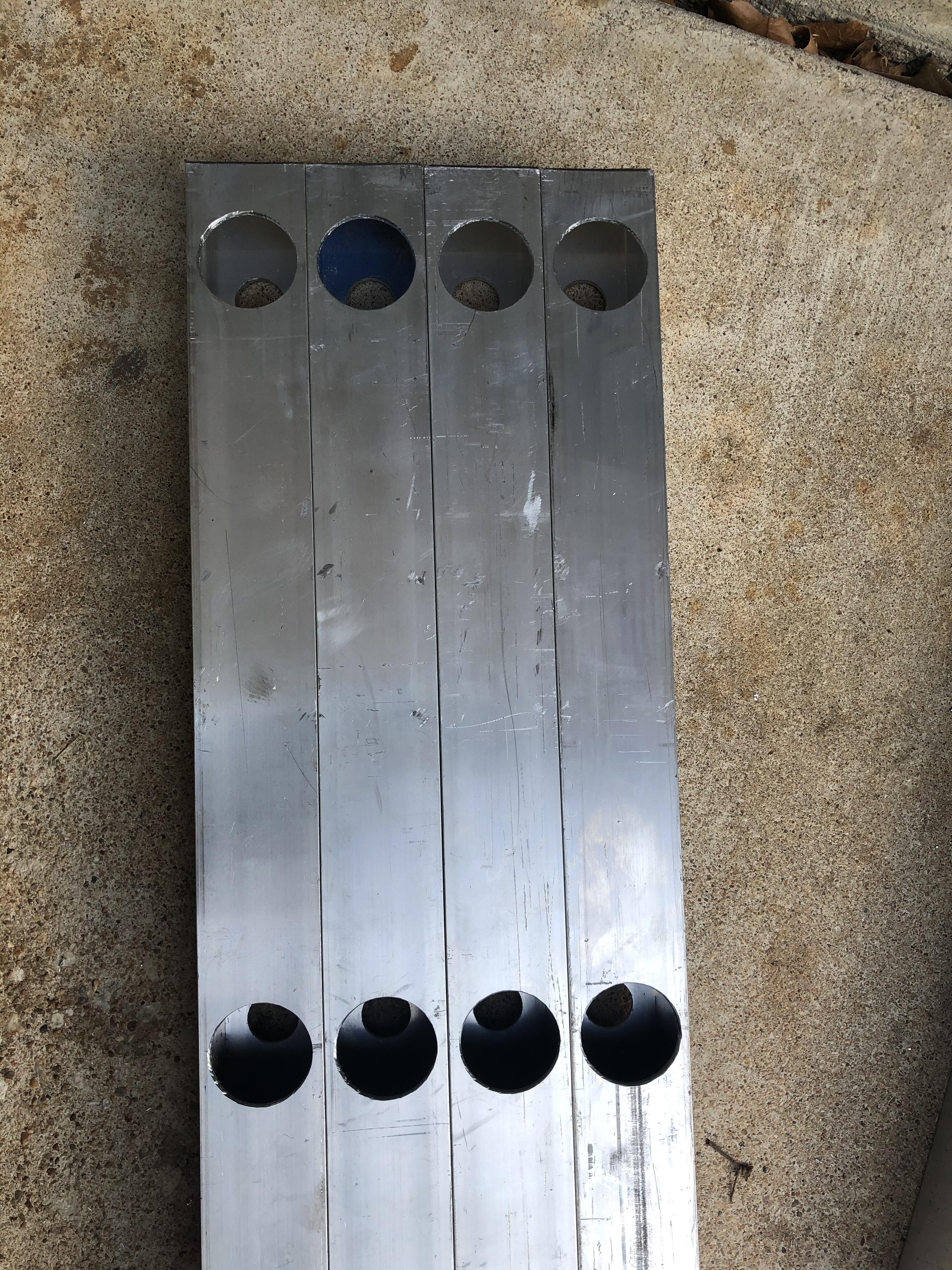

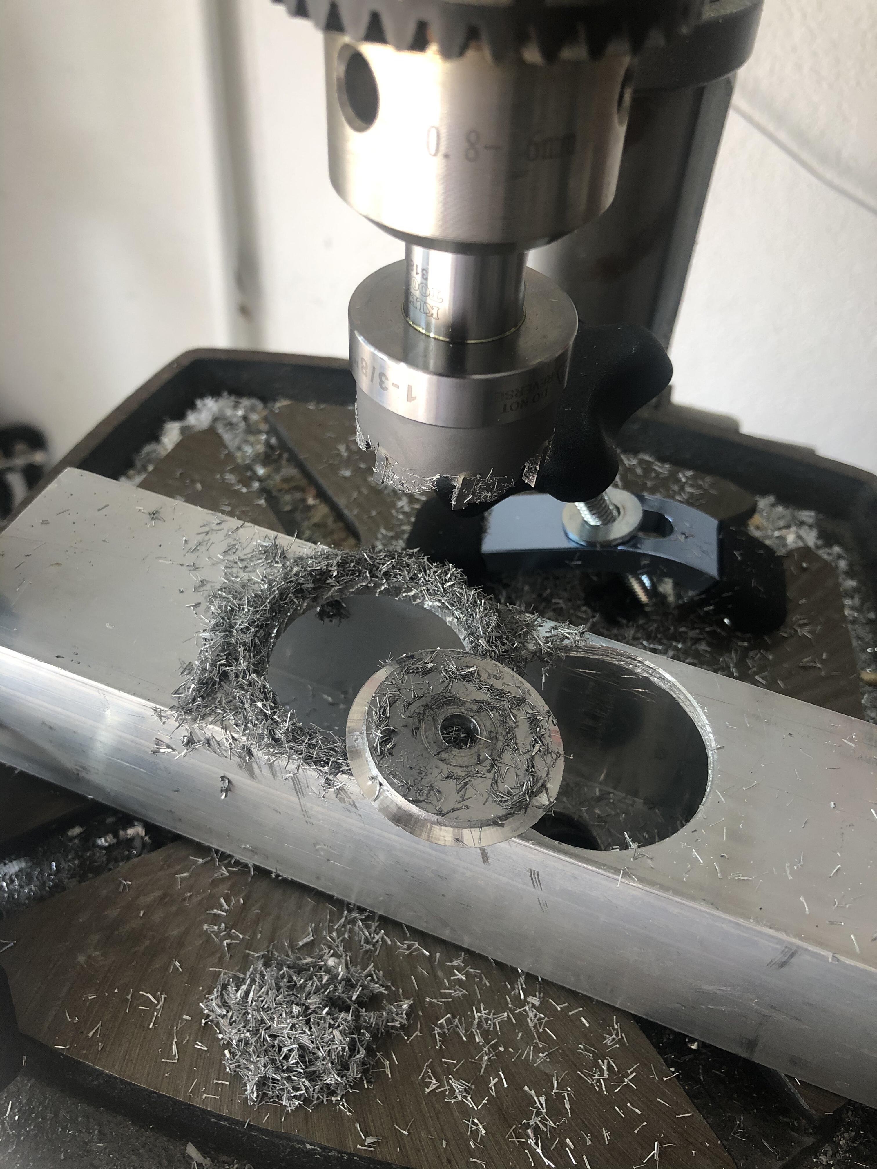

luvdunhill Posted August 25, 2020 Report Share Posted August 25, 2020 I decided to go custom I'll get some pictures after I ensure all my fingers are intact. I ordered some of these: https://www.amazon.com/gp/product/B075K4CTYM/ref=ppx_yo_dt_b_asin_title_o01_s01?ie=UTF8&psc=1 on Amazon to work with my drill press to make some holes with this https://www.amazon.com/gp/product/B0061J5B2Q/ref=ppx_yo_dt_b_asin_title_o02_s00?ie=UTF8&psc=1 I'm not sure if Nate has prior claim with anyone cutting holes, or if that just applies to woodworkers. Oh .. and this: 5 Quote Link to comment Share on other sites More sharing options...
n_maher Posted August 25, 2020 Report Share Posted August 25, 2020 The Guild of Round Hole Cutters is an inclusive and welcoming organization with a proud history of cutting mostly round holes. 2 Quote Link to comment Share on other sites More sharing options...

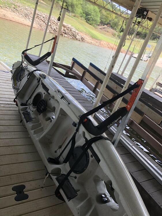

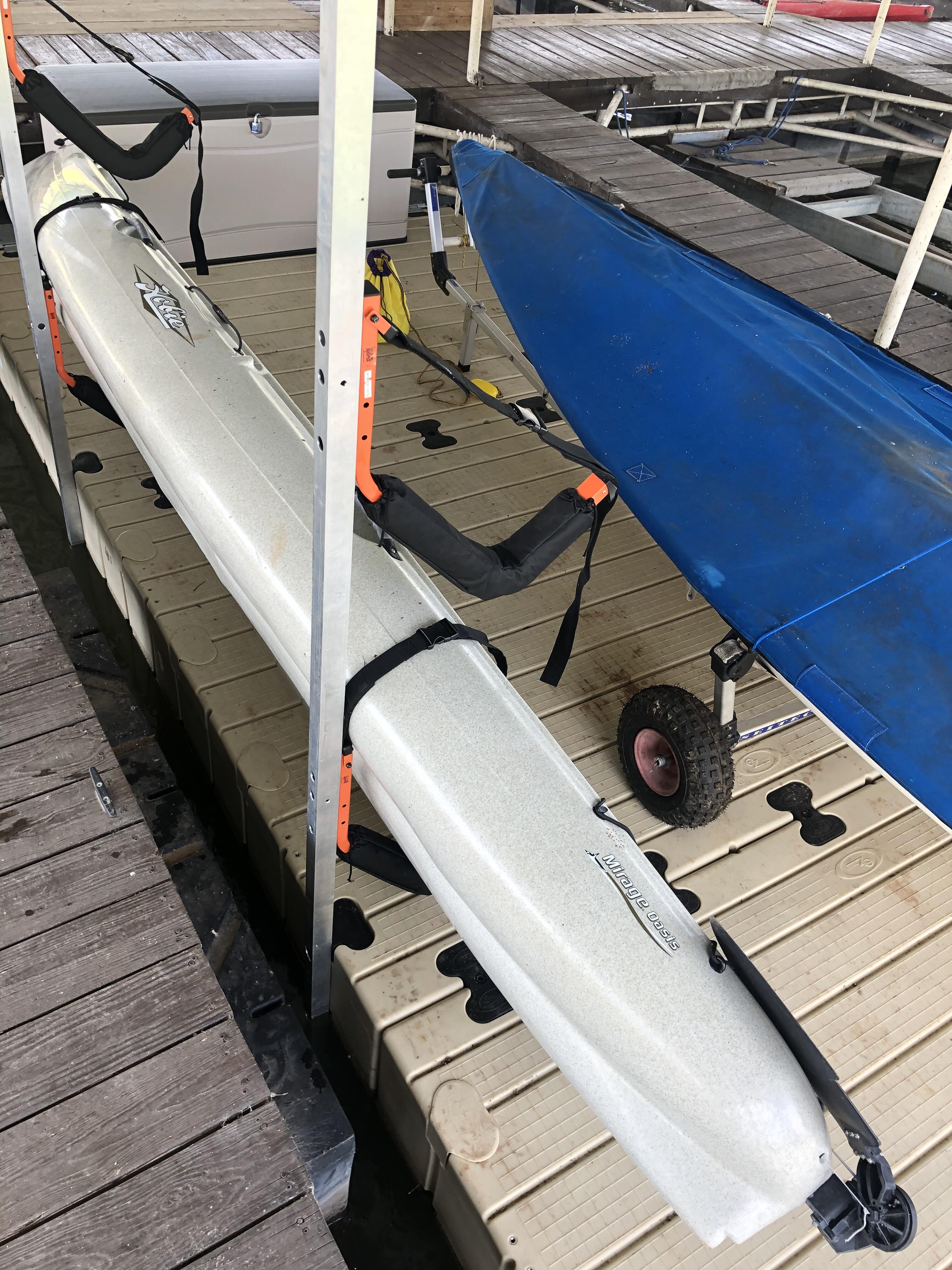

luvdunhill Posted September 8, 2020 Report Share Posted September 8, 2020 (edited) I was able to get mostly round holes lined up. These two holes will have bolts and room in the larger hole to accommodate a 15/16” deep socket. I tested them out this weekend and they hold the heavy tandem kayak well. I am going to build a second level with another pair of hooks. Pretty pleased so far. Now just need to avoid mistakes for the smaller holes Also, this alloy seems to be considerably harder than what I have used in the past. This is 6063. All my previous circle hole cutting has been 6061. With this, is the carbide saw is the tool of choice. The wood-working bit was a bit... “scary” (though it did produce a cleaner hole) experiment on scrap: No luck with a Punch.... or I am just not strong enough. This is 1/8” wall. Edited September 8, 2020 by luvdunhill 2 Quote Link to comment Share on other sites More sharing options...
luvdunhill Posted September 8, 2020 Report Share Posted September 8, 2020 Oh also, no difference in quality versus the Klein and EZ-ARC carbide circle hole bits. In fact, the EZ-ARC might be slightly better. Save money, go cheaper 1 Quote Link to comment Share on other sites More sharing options...
dsavitsk Posted September 8, 2020 Report Share Posted September 8, 2020 I've had surprisingly good luck with spade bits in aluminum. Did you use cutting oil? Can't tell from the pics. Quote Link to comment Share on other sites More sharing options...
luvdunhill Posted September 8, 2020 Report Share Posted September 8, 2020 I used tap magic (because I had it on hand, and it smells nice). Maybe there are better choices?I also tried a spade bit (not pictured) but it wasn’t nearly as good of a cut as the others. 1 Quote Link to comment Share on other sites More sharing options...

luvdunhill Posted September 14, 2020 Report Share Posted September 14, 2020 Success! 2 Quote Link to comment Share on other sites More sharing options...
