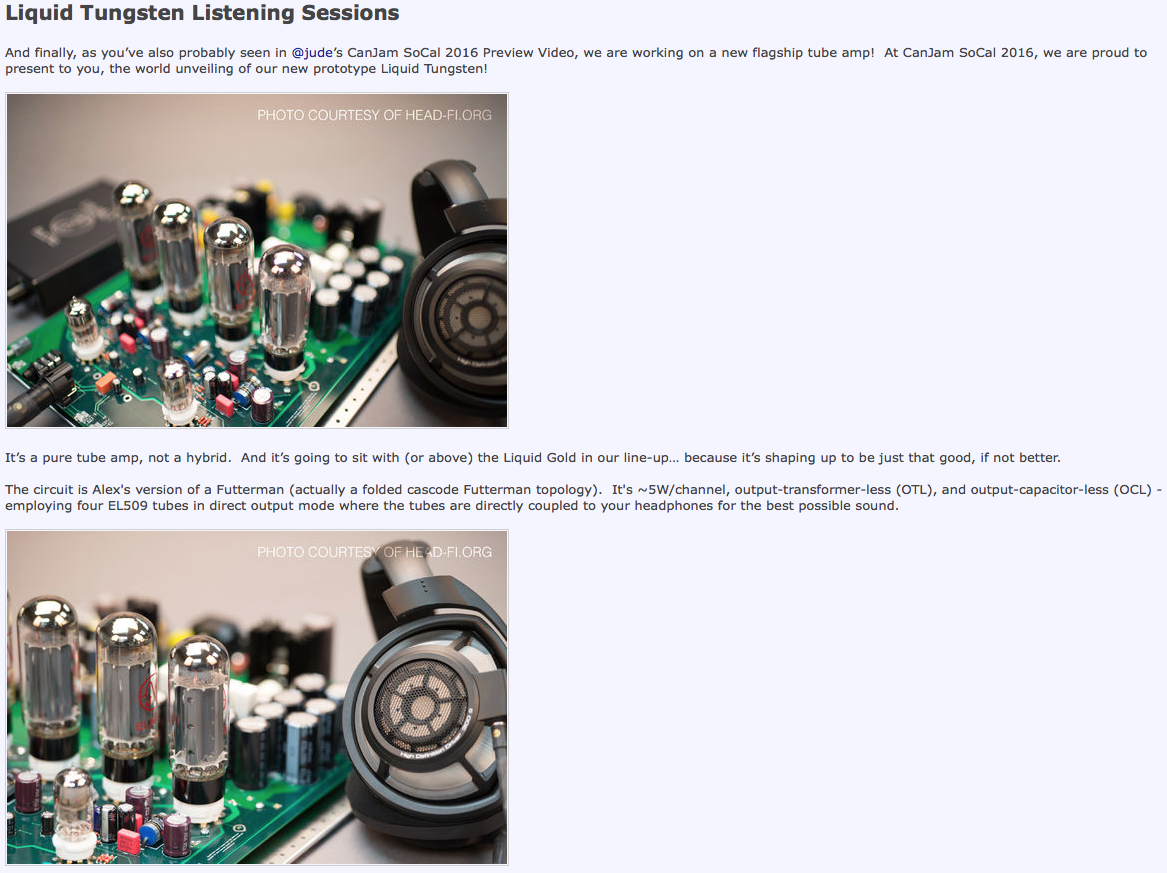

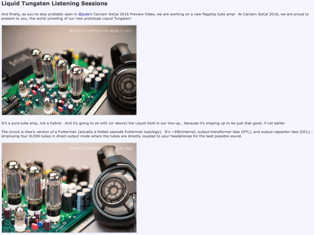

TMoney Posted March 15, 2016 Report Share Posted March 15, 2016 New Cavalli amp. Quote Link to comment Share on other sites More sharing options...
kevin gilmore Posted March 15, 2016 Report Share Posted March 15, 2016 jj (formerly tesla) tubes, no plate cap, so none of the NOS versions without modification sockets and really, a pentode as an otl output? sounds similar to rkv sure, why not. Quote Link to comment Share on other sites More sharing options...

JimL Posted June 29, 2016 Report Share Posted June 29, 2016 (edited) On March 15, 2016 at 11:56 AM, kevin gilmore said: jj (formerly tesla) tubes, no plate cap, so none of the NOS versions without modification sockets and really, a pentode as an otl output? sounds similar to rkv sure, why not. Maybe he's got the EL509 triode strapped? I think I saw somewhere that the rp for that is around 300 ohms. BTW sorry for the late comment, I just saw this. Edited June 29, 2016 by JimL Quote Link to comment Share on other sites More sharing options...
