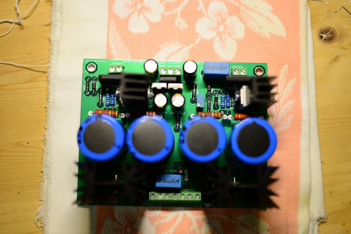

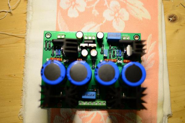

insanity Posted September 4, 2014 Report Posted September 4, 2014 I just finished assembling the boards. Have a look: Still waiting for the toroid though. Anyone else notice that the mounting holes of the PSU board are huge? Quote
spritzer Posted September 4, 2014 Report Posted September 4, 2014 Yeah, spotted the hole snafu when resizing the board over the weekend. Quote
chiguy Posted September 4, 2014 Report Posted September 4, 2014 (edited) I measured the holes when ordering screws and standoffs. I'm going to be using 1/4 inch hex 4-40 standoffs and screws for the amp boards and 5/16 inch hex 8-32 standoffs and scews for the PSU boards. Edited September 4, 2014 by chiguy Quote

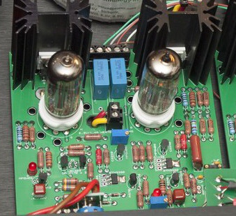

johnwmclean Posted September 5, 2014 Report Posted September 5, 2014 There’s a large vacant hole in-between the two tubes, a standoff here would probably help alleviate flexing changing tubes. 1 Quote

Laowei Posted September 5, 2014 Report Posted September 5, 2014 (edited) There’s a large vacant hole in-between the two tubes, a standoff here would probably help alleviate flexing changing tubes.That hole is used to route the wires to the screw terminal block for the floating tube heaters. Edited September 5, 2014 by Laowei Quote
johnwmclean Posted September 5, 2014 Report Posted September 5, 2014 Ahhh... ok, thanks Laowei. Quote
