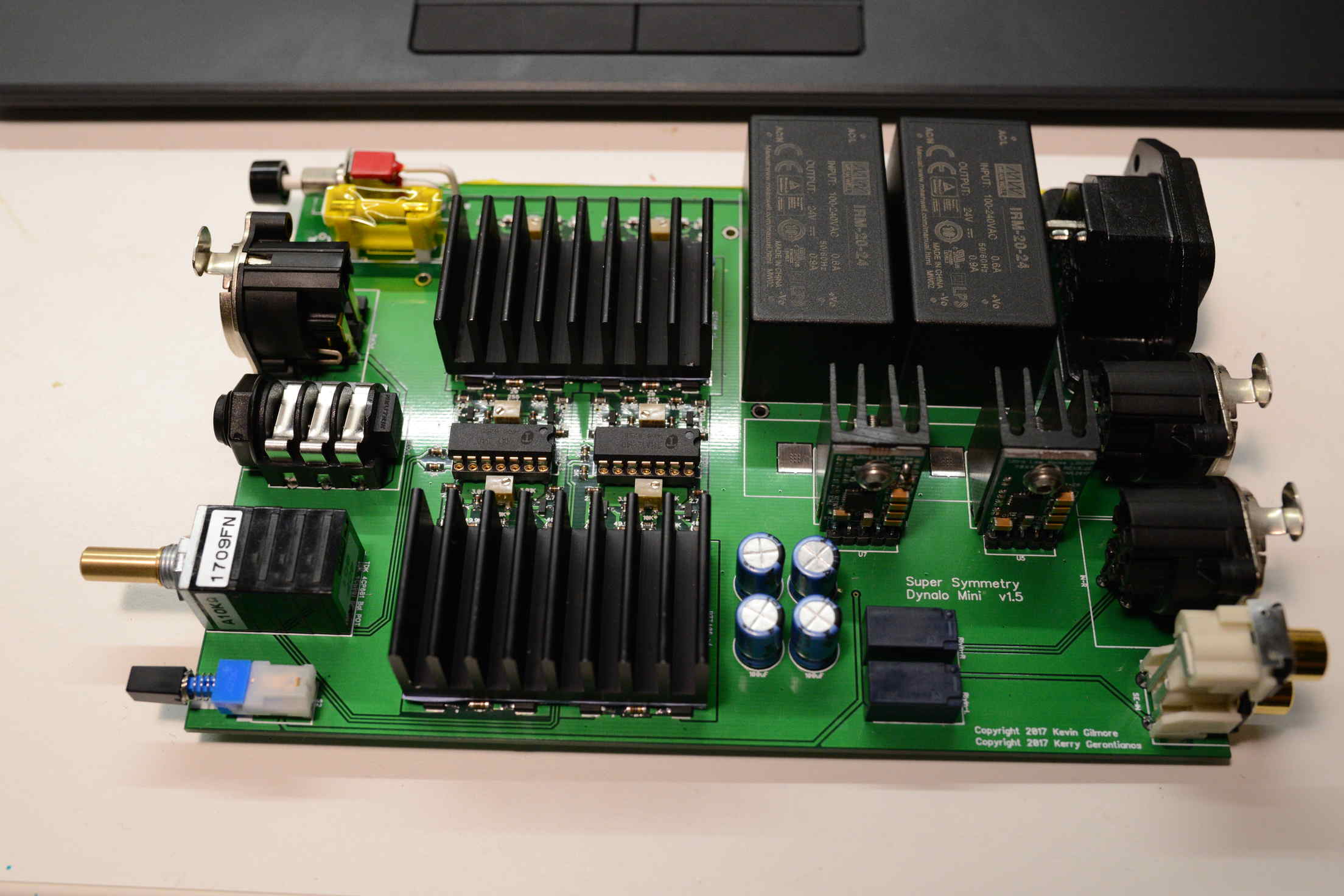

ruslanch Posted November 7, 2017 Report Posted November 7, 2017 I assembled dynalo mini and that340 chips on my board is very hot. Is it normal? Thanks!
Pars Posted November 7, 2017 Report Posted November 7, 2017 I assembled dynalo mini and that340 chips on my board is very hot. Is it normal? Thanks!I don't think so. Double check all components, check for solder bridges, etc. And this is both THAT340 chips are getting hot? How hot? Sent from my iPhone using Tapatalk
ruslanch Posted November 7, 2017 Report Posted November 7, 2017 40 minutes ago, Pars said: I don't think so. Double check all components, check for solder bridges, etc. And this is both THAT340 chips are getting hot? How hot? Sent from my iPhone using Tapatalk Thanks! 65-70°C on that340, both. But works fine. Now I checked all the components of the strapping - it's all right. But hot.
kevin gilmore Posted November 7, 2017 Report Posted November 7, 2017 that is hotter than I expect, what voltage rails and what voltages on the led's
ruslanch Posted November 7, 2017 Report Posted November 7, 2017 16 minutes ago, kevin gilmore said: that is hotter than I expect, what voltage rails and what voltages on the led's 20v psu , 1.60v on the led's
Helium Posted November 7, 2017 Report Posted November 7, 2017 It might be transistors are heating THAT340 thru copper layers. Are they soldered directy to board, or plugged in sockets?
ruslanch Posted November 7, 2017 Report Posted November 7, 2017 7 minutes ago, Helium said: It might be transistors are heating THAT340 thru copper layers. Are they soldered directy to board, or plugged in sockets? In sockets 4
kevin gilmore Posted November 7, 2017 Report Posted November 7, 2017 I was thinking the other board. Yes that board gets that hot due to the transistors you can add heatsinks

ruslanch Posted November 8, 2017 Report Posted November 8, 2017 8 hours ago, kevin gilmore said: I was thinking the other board. Yes that board gets that hot due to the transistors you can add heatsinks Thank you! I hope that this is indeed so, not my mistake. 8 hours ago, GrindingThud said: Nice!, what heatsink is that on the outputs? I'm so far behind...I still need to build mine. I never found the pot either, is there a source? Thanks a lot! Heatsinks from the nearest radio parts store, noname ). I bought a pot on ebay. I found a seller with a similar product and asked him to order from the manufacturer for me. It took 3 months but I got what I ordered.

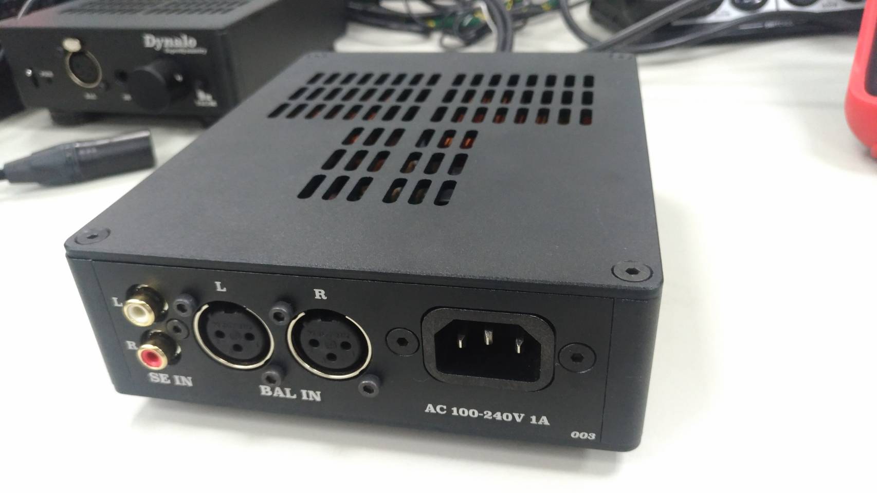

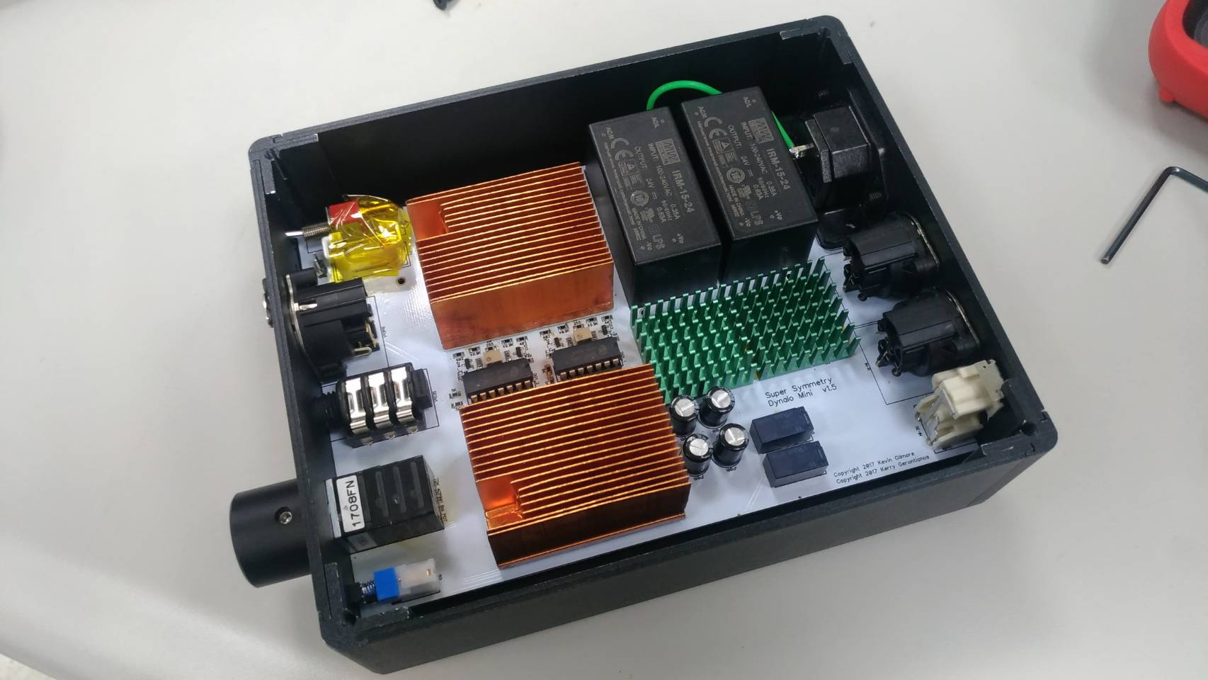

astro Posted November 25, 2017 Report Posted November 25, 2017 Hello, everyone. Sharing some phots of my recently built Dynalo mini. I have to thank Kevin, Kerry, and johnwmclean in the first place. My machine is pretty hot compared with others on the forum. The transistor heat sink temperature is 88c with 20mA bias(R14/R29 237ohm), 84C with 17mA bias(R14/R29 220 ohm) The IRM 15-24 power module is 16~18C cooler than the fin. The derating of it starts from 50C and shut down at 70C (ambient temp) This already makes me feel the amp working on the shutdown margin, though the sound is still fine. The forward voltage of D1/D2 LED is 1.794V and the R1/R3(increased to 453 ohm) cross voltage is 1.307V after warmed up which means the constant current 2.8mA. I remember the default constant current is 2.5mA, the Max bias current is 20mA and the normal bias is 15mA? Correct me if I'm wrong. Having no ideas about why my dynalo is hotter than other nearly 25C. Could it just cause by the higher hfe of the PZTA/MMBTA transistors? There are only minimum hfe value shown in the data sheet and no maximum is shown. I'll try 200 ohm and 180 ohm in the next week to see if I can lower the temp to 6xC. 5

cspirou Posted November 25, 2017 Report Posted November 25, 2017 (edited) There's a fuse near the switch. Nice work @astro! Where did you do your casing? Are those temperatures inside the enclosure? Are there holes underneath? Edited November 25, 2017 by cspirou 1
GrindingThud Posted November 25, 2017 Report Posted November 25, 2017 38 minutes ago, cspirou said: There's a fuse near the switch. Nice work @astro! Where did you do your casing? Are those temperatures inside the enclosure? Are there holes underneath? Ye, very nice job! I'm also interested in that case.
