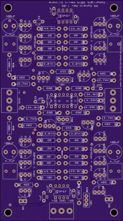

Pars Posted December 28, 2016 Report Posted December 28, 2016 ^ this belongs in the golden reference thread, not here.Question: do individual devices run hotter at specific bias than others at the same bias/current?All of my devices (MPSW06/56) are matched by hFE to the best of my ability. Vbe was consistent as well as Ib when matching (monitoring Ib and Ic). Since getting an IR thermometer and looking at temps, I have a couple of devices running at 55C (Q13 on both boards, interesting). Both are running at similar current to neighboring devices and the R value is within 0.02 ohms of others. hFE is also very close. I thought by measuring all of the R values and drop across them that I would see something out of the ordinary for the devices running warmer, but I'm not seeing anything.I'll probably just drop the bias resistors down to 255R for now and revisit when I case the amp to ensure that temps aren't over 50C or so. Any advice on when temp would be a problem appreciated as well. Current is verging on 15mA; these two are running at 14.8 or so (don't have access to data right now). These are thru hole boards also.Sent from my iPhone using Tapatalk
luvdunhill Posted December 28, 2016 Report Posted December 28, 2016 Something nearby Q13 is generating heat? If the voltage drop across the resistors is the same, they should share the same current.
Pars Posted December 28, 2016 Report Posted December 28, 2016 (edited) Nothing that would really generate any heat around that, and I was checking temps around the board anyhow. There are 3-4 others at 50C or more, some in the 30s. This was all done at approximately the same time with the amp having run for an hour or so. Board 1 NPN device ID hFE temp °C Vr Ie ohms PNP device ID hFE temp °C Vr Ie ohms Q22 10 293.3 39 0.2926 14.64 R44 19.991 Q24 45 293.3 52 0.2916 14.59 R47 19.989 Q21 32 293.1 39 0.2996 15.00 R45 19.978 Q23 18 293.1 46 0.3004 15.03 R46 19.985 Q16 44 93.0 45 0.2998 14.99 R40 19.999 Q17 64 293.0 44 0.2995 14.98 R43 19.992 Q12 8 292.8 40 0.2936 14.69 R32 19.982 Q14 30 292.7 42 0.2949 14.75 R37 19.996 NPN device ID hFE temp °C Vr Ie ohms PNP device ID hFE temp °C Vr Ie ohms Q11 74 278.9 35 0.2933 14.68 R35 19.983 Q13 11 278.8 55 0.2897 14.50 R36 19.980 Q15 40 279.1 35 0.2929 14.67 R41 19.970 Q18 31 279.4 47 0.2989 14.96 R42 19.982 Q19 5 279.4 45 0.2896 14.50 R51 19.973 Q25 39 279.5 49 0.2944 14.74 R48 19.969 Q20 86 279.6 47 0.2865 14.34 R50 19.982 Q26 90 279.6 38 0.2893 14.49 R49 19.968 bias VR39 1.7420 VR39 1.7420 Board 2 NPN device ID hFE temp °C Vr Ie ohms PNP device ID hFE temp °C Vr Ie ohms Q22 20 298.6 31 0.2879 14.42 R44 19.965 Q24 93 298.6 50 0.2813 14.08 R47 19.983 Q21 53 298.4 36 0.2883 14.43 R45 19.981 Q23 60 298.4 50 0.2807 14.06 R46 19.969 Q16 55 298.1 42 0.2875 14.39 R40 19.979 Q17 25 298.4 44 0.2905 14.54 R43 19.983 Q12 62 297.2 45 0.2839 14.21 R32 19.973 Q14 76 297.2 42 0.2867 14.36 R37 19.963 NPN device ID hFE temp °C Vr Ie ohms PNP device ID hFE temp °C Vr Ie ohms Q11 88 282.2 30 0.2834 14.19 R35 19.968 Q13 55 282.3 55 0.2819 14.12 R36 19.963 Q15 7 282.6 36 0.2869 14.36 R41 19.975 Q18 99 282.5 48 0.2862 14.32 R42 19.980 Q19 85 282.8 43 0.2862 14.31 R51 20.004 Q25 56 282.6 40 0.2860 14.33 R48 19.965 Q20 64 283.3 46 0.2814 14.09 R50 19.975 Q26 49 283.3 37 0.2831 14.16 R49 19.986 bias VR38 1.7344 VR38 1.7380 Edited December 28, 2016 by Pars
Pars Posted December 30, 2016 Report Posted December 30, 2016 I know, tl;dr Question on using an IR thermometer on these.When I aim at the to92 flats, since these are in rows of 4, it seems like the far end device measures hotter than the others, and temp increases as I go down the row. Shooting them from the top results in more even but somewhat lower temps. I think the thermo is picking up more than the one device when going for the flats down the row.Thoughts?Sent from my iPhone using Tapatalk

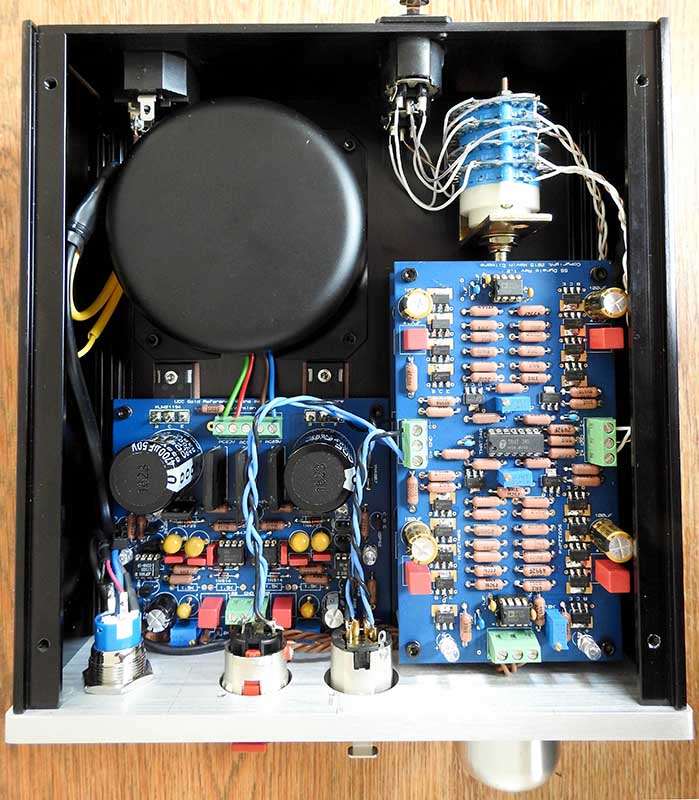

rumina Posted January 6, 2017 Report Posted January 6, 2017 Not a Mini Dynalo but a small one. Finished my Dynalo today, thanks to this forum and the members the build was easy and free of trouble, thanks everyone. Was fun to put it in a small case and solve this puzzle. Also a big thanks to Kevin Gilmore for this design and sharing it with us. http://www.diyaudio.com/forums/gallery/showgallery.php?cat=2232 Thanks to sbelyo for the group buy of the pcbs. 4
Pars Posted January 6, 2017 Report Posted January 6, 2017 2 hours ago, rumina said: Not a Mini Dynalo but a small one. Finished my Dynalo today, thanks to this forum and the members the build was easy and free of trouble, thanks everyone. Was fun to put it in a small case and solve this puzzle. Also a big thanks to Kevin Gilmore for this design and sharing it with us. http://www.diyaudio.com/forums/gallery/showgallery.php/cat/2231 Thanks to sbelyo for the group buy of the pcbs. Looks good. It appears that you populated all 3 bridge rectifiers in the Power Supply? You should remove the center one. It is there for people who want to use a center-tapped transformer. Since you are using a dual secondary transformer, only the 2 outer bridges are used (BR1 and BR2 in the schematic). With a center-tapped transformer (say 20-0-20), only the center bridge (BR3 in schematic) is used. 1
