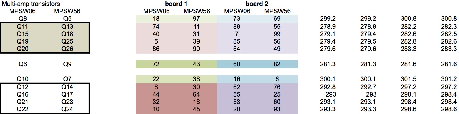

Mine is using 2SJ74/2SK170BL input JFETs. I had noticed that the balance between the + and - sides of each of the boards was off about 1mA. I determined that the JFET combos were mismatched, and got that corrected. One board has Idss of around 8.4-8.5mA while the other is 6.7-6.8. The higher Idss board has bias ~ 0.5mA higher than the one with the lower Idss JFETs, which makes sense. Using some JFETs that are matched (octal), they are both even, which also makes sense. Using bias resistors of 261R, after about 1/2 hour, bias is at 13.5 mA. I don't currently have an IR thermometer (Santa?), but nothing feels hot, just barely warm, including the GRLV pass transistors.
just for fun, since I don't have any THAT340s, I put some 2SA970/2SC2240 BLs in (accounting for the pinout diff of E-C-B vs. the THAT E-B-C), I was seeing the same bias currents on the one channel that I tried these in as I had with the FET input. The BJTs had hFE of ~530, vs the 100 or so for the THAT chips, so the hFE doesn't seem to make a lot of difference.
In my previous post, I had noted that bias resistors of 277 gave ~16mA; it was actually up to 17 mA once I let it run in for quite awhile.
Kerry sent me his ltspice file for this (thanks Kerry!), but so far I haven't been able to get it to even come close to real world currents; it is running 4.7mA or lower. I'm pretty new to spice models though. It appears that his BJT models came from Fairchild, and have a strange hFE (BF?) of 12.16K. Real world on these is more in the 300 range for mine. If I modify that parameter, the output stage Ie current drops to 3mA or less. I was hoping to use this to narrow down the bias resistors, as the 301R I had in there would have hit 20mA.
Sorry for the tl;dr, but just thought I would post this. I would guess with the mini that it will be toss it together with no matching. The BJTs in mine are matched pretty well, as I had 100 of each.
