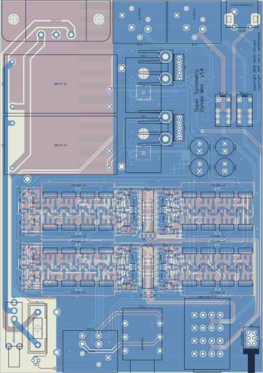

Kerry Posted November 2, 2016 Report Posted November 2, 2016 I did a small update on the mini board to add a pad on the opposite side of the on board regulators. Here's and updated view... 1 Quote
sbelyo Posted November 2, 2016 Report Posted November 2, 2016 This will be included in the group buy 2 Quote
