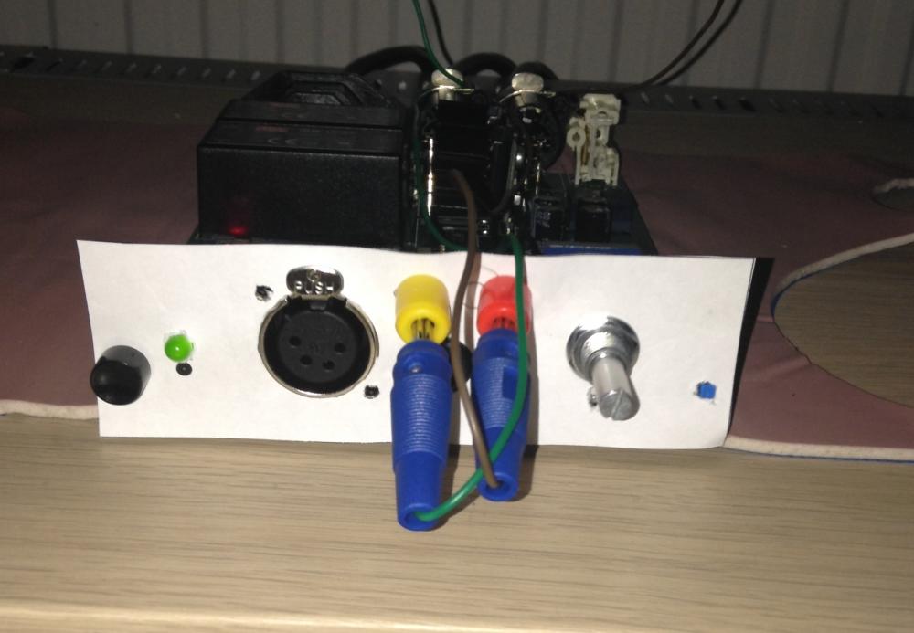

kevin gilmore Posted August 14, 2016 Report Posted August 14, 2016 use black magic marker to make it all black, then add some messed up funky logo's plenty of room to add flying piece of shit kobicon output connector
purk Posted August 14, 2016 Report Posted August 14, 2016 Please don't add the Kobicon...that jack is just pure sad. How about a 3.5 mm mini TRRS jack?
Kerry Posted August 15, 2016 Report Posted August 15, 2016 Yeah, I was curious what you wanted to the bananas for.

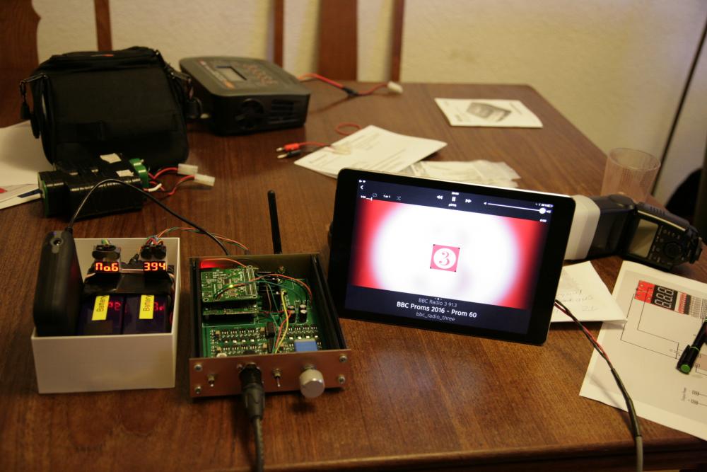

JoaMat Posted August 30, 2016 Report Posted August 30, 2016 (edited) I’ve had a great time the last couple of weeks building the mini Dynalo designed by Kerry. Here is the Dynalo with a finished (almost) board. Side panels from Modushop, internal height 40 mm. Front and rear panel are copper clad boards milled myself and the top cover is an aluminum net for better ventilation. Now, this amplifier turned to be a very nice one, so I started to modify it for my own personal preferences. I want a small portable amplifier to be used in my garden under a cheery tree - resulting in this. Switching power supplies, all connectors at the rear panel and some other stuff not needed removed to give room for Raspberry Pi 3 with a HiFiBerry DAC+ Pro on top. Changed front panel (easily done with a mill and copper clad board) and rear panel has two holes for connectors for the batteries and a wlan antenna. Today I got a heat sink for the output transistors. Below is a picture showing them, they are just resting on some soft pad – have to figure out the best way to get them fastened. I don’t think the sinks are needed but they are very much preferable. Many thanks to Kerry for an excellent work. Edited August 30, 2016 by JoaMat 5
GeorgeP Posted August 30, 2016 Report Posted August 30, 2016 ^want! Just needs a touch screen so you can stream over wifi.
JoaMat Posted August 30, 2016 Report Posted August 30, 2016 Touch screen to the right. Who needs Pokémon? 4
gepardcv Posted August 30, 2016 Report Posted August 30, 2016 This is fantastic! Time for a mini-Dynalo board group buy? 1
JoaMat Posted August 30, 2016 Report Posted August 30, 2016 I want to add that I use the Raspberry with piCorePlayer and a iPad with iPeng and Squeezepad apps. I’m very happy with the piCorePlayer and the iPad apps - Internet radio (I listen to BBC3 HD every day) Tidal, ripped things on hard disk, Met Opera, Berliner Philarmoniker. Pretty magic, isn’t it? Everything works terrific until batteries fade.
