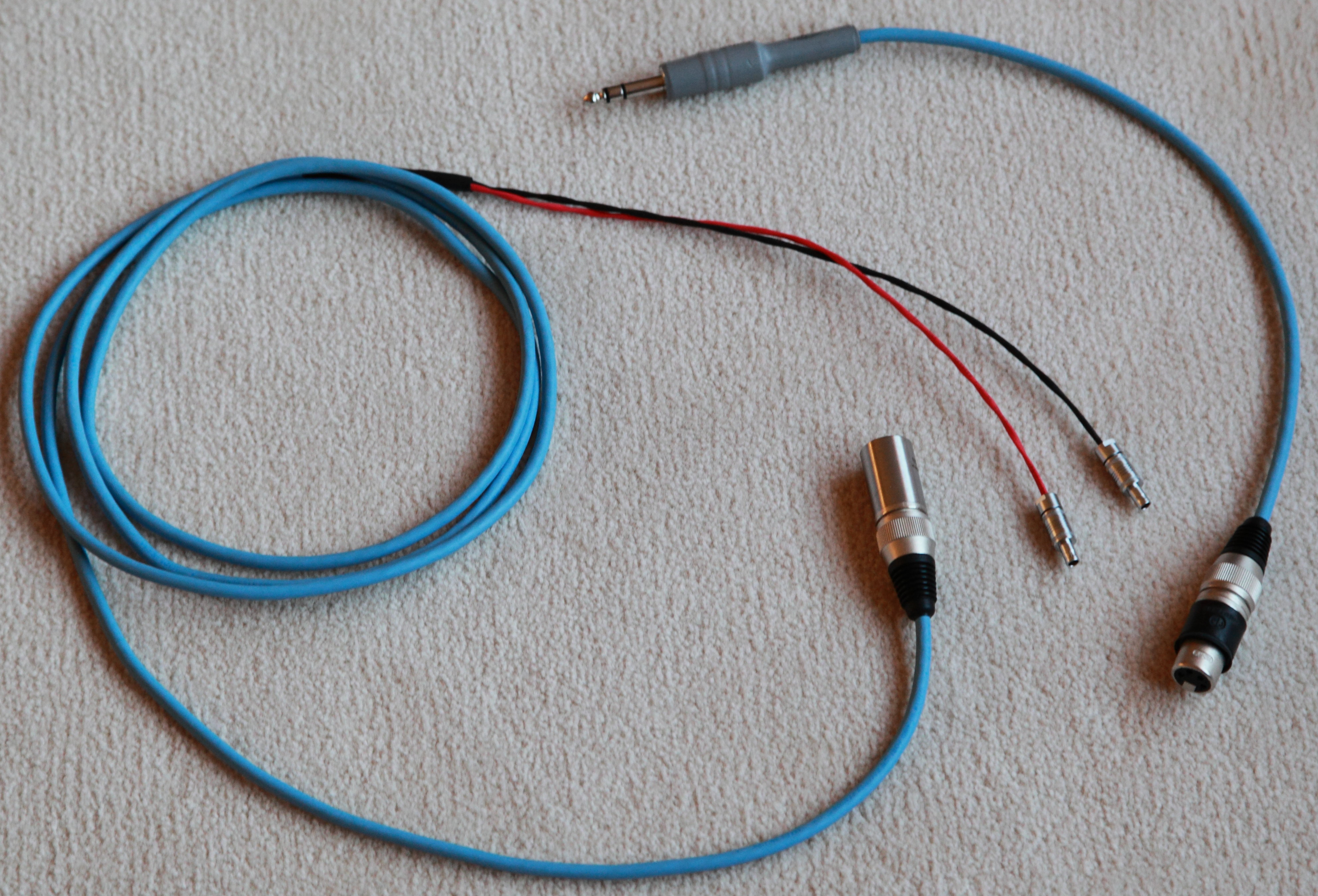

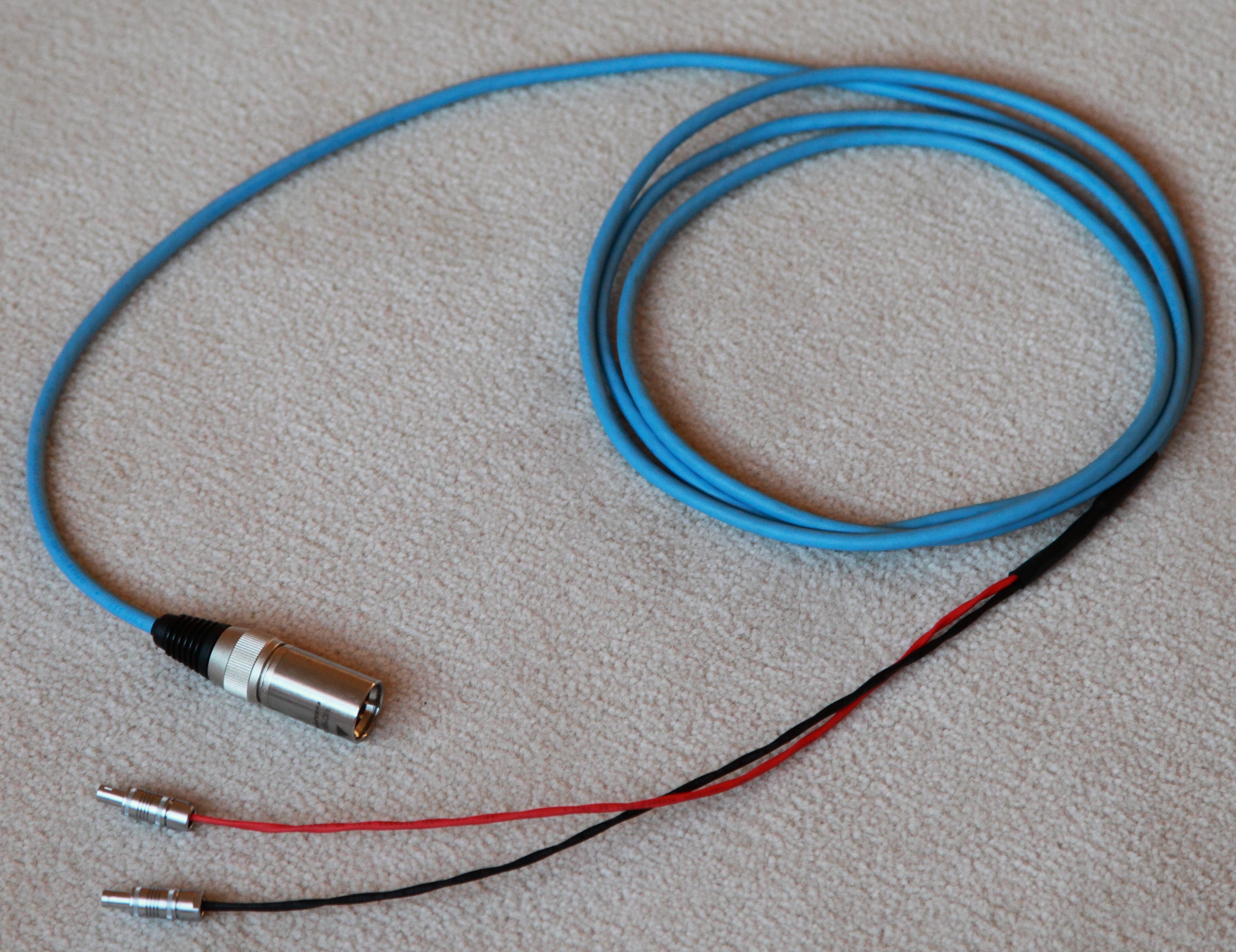

mwl168 Posted October 24, 2017 Report Posted October 24, 2017 Harvested an old Cardas Headphone cable to make a balanced cable for the HD800. Neutrik 4-pin XLR connectors. The HD800 connectors are from Parts Connecxion and a royal PITA to work with. 7 Quote
Pars Posted October 25, 2017 Report Posted October 25, 2017 You need a fugly set of cable pants for your Y split.I keed I keed.... nice job!Sent from my iPhone using Tapatalk 1 Quote
mwl168 Posted October 25, 2017 Report Posted October 25, 2017 57 minutes ago, Pars said: You need a fugly set of cable pants for your Y split... I have fantasized about fabricating some sort of Y splitter to use but ran out of patience. Quote

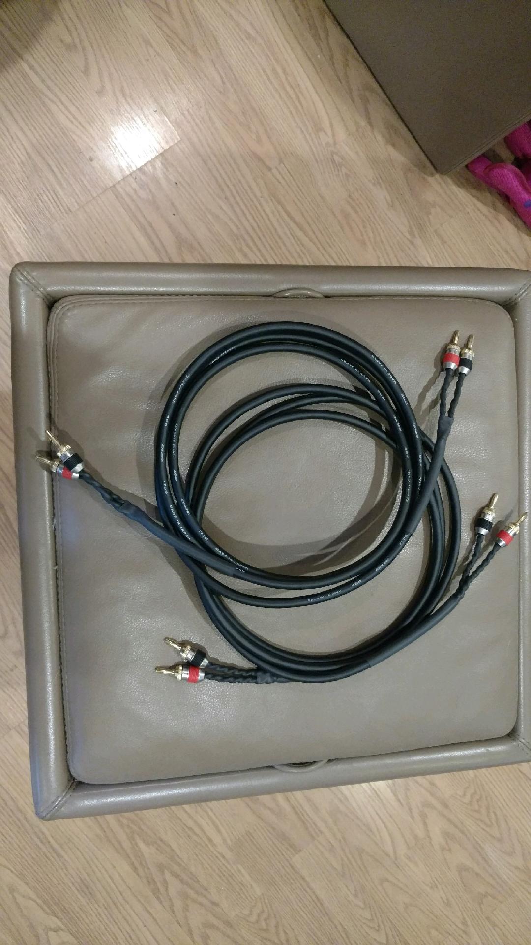

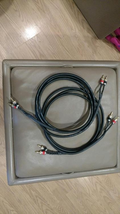

swt61 Posted May 2, 2018 Report Posted May 2, 2018 Put together some new speaker cables, for the new speakers. 3 Quote
luvdunhill Posted May 2, 2018 Report Posted May 2, 2018 Pfff... needs Dr. Wood logo somewhere 1 Quote

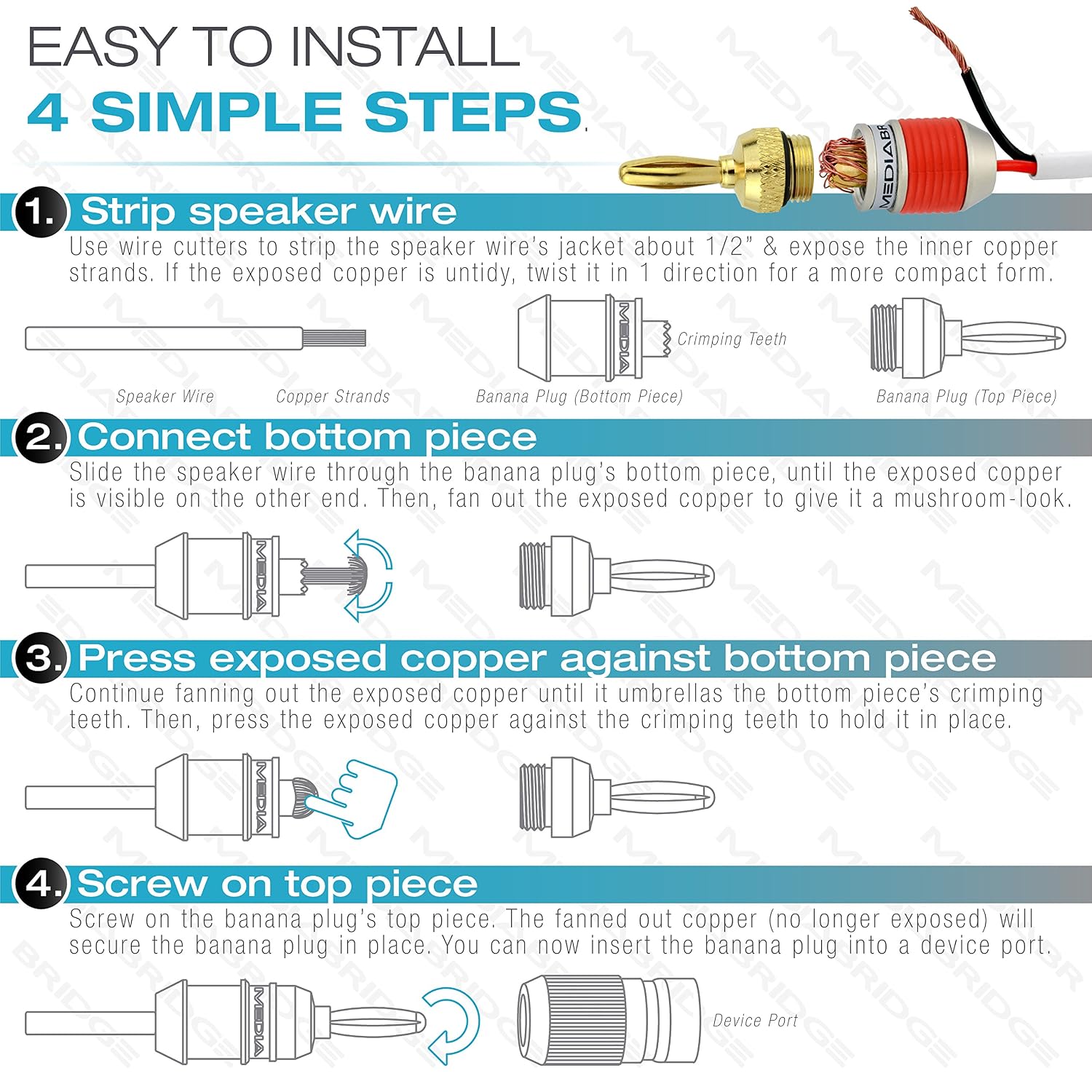

penmarker Posted May 2, 2018 Report Posted May 2, 2018 How are the banana jacks? Do they make secure connection with the cables? PM me where you got them please. Quote
swt61 Posted May 2, 2018 Report Posted May 2, 2018 The banana jacks are great. They hold really well and were very affordable. I got them on Amazon... https://www.amazon.com/Mediabridge-Banana-Plugs-Corrosion-Resistant-Gold-Plated/dp/B00JFC9ANW/ref=sr_1_14?s=electronics&ie=UTF8&qid=1525230515&sr=1-14&keywords=banana+plugs Quote
penmarker Posted May 3, 2018 Report Posted May 3, 2018 I'm more interested with how they secure the wires. I've had some cheapo banana jacks in the past and they use grub screws. No bueno, feels like the wires will shear right off. This one looks good. Thanks! Quote
swt61 Posted May 3, 2018 Report Posted May 3, 2018 It has sharper little teeth than others I've used, and it grabs the wire very securely. Quote
Craig Sawyers Posted May 4, 2018 Report Posted May 4, 2018 21 hours ago, swt61 said: It has sharper little teeth than others I've used... Nuff said.... 1 Quote

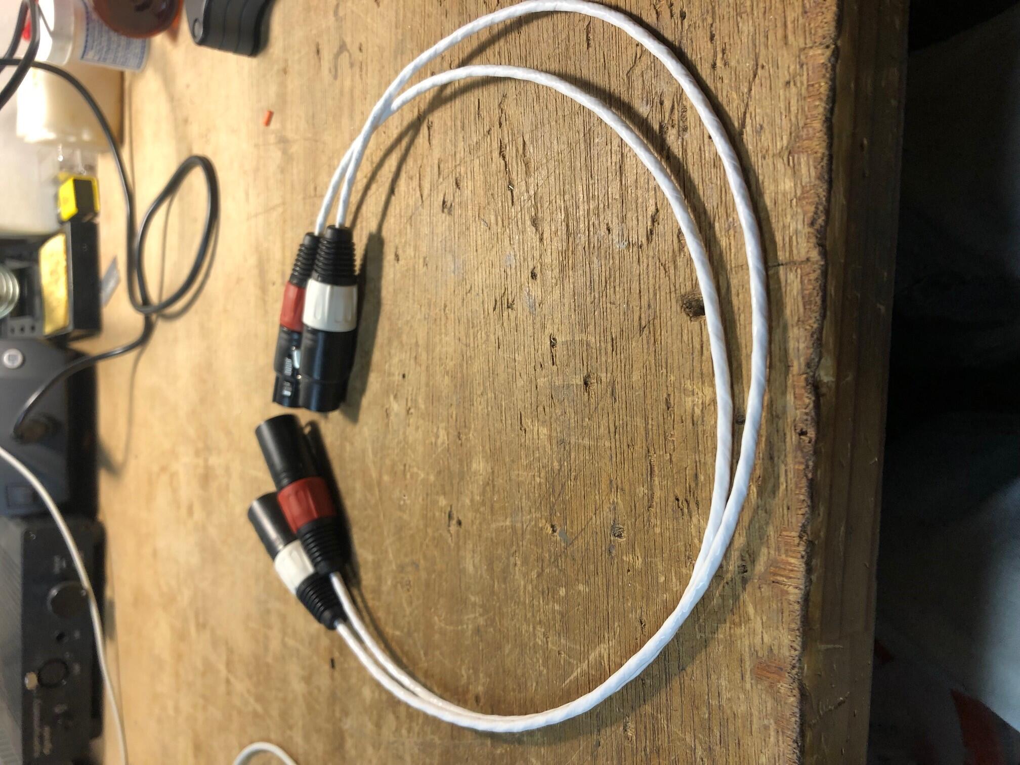

sbelyo Posted October 24, 2021 Report Posted October 24, 2021 I made these over the last week. The blue pair is Cardas 2 x 21.5 AWG. The white pair is 2 x 24 AWG SPC mil spec from navships. The navships cable is a step up from the Mogami that I was using. Cost was $35 After a week I really like it but found it to sound bright. The Cardas is a step beyond the navships cable. Sounds neutral to me. No harsh highs or bloated lows. After 5 hours I'm liking this one the best out of all three. Cost was $65 3 Quote
jamesmking Posted October 24, 2021 Report Posted October 24, 2021 (edited) On 10/24/2021 at 2:40 AM, sbelyo said: I made these over the last week. The blue pair is Cardas 2 x 21.5 AWG. The white pair is 2 x 24 AWG SPC mil spec from navships. The navships cable is a step up from the Mogami that I was using. Cost was $35 After a week I really like it but found it to sound bright. The Cardas is a step beyond the navships cable. Sounds neutral to me. No harsh highs or bloated lows. After 5 hours I'm liking this one the best out of all three. Cost was $65 is the mill spec cable silver or silver plated? personally I have always found cables which are silver or silver plated to be bright, shouty and lack ambience. I only use un-plated copper cables. I use Cardas chassis wire for my builds and use Cardas golden reference for speaker, power and some inter-connects. Van den hull first is not bad but I think it lacks a bit of bass - its cheaper second hand than the Cardas. I even find silver plated/solid silver fuses to be bright. Edited October 25, 2021 by jamesmking Quote
