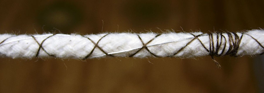

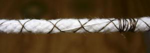

CarlSeibert Posted September 13, 2009 Report Posted September 13, 2009 (edited) a search for expanded ptfe tape turned up these: [snip...] of course you could simply counter spiral some cotton string around/along the main cable, teflon tape that in place and repeat until you got the girth you seek. Good Googling. "foam Teflon" gets nothing but noise. Small quantities of the foamed tape at a reasonable price could be a trick to find around here. The string idea is excellent. Shortly after I posted, I stumbled on an inspiration in my garage in the form of a bag of "Cotton T-shirt fabric mills ends" that I bought at Constantines for applying stain. They're rings of t-shirt fabric, like calamari. I think they are the off-cuts from when they start up the tubular knitting machines. Cut 'em so they're strips and they should wind just fine. A layer of Teflon tape to keep it all tidy, and the shield should slip on without too much of a fight. Don't know if this will help or not for your project, but I looked at this guy's website before I made mine. Didn't follow his exactly, but I like them. Cotton Silver Interconnect Construction Another flash of inspiration. That guy skips the Teflon tubes altogether. As long as you keep it fairly well sealed, I would guess it could work really well. (Cotton being a better dielectric than Teflon. But not as good as air, which is mostly what touches the wire in my IC). An issue I've had has been a limit to how long an interconnect I could make, based on getting the silly wire into the tube. His way could be unlimited in length. Alternatively, you could do non-continuous lengths of tube every foot or so, maybe, if you were concerned about the conductors coming loose and moving around and shorting. Oh. I see that fellow uses Titebond on the end of his rope. I have used epoxy finishing resin (the kind you would use to glass a model airplane wing) and it has worked great. It's hard, but a set screw will still bite. Just nip off the little blob that forms at the very end with side cutters. Any kind of epoxy that gets liquid as it cures should work fine. Thanks guys! Edited September 13, 2009 by CarlSeibert added the epoxy end bit

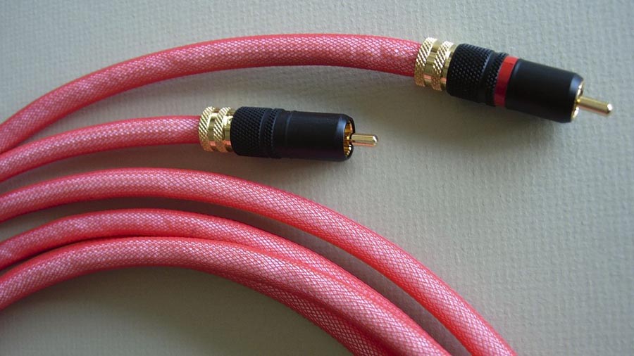

CarlSeibert Posted September 26, 2009 Report Posted September 26, 2009 Well, I can't say they're Pink Pythons of Perfection, but they're pink pythons of pretty good at least. Inspired by the guy whose link Pars posted, they're 2 meters long and no Teflon tube was harmed in their building, apart from a couple of half-inch lengths for the center wire at the plugs, which are my favorite ersatz WBTs from Parts Express. My contribution is to use cotton thread to bind the silver conductor to the rope, which seems a decent idea and allows you to build in the cotton spirit, without any PTFE touching the conductors. I actually used PTFE tape first and then the thread, mostly because I wasn't comfortable with the thread yet and I didn't want the things unraveling on me. The cotton jacket is jersey t-shirt material, which turns out to be a pain in the butt to work with. The edges curl up and you have the devil's own time getting it to lay flat. I'll use woven cotton next time. The curly edges made for a spiral bump down the cable, but two layers of Teflon wound over the cotton pulled it all down to a more or less uniform shape. So how does it sound? It trounced the rather decent commercial cable it replaced. A significant hardness was replaced by better resolution and a more relaxed musicality. Transients were better. Dynamics were better. Generally speaking, it was mo' better. Break in behavior is not the same as I've had on other silver cables I've made. Normally, they're pretty disappointing for the first few minutes (all midrange, no extension and no subtlety) then they pop into focus in less than an hour and don't really change any more. These don't seem to be changing much. Either they aren't going to change at all or they'll do it slowly, more like what you're supposed to expect from silver cables. We'll see. For it's intended purpose, it's a success. But that doesn't answer the real question, which is "is the cotton better, worse, or the same as the tubes?". Given that this is the longest cable in the den system, it's not as easy as I would like to work out a way to compare. If I take it out of its place, then I have to put the inferior old cable back in. It's a sticky wicket. I'll contrive something and report back. (I'll upload the file of the picture of the thread binding so it will stay permanently with the post.)
