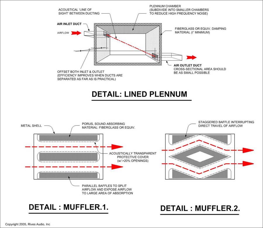

Tyll Hertsens Posted February 20, 2013 Report Share Posted February 20, 2013 I have a vague recollection that putting a 360 loop in vent ducts dramatically reduces its ability to transmit sound. Prolly should go look in my "Handbook for Sound Engineers." ......goes and looks.... Nothing about 360, but they do suggest a "plenum." http://www.audioholics.com/education/acoustics-principles/a-guide-to-sound-isolation-and-noise-control/fig3hvacsystemsehx.jpg/image_view_fullscreen Link to comment Share on other sites More sharing options...
swt61 Posted February 20, 2013 Report Share Posted February 20, 2013 I have a vague recollection that putting a 360 loop in vent ducts dramatically reduces its ability to transmit sound. Prolly should go look in my "Handbook for Sound Engineers." ......goes and looks.... Nothing about 360, but they do suggest a "plenum." http://www.audioholics.com/education/acoustics-principles/a-guide-to-sound-isolation-and-noise-control/fig3hvacsystemsehx.jpg/image_view_fullscreen I know I've sent sound diffusion for vents, but don't remember where. Link to comment Share on other sites More sharing options...
