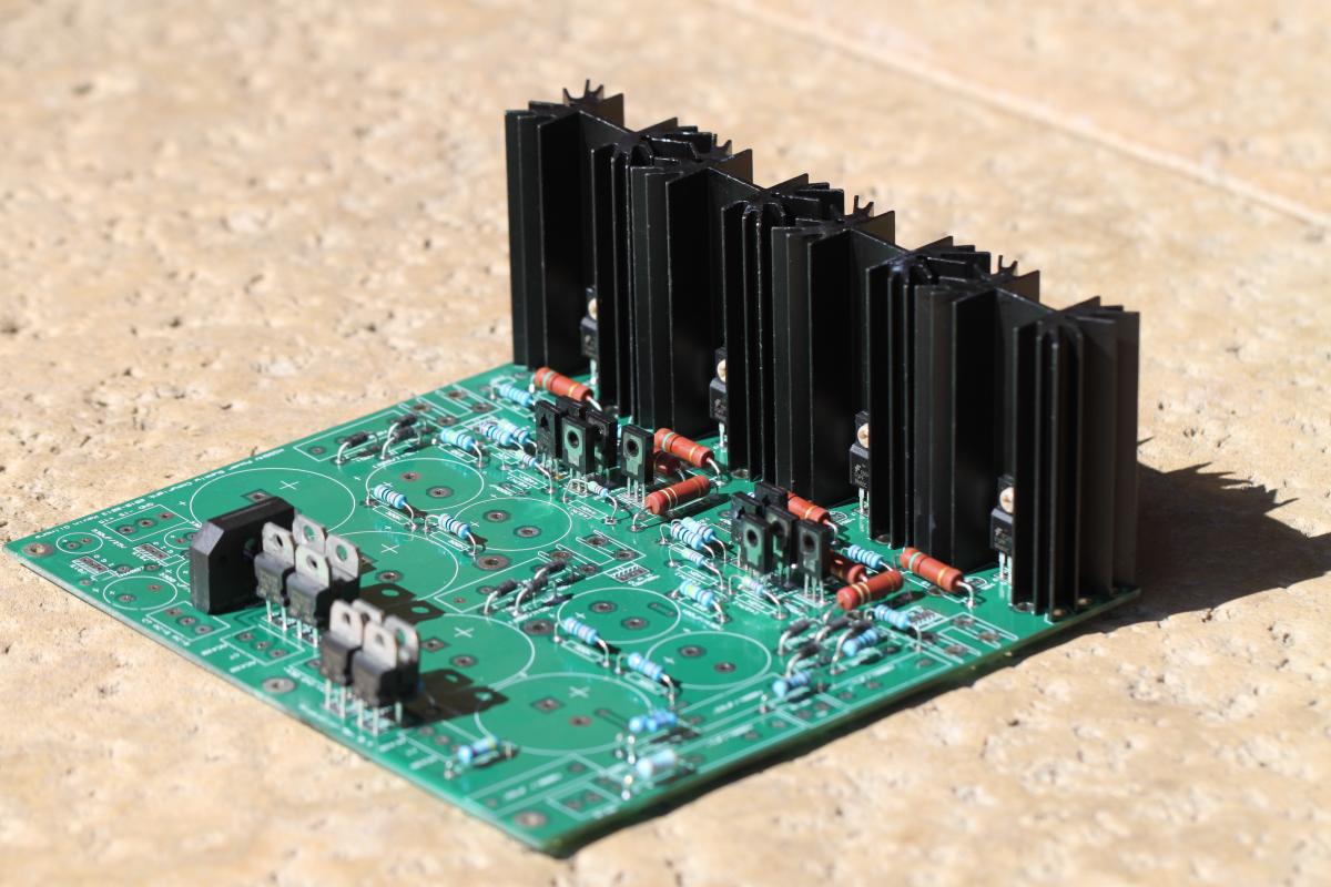

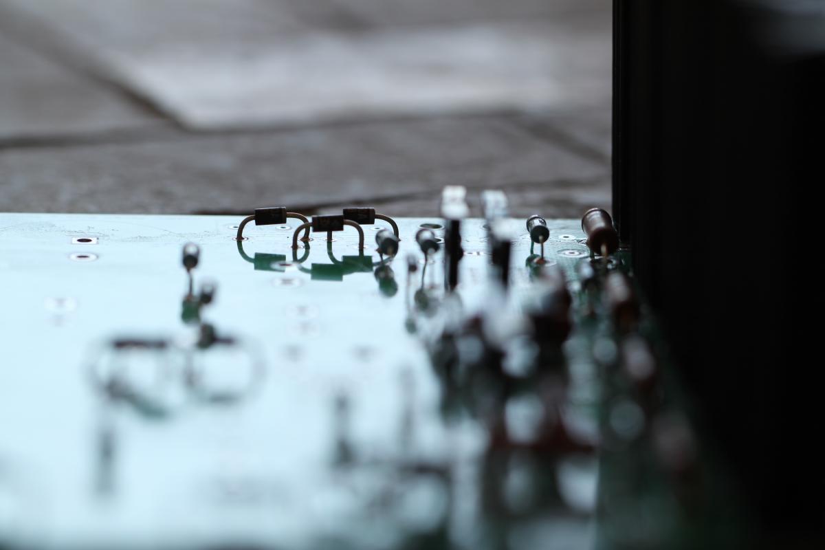

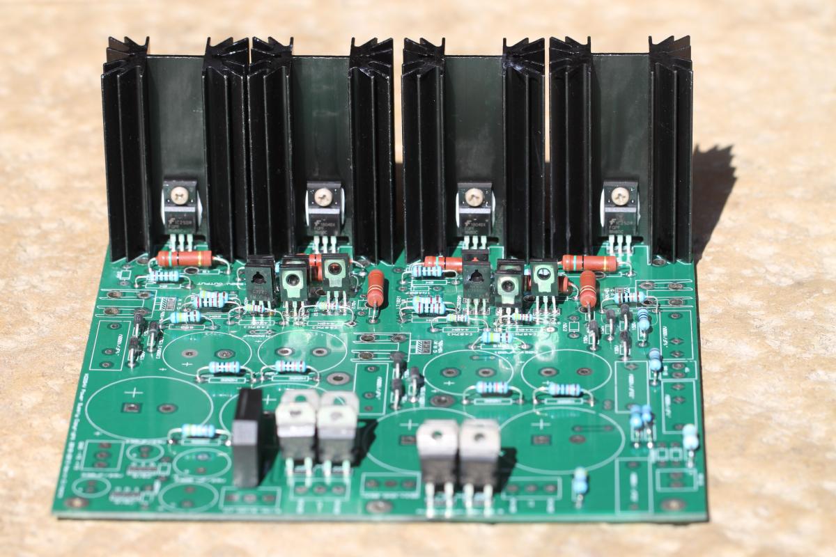

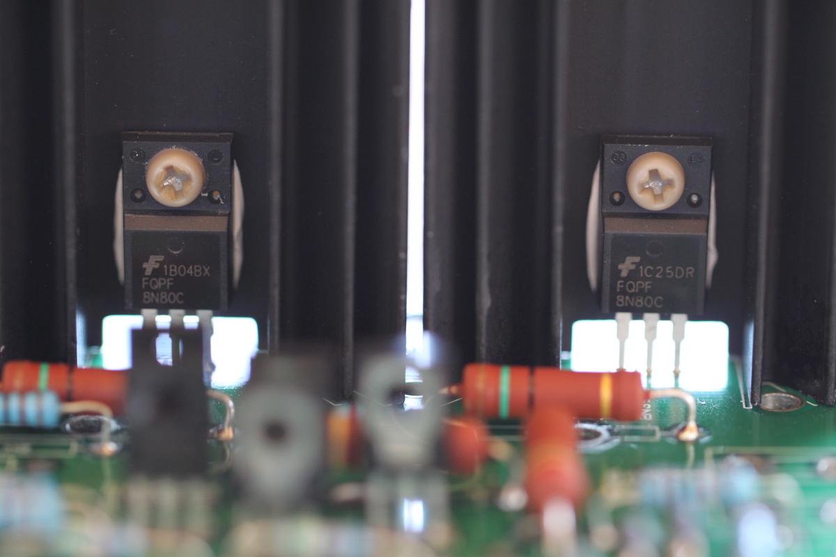

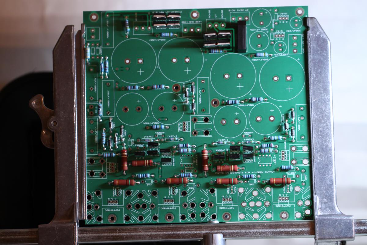

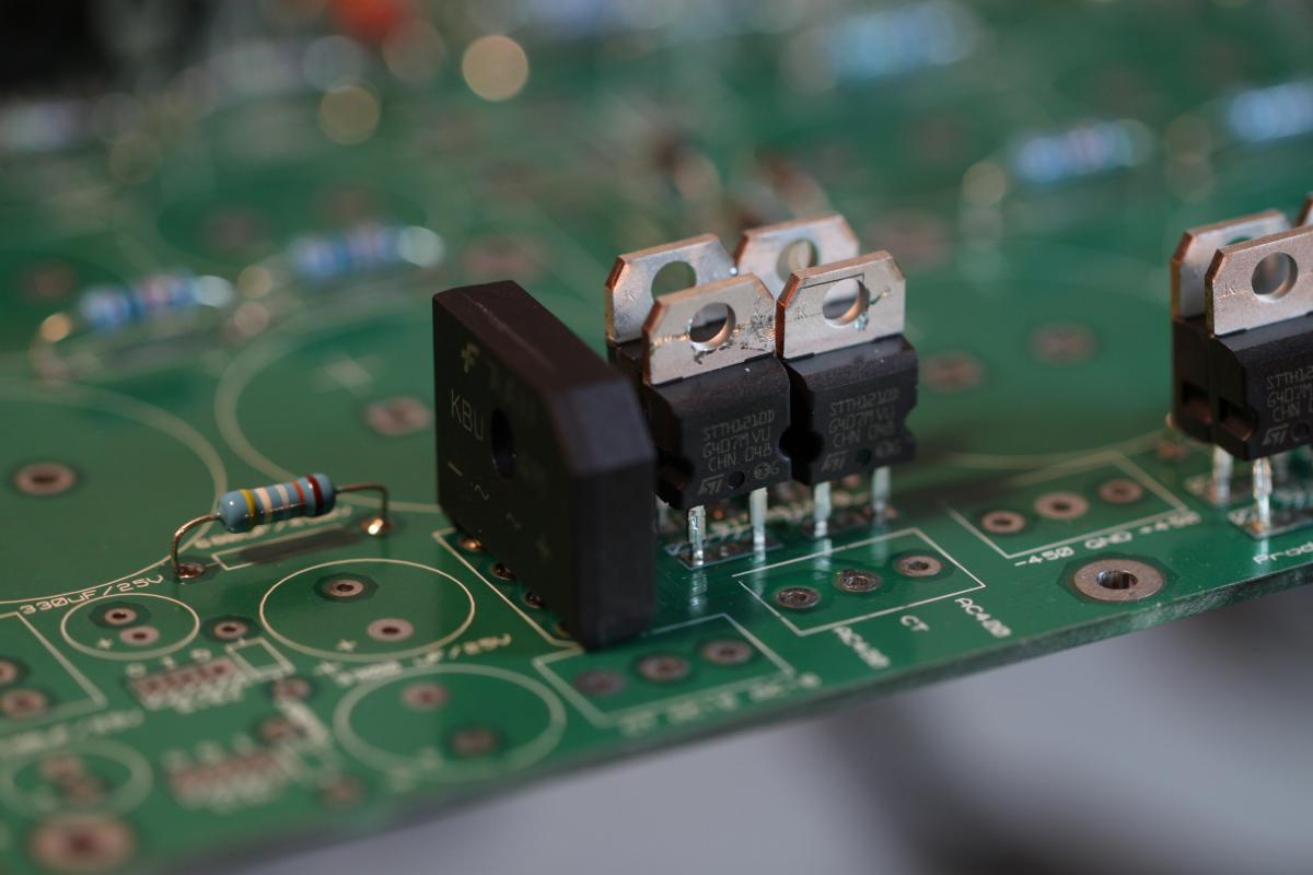

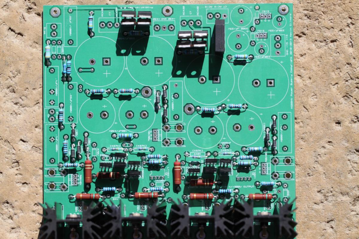

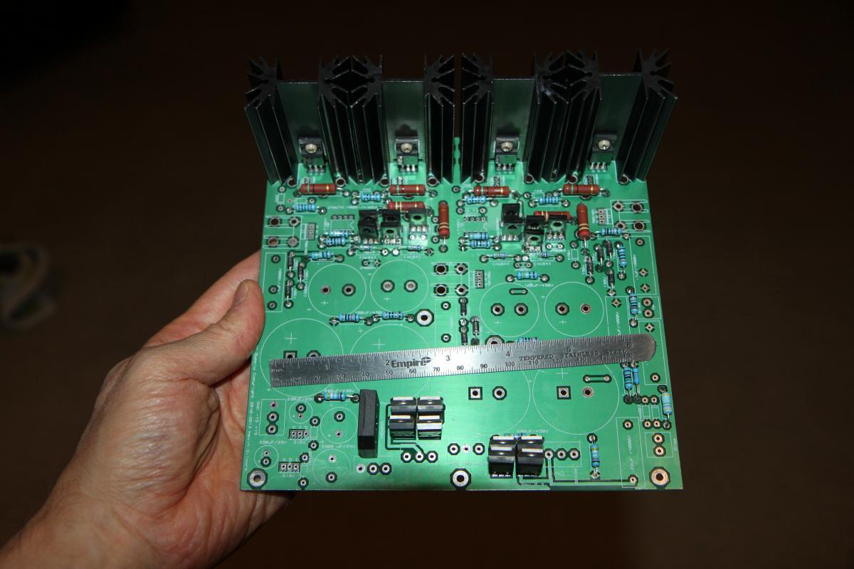

eggil Posted September 24, 2013 Report Posted September 24, 2013 I did not realize base and collector are linked in the 1486 that sits alone. After soldering, I thought I had created a bridge and removed the transistor. Lesson: look at the schematic and a bare PCB if you have one to compare. In the older PSU, they were connected by a trace. Now they are linked, and that makes it look like a solder bridge. Quote
eggil Posted September 26, 2013 Report Posted September 26, 2013 (edited) Waiting for parts Edited September 26, 2013 by eggil Quote

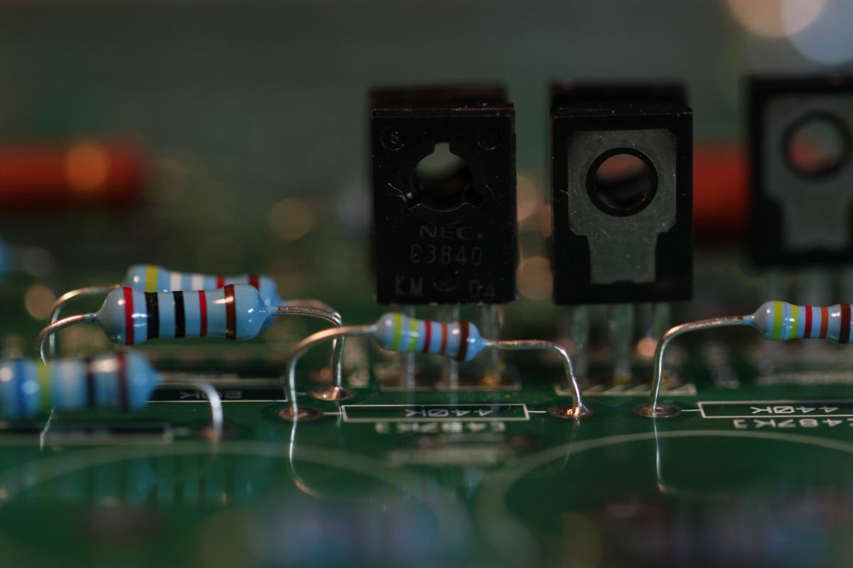

eggil Posted September 26, 2013 Report Posted September 26, 2013 Bought a Cannon macro lens, but I am not a very good photographer. 3 cold solder joints fixed. Quote
nopants Posted September 26, 2013 Report Posted September 26, 2013 I'm mostly done with my stuff,waiting on the transformers. I haven't touched it in a while so I need to revisit it in detail for errors and such. Also bought some mundorf supremes for coupling between input and output stages, any suggestions for other candidates I might use? Maybe I'll socket those spots... Quote
spritzer Posted September 26, 2013 Report Posted September 26, 2013 Do not under any circumstance use those rectifier diodes!!! Use the ones printed on the board. The board always overrules any BOM. Quote
