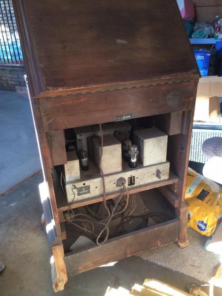

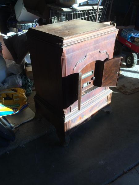

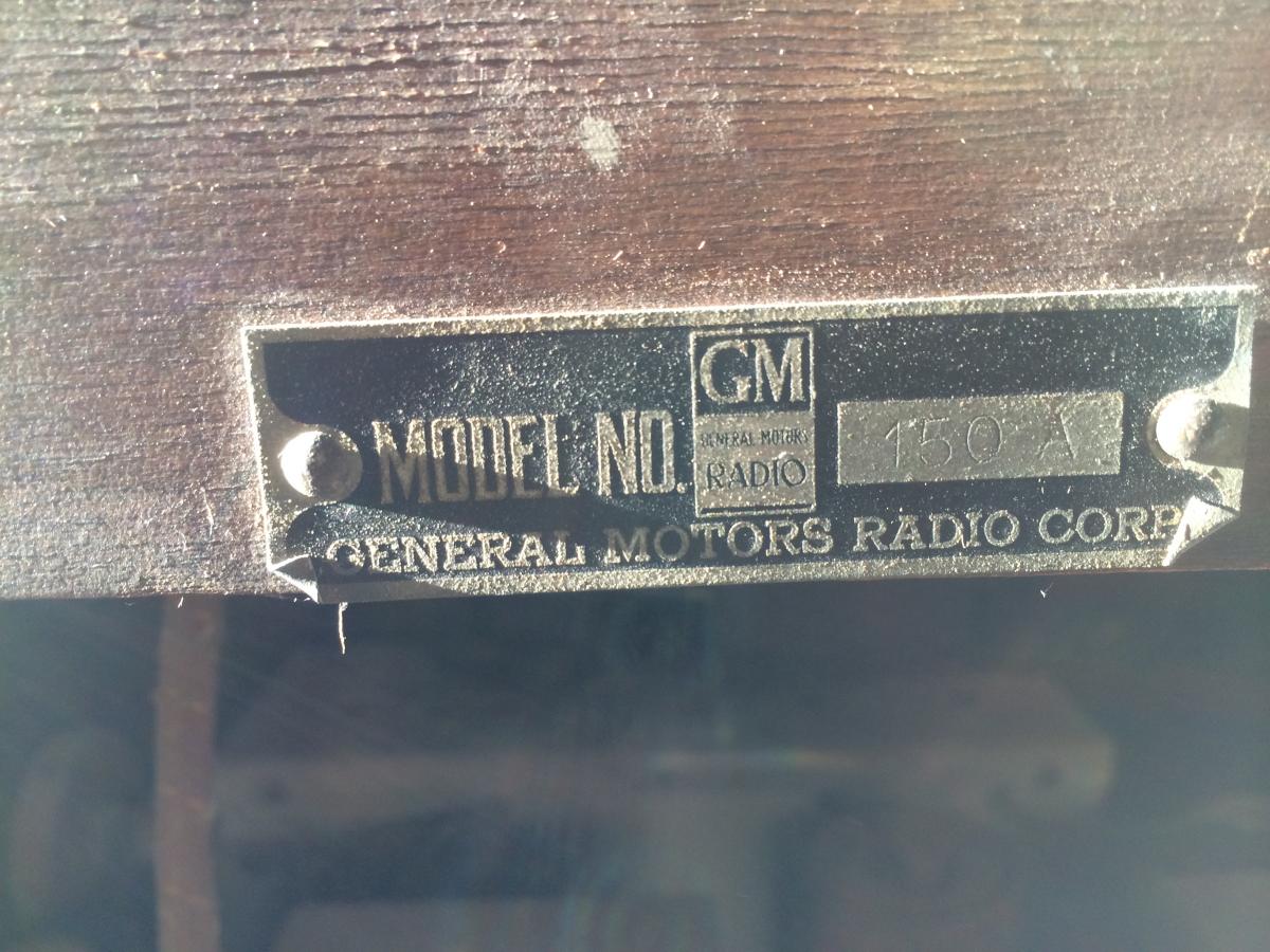

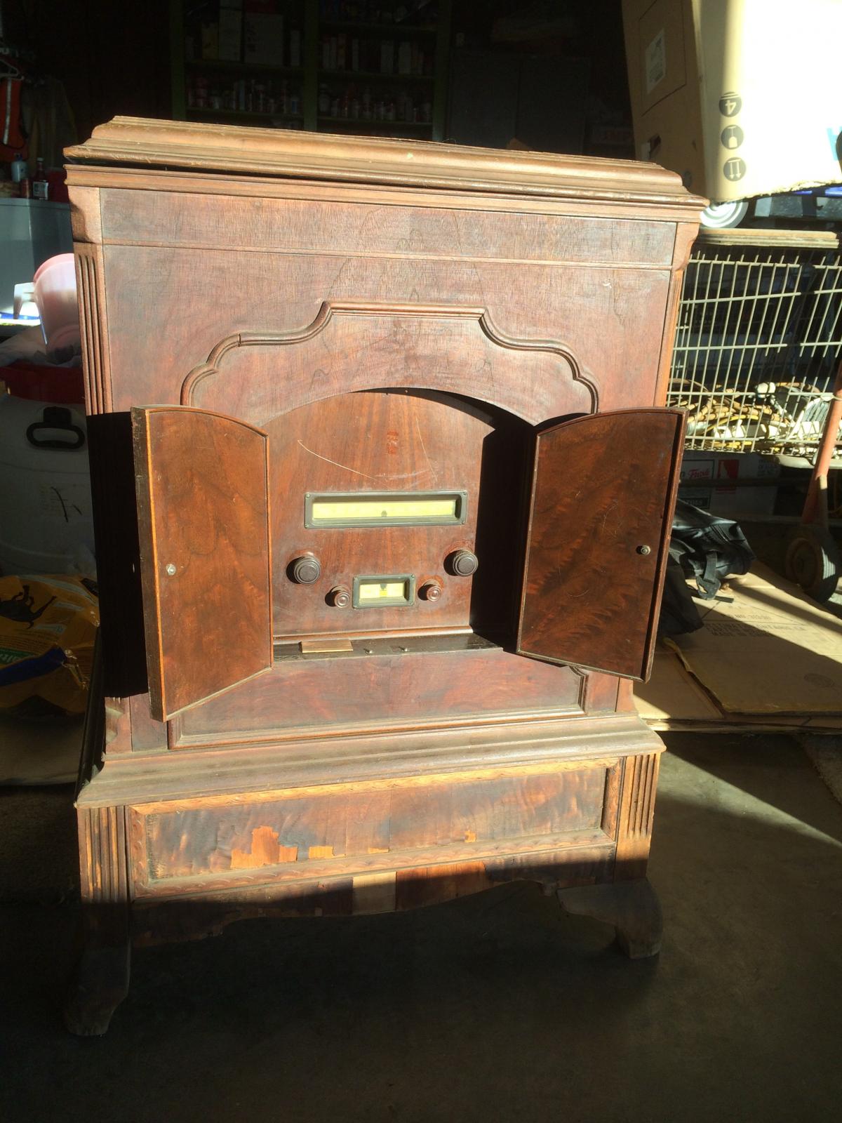

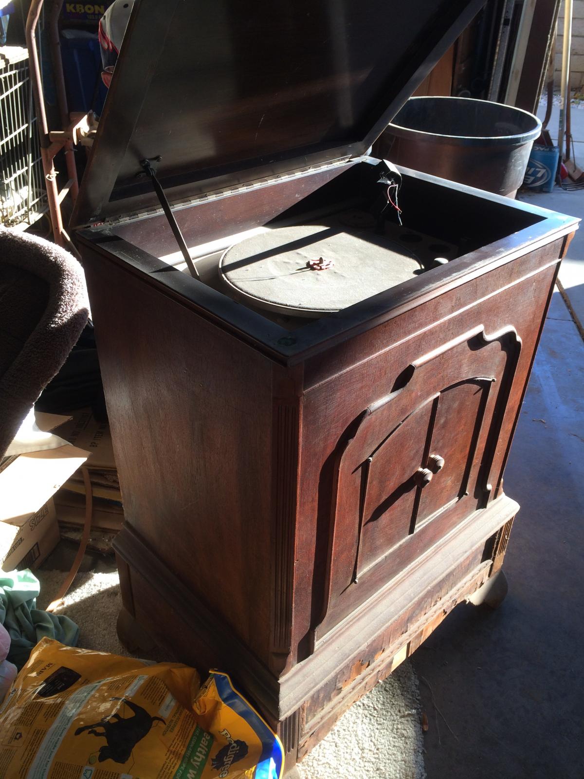

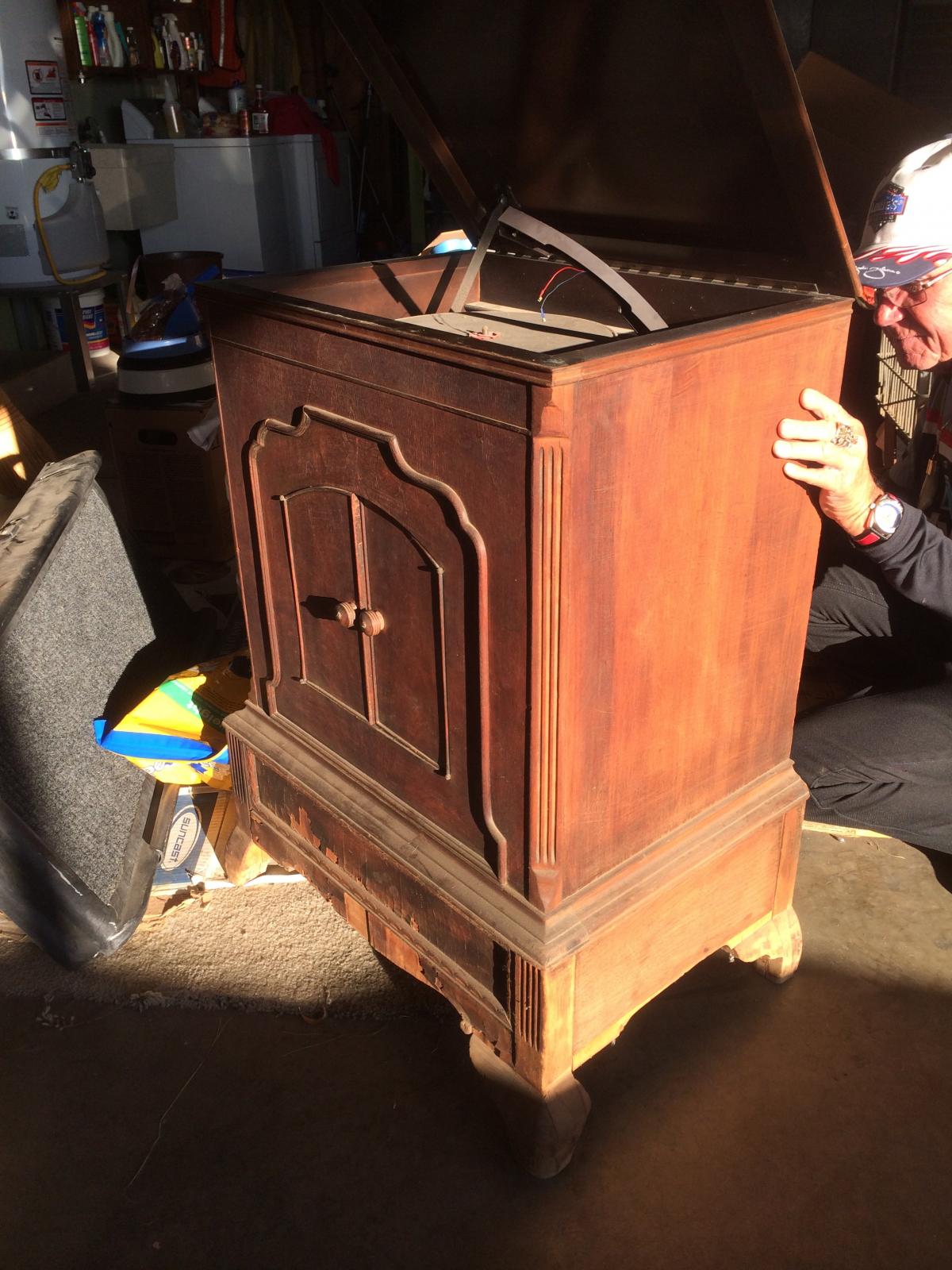

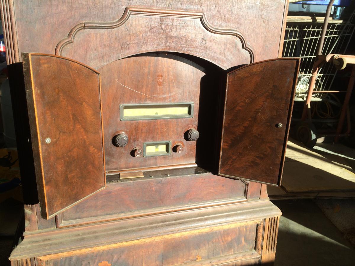

eggil Posted November 30, 2013 Report Posted November 30, 2013 (edited) My father in law was going to take this radio to the goodwill. It is a GM 150A (I didn't know General Motors made radios in the 1930's). I am thinking on using it as the case for my Megatron build. It needs a lot of work, refinishing the wood and gutting everything out. The amp/tubes would be where the turntable is, and could close the lid when not in use. The power supply and Stax jack will go where the radio dials are. It is quite heavy, and would be a real challenge to take it to meets Edited November 30, 2013 by eggil Quote
Victor Chew Posted November 30, 2013 Report Posted November 30, 2013 That's a piece is historical treasure. What tubes is the amp using? Quote
eggil Posted December 1, 2013 Report Posted December 1, 2013 (edited) Not sure. They have no ID numbers but have 4 and 5 pins. I'll post a picture when I bring it home. I am excited because this could be a unique and very cool looking amp. Edited December 1, 2013 by eggil Quote
